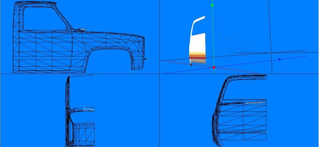

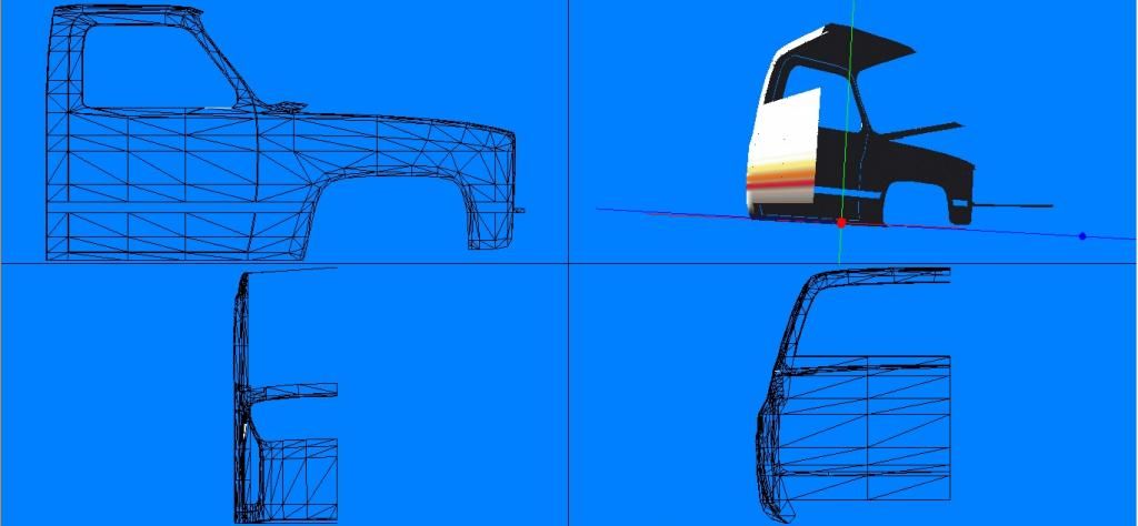

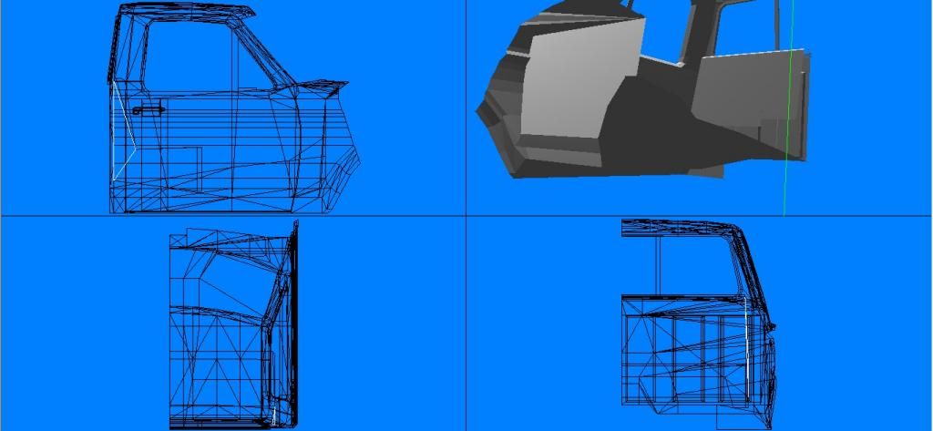

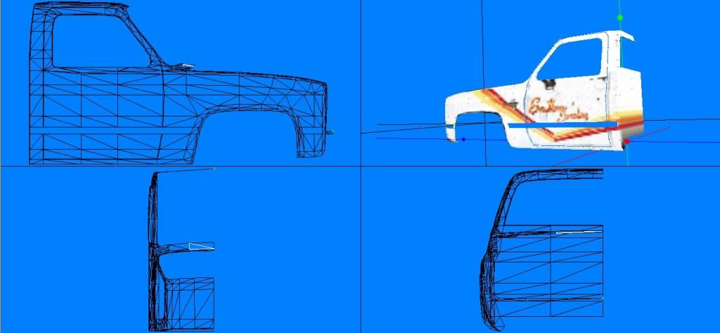

The models will most likely have to be designed for printing since most 3d models don't need to represent material thickness. Models made now are a framework of wires holding micron thick faces that represent a structure. If an attempt was made to print one the parts would be paper thin and far too fragile to work with. Bridging that gap will take reworking most models to represent not only the appreance of the original but also to have enough rigidity to be able to work with it.
Here are some basics about 3d models to aid in this discussion somewhat. In the pics below the the views on the upper left, lower left, and lower right all show the wireframe model from a differnt angle. The upper right window shows the model with the faces in place and painted with the texture that will give them their color.
Faces make up the surface of the model and the wireframe gives them their shape.
Faces do not have any thickness or mass to them. Think about building a cube from the thinnest possible styrene strips and wrapping it in clear plastic wrap, the cube will have a shape but it will be hollow and not have enough density to work with. Another aspect of faces in that they are only visible from one side, if you were to paint the outside of your cube you can clearly see the faces from the outside but if you were inside the cube and the faces behaved like 3d model faces and not plastic wrap the colored faces would be invisible. See how they behave in the pic below showing the inside of the model above.
To give the appearance of mass the guys on the site I was modeling trucks for developed what we called "fiberglassing", where we would take the outside model and turn it inside out to create an inside surface and then add it back into the outside model to make a body shell. The pic below illustrates this technique, it now looks like the body has mass or density. It appears to exist in 3d since it has an inside and outside but it would still not be printable because it still doesn't have any thickness, it's basically the front and back of the same sheet of paper.
More advanced 3d models and most of what you find available on the web have their interiors built in such a away as to be truly 3d but they still would have the same material thickness issues as the pics above. The models will have to be made with an inside and outside surface and in a way that tells the printer that the area between those surfaces needs to be solid. Newer 3d programs are beginning to have this ability, a lot of this really depends on how the software is programed. Here is an model I made for the inside of a truck cab to give it more depth, some areas are just reversed faces to represent sheet metal and others I built out deeper to give the appearance of interior panels inside the cab.
