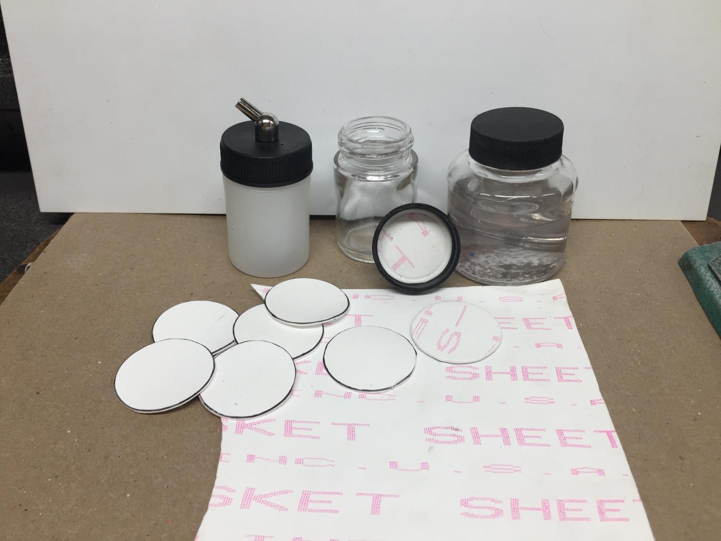

NOBLNG Posted April 17, 2019 Share Posted April 17, 2019 (edited) Rather than start a new thread, I figured I would add to this relevant one. My Paasche airbrush came with two cheap plastic paint bottles, only one of which had the fitting to attach to the airbrush. I can buy these two sizes of glass bottles at Michaels that fit the Paasche lid, but they come with foam gaskets in the lids that disintegrate with any volatile fluid. I went to a local gasket supplier and got some 1/16" PTFE (Teflon) offcuts for next to free! Replacing the cheapo lid gaskets with this stuff means I can store just about anything in them. It is quite soft and gives a very good seal. I also made a gasket for a 1/2 pint relish jar to store laquer thinner in, it is big enough that I can drop these smaller glass bottles inside to soak and clean them if necessary. Edited April 17, 2019 by NOBLNG Quote Link to comment Share on other sites More sharing options...
Bainford Posted April 17, 2019 Share Posted April 17, 2019 Excellent tip! About 20 years ago I got my hands on a quantity of 1/32" sheet PTFE, and made gaskets for all of my airbrush bottles, too. It works exceptionally well. Quote Link to comment Share on other sites More sharing options...
