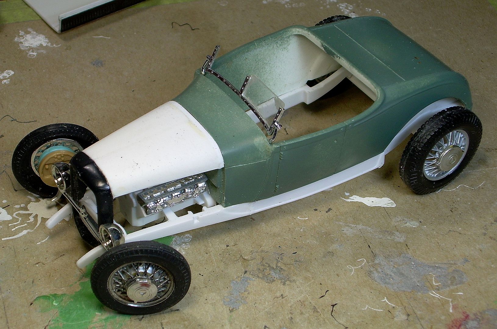

They say the devil's in the details, and the hard part of any build for me is sticking to it after I KNOW how it will look, but still have to go through all the motions to get there. Once I have the overall theme and stance established, I tend to go spinning off into more creative beginnings on new projects, rather than staying with the precise and time-consuming work to complete things. A character flaw, I know, and one I simply CAN'T indulge in real-life.

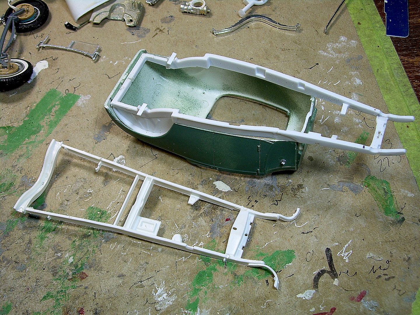

Anyway, this one's shaping up slowly. I've put the front crossmember back in between the frame rails, after narrowing it to fit the pinch, and turning it upside-down to raise the spring (and drop the nose) a little further. You could do it like this on a real one, but making an entirely new crossmember would be the right way, and after this one is trimmed and corrected, that's what it will represent. The frame-rails themselves have been clearanced a bit for the spring ends too. The AMT firewall has also been clearanced to fit the new bellhousing.

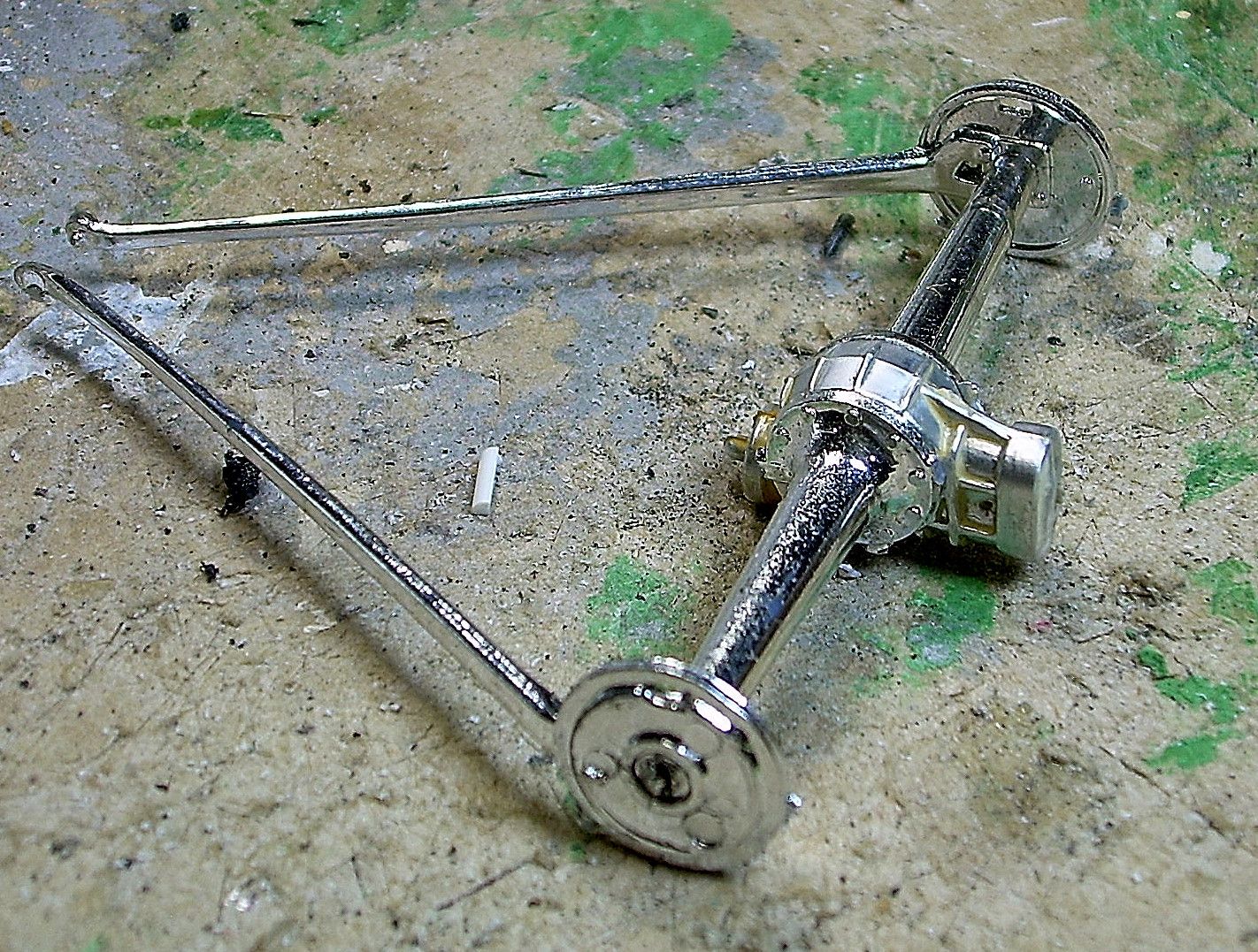

Rear suspension is shaping up, with the ancient Revell '30 Ford axle bells, wishbones and backing plates, and an equally ancient Revell parts-pack quick-change center section.

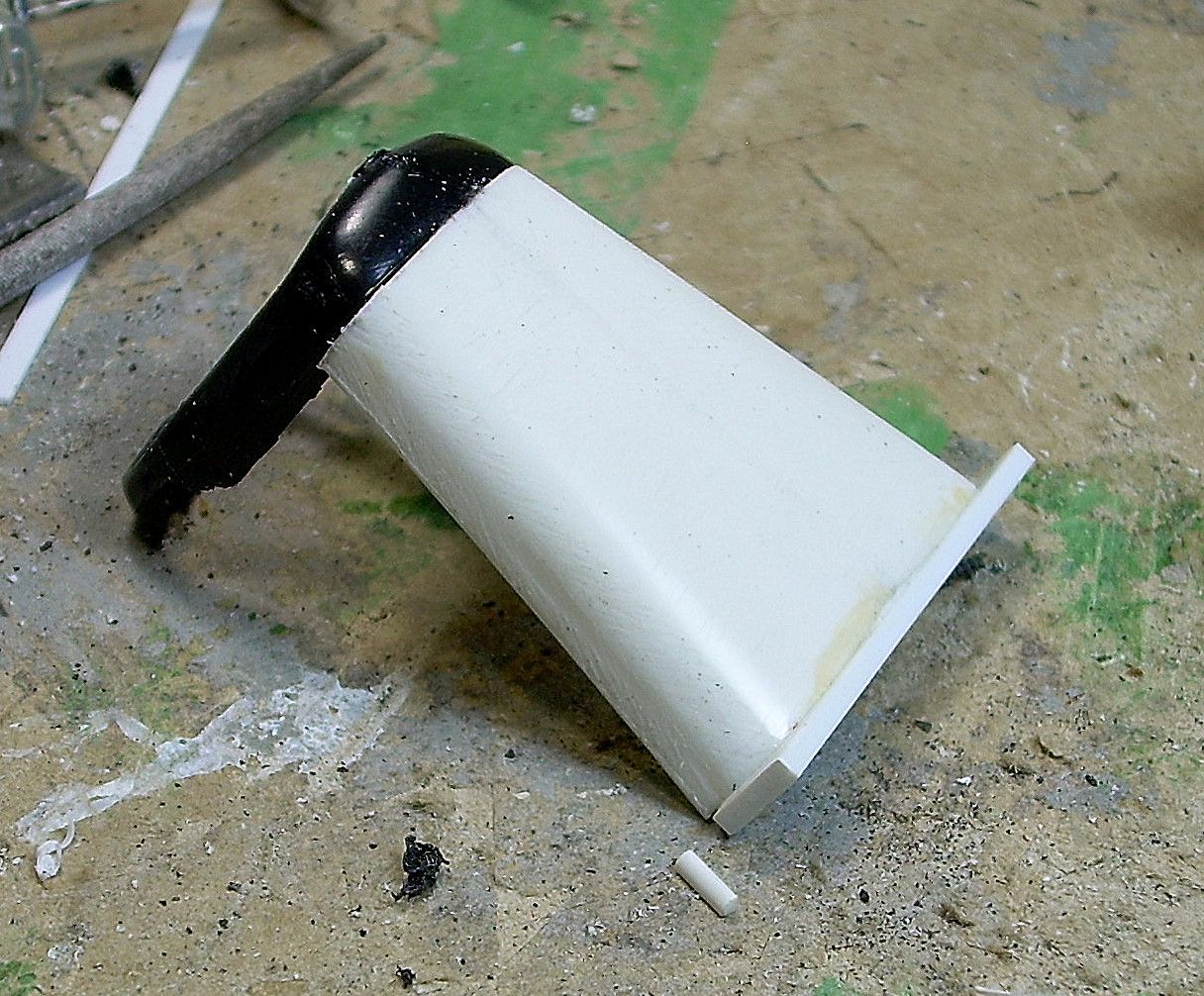

I've lengthened the hood a scale 2" by adding a 2mm strip of stock to the rear of it. This will be shaped to fit the cowl.

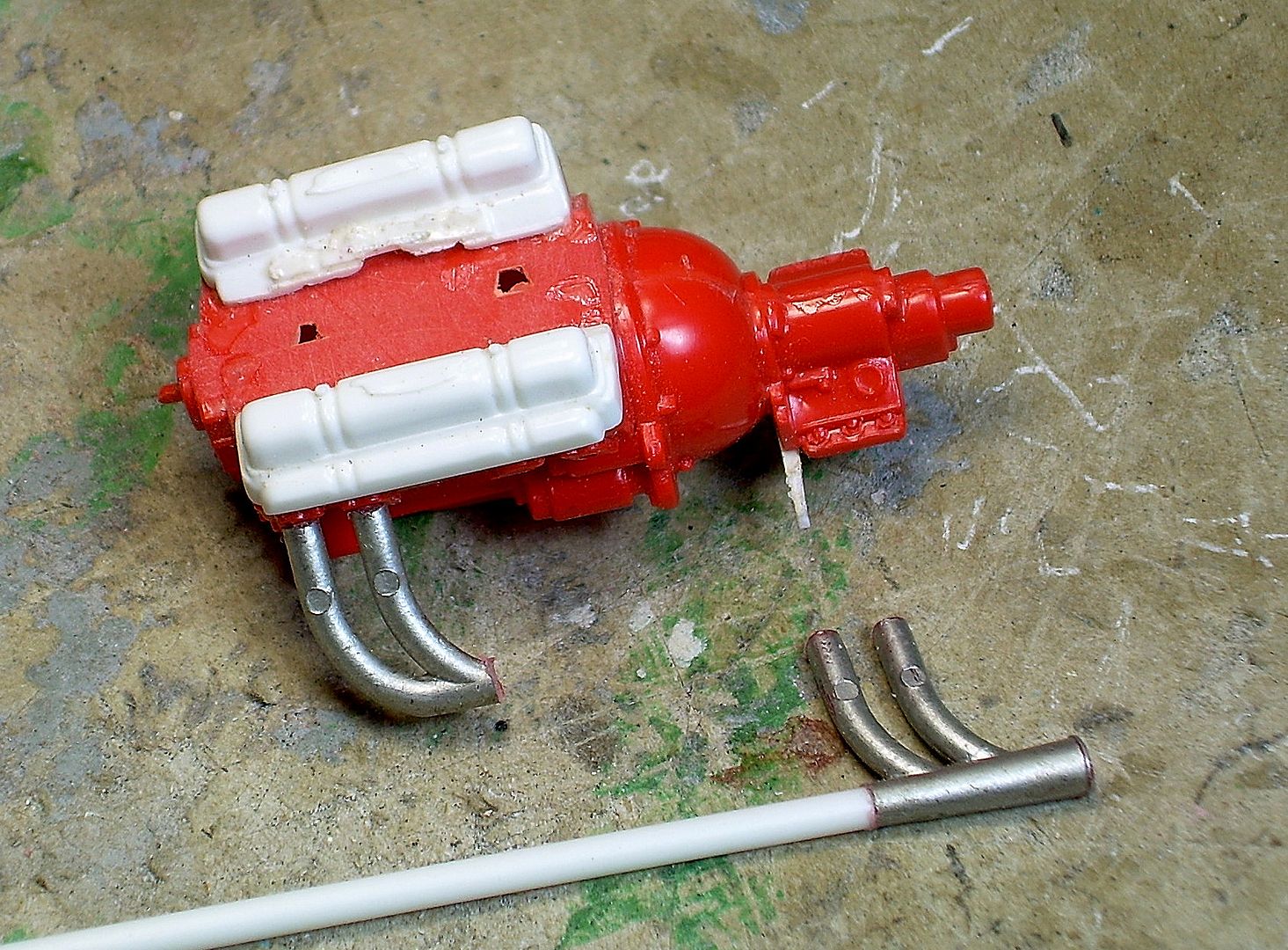

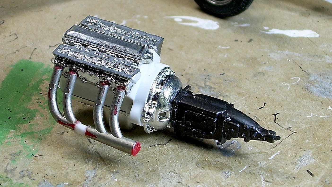

I'm using headers from the very old Monogram Indy Kurtis for this. The end tubes are paired the correct width for a nailhead (as are the ports on this old Monogram 1/24 Orange Hauler engine I'm using for a jig), but the center tube spacing needs to be stretched.
This is the mashup engine...new-release Revell ('29 Ford) nailhead block, headers modified as above, old Revell parts-pack heads, valley cover, bellhousing and oil pan, and an AMT parts-pack Borg-Warner T-10 4-speed trans.

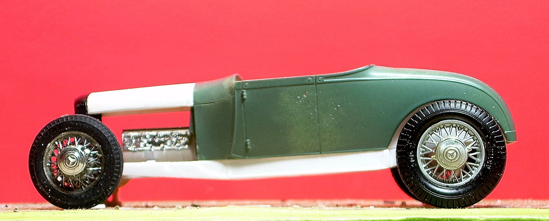

This is the payoff for the additional work on the front crossmember, and the lengthened hood. I was able to get very close to the stance of the original mockup back...with the suspension actually under the car...and that's a large part of what I like best about this particular build.

If I recall correctly (I'll check in a minute or three) the AMT quick-change centers are too large in diameter to look right with the old Revell axle tubes, though it's mos' likely just a minor measuring / scaling problem somewhere along the line...which is why I used the smaller old Revell parts-pack unit.
There IS a difference between Ford model A / midget and V8 quick-change diameters at the bolt-circle (the A is 9" in diameter, while the '35 and later "V8" unit is 9.25"...BOTH quick-change styles were available). The difference between the A and V8 units is kinda small to be visible in 1/25 (only .25mm) , but the difference in the bolt-flange diameter between the AMT axle housings and the Revell QC centers is VERY obvious.
Something else to be aware of if you do a QC...all of the flanges on the various kit axle tubes are WAY too thick to look anywhere near scale-correct. Notice the axle-tube bolt flange in the lower LH corner of the photo below. You'll see it's quite thin. Many kit parts represent this flange as being over 1" thick, which looks ridiculous to anyone familiar with the real thing.

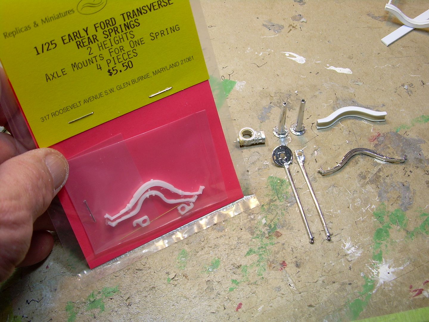

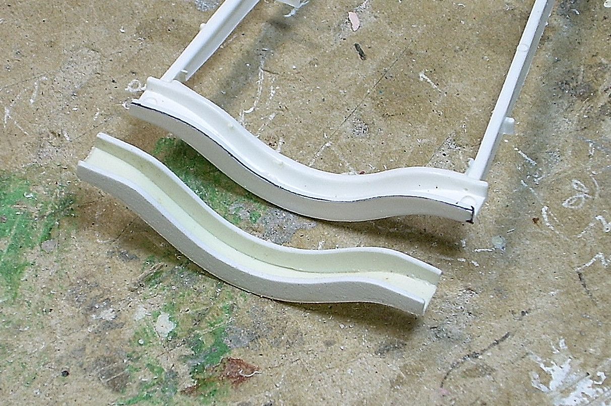

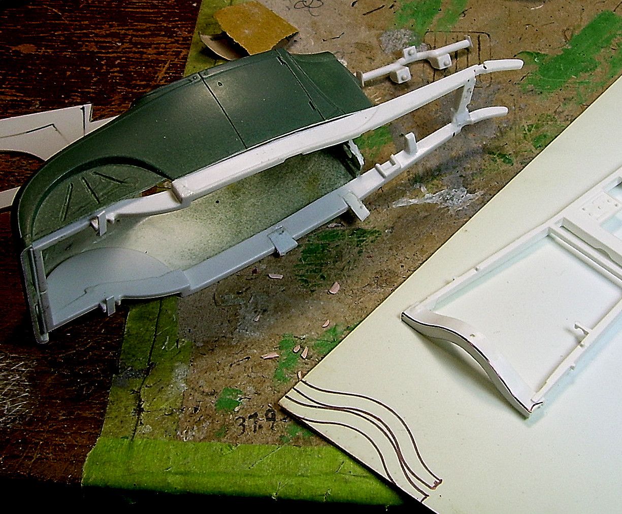

I had a little bench time, and the next thing to address was the rear spring, a crossmember to accommodate it, and the placement of the crossmember to maintain the stance exactly. I'm getting a little low on model A chassis to rob rear crossmembers from (either an A or a T rear crossmember is usually necessary to swap in an A or T spring that has enough arch to clear a QC rear end in a '32 frame...of course depending on several factors, like how low you want to go).

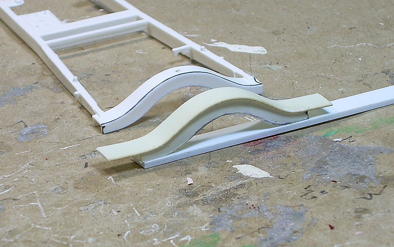

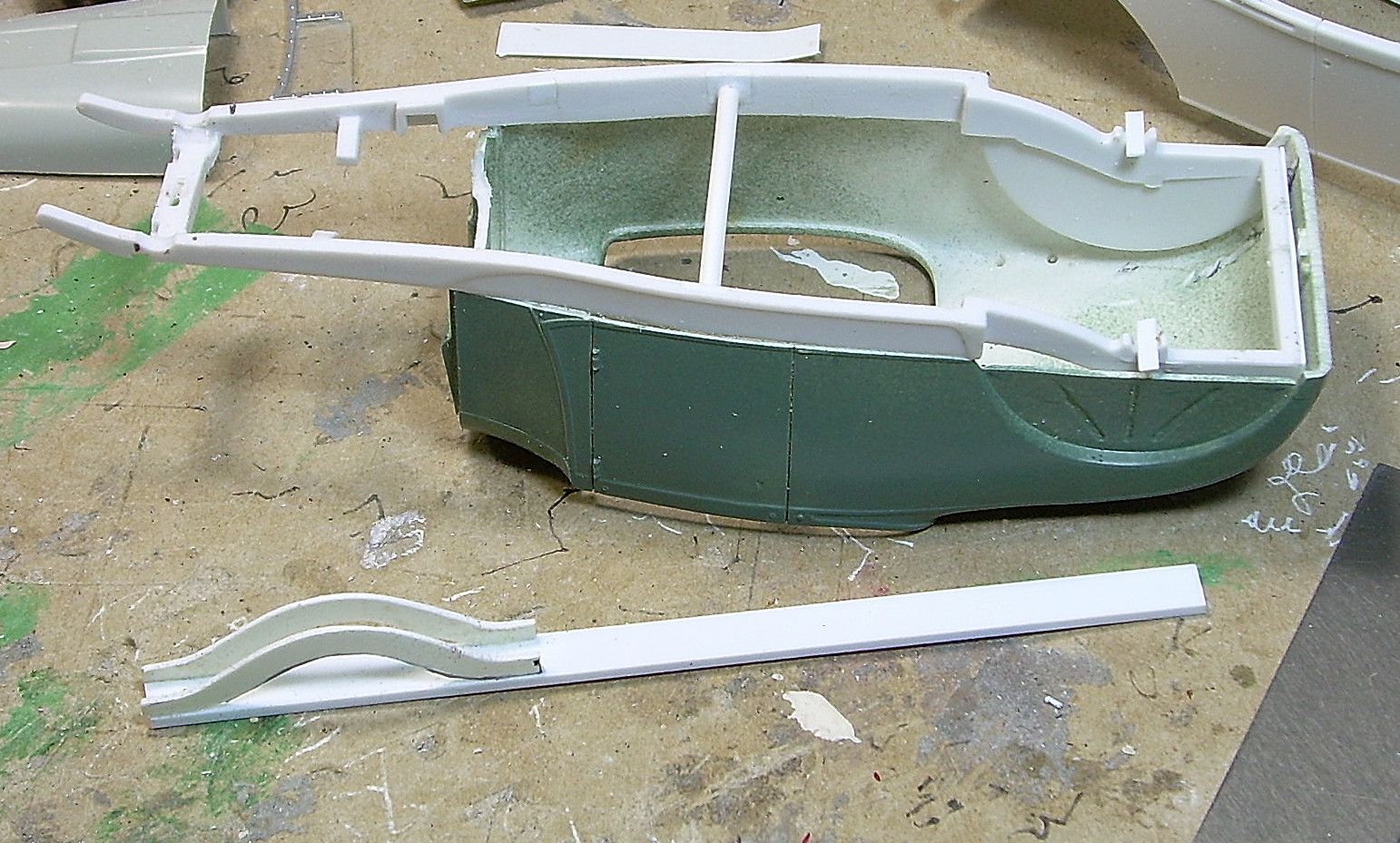

Rather than hacking one out of one of my dwindling supply, I decided to scratchbuild one, using the old and excellent Revell '30-'31 unit as a pattern. The rear crossmember on the chassis in the foreground is what we're after.
I traced the shape on sheet stock first (also shown is the in-process filling of the mounting locations the Revell kit chassis provides for the crossmembers and bits)...
...cut the pieces out and assembled them (tacked with small drops of liquid cement) on a fixture to hold them steady for work...
...matched the pieces and glued a cap over the side webs...
...and after everything hardened up and got trimmed, we have a finished crossmember, ready to go in.
Here it is in its rough position. The photo also shows a slightly dropped center crossmember I made from tube to support the rear of the trans, and the filled indentations the Revell frame comes with to mount the kit crossmembers.
