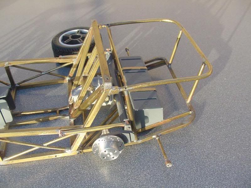

Once I got the rear body section mounting points established so I could put it on and take it off the frame and have it line up the same every time, I went back to setting up the rear suspension. I made the upper links that determine where the rear wheels would reside in relation to the wheel well openings. More brass…

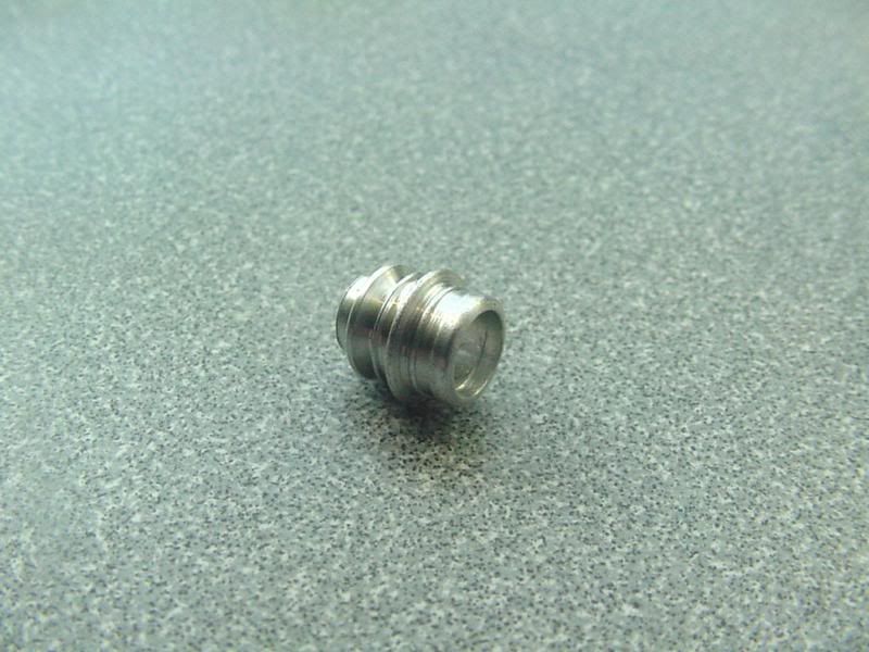

I also made the outer CV joints and stubs to mount the rear rotors out of aluminum.
The CV boots will be soft and dyed black like the tires. The mold has already been made from this aluminum master I turned for them.

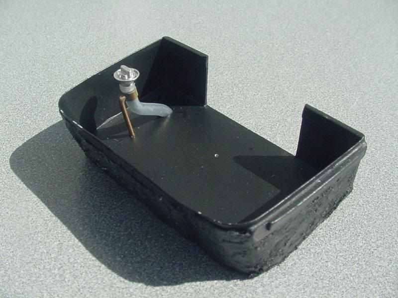

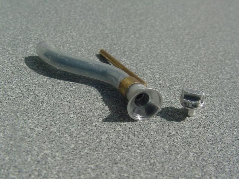

The fuel filler is made of brass, aluminum and some soft rubbery plastic that was a tube I had lying around from a paint brush bristle protector. Heating over a candle and bending it like sprue worked well.
The filler will be installed in the trunk.

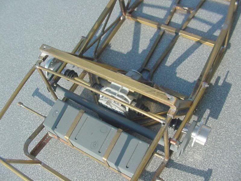

I cast the CV boots out of a rubber-like elastomeric resin and made half-shafts out of brass. Here is one CV/axle assembly and a “loose boot”. The inboard CV joints are already installed on the pumpkin.
Here are both sides installed into the car. There is enough flexibility for the rear suspension to work. Top:
Bottom:

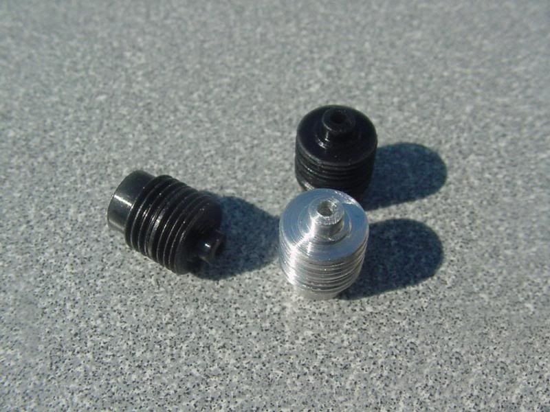

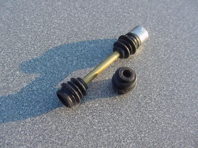

Here’s more boots… Since I was making CV boots, I decided to make the steering rack boots as well. I turned a master from aluminum and cast soft rubber-like accordion boots.
Mark, the boots look great. With all those ribs, I'm surprised you're able to get them off the aluminum form. The rubber must be quite flexible. Great work in any case.
Edited by Alyn
Thanks Alyn,
But I think you may be missing the process I used to make copies.
The aluminum piece is the master. I made a two part RTV mold off it, then I cast the rubbery elastomeric resin from the RTV mold.
Yes, the elastomeric stuff can be very gooey and flexible, it depends on the ratio it is mixed. It is actually easier to get the parts out of the mold if I mix it on the firm side.

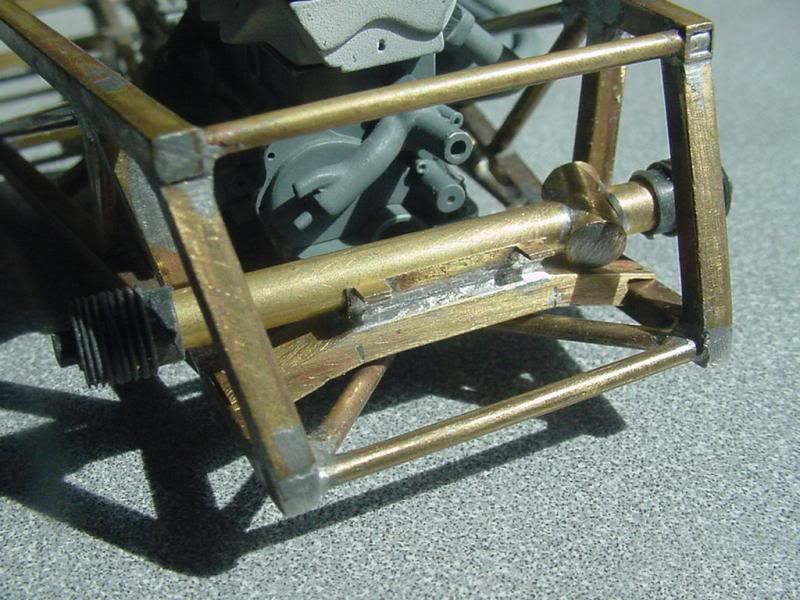

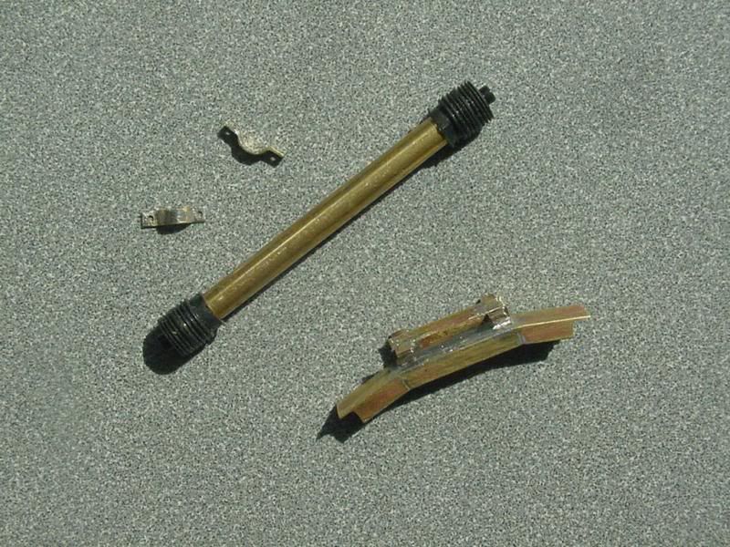

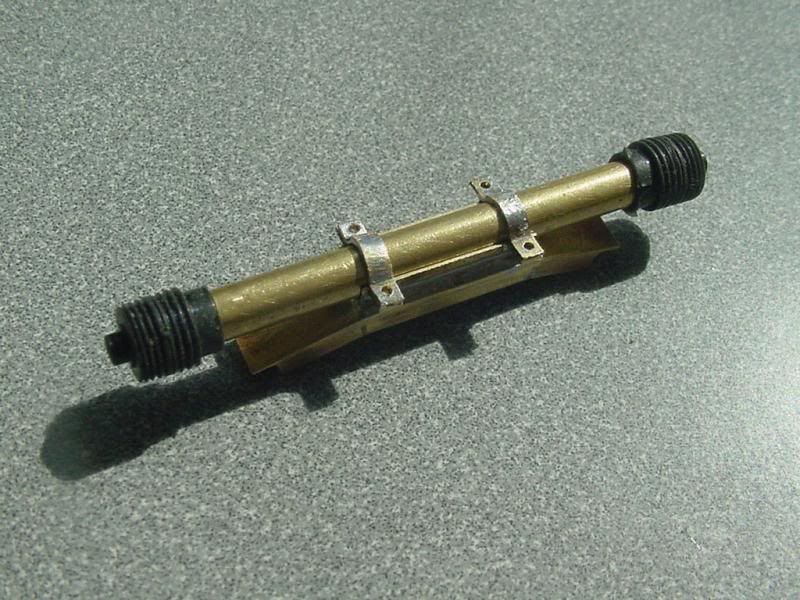

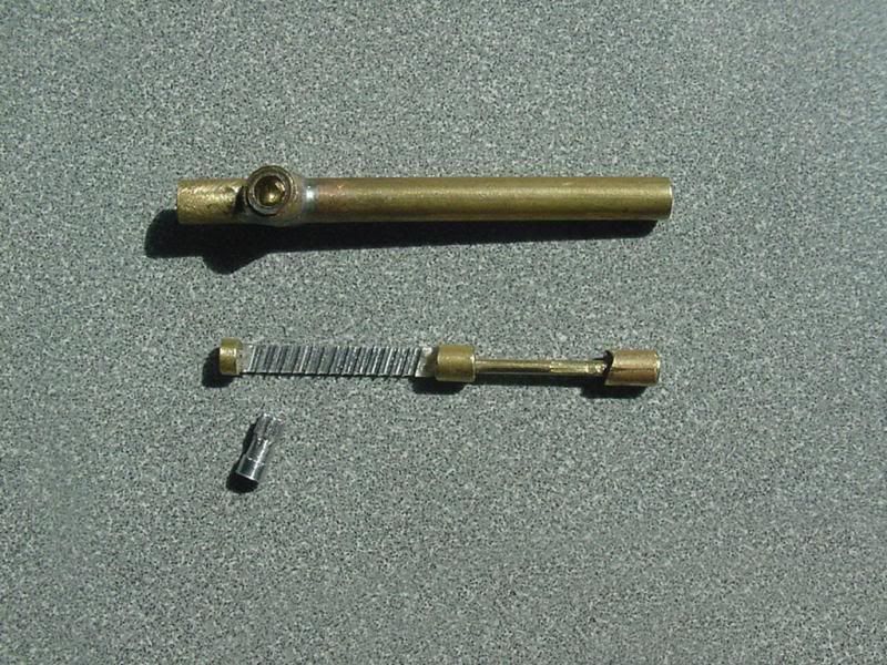

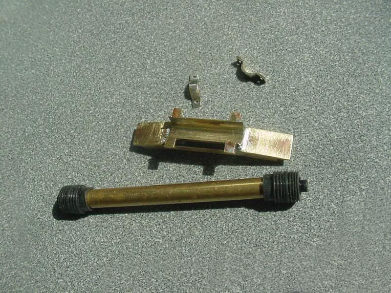

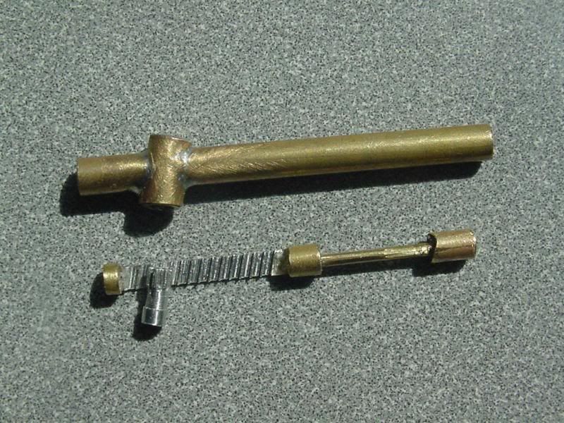

After I made a few steering rack bellows, I decided to make the rack, but I needed to make the cross member/mount for the rack first. All these assemblies are made of brass, (except the boots).

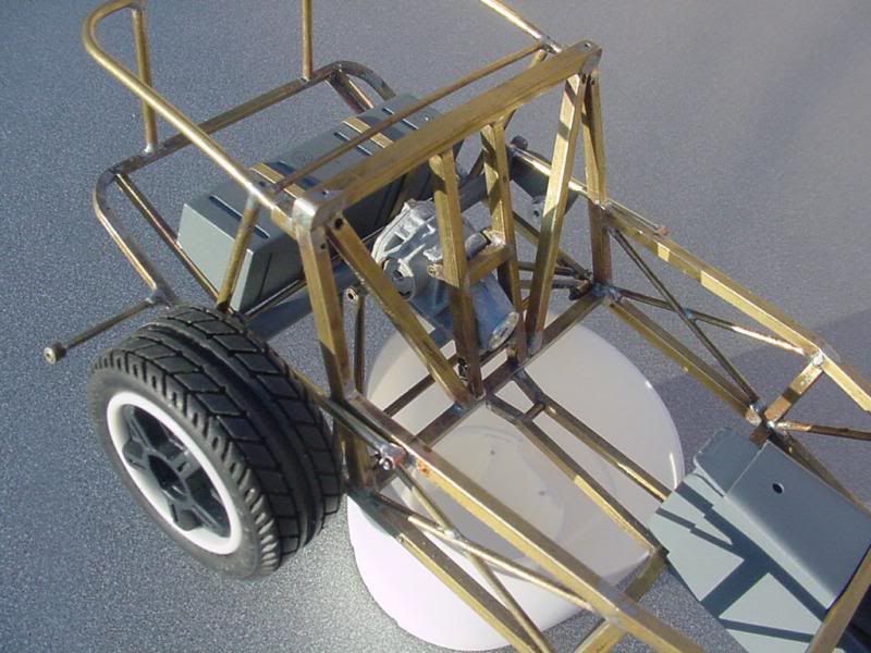

Once I install it into the frame with the engine I can get measurements to determine where the steering shaft will go. This one has some “working boots” on it so I’m not worried if they marred during the building.
The rack and pinion gears were cut from aluminum and the teeth section of the rack was cemented to brass guides. The rack teeth had to be pitched to match the input angle of the pinion. It does work.
It will be snug fit but the steering shaft should clear the alternator…
