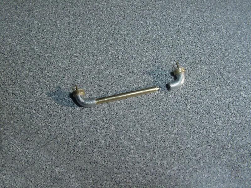

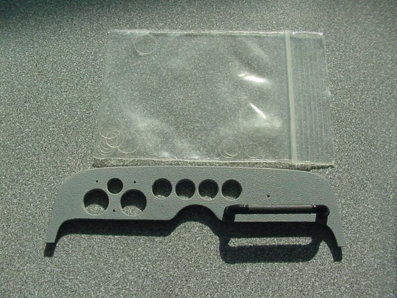

Scale-Master Posted January 15, 2014 Author Posted January 15, 2014 Thanks Harry. This will be the grab bar for the passenger side of the dash. I’ll add the rubber grip after it is painted.
Modelmartin Posted January 16, 2014 Posted January 16, 2014 Your spacing is remarkably precise. Off by a few thou here and there.
Scale-Master Posted January 16, 2014 Author Posted January 16, 2014 I textured the dash and made the lenses for the gauges. The grab bar is assembled with shrink tubing for the rubber grip.

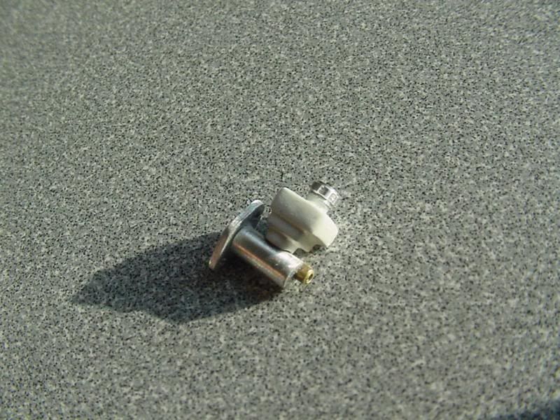

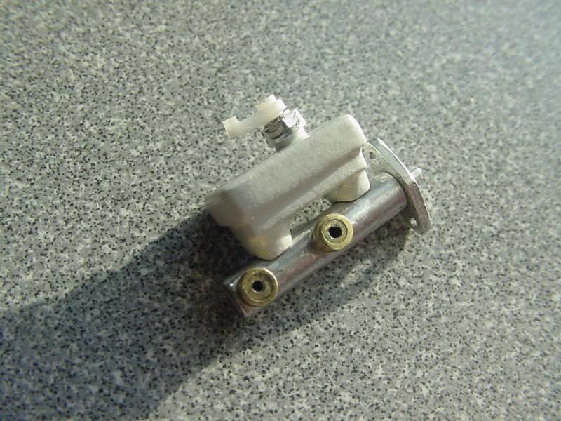

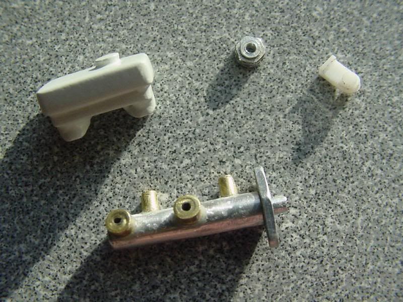

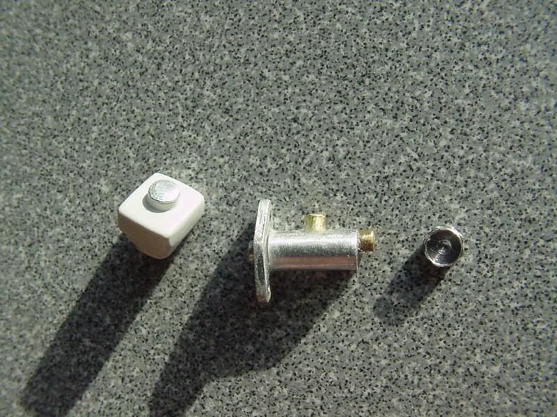

Scale-Master Posted January 17, 2014 Author Posted January 17, 2014 Master cylinders for the brakes and clutch. Brake: Clutch: Aluminum and brass for the hydraulic parts and caps. I rough milled the reservoirs from raw resin and hand finished them. Still a little clean up required… The electrical connector for the brake master was also milled from resin stock.

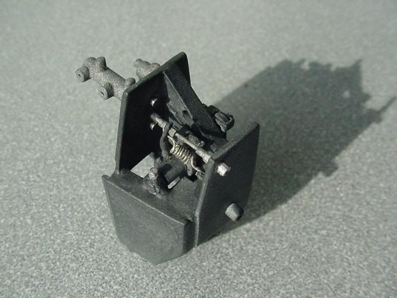

Scale-Master Posted January 23, 2014 Author Posted January 23, 2014 I assembled the pedal set into the foot box for the final time. I made the hardware and linkages and connected them to the master cylinder castings and brake & clutch pedals. The machined master cylinders were textured and painted to look like the cast parts they represent. I also made the cable with adjustment hardware for the throttle. This is not going to be a model of a virgin or trailer queen, so a little dust and grime was weathered into this sub-assembly. Still more parts and details to add to it though

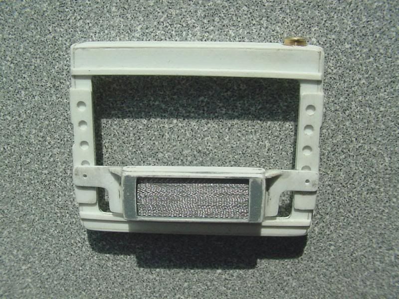

Scale-Master Posted January 29, 2014 Author Posted January 29, 2014 Thanks again guys! These parts were started over a year ago. Now it’s time to fit them into the whole of the project. The firewall has been added to the cowl and the windshield frame and mounts have been soldered together. Only five pieces make up the windshield assembly at this point…

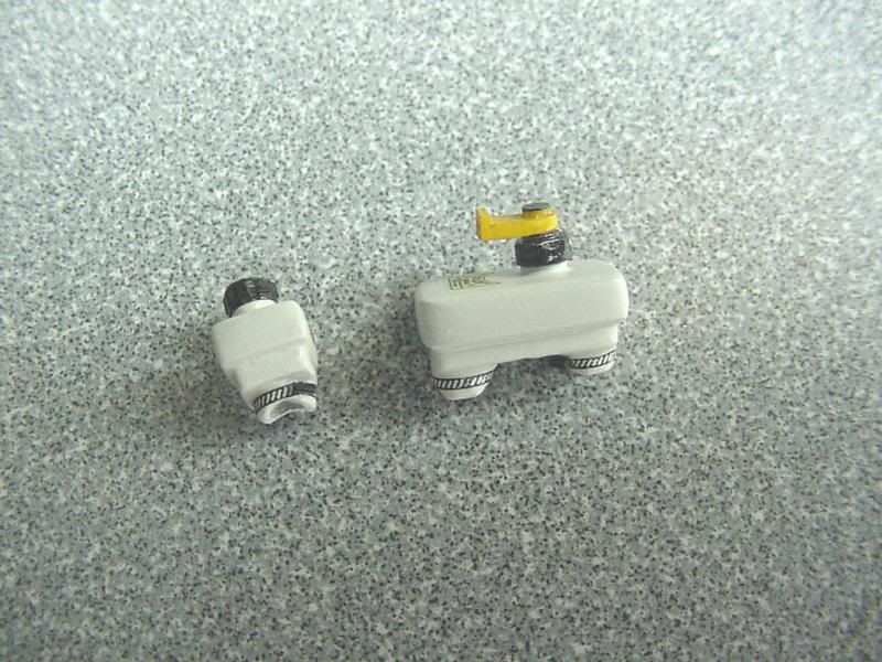

Scale-Master Posted January 30, 2014 Author Posted January 30, 2014 The reservoirs for the clutch and brake master cylinders are pretty much done now that they are painted, (custom) decaled and have the hose clamps installed; I think I may hit them with a duller clear after seeing them in the photos…
