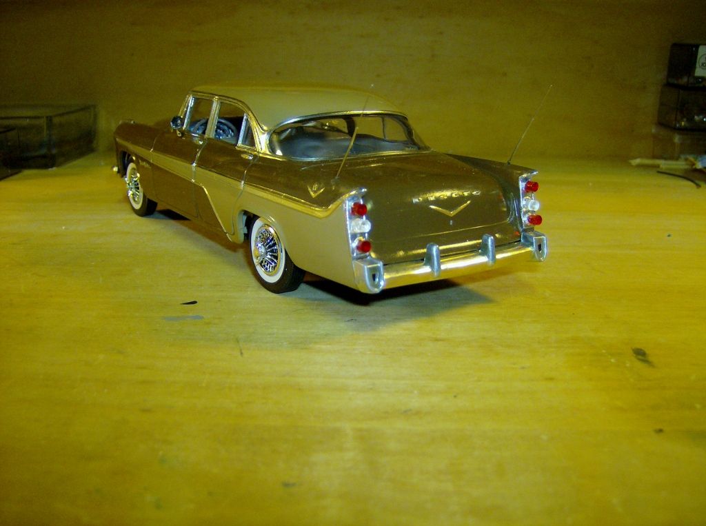

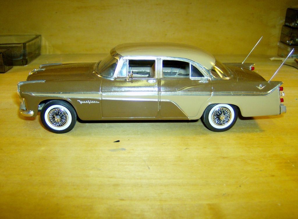

Well, at times it was a tough fight, but I finally got this thing finished up. I painted it with Tamiya Tan and Tamiya Red Brown. The BMF work was a bear to do, but came out well in the end. The Modelhaus resin interior gave me fits to get it to seat into the body properly. I had to sand down the side panels and the front and sides of the dashboard, plus, I had to drastically trim the front and rear promo glass a lot at the bottom edges. The interior still doesn't seat in perfectly, but it's as good as I could get it. I added clear headlight lenses from my parts stash on top of the chrome promo headlight pieces. They look a lot better with the clear lenses. For the taillights, I got a little creative. The Johan promo body had the taillights and backup lights molded on in the same color plastic as the body. I snipped those off with a sprue cutter and filed the bases as flat as I could get them. After the BMF got applied to the taillight area I wound up creating my own taillights. I used the little round nubs attached to the clear parts trees around kit windshields that the ejector pins hit to push the clear parts tree out of the mold. I found 6 that were the same size, cleaned them up and painted 4 of them with Tamiya clear red. Then I glued them in place, using 2 unpainted clear ones for the center backup lights. I think they look pretty cool, and definitely a lot better than the molded on ones would have. I made my own twin antenna's from printer pins and stainless steel surgical tubing. I used a cool looking set of wire wheels from my parts box along with a set of whitewalls, instead of using the blackwall promo tires and hubcaps. I think that the wire wheels look a lot better on this car.

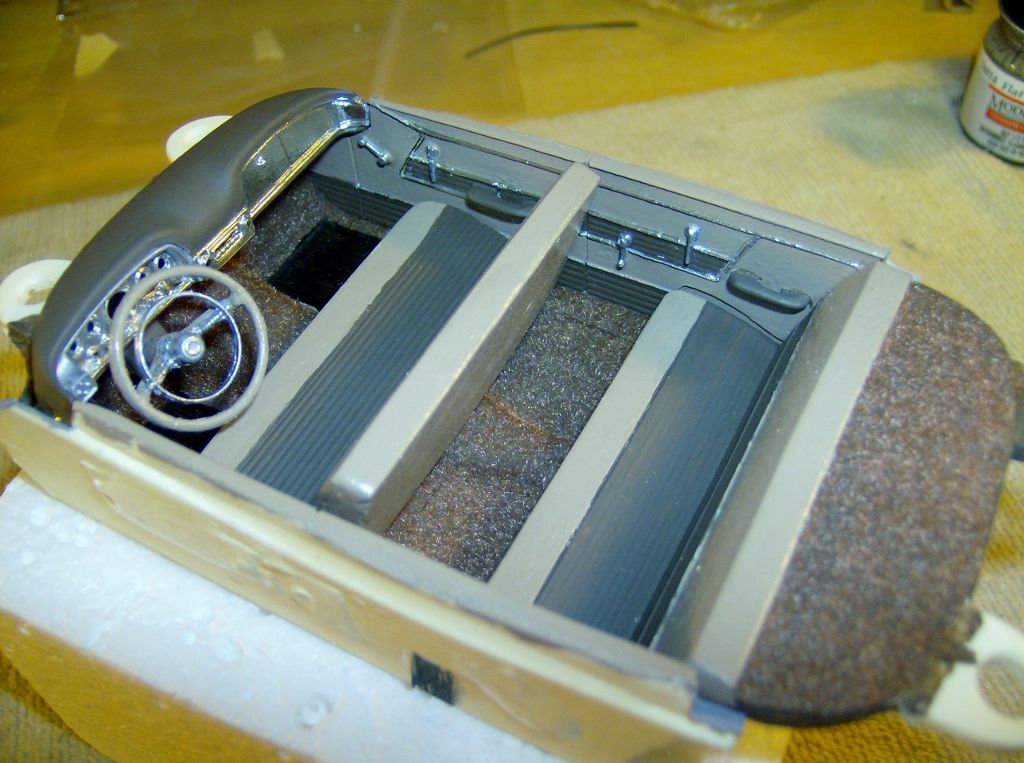

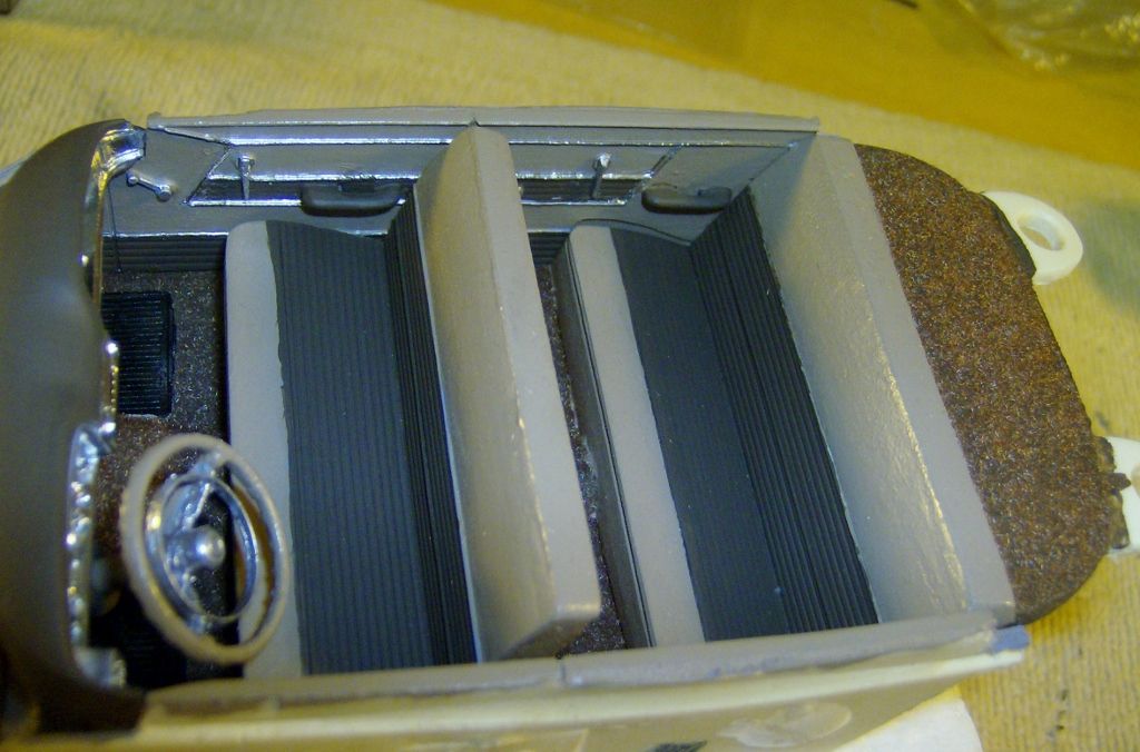

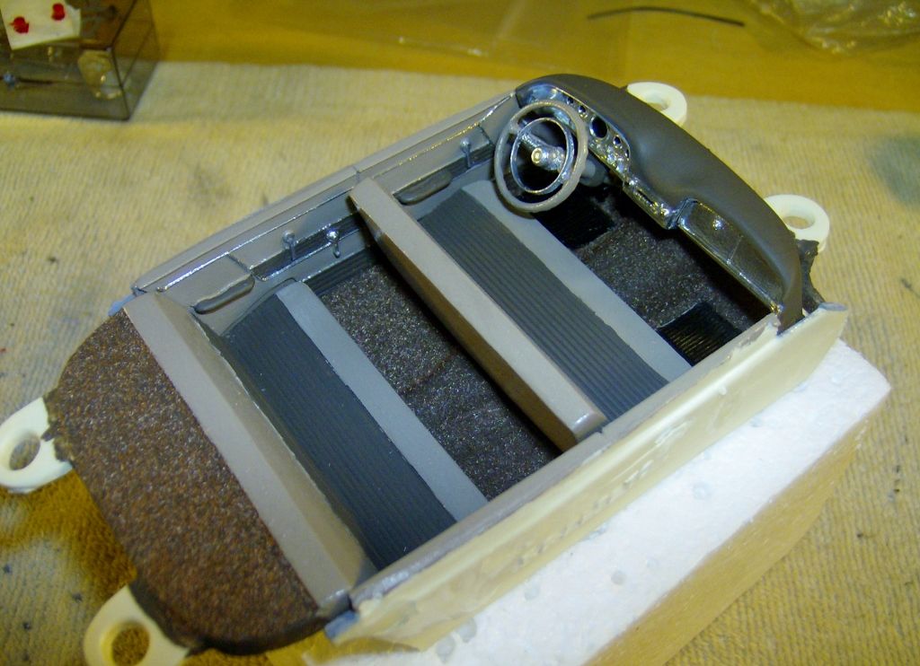

Here's what the finished interior looked like before being installed into the body. The Modelhaus resin interior for this car is a 6 piece assembly consisting of the dashboard, steering wheel, 2 side panels, front bench seat and floor with rear seat. Doing the BMF on the side panels was a pain because the trim to be foiled was so thin that the foil didn't want to stick. It all came out OK though. I used brown flocking for the carpet and installed a brake pedal from my parts box, as there was no pedal molded to the floor.

Thank you all so much for your great, encouraging words.
Al, the BMF was a real chore on this one......more so than some of the '58's that I've done.
Harry, WOW.. thanks a lot..!! Yeah, I'm really happy with the way that the taillights turned out.
Larry, this car is far from immaculate, but thanks very much for your kind words.
Tom, yeah I'm thinking that the Plymouth will most likely be next up, but I still have to do the interior work. I've also still got the '58 Olds in the works... the clearcoat is drying and I've got a lot to do yet on the interior.
nice job upgrading the promo tail lights. the Jag/Maserati wires look good on this too.
If you keep doing BMF on these 50's cars people here may just ask for a BMF tutorial from you. :)
Thanks very much again everyone for all your kind words.
Steve, I absolutely LOVE all of the cars from the 1950's. They all had their own style and identity back then...... not to mention all that chrome and stainless trim. IMHO cars today don't have much if any individual style or chrome.
Mike, those wire wheels are not from either a Jag or Maserati as I've never had a model of either of them. I found them in my tire/wheel parts stash. I really don't know what kit they were originally from. The only thing I can say about doing BMF work is use a new, sharp blade, burnish it down really well with both a QTip and a toothpick, and after you trim it on the model, burnish down the cut edges again with a toothpick. Use a magnifier if you have to, and take your time.

So far, I've seen at least three kits those wheels could have come from, Monogram also had an Aston Martin those tires/wheels could have come from, although it's possible they could be from some other Airfix or Aurora kits of some english sports cars.
Looks really really nice Richard , and is a great start to the Class of '56 !
Paint , interior , and the BMF all look great , and I like your idea for making taillights ( I'll remember that ) ! Also , making the antennas that way is the only way to go . . . I did it on my El Camino build and will never use plastic "kit" antenna again !
