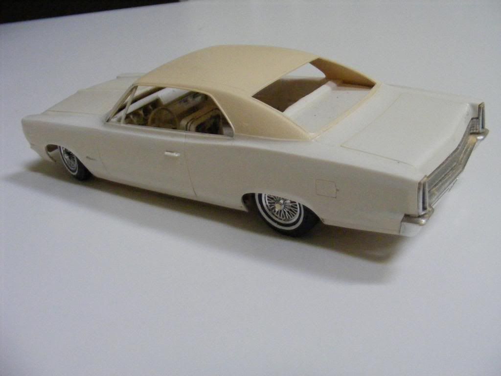

Jo-Han 1967 AMC Ambassador DPL 2 Door Hardtop.
I started with this one. The front suspension was broken in pieces.
It was glued pretty tight, and it was a little dirty, but I was able to get it apart with little drama and it was cleaned and stripped.
I had to rebuild the front suspension, and I lowered it while doing so.
I decided on painting it with Testors' Fiery Orange Lacquer, with a Black Vinyl Roof, and Interior. I also added a set of wire wheel covers, with Goodyear Power Cushion Whitewalls.

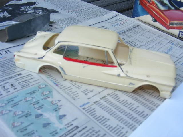

Lookin' good Ron! I was thinking about you today. I am working on a Revell '62 Valiant and the windshield top is way to low. I'm figuring I'd be taking it up to the top of the molding, and scribe a new one that much above. Didn't you do this modification? Advise?
Tom,
I cleaned up the heavy mould lines on a AMT '61,
and replaced the windshield and backlight moulding with plastic strip.
On your Revell car, I would look at the AMT, measure the height of their windows relative to the edge of the roof, and remove that amount, and replace the mouldings. I'm also working over an AMT '60 Sedan, which is not as bad as the hardtop.

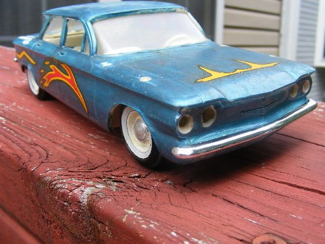

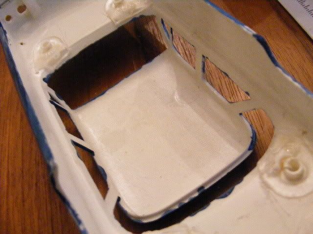

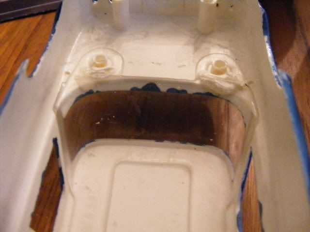

I have a Buick with a bordering-on-fused glass unit into the roof and I'm trying to figure out how to remove the glass without destroying the body.
On this '60 Corvair,
the glass was heavilly glued in at the base.
I cut the glass loose at an inconspicuous place, using the Dremel with the 1" Zona circular blade, cutting just at the glass, and removed it from the car.
And yes, It's ready for paint after a lot of work.
