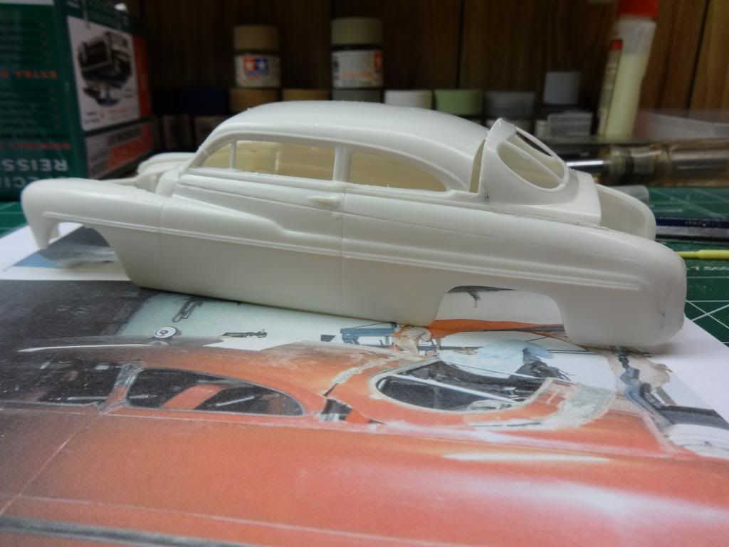

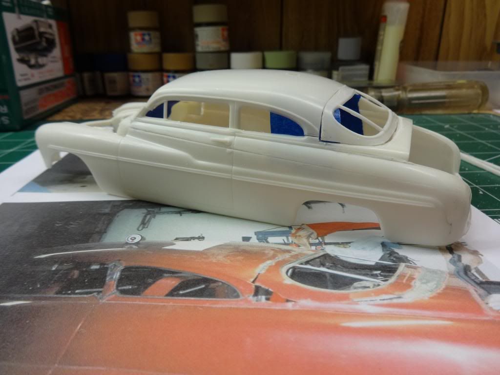

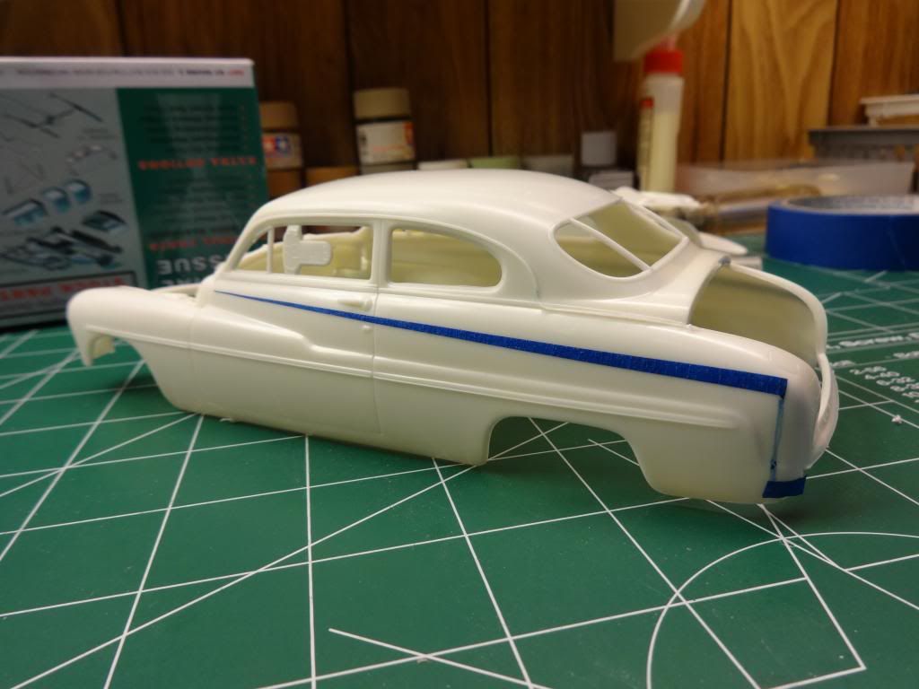

James2 Posted September 25, 2013 Posted September 25, 2013 (edited) Starting with the AMT 2Door Custom kit, It will get a pie section first, then the roof. I used a razor saw to scribe the cut then the back side of a #11 blade, scoring little by little until the cut went through. I'll save the pie to use as filler on the roof chop. I then welded the body back together with liquid cement. After this is set I'll chop that top.... Edited May 16, 2014 by James2

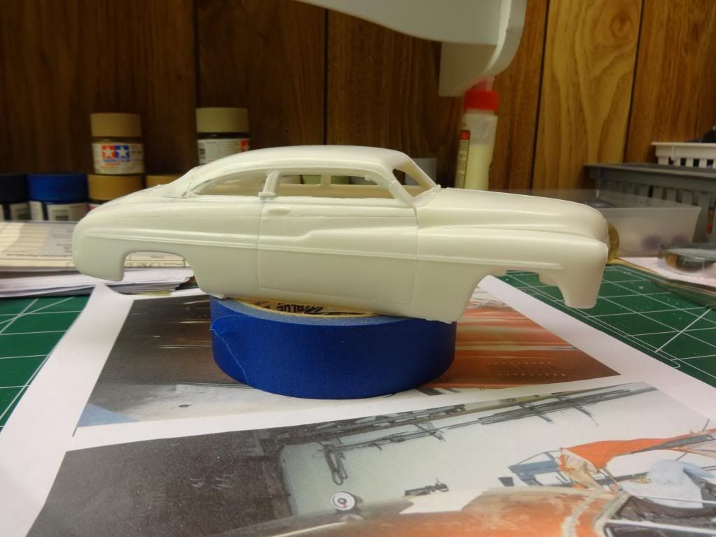

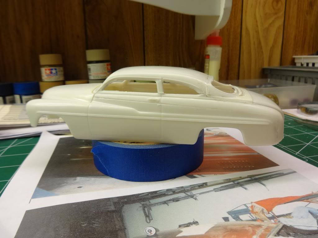

James2 Posted September 29, 2013 Author Posted September 29, 2013 Thanks guys, here it is before shaping, grinding and sanding. My plan to bend the "B" pillars was a good idea, the execution could have been better, but it will sand out fine. I also reinforced the inside of each joint with micro brass screen and CA glue. More mods to follow.... 1
Ace-Garageguy Posted September 29, 2013 Posted September 29, 2013 (edited) NICE FLOW on this so far. I like the wedge-sectioning job, and the chop is just right. Edited September 29, 2013 by Ace-Garageguy
Ace-Garageguy Posted September 29, 2013 Posted September 29, 2013 Just a thought...I wonder if a tad more rake on the B-pillar, and maybe a little subtle curve on it might echo the line of the front of the skirt... What you've got going looks great anyway, just as it is.
Alfa Posted September 29, 2013 Posted September 29, 2013 Nice chop an sectioning. the scrits all look right.
James2 Posted September 29, 2013 Author Posted September 29, 2013 On 9/29/2013 at 6:59 PM, Ace-Garageguy said: Just a thought...I wonder if a tad more rake on the B-pillar, and maybe a little subtle curve on it might echo the line of the front of the skirt... What you've got going looks great anyway, just as it is. Thanks Bill, I think I'll try a few paper patterns and see what looks good.
