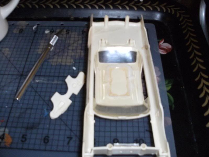

charlie8575 Posted September 30, 2013 Author Posted September 30, 2013 *Queue urgent-sounding news music* FLASH! Wildcat escapes anchorings! Pictures to follow! It appears I'll have to do a little repair to that cross-member, but the freed engine is a major hurdle.I suspect the soapy water being frozen expanded enough to loosen things up and the "wetter water" made it happen. Charlie Larkin

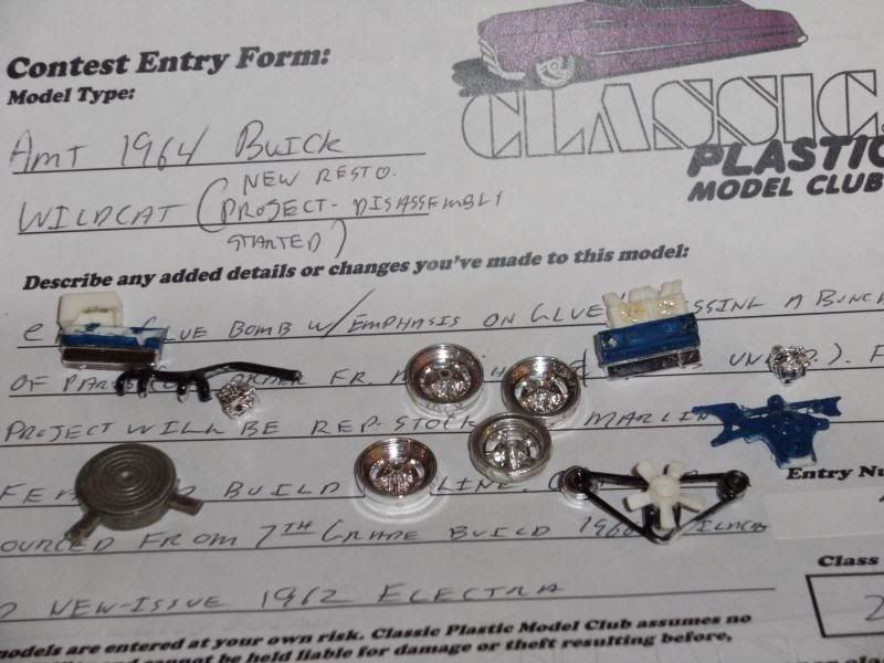

charlie8575 Posted October 7, 2013 Author Posted October 7, 2013 A short update as promised earlier. The parts from the '66 Wildcat that will probably be used large portions of the restoration work. A little closer view. As you might have noticed from the background, I went to Classic Plastic's show yesterday (well, officially yesterday now as it's 12:41 AM) and was talked into entering the disassembled mess into the "Work in progress" category. Well, it is certainly that, if nothing else! More will be coming this week. Charlie Larkin

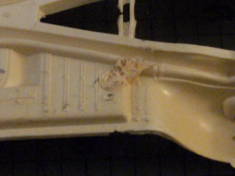

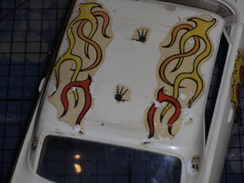

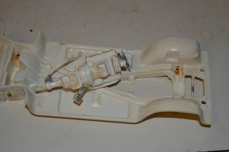

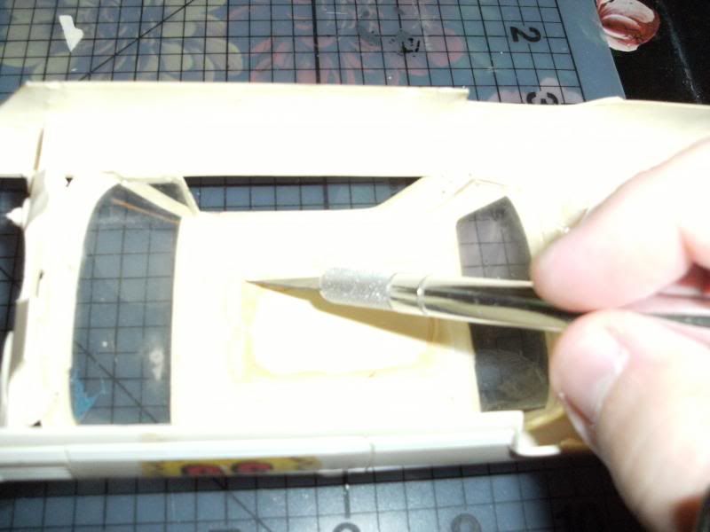

charlie8575 Posted October 11, 2013 Author Posted October 11, 2013 So, with today being fairly quiet, I decided to take a little time this afternoon, and see what I could do with things. It was pointed out to me Sunday that there is quite a bit of roof-melt from all the glue used on the window. This is a putty-sand-prime-repeat job, I think. I began by running a knife around the approximate inside of the window unit. I say approximate because the glue made the beginning and end of the parts indistinguishable in several areas. On the bright side, the firewall was barely glued it. Kid must've run out of glue. The body is now sitting in soapy water to allow it to more fully penetrate the seams, and hopefully release those hideous decals. The chassis is turning into quite a pit of vipers. It appears that the glue solvents caused the plastic itself to aerate, almost making it into a brittle, crumbly, Styrofoam-type material, espeicially around the exhaust where those dumps were attached by wanton cementing. I cleaned things up as best I could with a #11 and #17 chisel blade and some sandpaper. I'm going to continue to work on it, and see what I can do. Re-examination of the parts in '62 Electra found that the engine/transmission will indeed fit the '64 with the way the parts are designed, with a couple of small modifications. I will still be using the 1966 front cover and alternator, though, at they're better-detailed and more correct. Charlie Larkin

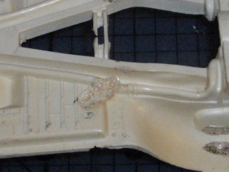

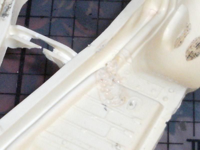

slusher Posted October 12, 2013 Posted October 12, 2013 Charlie l have not seen glue look buble like what is on the chassis. l have not work on many glue bombs either. Glue must have been stronger then. I hope you can get the glass out...
charlie8575 Posted October 12, 2013 Author Posted October 12, 2013 I don't recall ever having foaming glue like that, either, Carl, and I've seen some pretty messy resto projects over the years. I suspect the original builder simply used too much of it. I'm not entirely sure what type of glue was used, because there were some pretty strong ones then. I rather doubt that Duco cement would've caused that; that tends to get brittle and simply lose grip. There were also a lot more varieties of glue- Testors, Revell, Ambroid, and a few others. As I write this now at 4:04 AM, the body is still sitting in the tub, I'll probably pull it and bag it later this morning after I get some sleep (what a novel idea...), and see if I can get those decals off, as they don't appear to be budging (boy, this kid made a mess of this one), a quick re-soak, and in the freezer it goes. Charlie Larkin

ChrisBcritter Posted October 12, 2013 Posted October 12, 2013 I run into that bubbly business on pretty much every gluebomb I've worked on, especially when two parts aren't quite touching and the glue fills the gap. Maybe clean it up as close as possible, then weather the rest to look like dirt and rust? Good luck with the windows; will a new set from an AMT '63-'64 Impala interchange?
