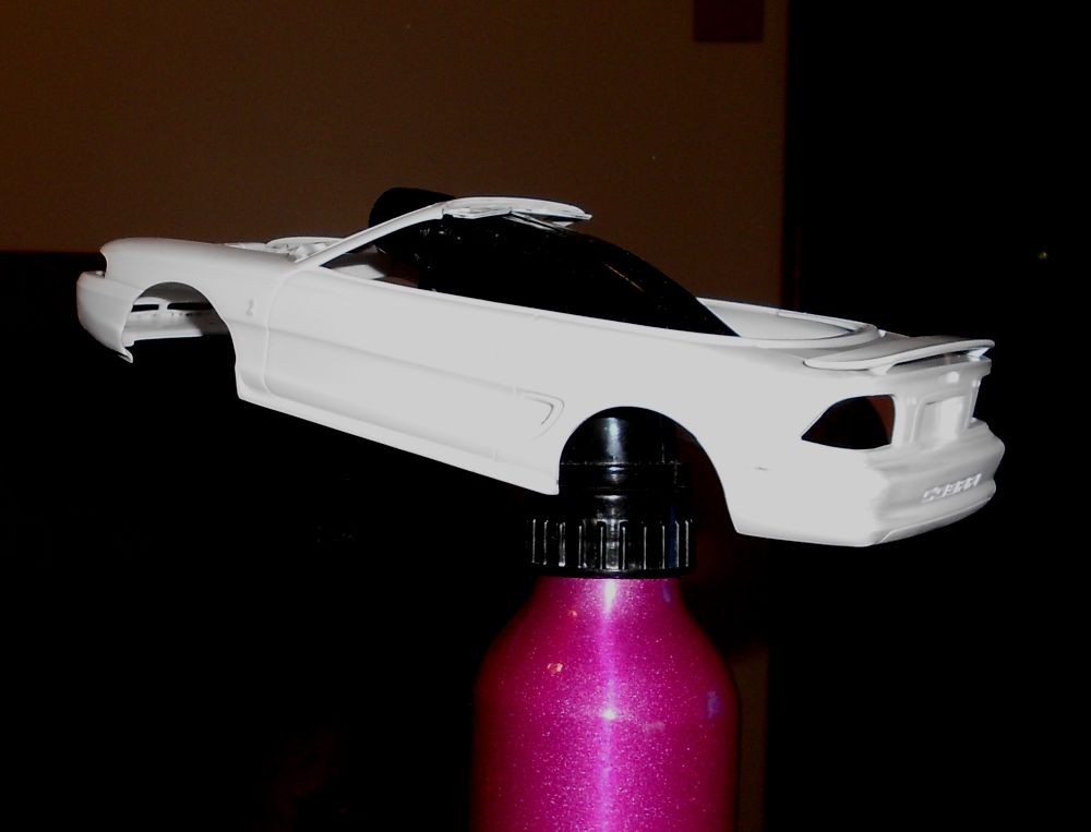

After reading this thread I made a quick trip to Dollar Tree to check this stuff out. For anyone wanting to try it they carry it in two forms, a ready to use variety that comes in a spray bottle and a concentrated kind that just has a cap on the bottle, I got the concentrate since I have bought the spray kind to use as household cleaner and was not impressed. I have to say after playing with it for a week or so that for soft paints like hobby enamels this stuff is great. However, it won't touch laquers even after a few days in the tank. It's not ideal for stripping chrome, the plating comes off easily but the under coating doesn't seem to be affected. What I do like is that it doesn't damage the plastic, unlike my previous oven cleaner method which always left the plastic rough and brittle. If you paint primarily with Testors enamel paint this will be a huge help for you. If, however, you use Testors one coat laquers, Tamiya laquers, or auto touchup paint you should stick with brake fluid or your preferred method.
Here is a pic of a body that was painted with Testors black metalflake, after two days in the LAs Totally Awesome and some gentle brushing it came completely clean. I have never got such a complete stripping from oven cleaner and the plastic is always damaged and stained.
