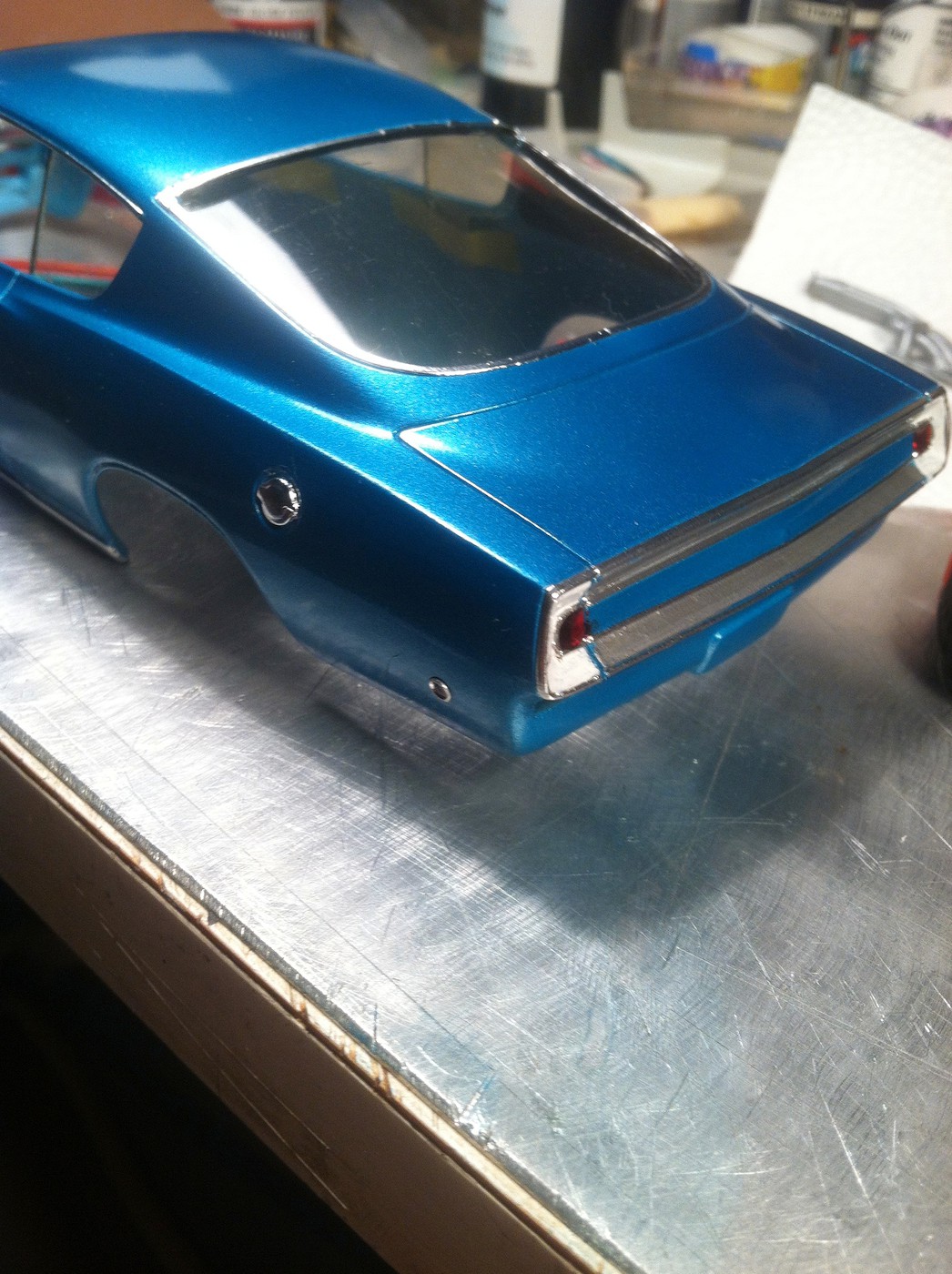

I managed to get everything ready for color. Tonight I got a late start, but fortunately didn't have much to do. I have to go into work for a few hours tomorrow morning and pick up out Easter Ham on the way home, but the afternoon is mine to spray on the color. The body looks really nice and smooth with level panels.
