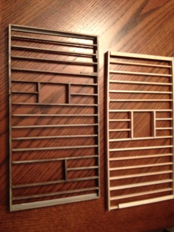

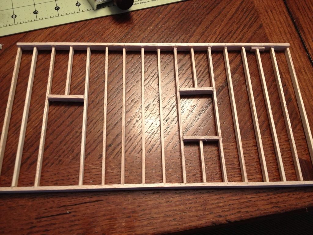

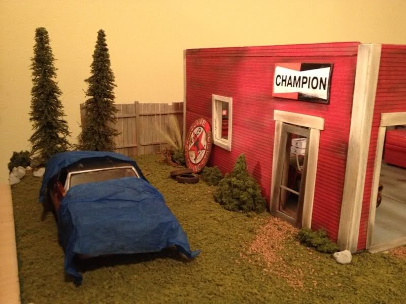

I started thus just before Christmas. I have been planning this build in my head for years and finally pulled the trigger.
I'm quite a ways on so I'll post pics from start to where it is now.
89C85341-1A3B-47DF-AF27-BD1544CCB25E-295

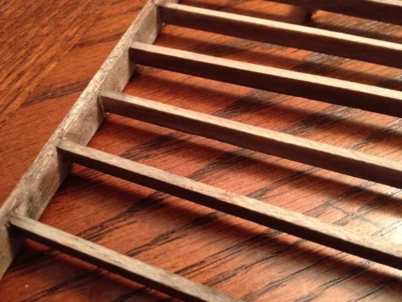

To age the wood I mixed black and white craft paint to make light gray. Then I thinned it a lot. I wiped the paint on the wood with a sponge, or paper towel or etc. and let it dry. I wanted each piece to look unique. This made the wood look aged. Then I uses variouis shades of black, charcoal and brown pastel chalk to dirty it up some more.
52FBBBB9-4D39-4267-BDC9-6B2FB4DB48DC-295

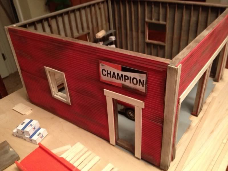

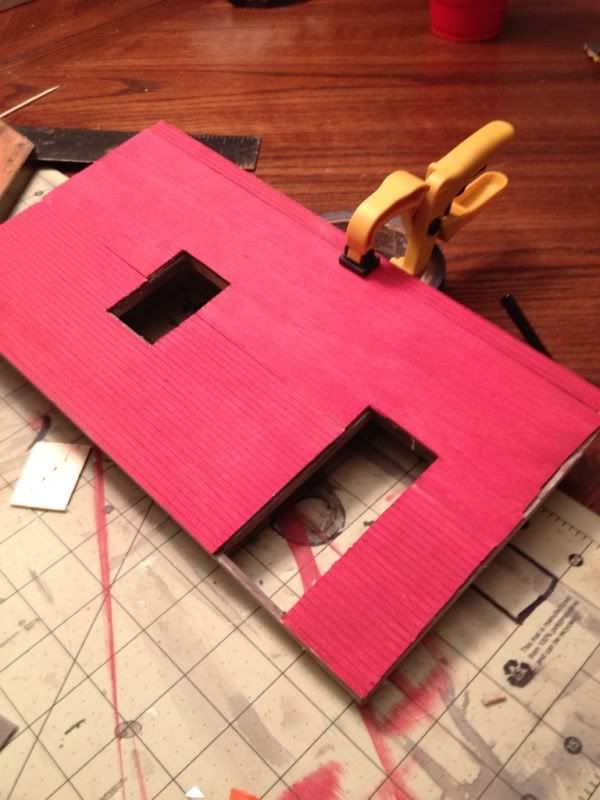

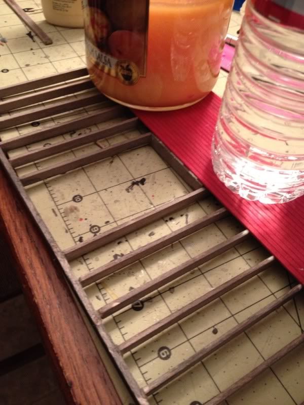

I bought basswood siding from Urecht supply and aged the inside, while painting the outside with flat red thinned craft paint. THen I glues it on the framing with wood glue. Candles for weight :)
03EA1B5E-5591-4988-A380-F3AD8F008310-158
0DCD996E-B9FA-4E7E-B2CC-C668C804C99D-295

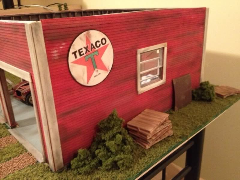

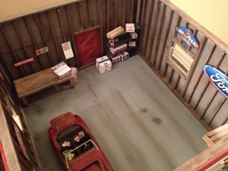

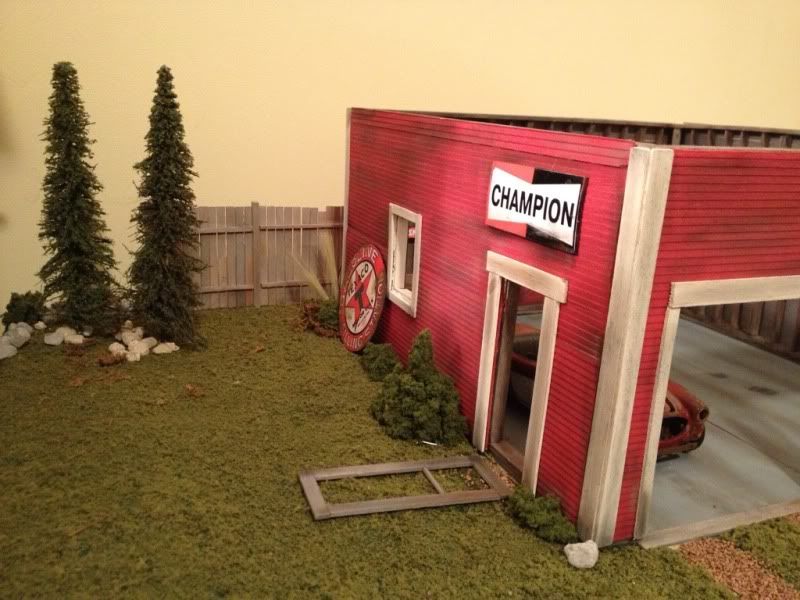

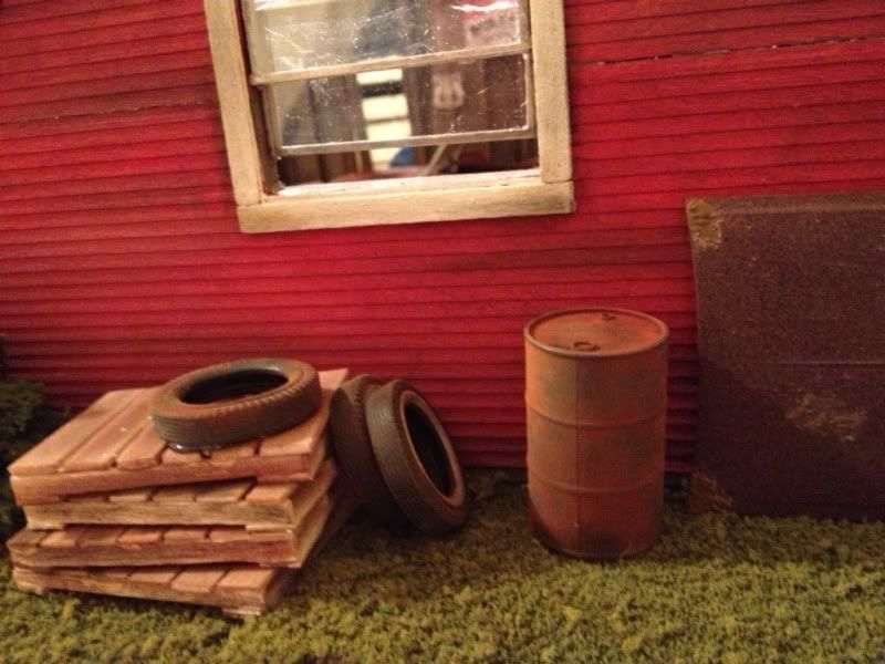

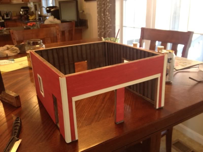

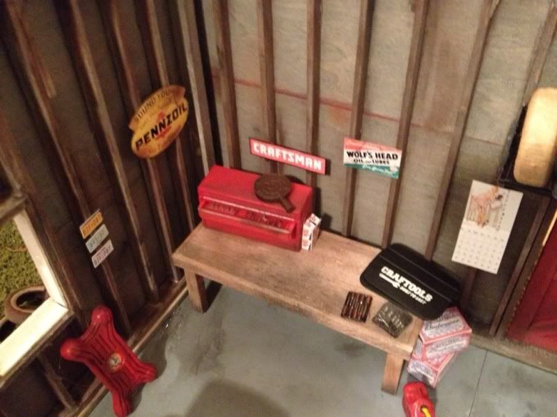

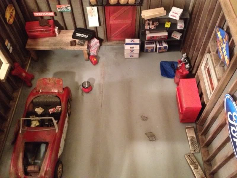

This is siting on the wooden base. I used charcoal pastel chalk to dirt up the outside of the garage. Most of the weathering on this project is from pastel chalk. I also started making boxes and other bits to put around the garage,
