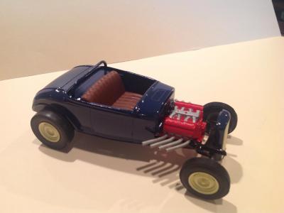

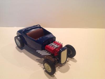

Couldn't make the 40 Ford hood fit to my liking,sooooo, I went more conventional. Here's where I'm at today. 50s modified roadster. Model Master Acryl Blue Angel Blue and Phoenician yellow, wheels and grill insert. Chrome was really worn on this build up so I decided to use color. It's getting close to being finished. Comments always welcome.
