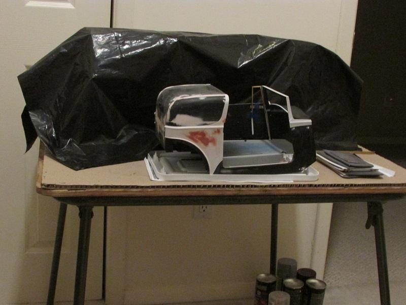

Cato Posted December 31, 2015 Author Posted December 31, 2015 A little rehab... Slowly over the last couple of days I got back to doing small things. Boy it feels great when working but I pay a price after... I started slowly with a masking project on the rear body work. No rush, so I took a day for that. As the temps warmed to the 50F, I shot two build primer coats and one mist guide coat in black then an overnight dry. This in an effort to perfect the sweep panels and get them flat. The roof will remain masked so that the fabric covering bonds to raw plastic and not paint. That's quite a way off. Sanding tomorrow to get flat and find any low spots. Getting crazy, I tackled a nit pick job of perfecting the windshield opening to match the brass frame. I cut thin strips of .030, .020 and .005 styrene to build the curvature at the bottom center. A little sanding and back and forth fittings blends them into a gradual curve. The frame is a now a press fit snug but when painted, I will relieve the paint build-up and make it a light press fit. A smear of Bondo may be needed across the front edge - will see when I get some primer on that area. Sure feels good to get back to the bench...
