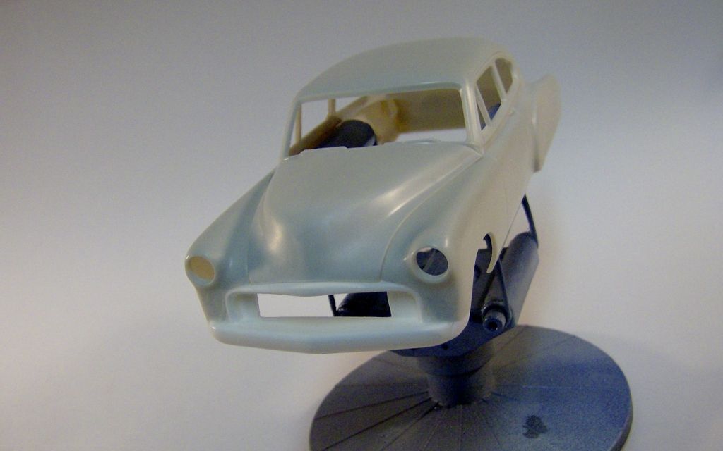

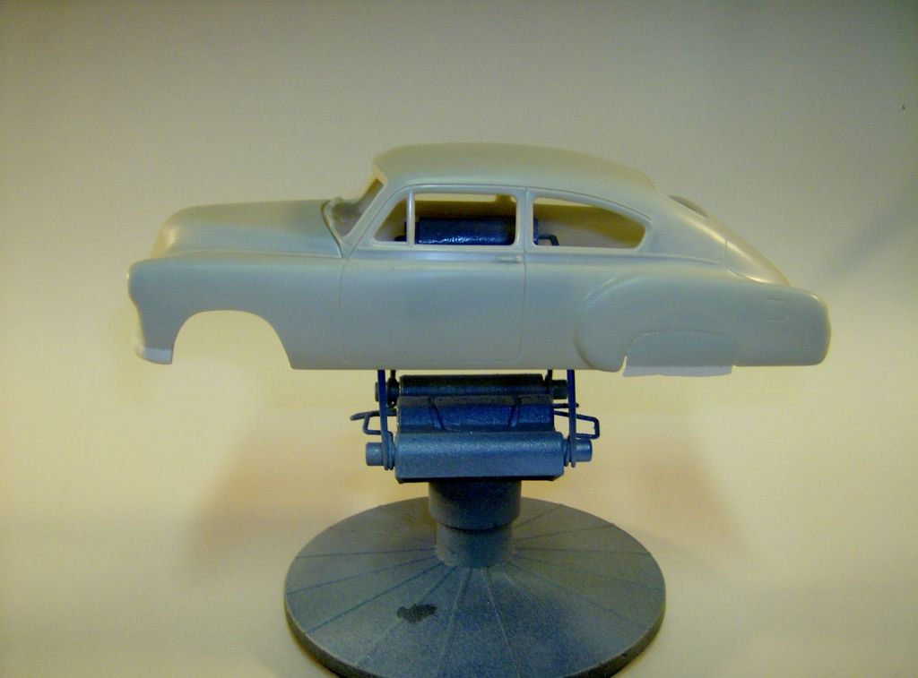

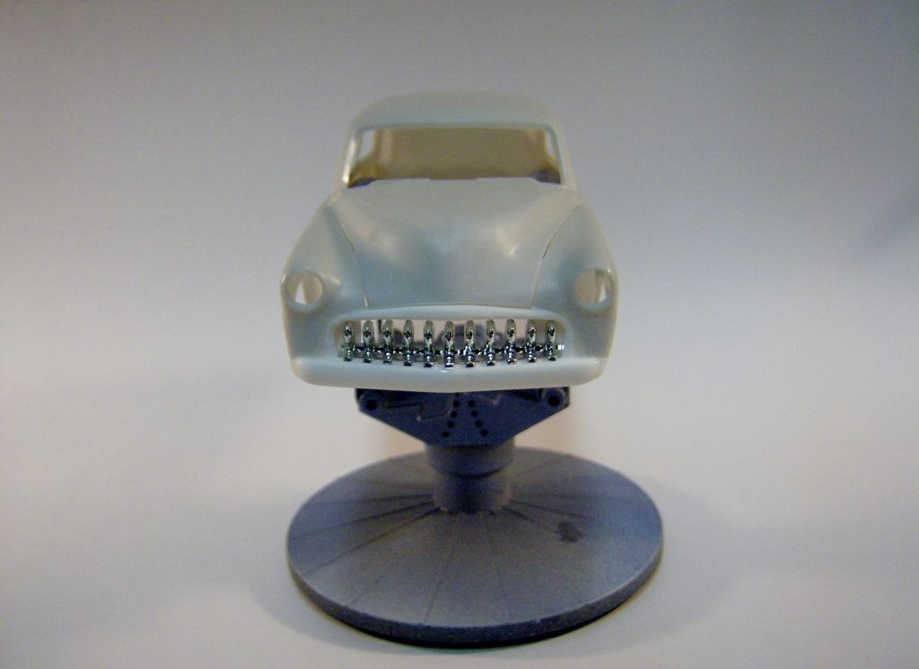

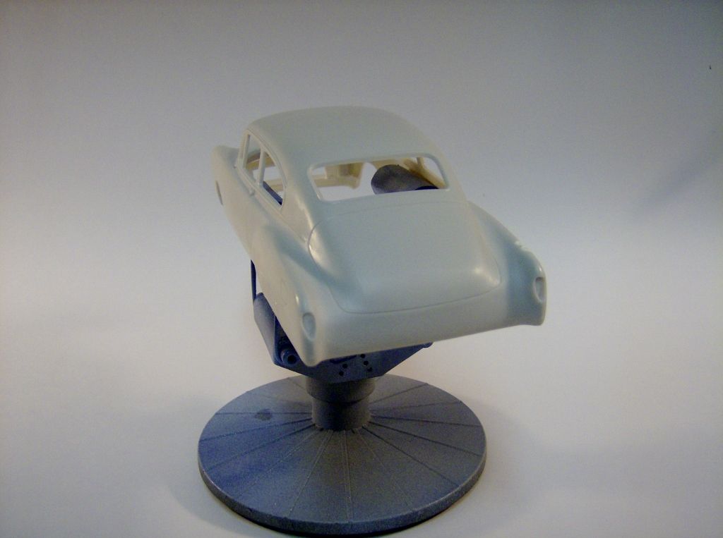

Ramfins59 Posted March 28, 2014 Posted March 28, 2014 I've had this itch to do a full-on Custom, so while I was waiting for primer and paint to dry on the '59 Plymouth model, I started on this '51 Chevy Fleetline. I had sanded off the hood, trunk and side chrome along with all the mold lines some time ago which gave me a good head start on this project. I attached a custom front grille surround and rolled pan piece from the '50 Ford Convertible kit along with the rear rolled pan piece from the Fleetline kit. They are attached with liquid cement and any gaps were filled with CA glue and all was filed and sanded smooth. The windshield center post was removed. I carved out recesses in the rear fenders for aluminum teardrop taillight bezels that I got some time ago from Bob Dudek. Next I drilled 2 holes in the top of the passenger side rear fender and glued in 2 short lengths of plastic tubing again using liquid cement. These are for recessed or sunken antennas. I sanded them smooth with the top of the fender and again filled in any gaps with CA glue and sanded ot all smooth. I added thin strips of plastic to the front lip of the hood and to the rear driver's side corner of the hood using liquid cement to fill in some gaps and sanded it all smooth. The white strips of plastic you see at the bottom of the flush mounted skirts are to extend the skirts completely down to the bottom of the rear fenders, They will be sanded smooth with the skirts and even with the bottom of the fenders once the liquid cement completely dries. The grille insert will be the '53 DeSoto tooth piece from the Revell '49 Merc kit. For a color I'm thinking Duplicolor Navy Blue and possibly some White pinstriping. For wheels I know I'll go with wide whitewalls but I'm trying to choose between spinner hubcaps (my favorite) or chrome reversed wheels, or maybe Caddy Sombrero caps. I've got a long way to go on this buildup. I haven't touched the engine (I think I'll go with a fully dressed straight six), the chassis or the interior yet. I thank you for looking in on this Custom buildup. Further progress will be "reported" as it happens. Any and all comments are welcomed and appreciated.
Joker Posted March 28, 2014 Posted March 28, 2014 Whodathought ! Combine a '51 Chevy with a '50 Ford grill surround... sprinkle some '53 DeSoto teeth.... instant custom grill. Subscribed... Sure wish Mr. Dudek still marketed the teardrop tail lites.

Ramfins59 Posted March 28, 2014 Author Posted March 28, 2014 Thanks a lot guys. James, I also wish that Bob Dudek had LOTS more of the parts that he made, but he no longer has access to a CNC machine to make the parts. I'll also be using a set of aluminum "frenched" headlight bezels that he originally made for the Revell chopped '49 Merc kit...... they fit this car like a glove.......and...... I have one last set of his gorgeous Lake Pipes to use on this car too. The front end of the Chevy needed some trimming to get the grille surround/rolled pan piece to fit in. It wasn't just a "drop in fit". Mark, the Sombrero caps would probably look pretty good. My "personal" all-time favorite hubcap on a Custom is a '59 Dodge Royal Lancer 4 bar spinner. To my taste, it is the "ultimate" spinner hubcap. I've already used it on several models so maybe......just maybe...... I'll change this time around.

Ramfins59 Posted March 28, 2014 Author Posted March 28, 2014 (edited) Thanks Carl. To get the grille shell piece to fit I first trimmed off about 1/4 inch of plastic at the bottom front of the wheelwell opening for the wraparound part of the rolled pan to seat properly and I added some pieces of sheet plastic to widen the outside edges with liquid cement and CA glue and sanded it all smooth following the curve of the pan. I also had to enlarge the grille opening for the grille surround to "set into" the front end rather than sticking out too far. . Edited March 28, 2014 by Ramfins59
