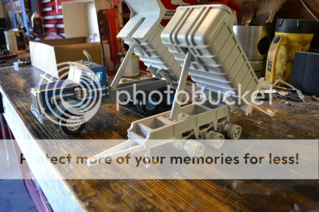

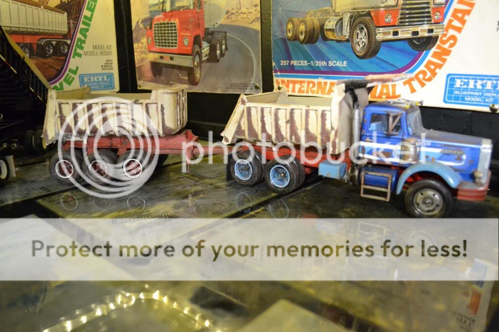

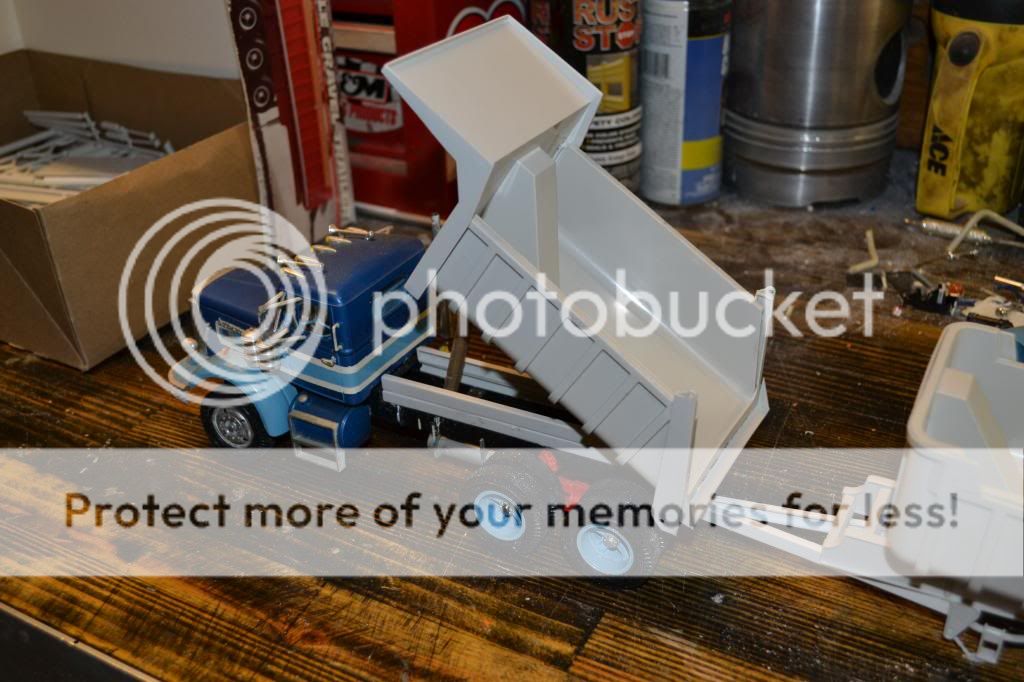

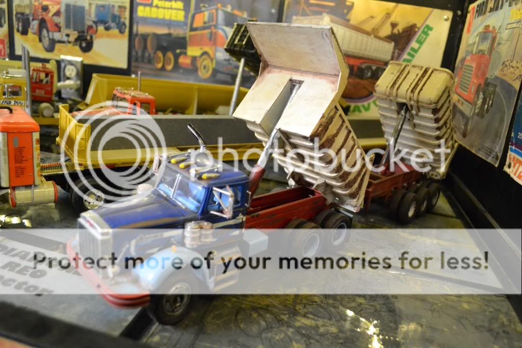

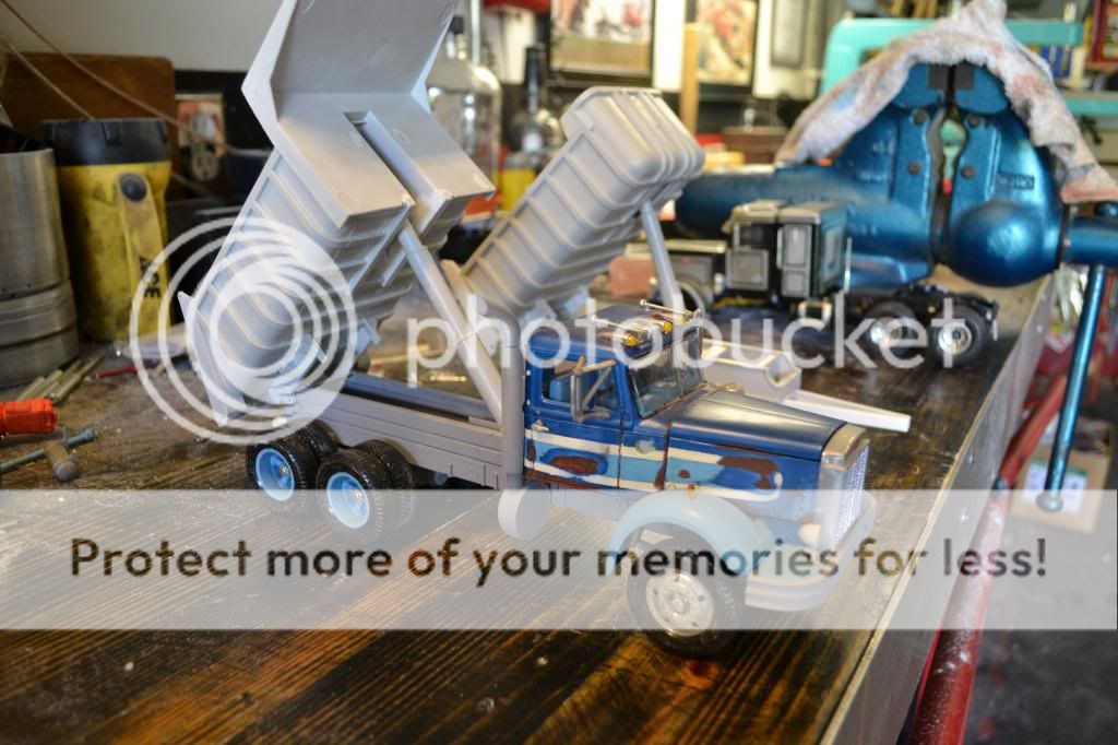

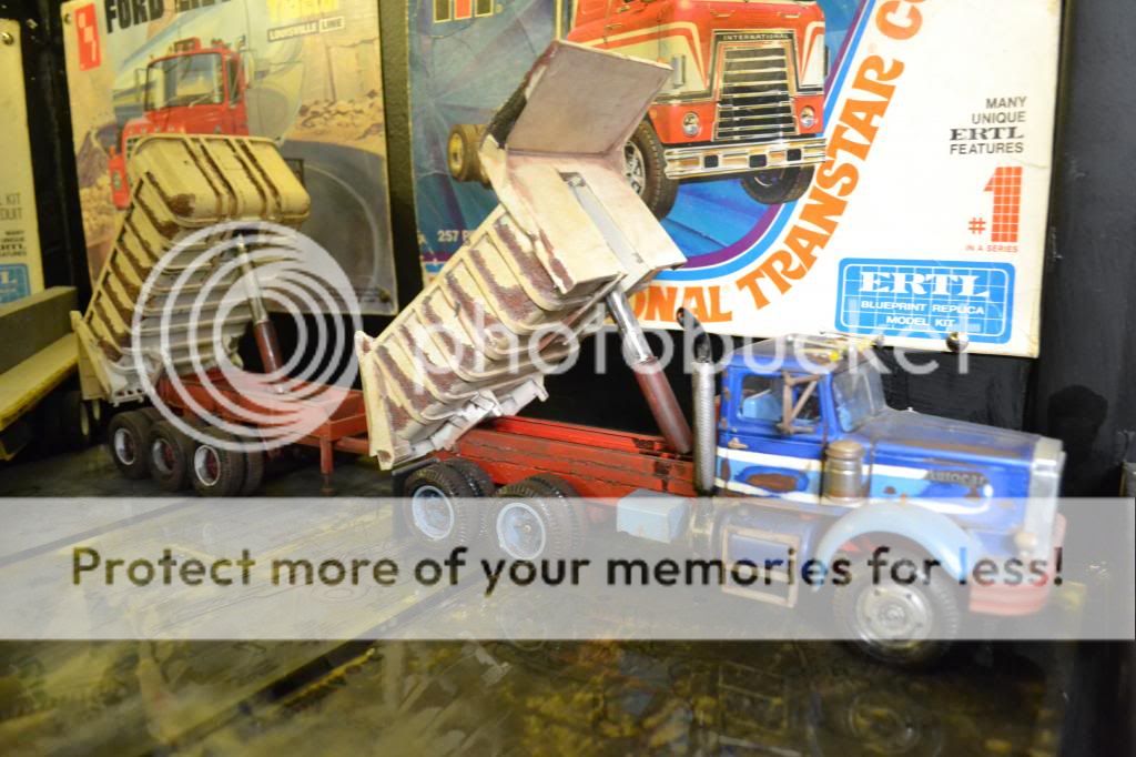

Superpeterbilt Posted April 9, 2014 Posted April 9, 2014 First off, its not the kit you were expecting. Its the A64B kit with a dump body added. Ive been wanting to do this with a dump trailer kit for years. This was another built up kit. It looked good when I bought it, but when I recieved it the paint wasnt as nice as I though. So I decided to rust it up. I rebuilt the chassis, moved the axles back a little, added a resin stack from AITM, painted the chassis red, and added the dump body. I built the tag-a-long with what was left of the trailer. I applied heat and bent and dented up the bodies and glued some sand to them to simulate heavy rust.Thats pretty much it!

Superpeterbilt Posted May 20, 2014 Author Posted May 20, 2014 That weathering job is sick, woooow. I have two of the trailers waiting to do something similar, you might have just moved them up the ladder. awesome Thanks for the inspiration. cheers Ewan Glad I could help. This was the first time I attempted to pull this off. To give a brief rundown, the bodies were heated(with my heat gun on low), then poked with a flathead screwdriver, primered, then painted white. I spread some glue in the areas that I wanted heavy rust, and spread sand in to the glue. Rustoleum makes two shades of rusty metal primer,that looks just like rusty metal. Coincidence? Using the darker primer on the sand then shading with the light primer on the tips of the sand. Then I misted the whole body with tan. I used the same primer thinned down to rust parts of the truck.I used thinned black for oil leaks on the Hyd cylinders,wheel hubs, and fuel tanks.Hope that helps.
