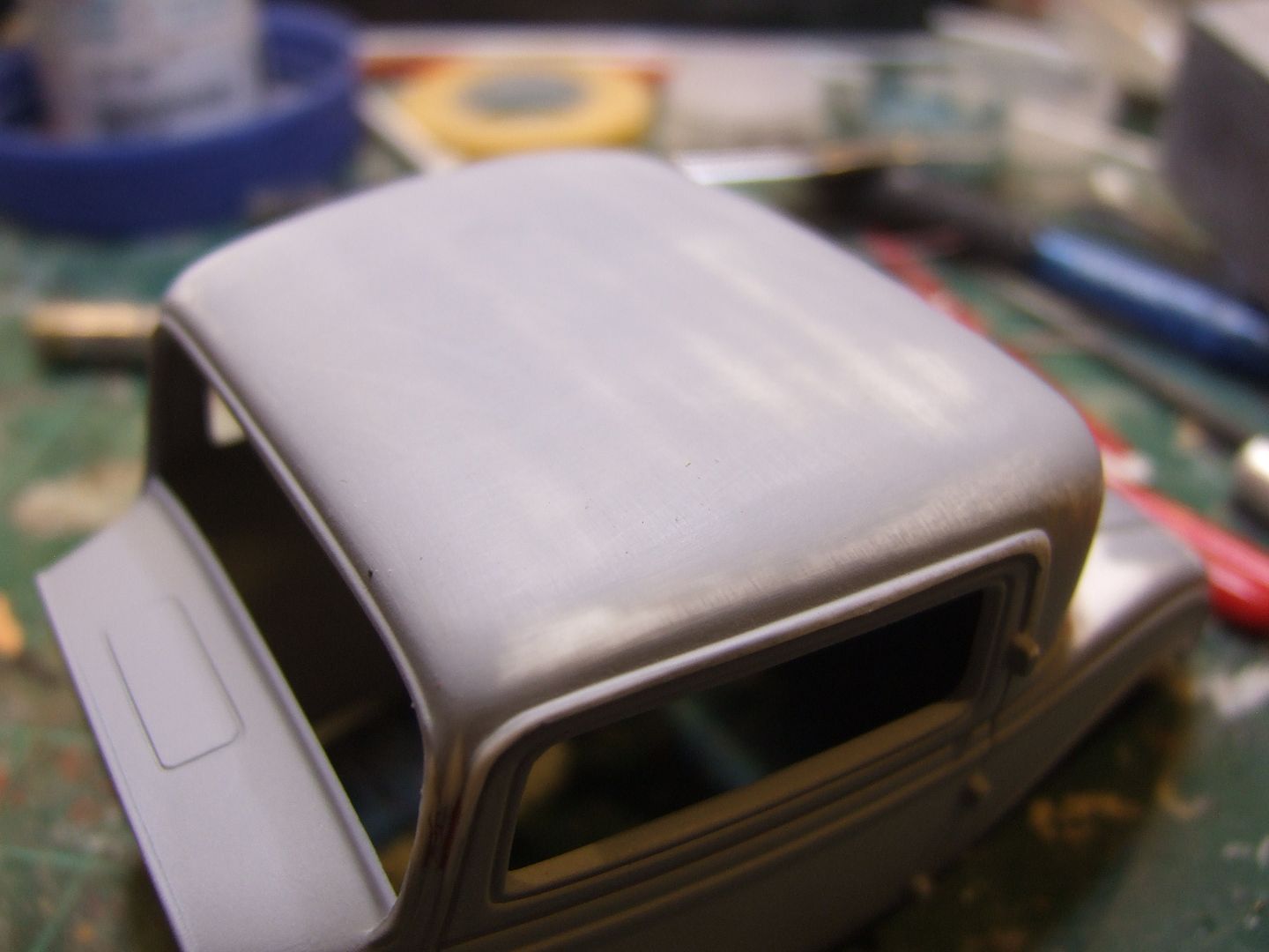

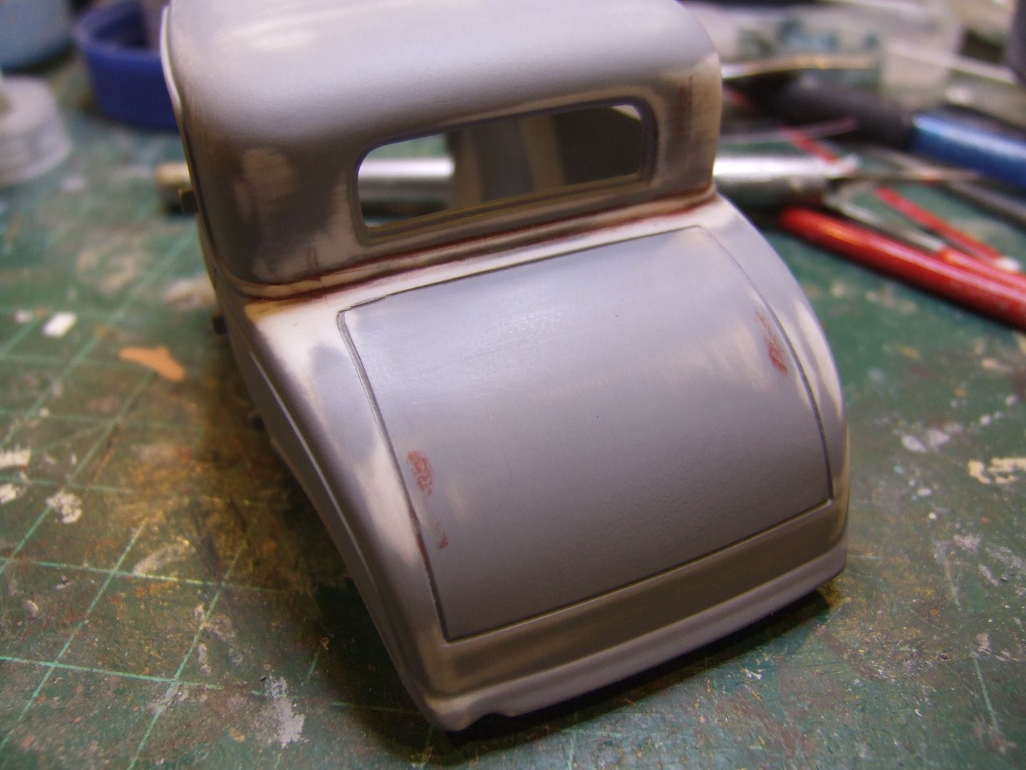

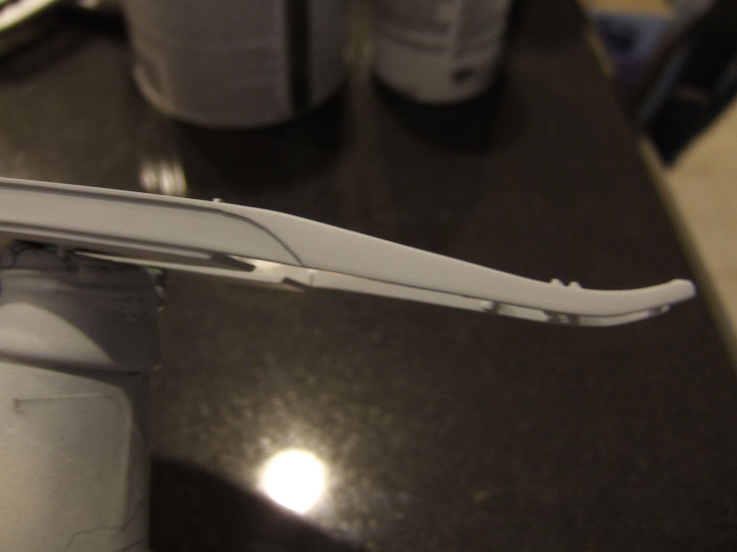

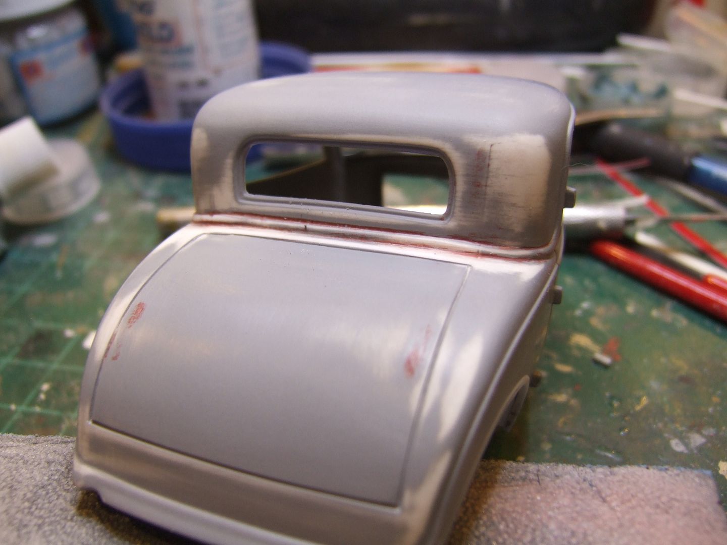

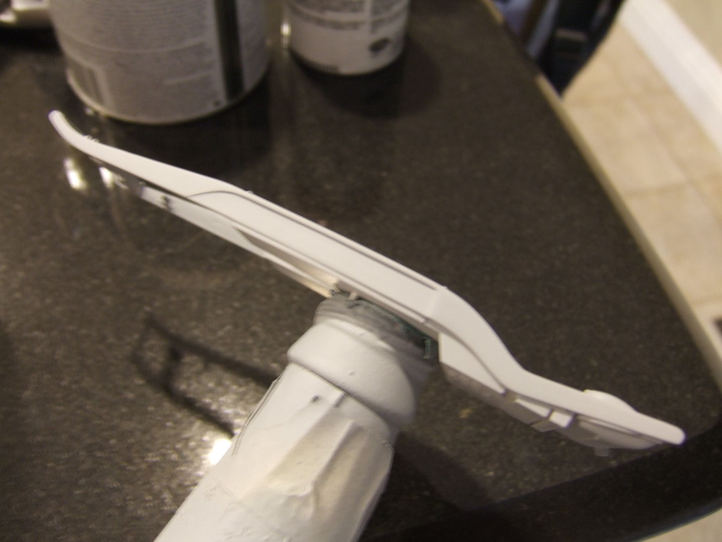

The rear deck was quite a chore.
It took three attempts to achieve this, the final sanding. The roof was a bit wavy as well.

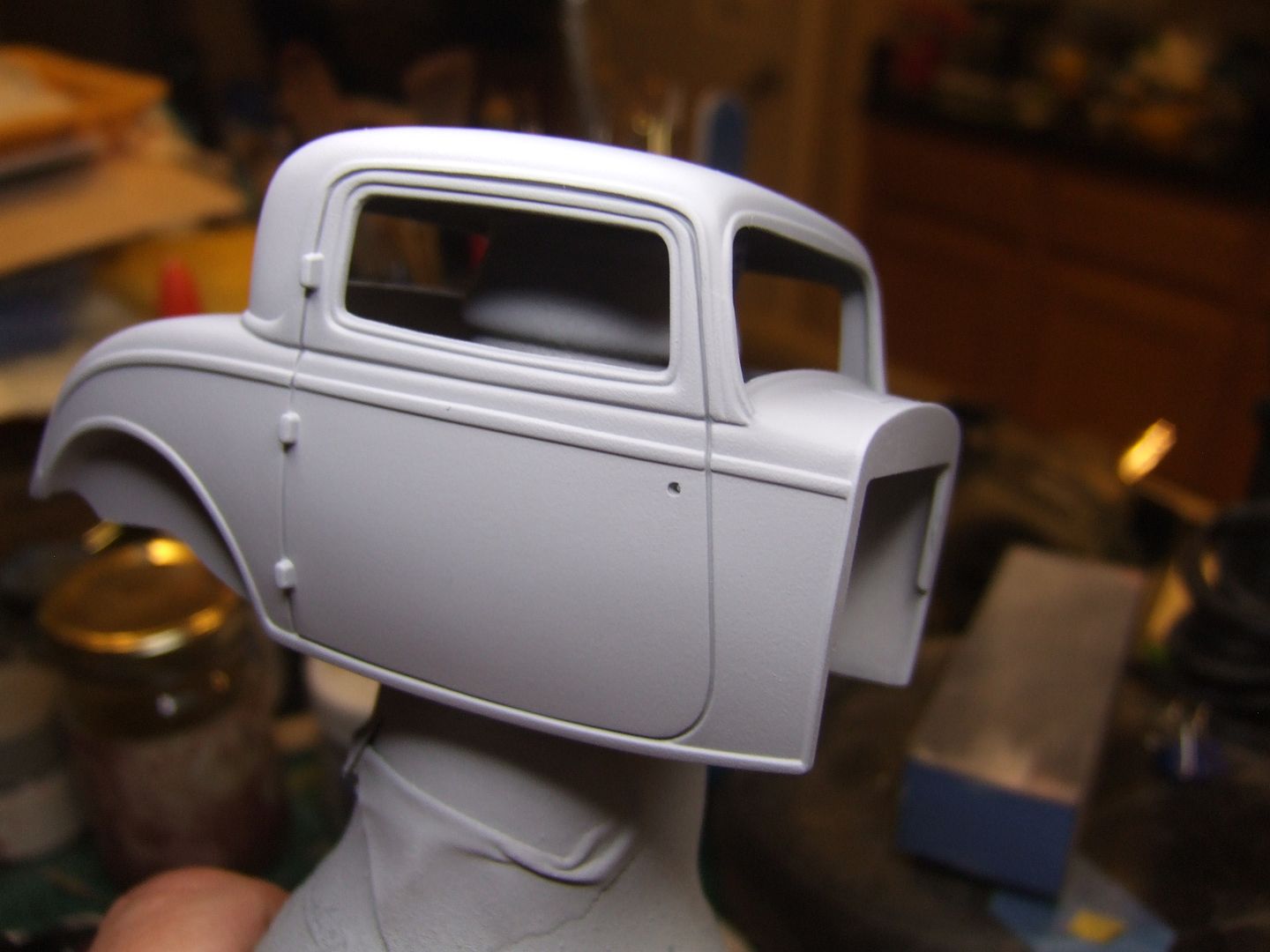

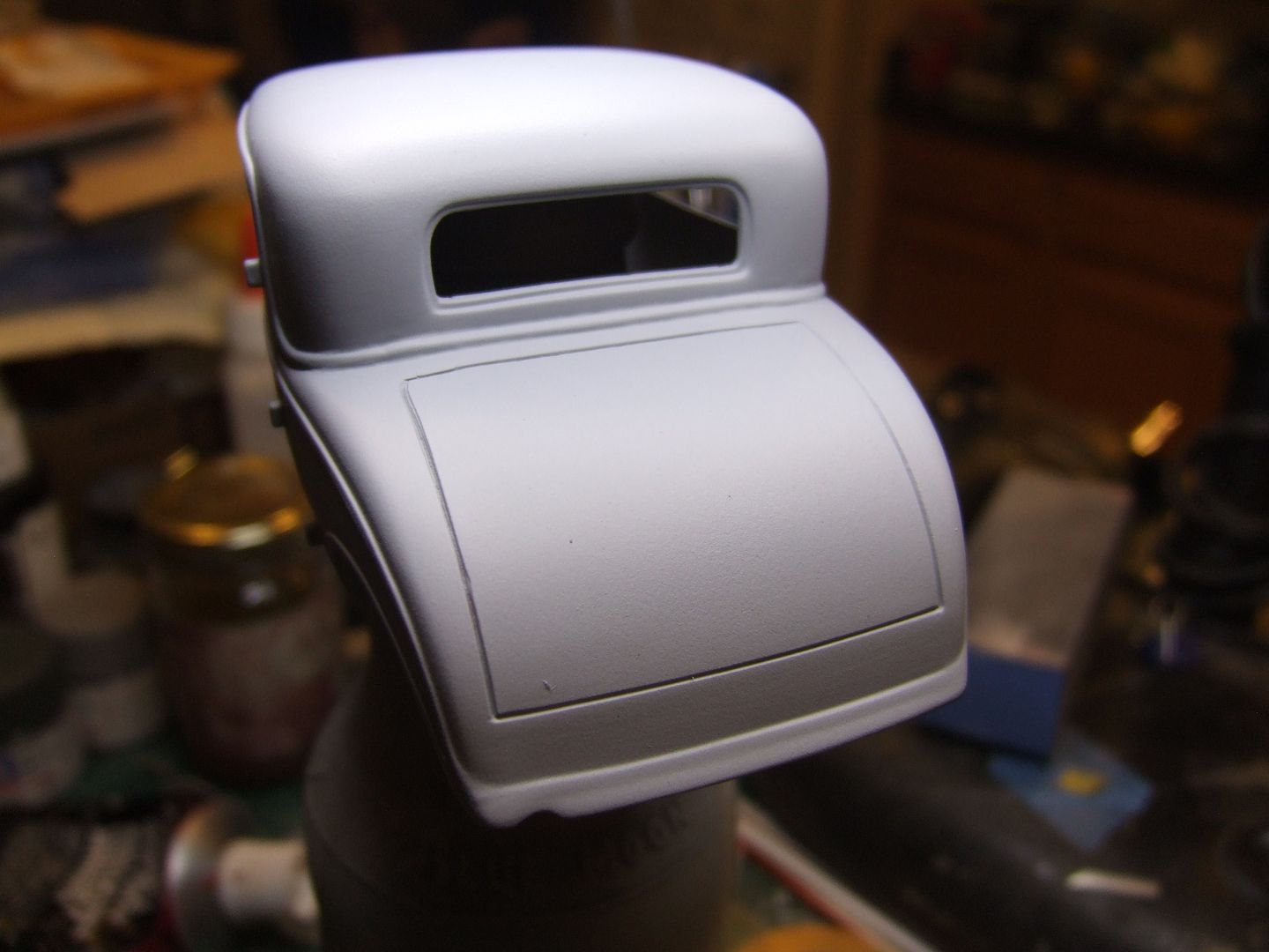

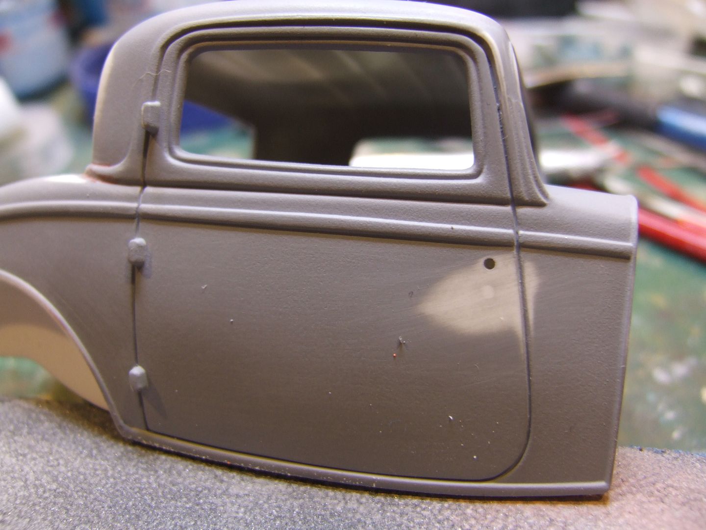

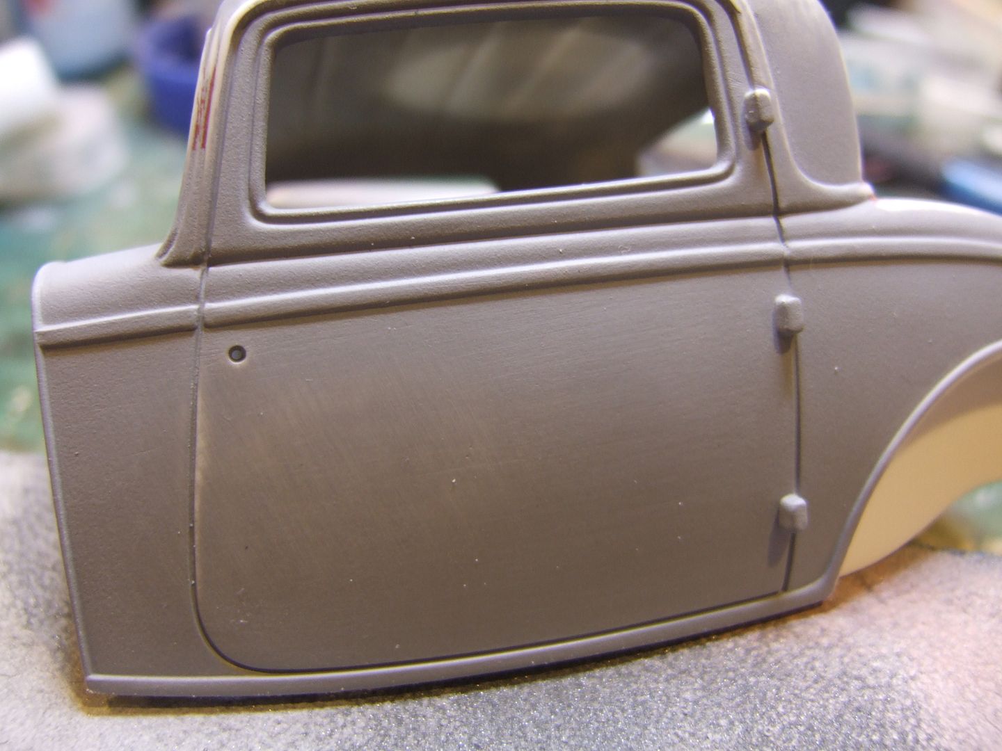

I was inspecting the body and realized there was a lock button on only one side. So off it came.
The driver's side was ok.
Smooth as a baby's behind now.
Lotsa elbow grease on one small part.

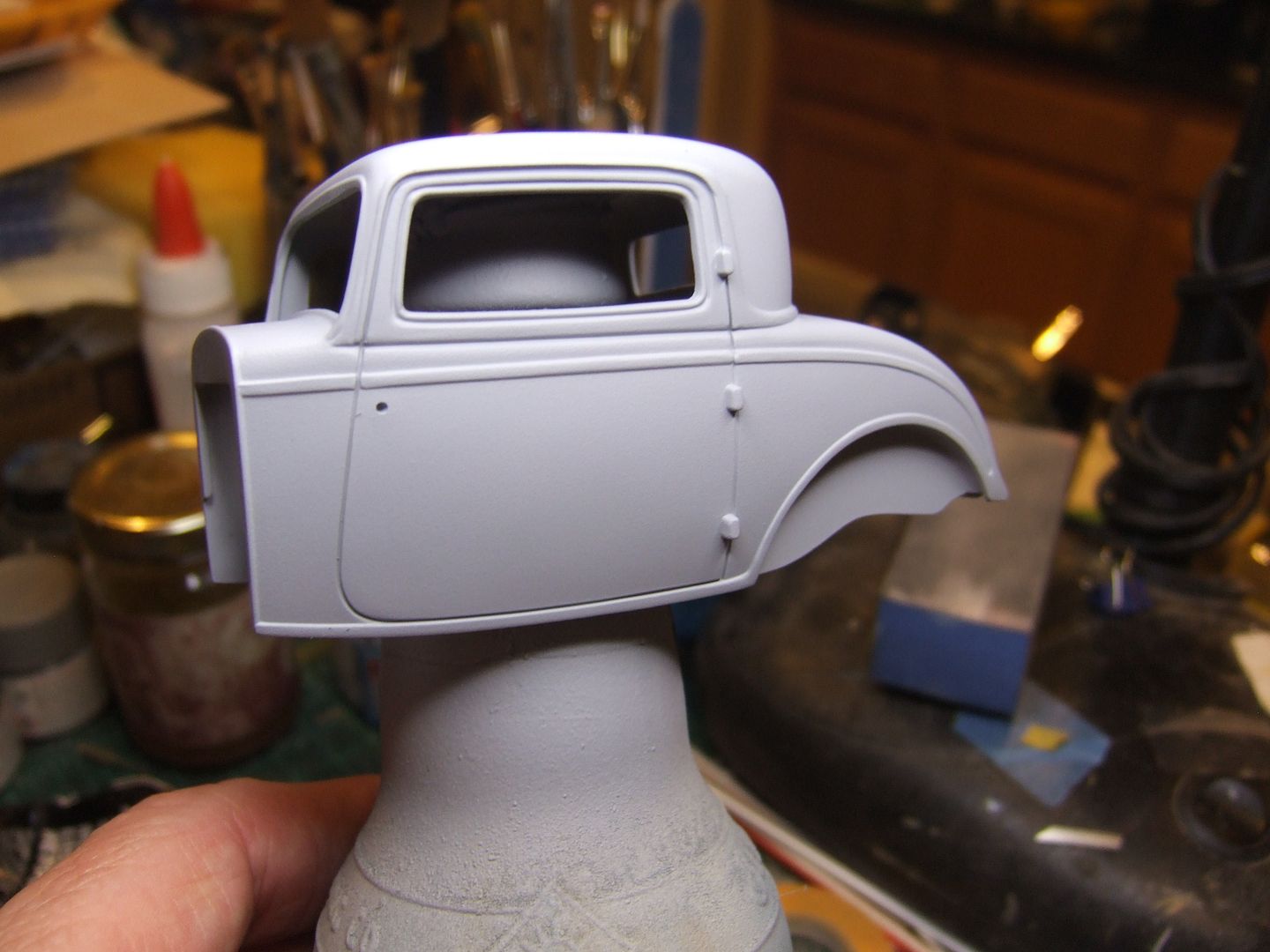

Ok I have sloughed off for a week now so it's time for some progress pics.

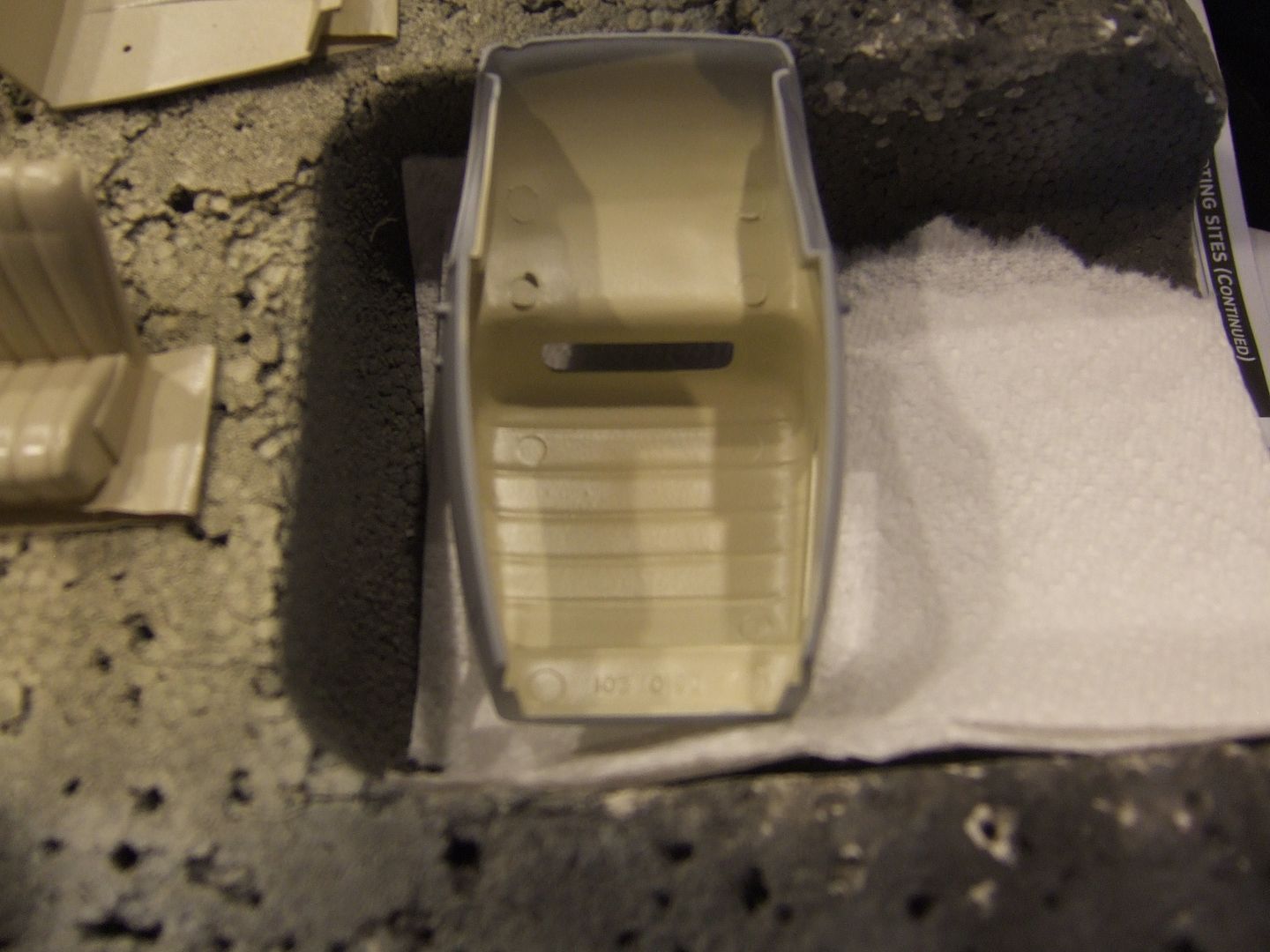

Here's the frame after final sanding and priming.
Smooth as silk now.

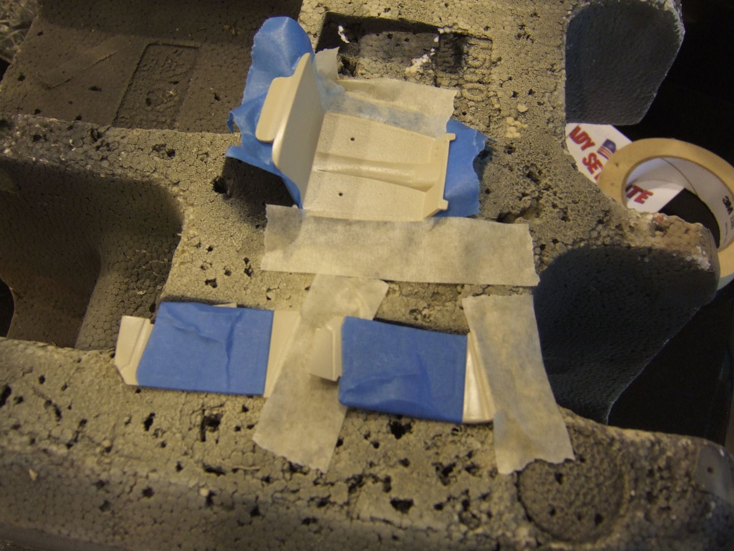

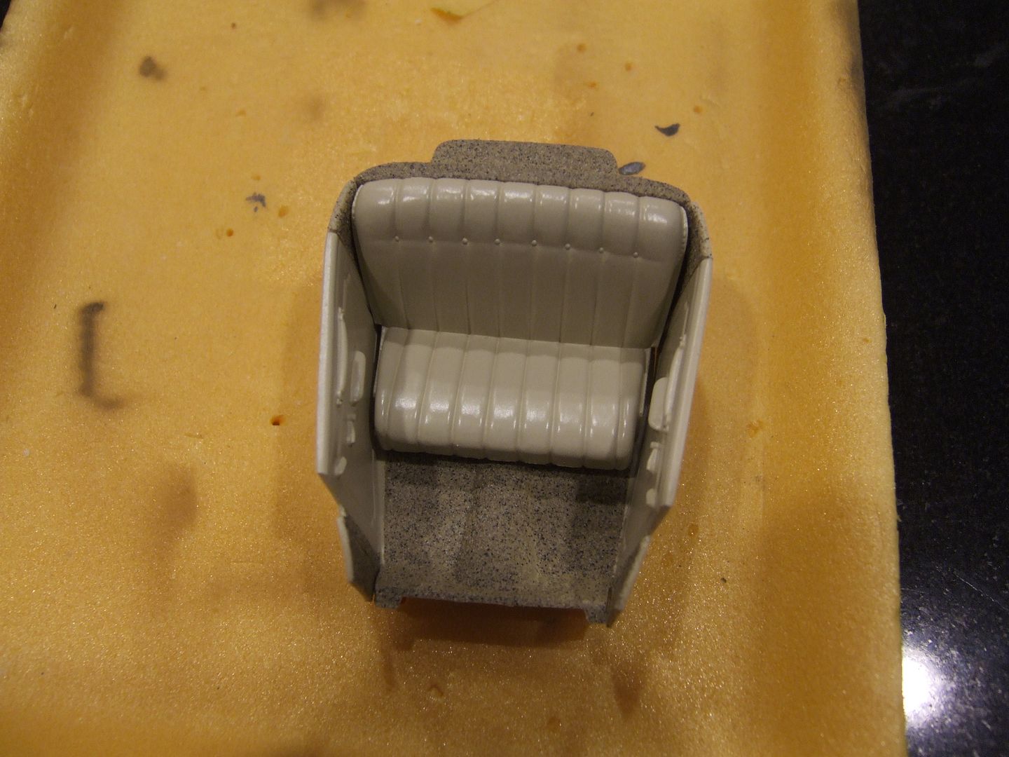

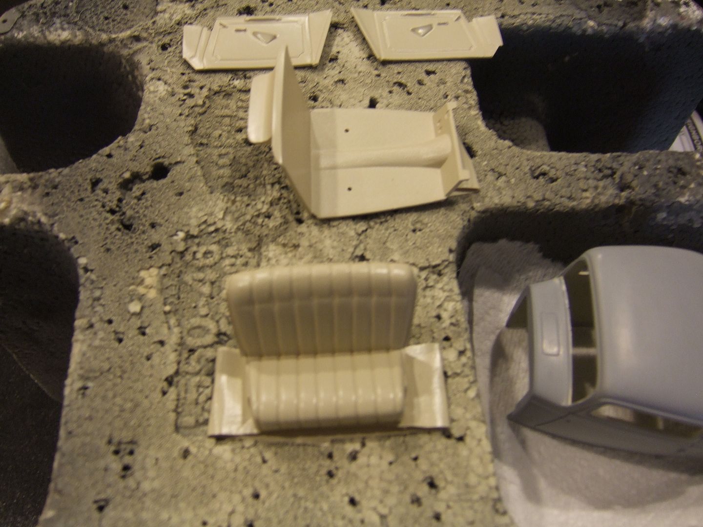

Thought the interior needed some color so after a white primer, Krylon Satin Almond.
Can any one guess what's next?

WAYNE ,the reason for the lock button only on the passengers side is people use to get in and out on that side when parked on the street so you did not get hit or lose a door ,
nice job so far ,i,ll be watching ,
I had an idea it may have been something like that after I sanded it off. I just might look in my PE spares for something to add after the paint is buffed.
Thanks Jonathan!

I used that shade of almond (older American Accents satin, not the textured paint) for the interior on my stock '32 Model B roadster. It's a nice color, and a good choice, I think. The real open '32s had that, and I suspect a lot of the closed cars did, too.

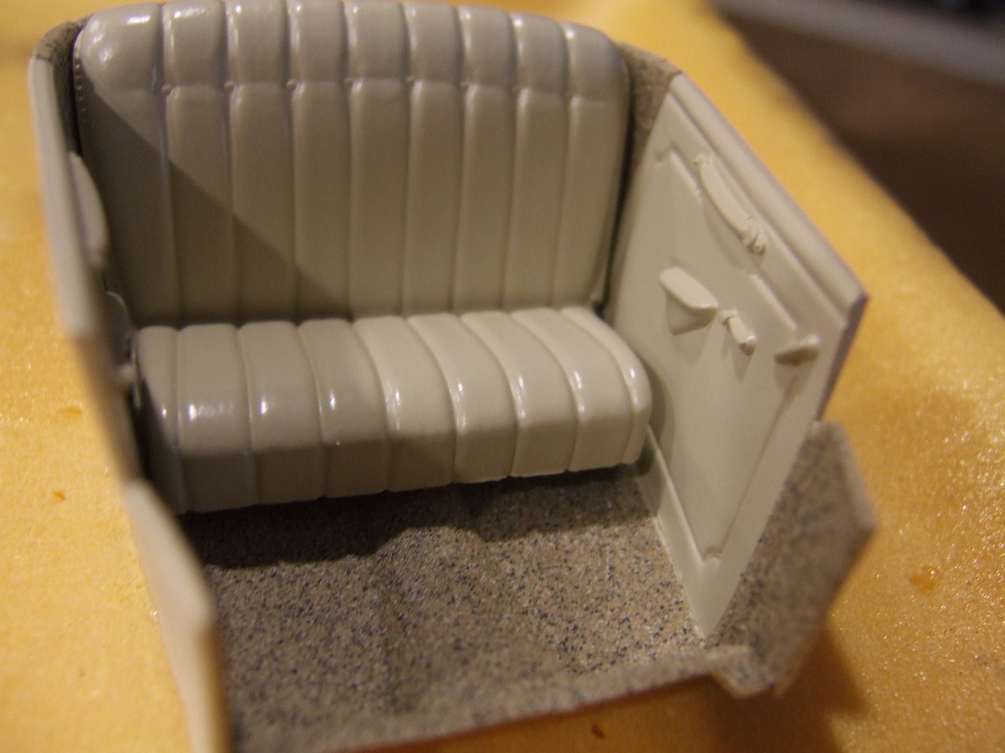

Carl, That textured paint has become a staple in the armor community to replicate the non skid finish on most modern tanks. I spray it on the hull then paint over it with the tank's base color. It's a bit too fine and regular for replicating cast texture, but with this color on hand I couldn't resist using it for carpet.
Anyway here we go.
The parts are just press fit for now but you get the idea.

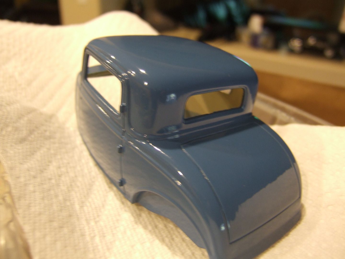

Color you ask? Here's a teaser.
G
Link to comment
Thank you all!
That's Krylon "Global Blue" straight from the rattlecan. I bought it for another project, found it to be too light, so I used it here.
It sanded and polished out very well. Cured rapidly too, however I believe the 100+ temps and bright sunlight helped. :)

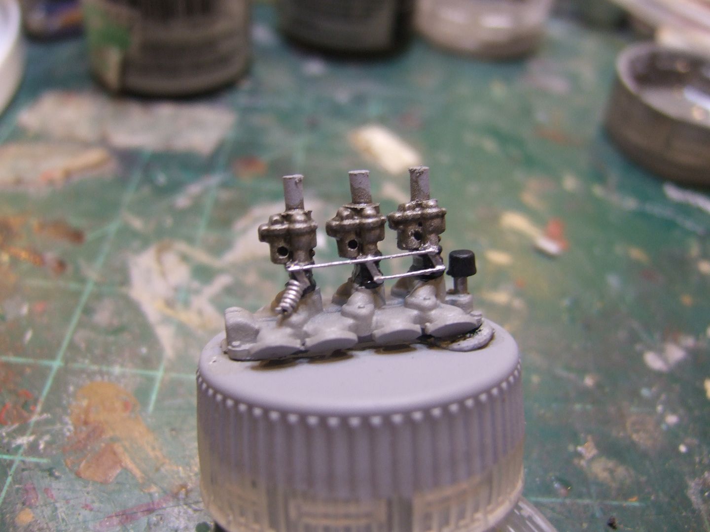

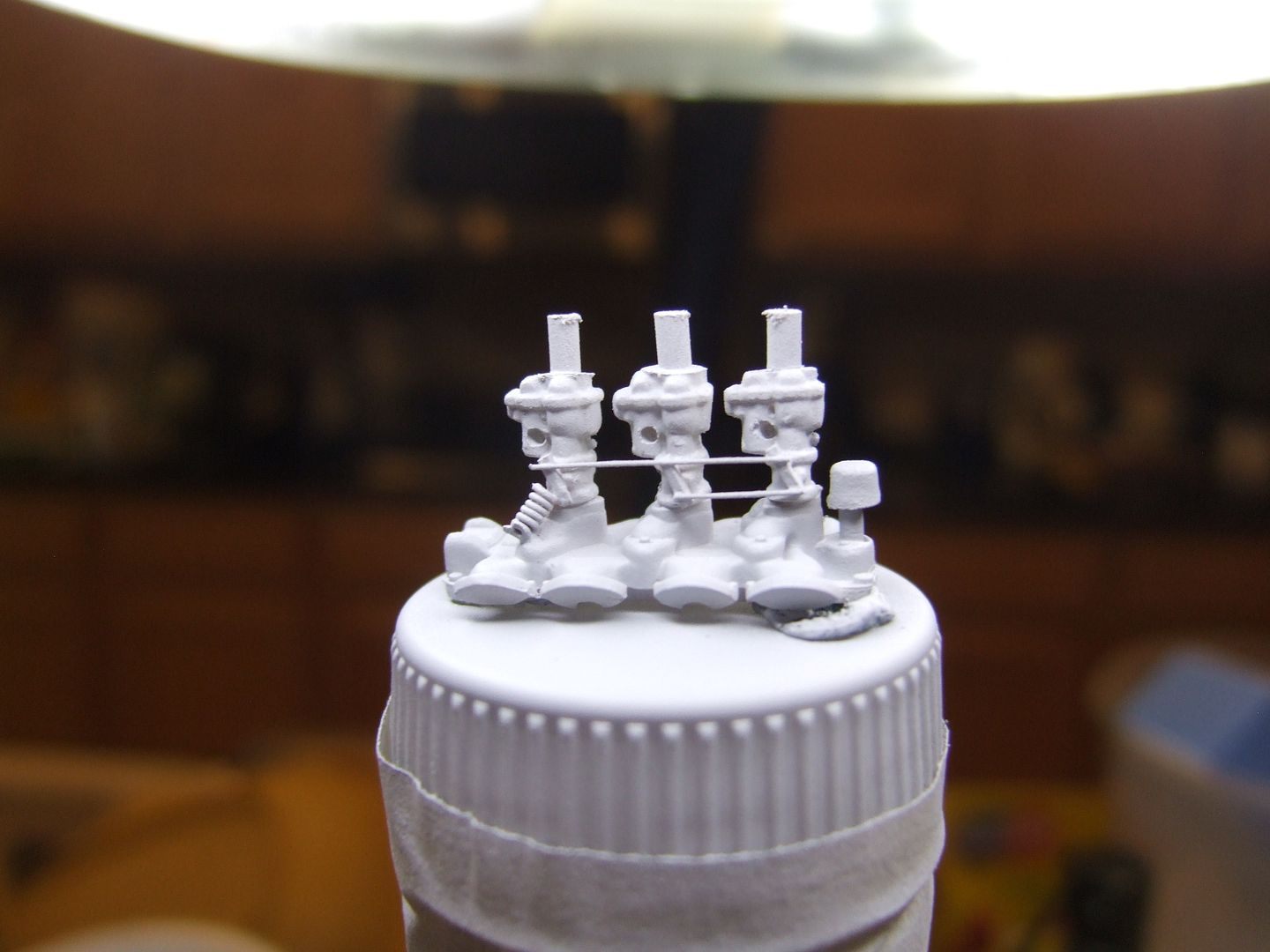

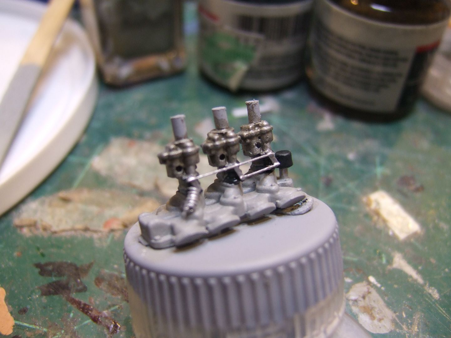

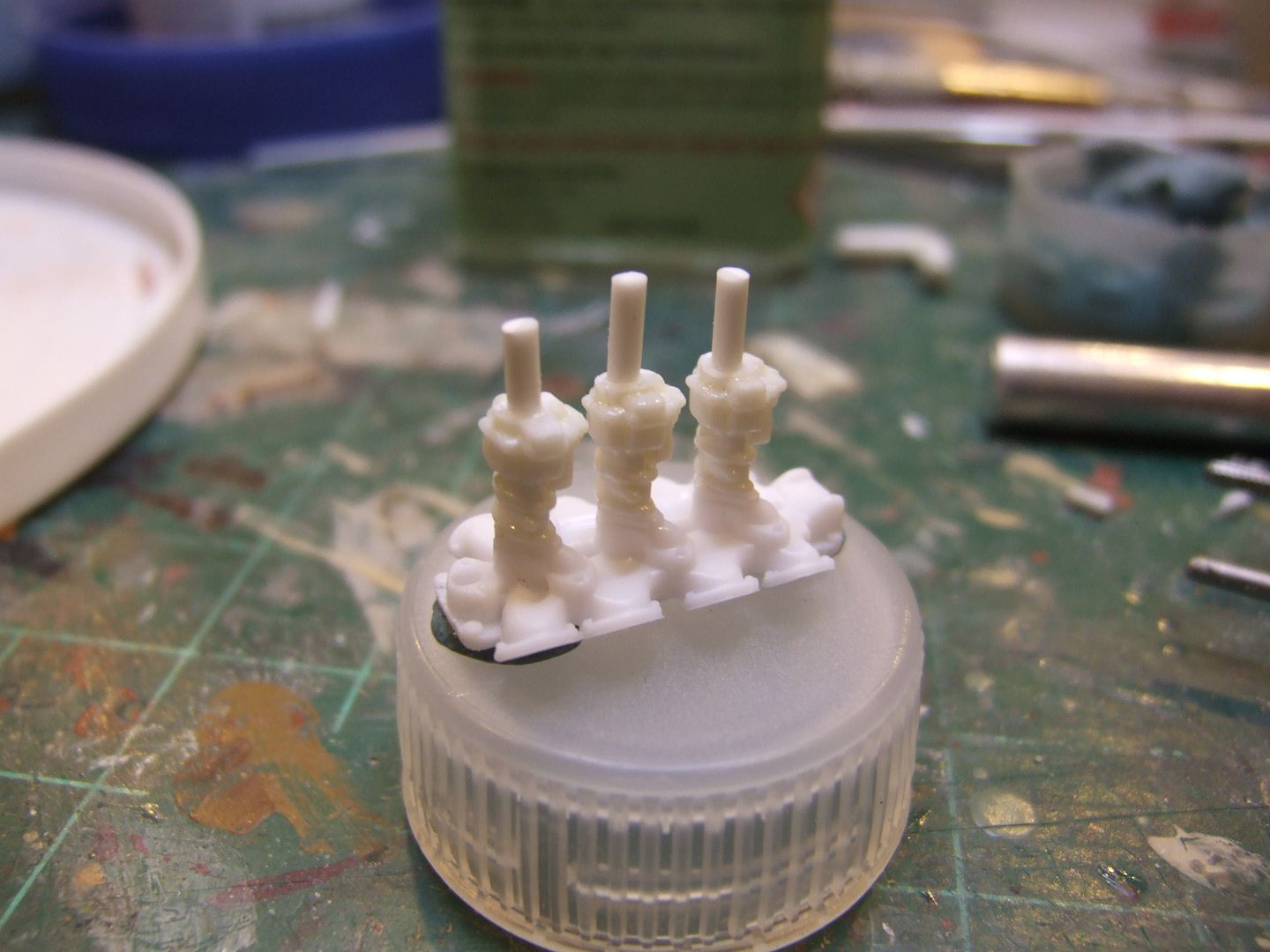

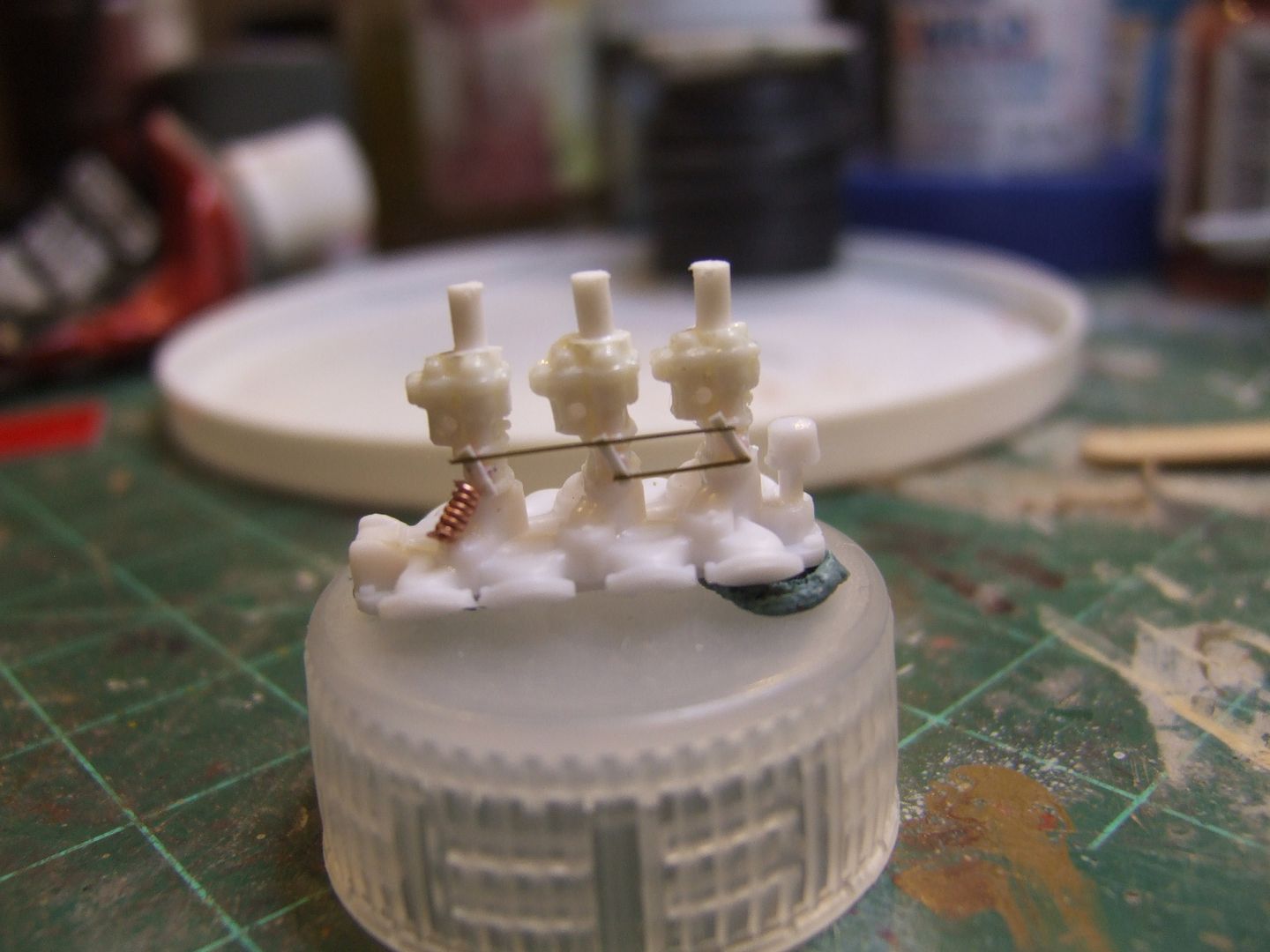

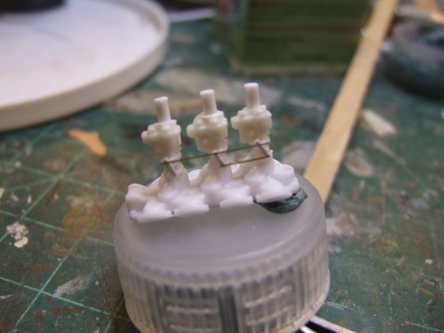

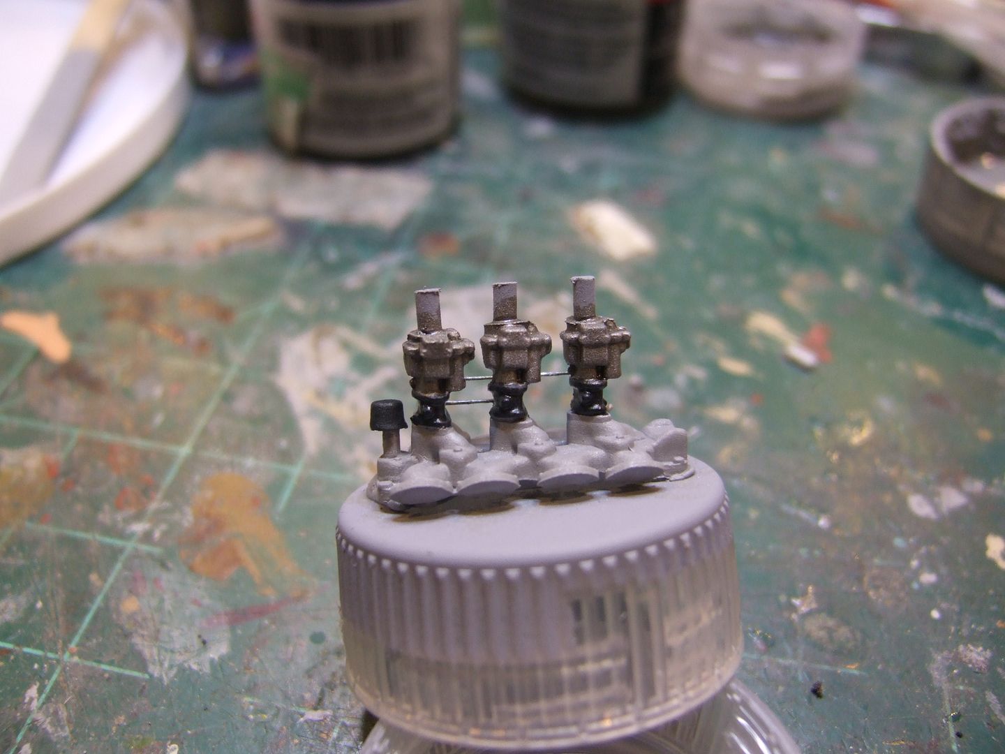

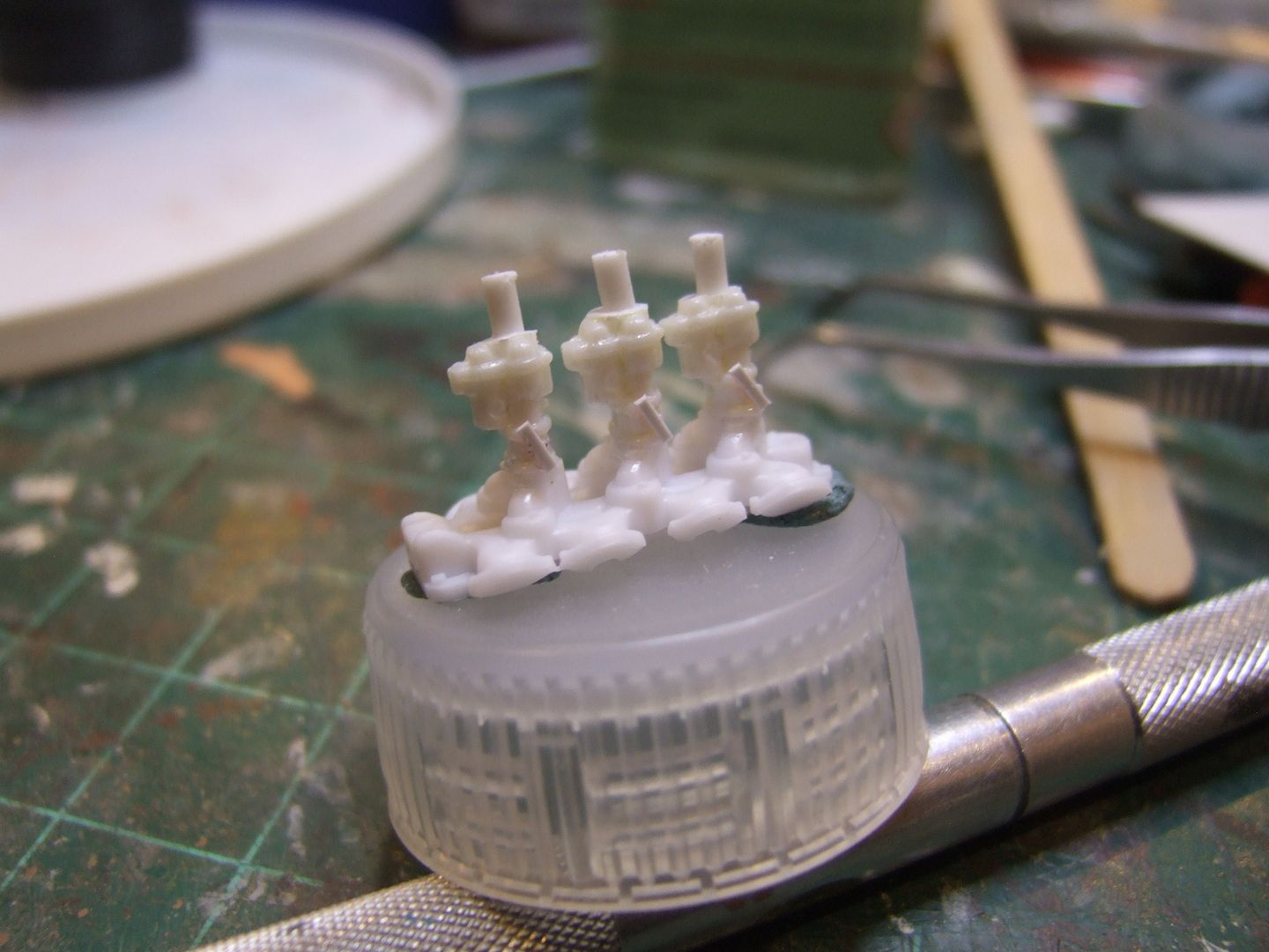

Well I had the morning to myself so I worked on the intake system. The kit provided three fairly well molded Stromberg 97s. Trouble was the intake stacks were solid, and they were chromed.. So I stripped the chrome, cut off the stacks, filed the tops down and added some rod to serve as a mount for three chrome Bell aircleaners from a Revell '49 Mercury kit.
Here, for your viewing pleasure, is todays progress in photos.
Fuel lines will attach where I drilled the holes in the carbs. I will run them back to a fuel distribution point on the firewall as the engine is devoid of the stock fuel pump.
