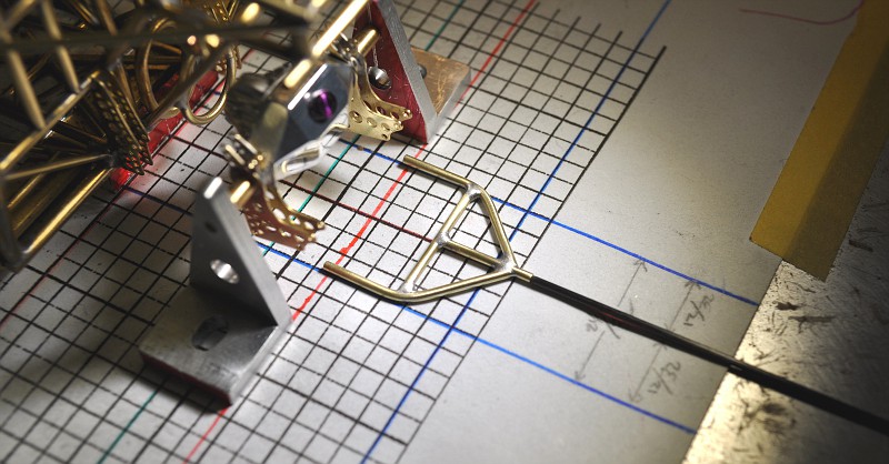

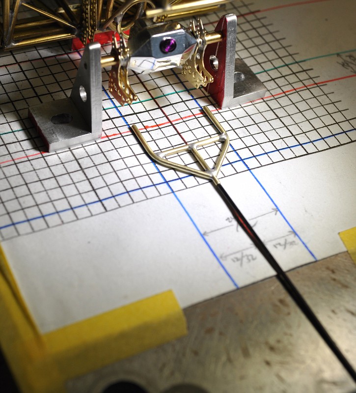

Codi Posted May 28, 2015 Author Share Posted May 28, 2015 Started the wheelie bars. The piece you see respresents a chromoly piece that attaches to the bottom of the axle 4 link brackets. The design is one I saw of a recent pic of the JEGS promod vette. It's triangular and combines carbon fiber and chromoly. I have CF rod on the way (the RC car and plane industry has it) and I'm going to make mine the same. I do have some 3D CF decals that I might apply to the tubes as well but I have to see how thin I can cut them. The tubes will be 1.2mm to replicate the real thing. The housing for the wheelie wheel itself is a modified dirt modeler piece. I'm going to nickel plate that bracket as well as the one in brass that I fabbed in these two pics. I polished the rear end as well in preparation for attaching some nickel brackets from futurattraction. Cheers Quote Link to comment Share on other sites More sharing options...
Nitrozilla Posted May 28, 2015 Share Posted May 28, 2015 Good start on the wheelie bar, but I ... can't ... stop ... staring ... at ... the ... rear ... um, er, ... housing. Quote Link to comment Share on other sites More sharing options...
Petetrucker07 Posted May 28, 2015 Share Posted May 28, 2015 (edited) Excellent work. That polish looks amazing. Lookin forward to seeing the wheelie bar done. Edited May 28, 2015 by Petetrucker07 Quote Link to comment Share on other sites More sharing options...
doomcrew Posted May 28, 2015 Share Posted May 28, 2015 @Codi inspiring stuff as always, love the work on the rear end. @MitchP I put the CF decal on the hat in two halves, and used decal softener on it, so it could conform to the shape. I let the first half dry, then repeated the process, when dry, I trimmed it, then cleared it. Steve Quote Link to comment Share on other sites More sharing options...

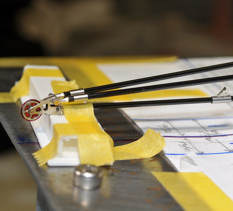

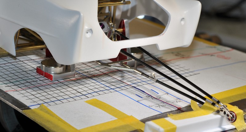

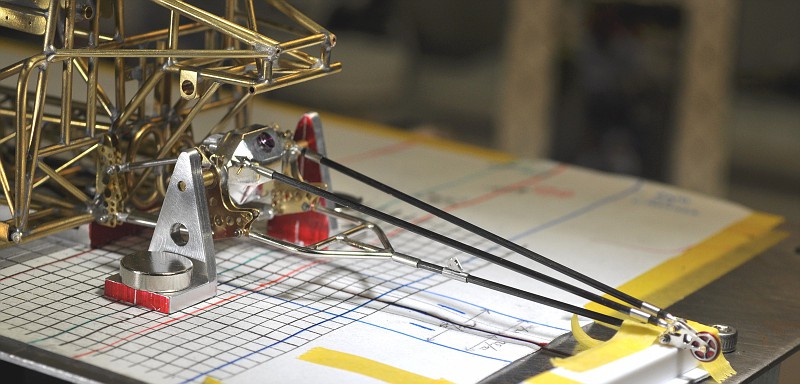

Codi Posted June 4, 2015 Author Share Posted June 4, 2015 One more small horizontal bar to add and some beautiful chrome dirtmodeler brackets and these are done. They're not glued together yet but you'll get the idea. I strongly dislike making wheelie bars btw. This 3 bar unit fought me every which way. It was without a doubt the most aggravating thing I've made to date for this build. And that's saying alot. Thanks for letting me vent a little bit. Cheers, tim Quote Link to comment Share on other sites More sharing options...

Nitrozilla Posted June 4, 2015 Share Posted June 4, 2015 I empathize with you on the bars. I have played with CF rod before and it is a total pain. They look great Tim. What really looks cool is the caster and the wheel you made for it. Top notch man. Any time you want to vent, we're here for you. Quote Link to comment Share on other sites More sharing options...
10thumbs Posted June 4, 2015 Share Posted June 4, 2015 The wheelie bar unit certainly looks frail, and perfect. Fantastic detailing and very cleanly executed, good that you have it behind you. Tim, I see the assembly took you off your frame jig, that thing is long. Will you attach it permanently at the very end of the build? Michael Quote Link to comment Share on other sites More sharing options...

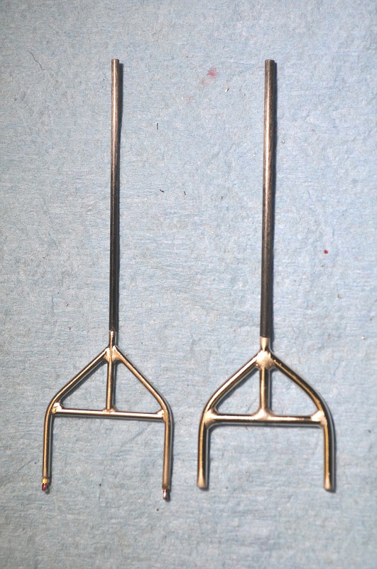

Codi Posted June 4, 2015 Author Share Posted June 4, 2015 Michael - its frail looking because I made it the wrong dimension. I thought the same thing when I put them on the car but accepted it was right. It took me about 90 minutes to finally find the CORRECT diameter that the real thing is made from.....my bars are 25% too narrow. I'm re-doing the whole thing. Thankfully I have the materials on hand (won't have to re-make the wheelie wheel and housing) and more importantly the KNOWLEDGE on the dimensions (length of tubes etc.) and how to fab down solid. I suspect I can get em' remade in little more than a day. I KNOW they'll look more appropriate then. Silly what a few tenths of a millimeter mean huh but I won't compromise on their accuracy.........so......... Chris - the kit you're seeking is the $49.99 nickel plating kit from caswell. be sure to read their directions and try some of the tips I've shared here on the best way to get decent results.....at least from what I've learned thru experience. Cheers Quote Link to comment Share on other sites More sharing options...
Ognib Posted June 4, 2015 Share Posted June 4, 2015 I respect you for admitting your oversight & also for your determination to do it again until it's right! Quote Link to comment Share on other sites More sharing options...
Codi Posted June 4, 2015 Author Share Posted June 4, 2015 Thanks Ray.....it's just the way I was raised and the way I am. Here's a pic and you can see the difference between the original and what I'm fabbing as we speak. Cheers, Tim Quote Link to comment Share on other sites More sharing options...
