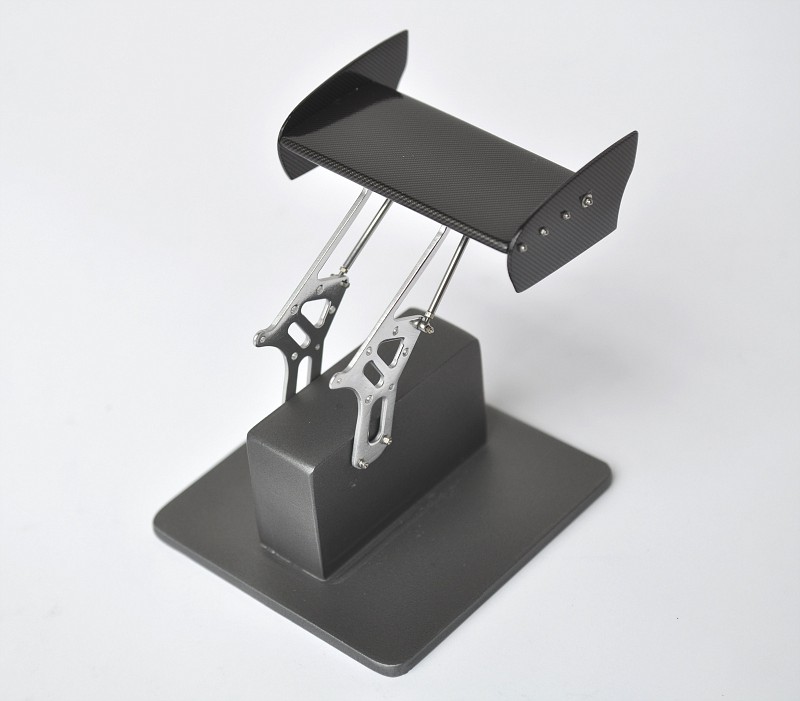

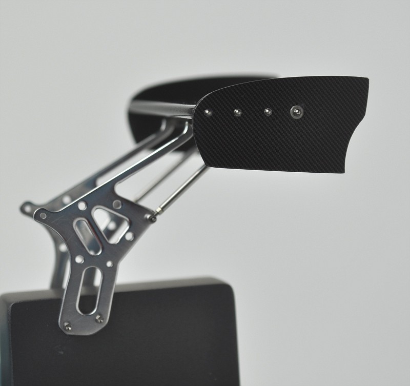

Codi Posted May 26, 2015 Author Share Posted May 26, 2015 Thanks Steve. Seems all the advice I've gotten is to go with 2 part urethane. So what did I do you ask. Well, Testors Wet look clear. Decanted it and thinned it 40%. Took 2 1/2 hours to apply 2 mist, 1 med. and 1 wet coat. Shot it at 20psi and the weather was perfect. Turned out very well even though the pics don't do it justice. And thankfully I won't even have to polish and there's only 1 tiny dust bunny on the very underside of the wing. Made a simple stand for it to assist in assembling it which will help for future mock-ups when I finish the back of the chassis. Cheers, Tim Quote Link to comment Share on other sites More sharing options...

Randy D Posted May 26, 2015 Share Posted May 26, 2015 Hi Tim, Well you certainly know how to take a wing and create a piece of art Your finish is flawless, congrats my friend!!! The added linkage is really cool. The brackets on the wing, are they Detail Master or something of your creation? Randy Quote Link to comment Share on other sites More sharing options...

Nitrozilla Posted May 27, 2015 Share Posted May 27, 2015 Now THAT'S a wing jig !!!! Almost looks 3D printed. Great finish on the CF Tim. I had a feeling the clear would make it pop. Onward to the next amazing step. Quote Link to comment Share on other sites More sharing options...
Codi Posted May 27, 2015 Author Share Posted May 27, 2015 A personal thanks to each of you that took the time to comment and your encouraging input. Wheelie bars and the final back brass portion of the chassis are next. I also want to answer Randys question about the wing brackets (the drilled out small pieces underneath the wing that attach to the strut itself) yes, they're detail master hood hinges that were slightly modified and polished. I always check my parts stash (don't we all) and found these. I had taken a lot of time to make 4 individual units but I just wasn't thrilled with them as they were a tad too large in my estimation. I thought these with the drilled holes in them complimented the struts themselves in a much better fashion. Cheers Quote Link to comment Share on other sites More sharing options...
