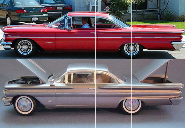

Really nice build -up of the '60 Bonneville. I've heard all the comments about the roof, but that side by side of the them really clears it up for me. It's a shame that Trumpeter doesn't run the test shots or advanced views through the various forums and get feedback.
Wonder if the roof could be corrected in place. Seems a waste to trash a '59-'60 chevy :(
I looked at doing that Mike with the kit I have, but the problem is not just the length of the roof, it also has a strange inward taper starting at about the mid-part of the roof and working your way back. It's very noticeable (to me) especially when looking at the model from the top.

What is the actual difference in the roofs shown in post #2? The height of the crown? I don't see it.
As you can see, the overall length of the body is pretty close. Several key points line up pretty well... but the rear glass ends too far forward on the model.

Thank you Harry to show the different roofs. I also didn't saw the differences.

After seeing the Trumpeter Bonneville hardtop compared to the real car, I see you had no choice but replace the top. Also, what were they thinking using a 2 door post sedan roof on a Bonneville?
