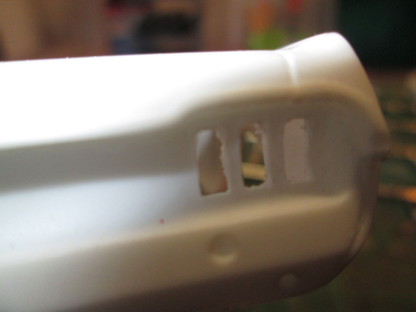

landman Posted December 31, 2014 Author Posted December 31, 2014 (edited) Tried my hand at making rocker panel trim à la Mr.Obsessive. This kit doesn't have the strakes for the rear quarter vents. I'll use the ones from the fastback as the PE ones appear too large for the holes. Notice how my scribing the door openings has left them rough? How do I remedy that or are they beyond help? Edited December 12, 2020 by landman

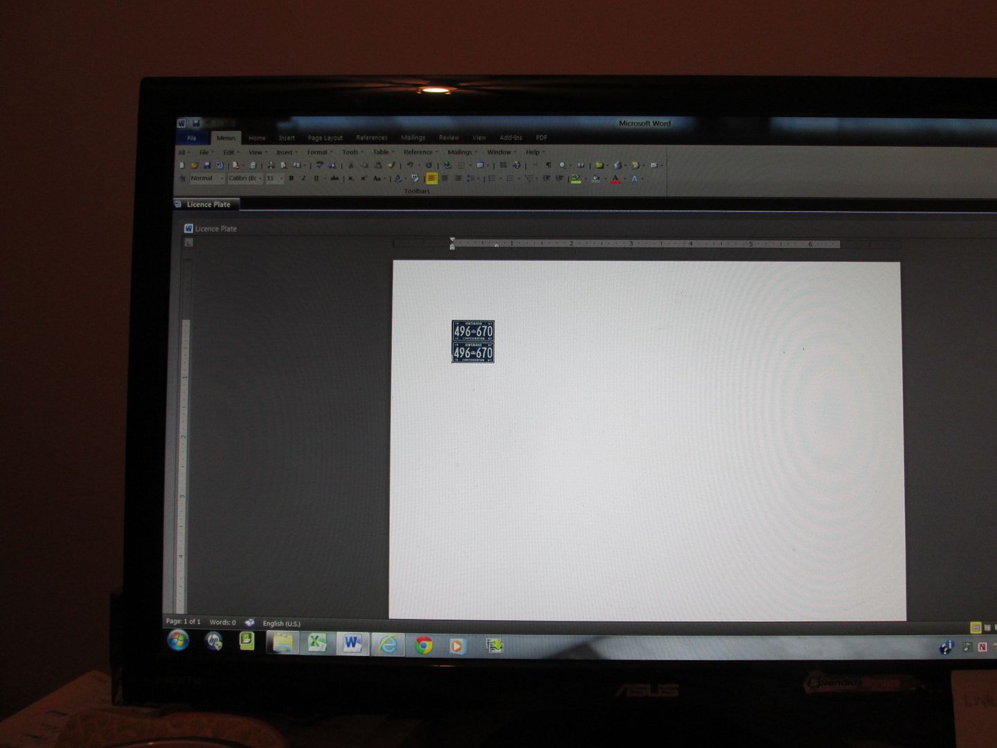

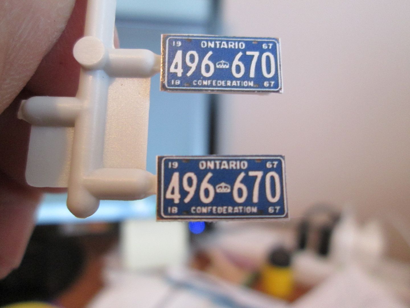

landman Posted January 1, 2015 Author Posted January 1, 2015 (edited) Played a bit again today. Added the wheel lip moldings. Used some half-round to do them. They may be a bit oversize. Also made a shifter for the automatic transmission. Reduced a photo of the YOM licence plates on the car on Word as I don't have a real photoshop type program. I have Testor's No.9198 decal paper and some Liquid decal film. Can someone tell me how to use that stuff? Edited December 12, 2020 by landman
mustang1989 Posted January 1, 2015 Posted January 1, 2015 For the wheel moldings Pat you could use some stretched sprue(I dedicated a couple of hours to perfecting this technique-it comes in handy with WWII aerial aircraft antennas). Then you still have the round look you're after and you can make it any size you want. That shifter handle is awesome! Can't help you much on the decal issue.
Tom Geiger Posted January 1, 2015 Posted January 1, 2015 Pat, I do most of my decal work in Word also. It's just fine for changing image sizes and printing multiple copies. I will share two thoughts... When printing, I always print multiple copies... like several sets of those plates. It's not much more paper and if you accidentally screw one up you have plenty more! Second, I don't print my plates on decal stock. I print mine on 60 lb white bond and use white glue to glue them. I like the thickness of this paper stock. When I do make decals, I use the Testors brand decal coating. It comes in the same small can as their paint sprays.
landman Posted January 2, 2015 Author Posted January 2, 2015 (edited) Tom,I used photo paper they came out nice and crisp. Edited December 12, 2020 by landman

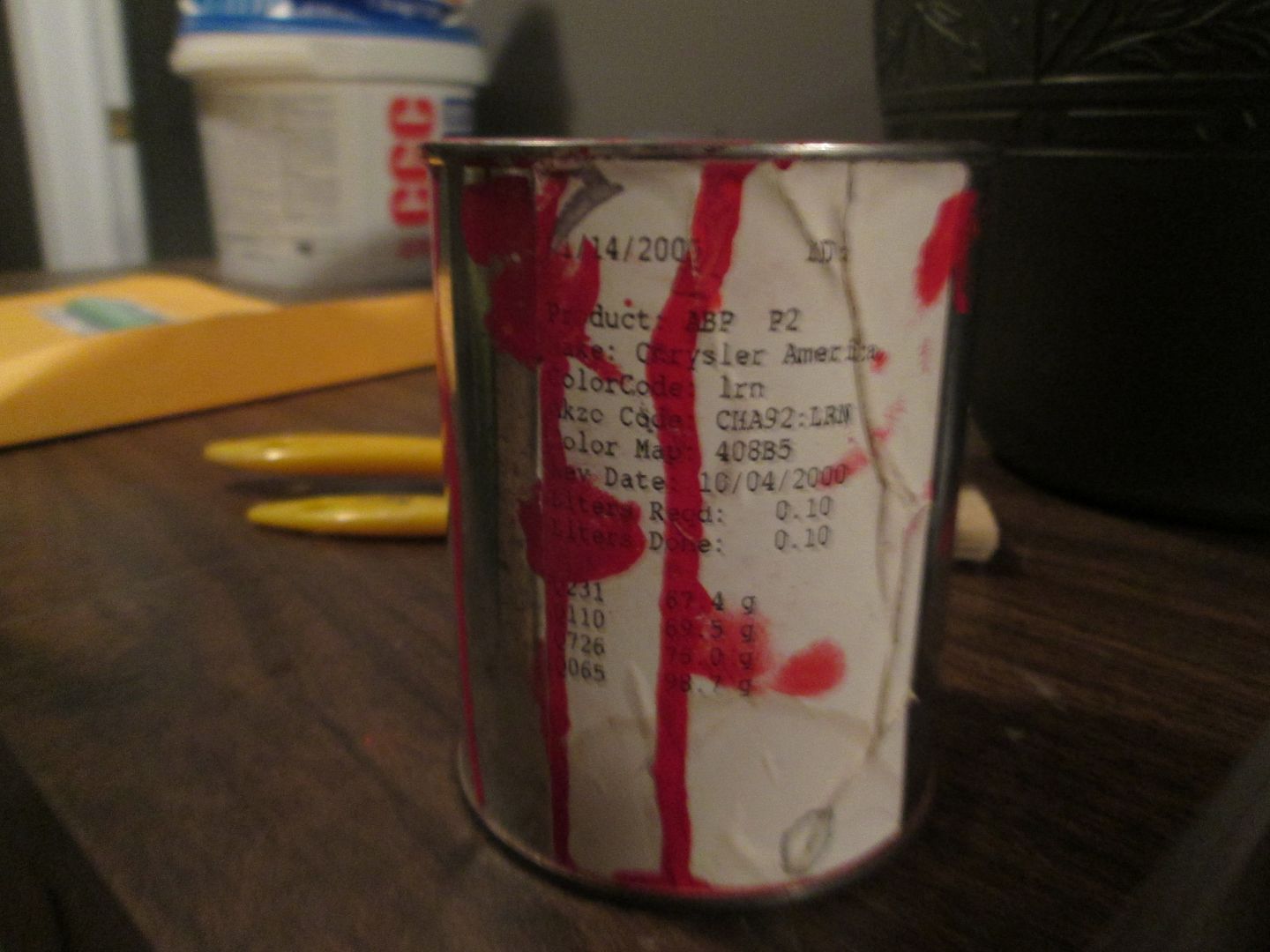

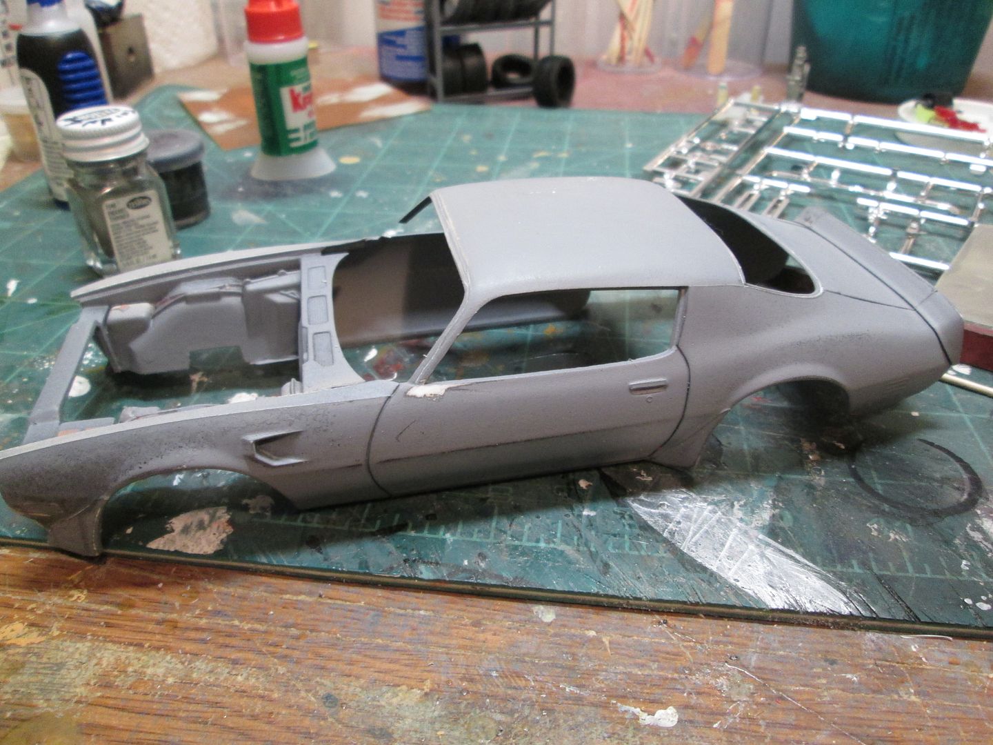

landman Posted January 2, 2015 Author Posted January 2, 2015 (edited) Put the new needle & tip in my airbrush and sot a few streaks on a piece of drywall. This can of paint was in the trunk of the car and was obviously used on the car itself. It looks thinned, ready to shoot. This old TransAm body will be the test mule. I plan to do quite bit of practising before shooting anything on the car, except maybe primer to highlight defects. Edited December 12, 2020 by landman
