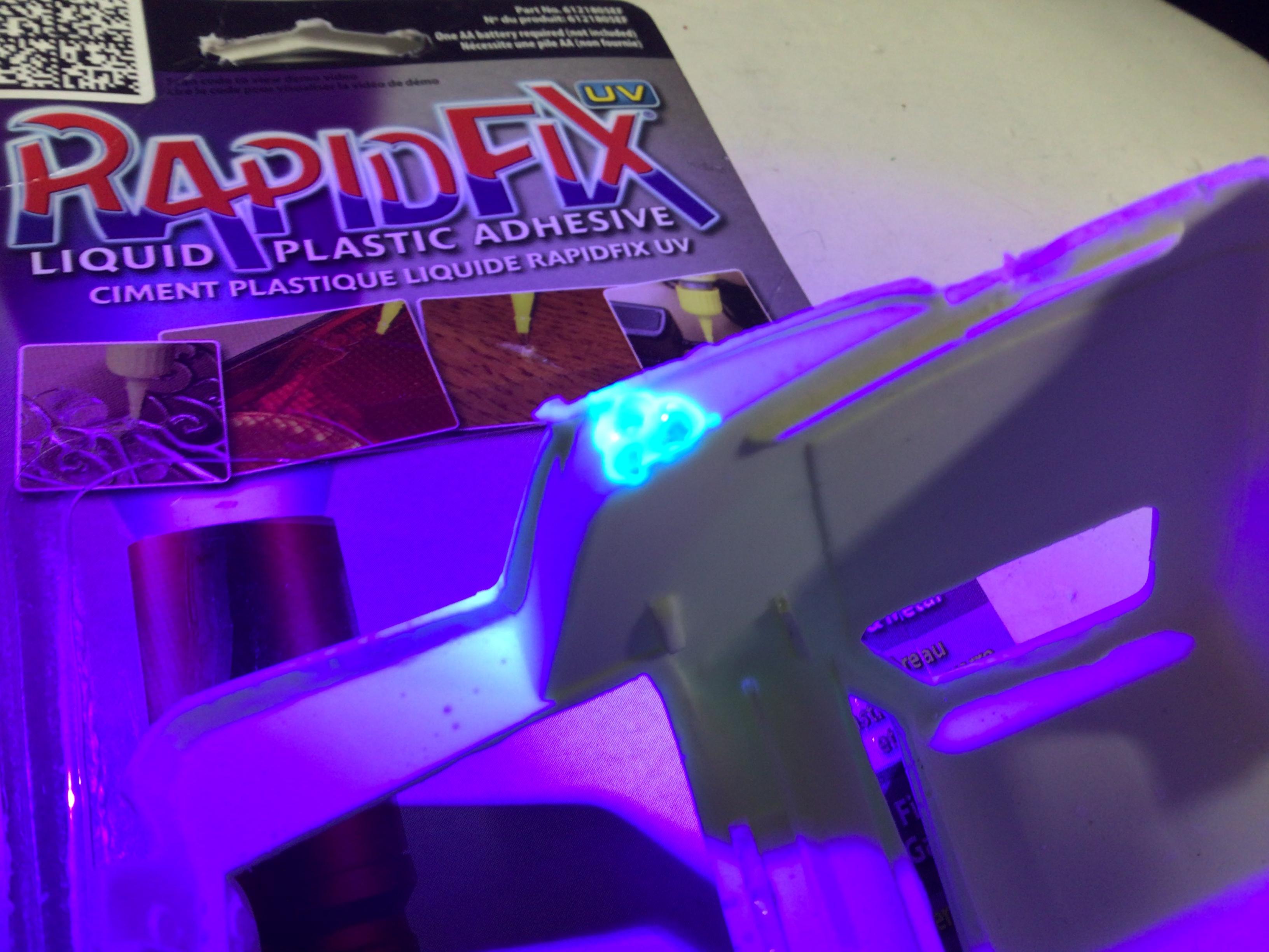

NOBLNG Posted October 21, 2021 Posted October 21, 2021 I am patching some air bubbles in a resin casting, and I ran out of bondic. I could have bought a refill tube for it. But I saw this at Canadian Tire in the automotive section. It is very likely close to the same material, but it comes with a much more powerful UV light ( AA battery not included?). This stuff also glows when exposed to the light.

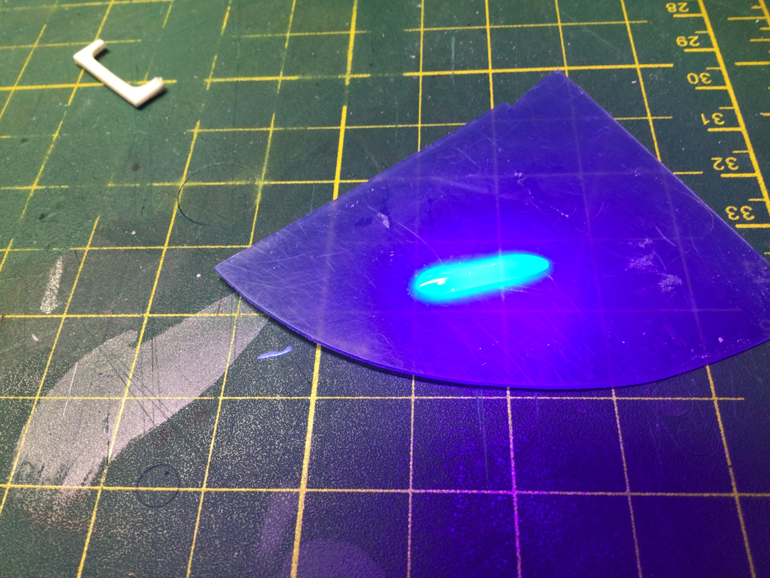

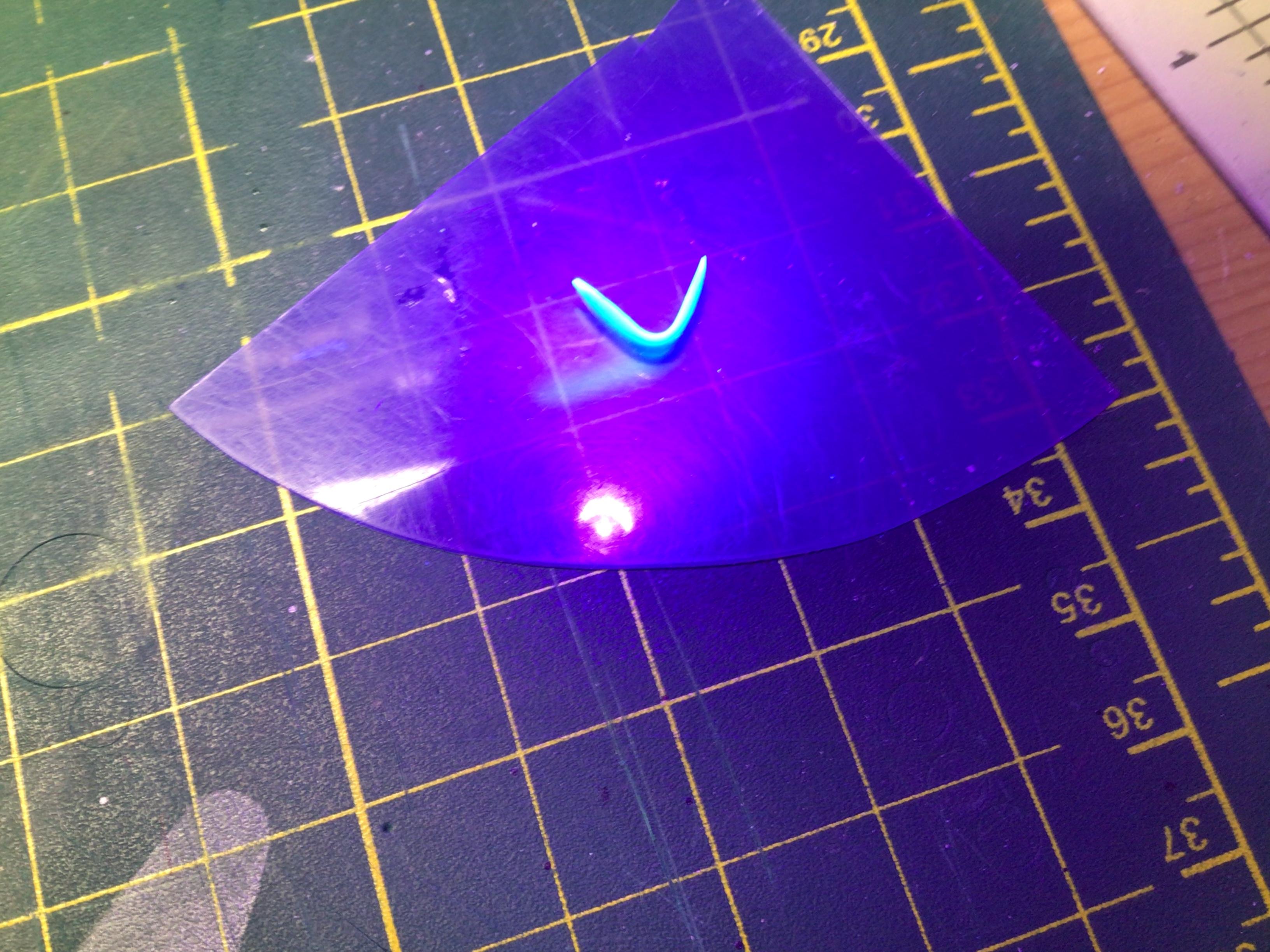

peteski Posted October 23, 2021 Posted October 23, 2021 (edited) 17 hours ago, JohnU said: I’m using it right now to assemble the clear parts of the Renwal visible V8 engine. Cures up rock solid with no fumes like two part clear epoxy! Instructions say to expose the UV light for ten seconds but I used it for at least thirty seconds at each joint. I'm surprised that it gets that hard. Could you do a test for me? Run about 1" long bead of your UV adhesive on a piece of aluminum foil. Once it is hardened, peel it off the foil, and bend it. Is it flexible or does it just break? My Bondic just bends. It is not very soft, but not really hard either. The other problem I have with Bondic and the original UV light (and even a stronger UV flashlight) is that while the resin semi-hardens, the surface remains sticky. I discussed this in another thread some time ago. However, when I cured Bondic with sunlight, it not only got really hard, but the surface was nice and shiny (not sticky). The discussion we had hypothesized that the curing lights don't use the most favorable wavelength of UV light, where Sun's light contains a wide spectrum of UV light. Edited October 23, 2021 by peteski
NOBLNG Posted October 23, 2021 Posted October 23, 2021 5 hours ago, peteski said: I'm surprised that it gets that hard. Could you do a test for me? Run about 1" long bead of your UV adhesive on a piece of aluminum foil. Once it is hardened, peel it off the foil, and bend it. Is it flexible or does it just break? My Bondic just bends. It is not very soft, but not really hard either. I did that test with this Rapid Fix and it is still flexible. I believe the stuff I cured yesterday however has hardened up substantially. I had some excess in a bottle cap and it began to harden under the LED lights over my desk. If the sun ever pokes it’s head out here in the near future, I will try an outdoor test.
JohnU Posted October 23, 2021 Posted October 23, 2021 6 hours ago, peteski said: I'm surprised that it gets that hard. Could you do a test for me? Run about 1" long bead of your UV adhesive on a piece of aluminum foil. Once it is hardened, peel it off the foil, and bend it. Is it flexible or does it just break? My Bondic just bends. It is not very soft, but not really hard either. I used small dabs on clear parts that allow the UV light to pass through and penetrate the Bondic and thoroughly cure it. I tried to poke a pin in the joint to test the softness and couldn’t pierce it! I was skeptical at first considering the tiny light they provided. Was quite impressed! Again, these were small dabs not thick beads. The Bondic instructions show that if heavier amounts are needed, it should be built up in layers. Maybe a more intense UV flashlight or as mentioned, sunlight is needed for your application. I ordered a UV penlight from Amazon with an adjustable beam. Should be here by Monday or Tuesday. I’ll do an experiment at work and try to check the hardness on a Rockwell tester if possible, to see what it is on the B scale. Get back with results before the end of the week
