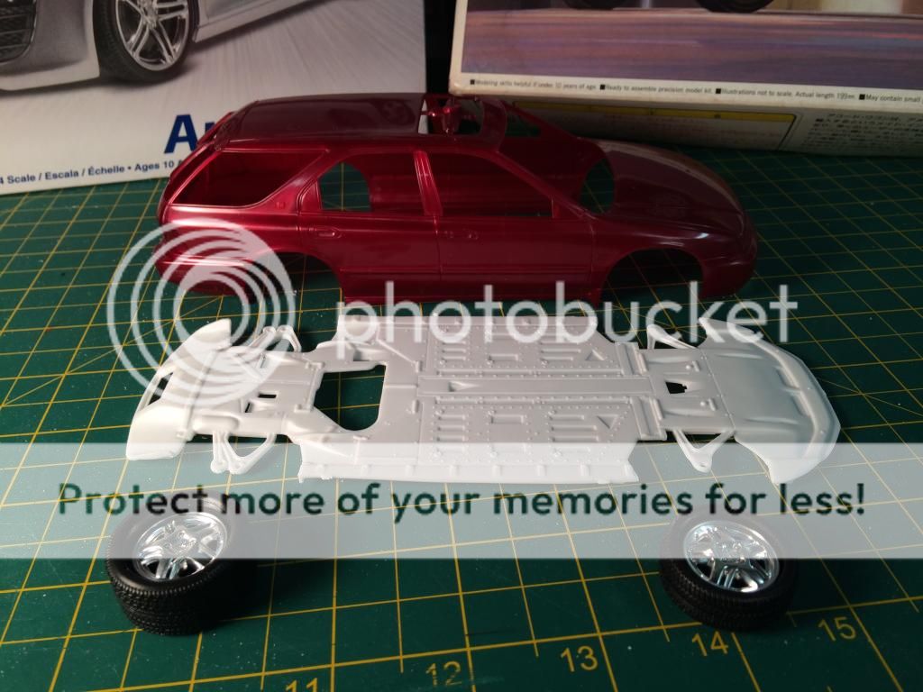

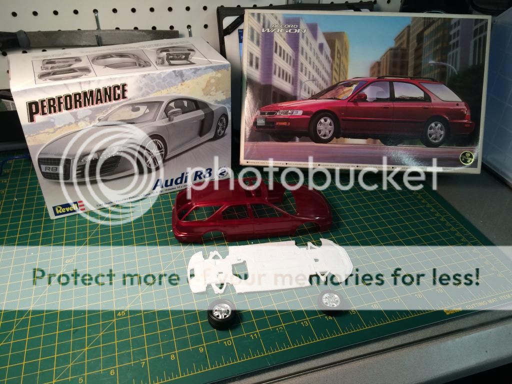

Impalow Posted February 3, 2015 Posted February 3, 2015 (edited) My kits have finally arrived!!! Wont be delving into this 100% for a little while.. but the start is there. Honda accord wagon... with Honda Indy Mid-engine.. and some fun sleeper tricks. (Donor kits Audi R8 and an Enzo) Edited February 3, 2015 by Impalow

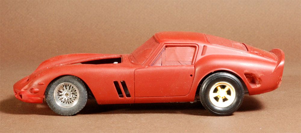

Foxer Posted February 3, 2015 Posted February 3, 2015 Ferrari 250 GTO Ricardo found a pair of mag wheels to fit the back where he was missing an original wheel. Now he could slip the wheels on to see how the clearances were. Up on wheels! Oh, the Ferrari people are going to groan!

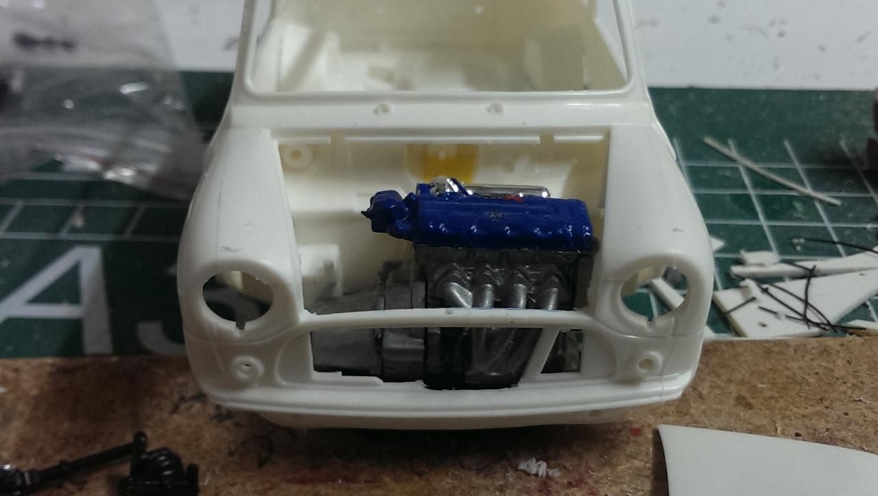

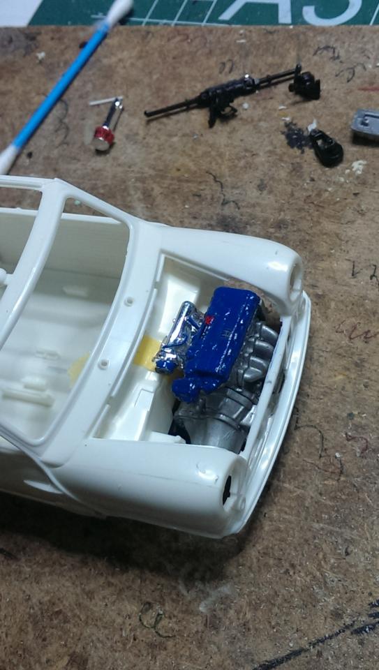

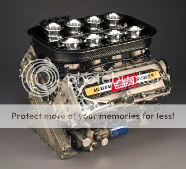

christian-w Posted February 4, 2015 Posted February 4, 2015 @Impalow ... Awesome! I love this wagon I drove mine about 11 years and was really sad, as our ways separated because of a broken valve. It had 323323 kilometers on the clock. Loved it. I'm looking forward on your built All together: nice and good progresses! I'd like to remind you, that I'm still on the start with my Mini-Honda runner. Nothing big was going on but after 2 1/2 hour of sanding, cutting and a lot of dry fits I made the engine fitting the engine bay. Shortened the oil pan, lowered the cylinder head and valve cover about 1mm, cut some parts of the wheel house, the inner fender and hood, shortened the intake manifold and pipe and some more..... Here it is..... I'm satisfied with it so far. Now I'm working at the exhaust and axles.
Belugawrx Posted February 4, 2015 Posted February 4, 2015 Looking good Christian Whoa.. that took some cramming ! Cheers
MeatMan Posted February 4, 2015 Posted February 4, 2015 Definite shoehorning!! Now, about that radiator...

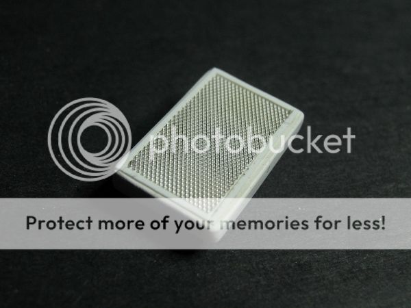

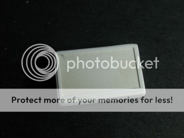

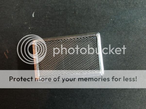

Belugawrx Posted February 5, 2015 Posted February 5, 2015 Speaking of rad,... got mine done for the '62 Impala Stole this from a Dale Jr's And since it will be visible from the outside... covered it with styrene and framed with evergreen strips.... Remembered I had some scale mesh ! Wrapped the frame with duct foil tape Cheers

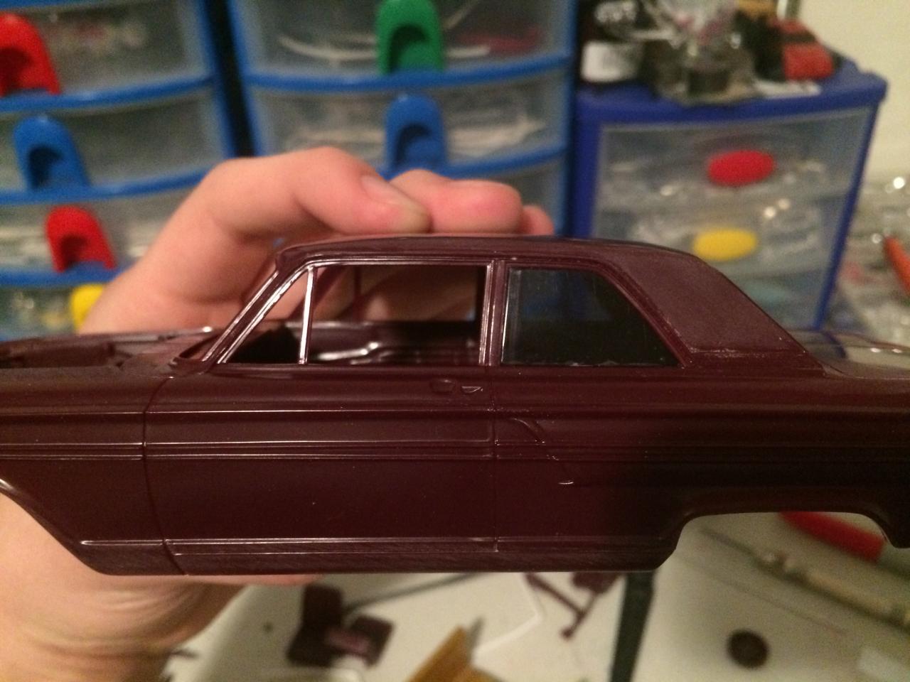

Dragfreak Posted February 5, 2015 Posted February 5, 2015 I started on the cage, I think I'll just be doing a hoop, down, and door bars since that'll be all it needs. The hoop I made out of brass to aid in keeping it's shape. The rest with be styrene/ aluminum rod. The hoop I managed to hide behind the b pillar, I had to add a slight bend back at the door line to follow the slight angle the pillar has so you really cannot tell its there. That with the tinted windows and nobody should be able to tell anything is there.
