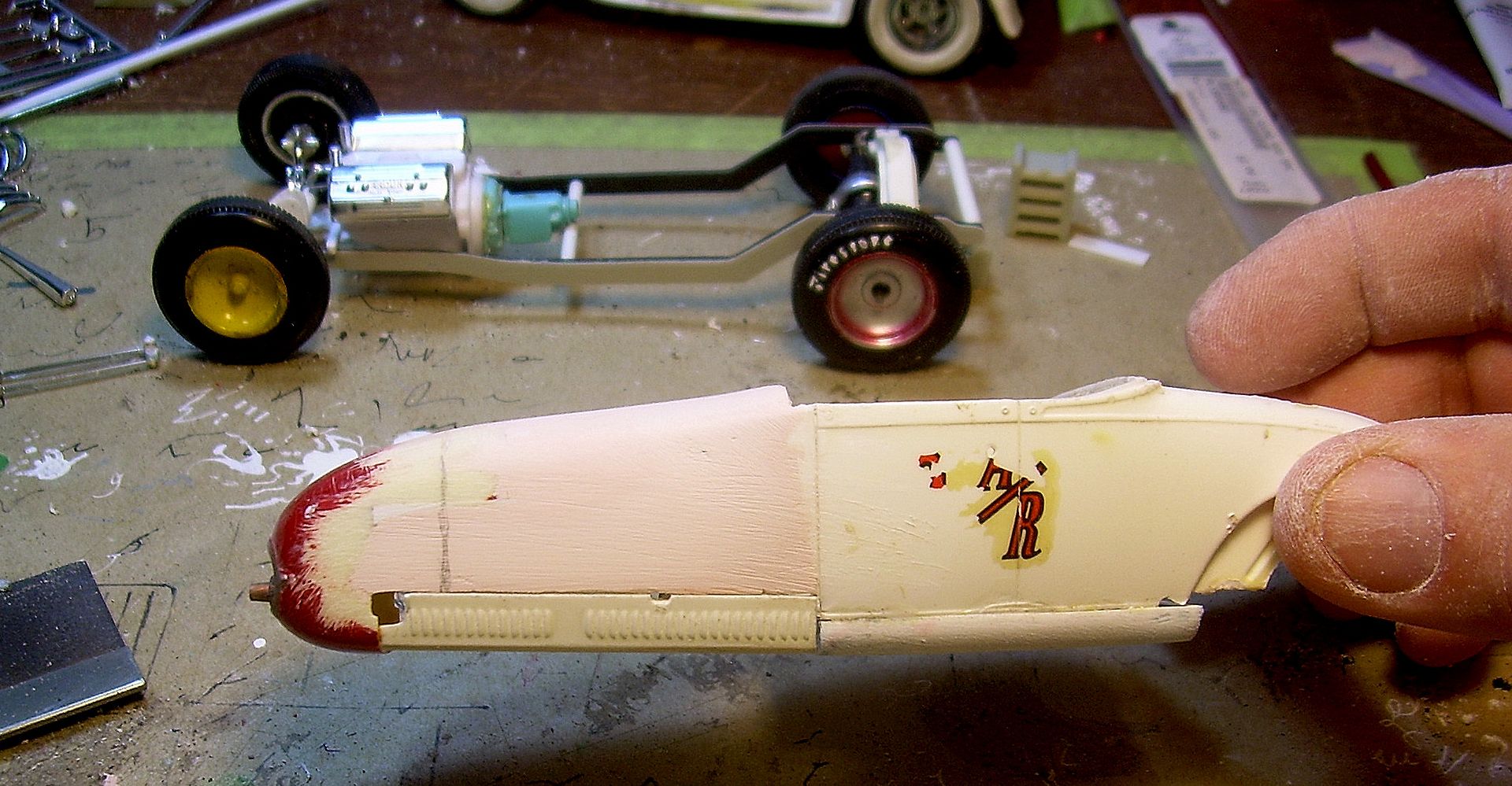

While the suspension parts were setting up between stages, I went ahead and started the bodywork. I don't see how anyone could do this work with one-part putty...at least not this fast, with thick, sculptural fills.

That is what is called a finishing glaze. Super easy to sand and get final bodywork blocked out perfectly. Many companies make a finish glaze. That particular brand is bondo brand.

what stuff did you use exactly to fill the nose ? the pink stuff that look like great sandable bondo
Yes, Bondo #801 Professional finishing glaze. It's a 2-part polyester product, chemically identical to regular bondo, but with a much finer texture. As JTalmage says, there are many brands of similar product that work equally well. (Do NOT confuse it with Bondo # 907, which is a single-part lacquer putty.) 801 comes with its own hardener.
The advantage the Bondo product has in the US market is that it is available in small, modeler-friendly packaging, while most "professional" products come in larger amounts that will probably go bad before you use them up (unless you build a LOT of custom models).

For larger work on 1:1 jobs, I still prefer USC Icing, but for smaller jobs and models, the Bondo Professional can't be beat. It's thinner bodied than Icing and self-levels better, which is especially helpful on a model where you can keep the filled area parallel with the floor until it kicks. It's also the finest-grained of any spot-putty I've seen yet, except for maybe U-POL Dolphin Glaze.
The fact that it's a little on the runny side initially is good for modelers too, because as it drys out from sitting on the shelf after it's opened, it's still usable (though thicker) a year after first being unsealed. Many other glazing putties will really be too stiff to use on a model after having been opened for that long. (Once opened, even if tightly capped, they ALL will dry out and get stiff).
