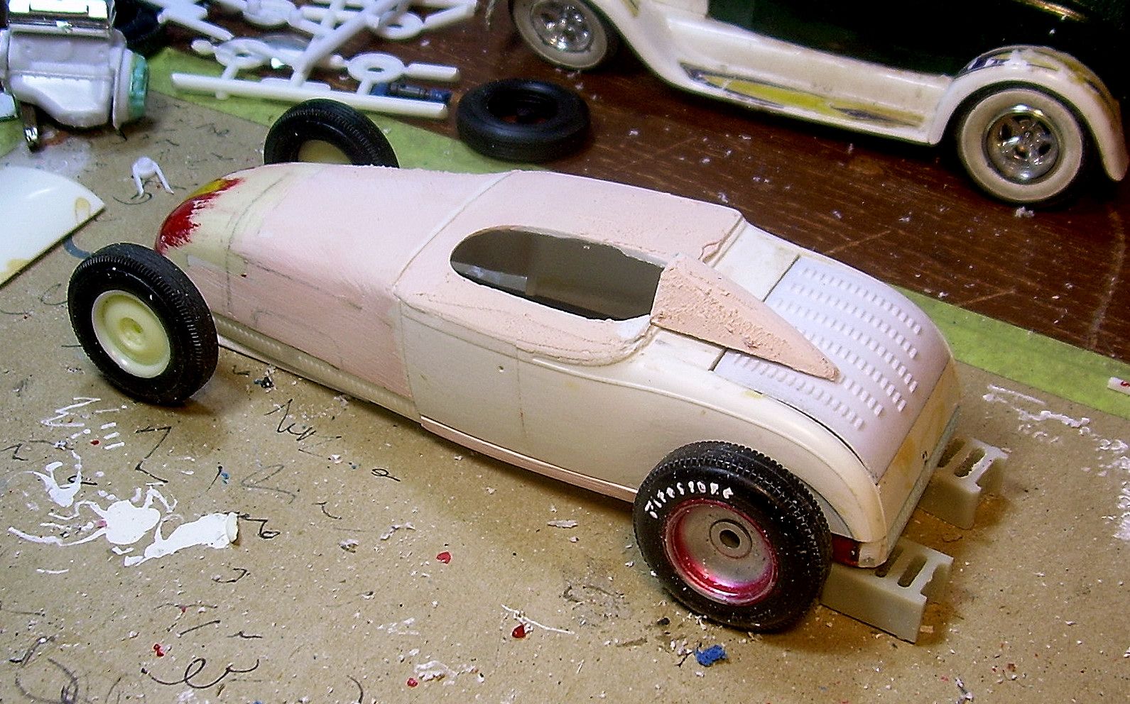

Opened the rear deck for access to the water tank. Some cars like this of the period didn't run radiators, choosing to block off the grille for cleaner aerodynamics (as will this car). Some kind of cooling system was still necessary, so the solution was to run a water tank somewhere, often in the rear, with the water pumps circulating cool water from the tank through the engine. Even Mickey Thompson's 406 MPH 4-engined LSR streamliner used this system.
Made up a louvered decklid from a Revell 5-window '32 part. No, it doesn't fit. Had to change the curvature, widen it, and shorten it at the top and bottom.
The bomber seat will show through the hole in the hard tonneau.
Made a match for the other side of the rear bellypan.
I'm really getting to like the overall look of this thing, and it's coming out pretty much exactly as I'd envisioned it in the beginning. The old Ford wheels from Joker and vintage AMT tires are perfect for the front.

There was a big ol' crack in the RH side of the body, and it kept opening up while working on the thing, even after repeated gluing. Very small-area butt joint, zero strength. No possible way it would stay stable during bodywork.
Made a patch panel to go inside the lower body. I want this thing to look good inside too, and the visible top seam of the patch will simply represent a stitched-in patch on a real body shell...one that had been pulled, rusted off along the bottom on one side, out of the junkyard. This has to be fitted carefully to keep the close fit with the bellypan.
The bellypan rear-section got reinforced inside to tie all the parts together. Yes, it looks grotty inside, but this is only the plug for a fiberglass copy that will be on the final model.
Moving along nicely on the shaping.
Made a new windscreen mockup to fit the revised cockpit opening, and re-contoured the helmet fairing to work with the revised shape. Also started scribing in the panel lines for the nose and hood.
Tail view shows the fairing, raised to clear the louvers, and acceptable fit of the deck. I went too fast doing the rough cuts on the decklid side extensions and cost myself more time filling some deep scratches as a result.

nice will you open up the bonnet on the engine for this?
Yes sir. I forgot to mention it. The nose, hood (bonnet) top and two side panels, plus the hard tonneau and the helmet fairing will all open and be removable, and the decklid will be hinged. What's shown for all of those parts are "plugs" that will have molds pulled from them, and .020"-thick fiberglass copies made for the final model.
