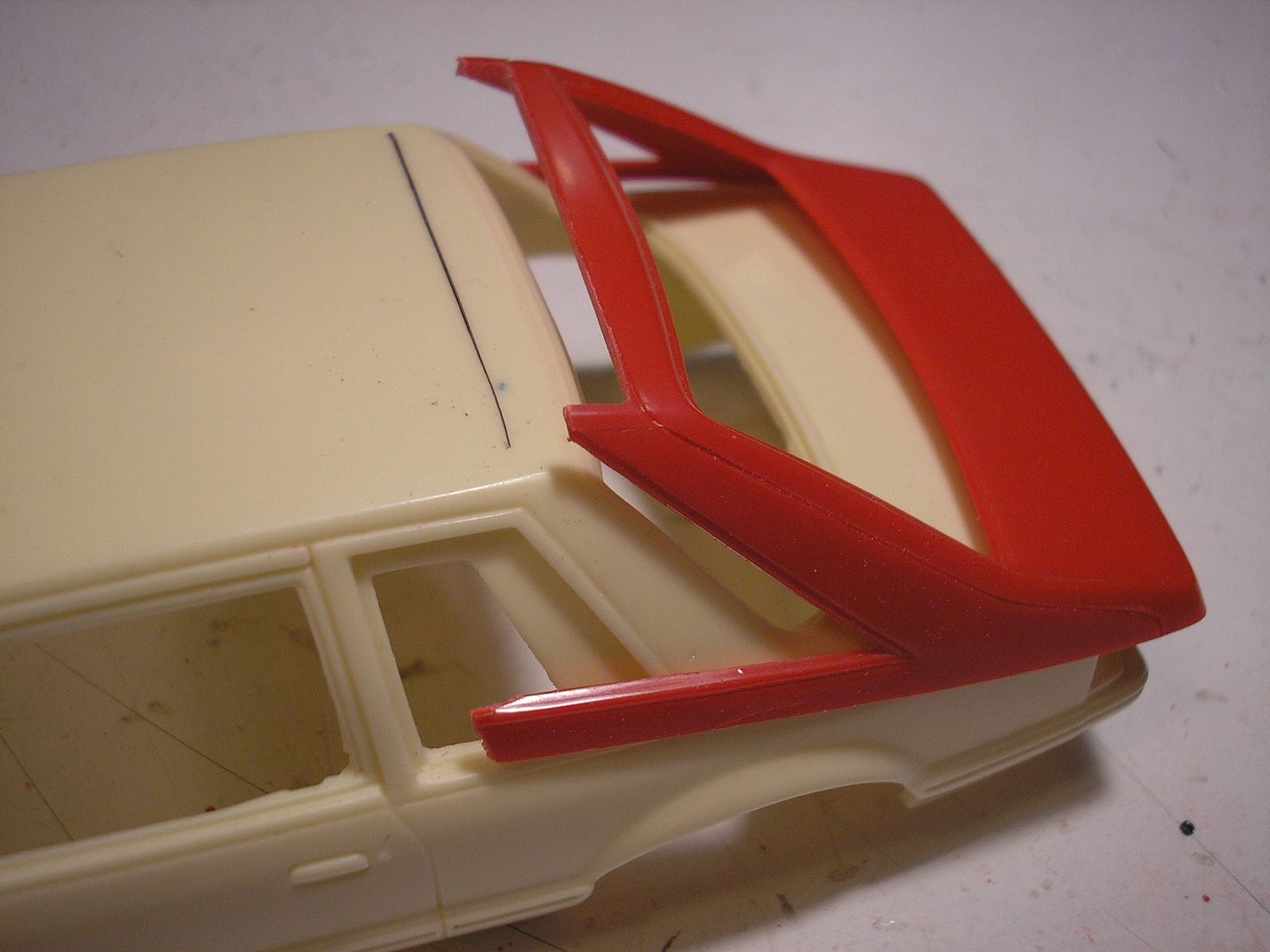

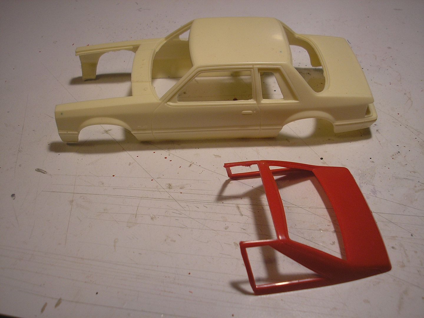

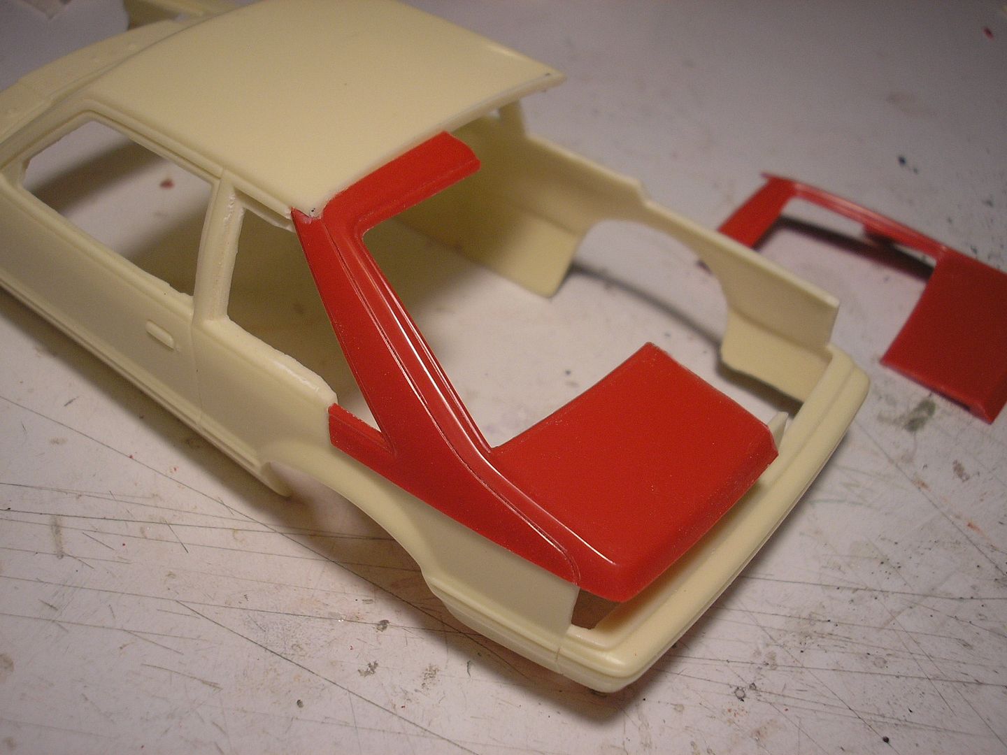

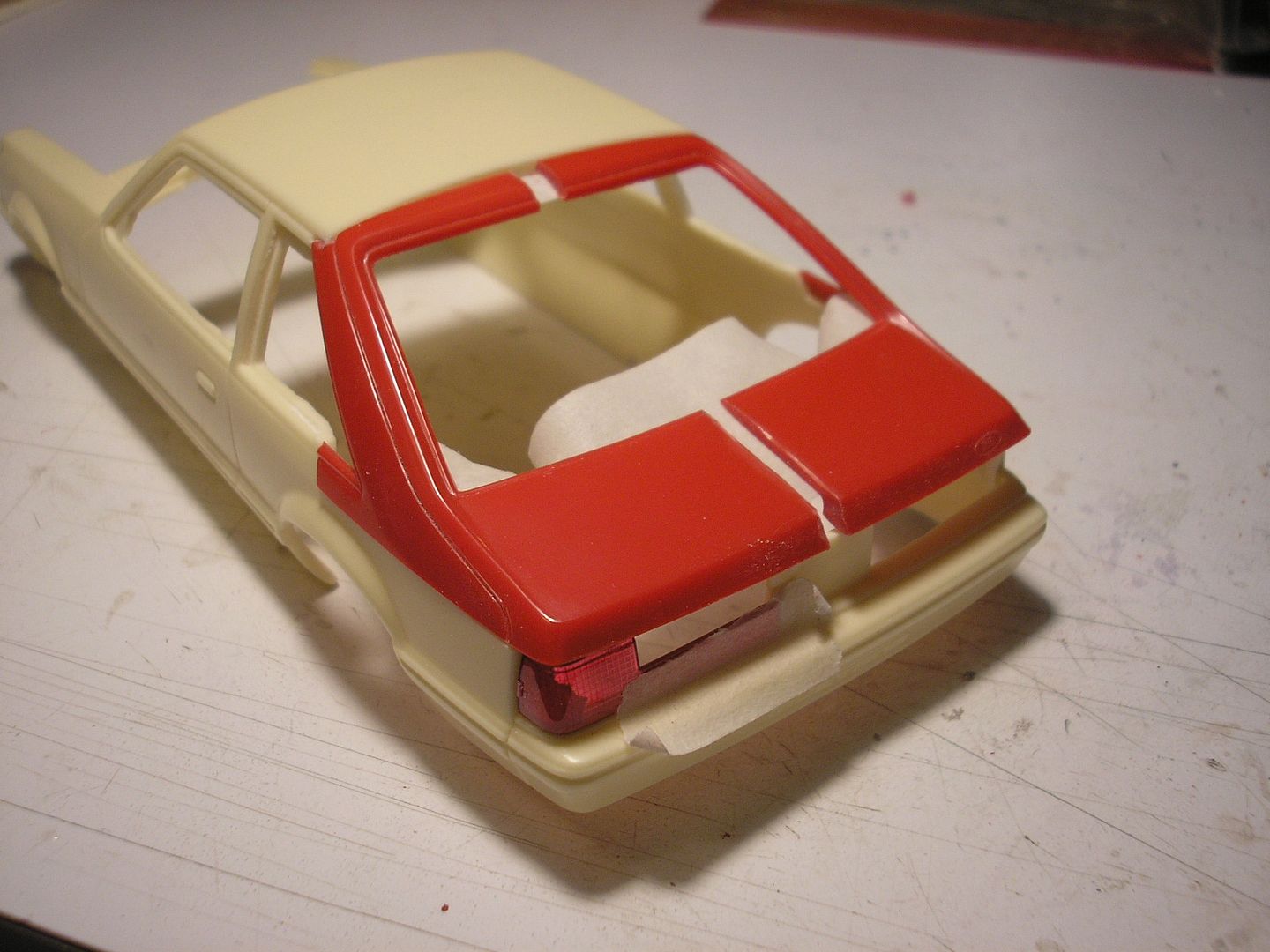

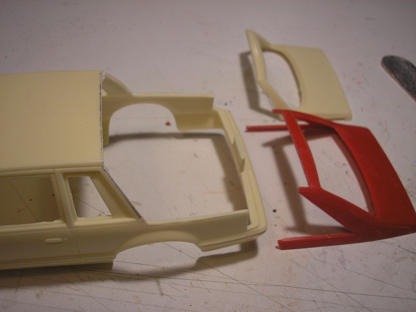

Maindrian Pace Posted January 13, 2015 Posted January 13, 2015 As a break from the 1:1 car building, I decided that what I really wanted to do today was to saw up some plastic and resin. The grey, windy, rainy day contributed to the decision, it's kind of like Chicago only without the soul-crushing cold. I started by cutting the hatch area off of an MPC '87 Mustang GT. Figuring out where to cut the coupe was interesting, I wanted to save as much of the roof and 1/4 window detail as possible to make less work for myself. Ain't no turning back now! The hatch needs to be widened, so I broke out the hatch stretcher. -MJS

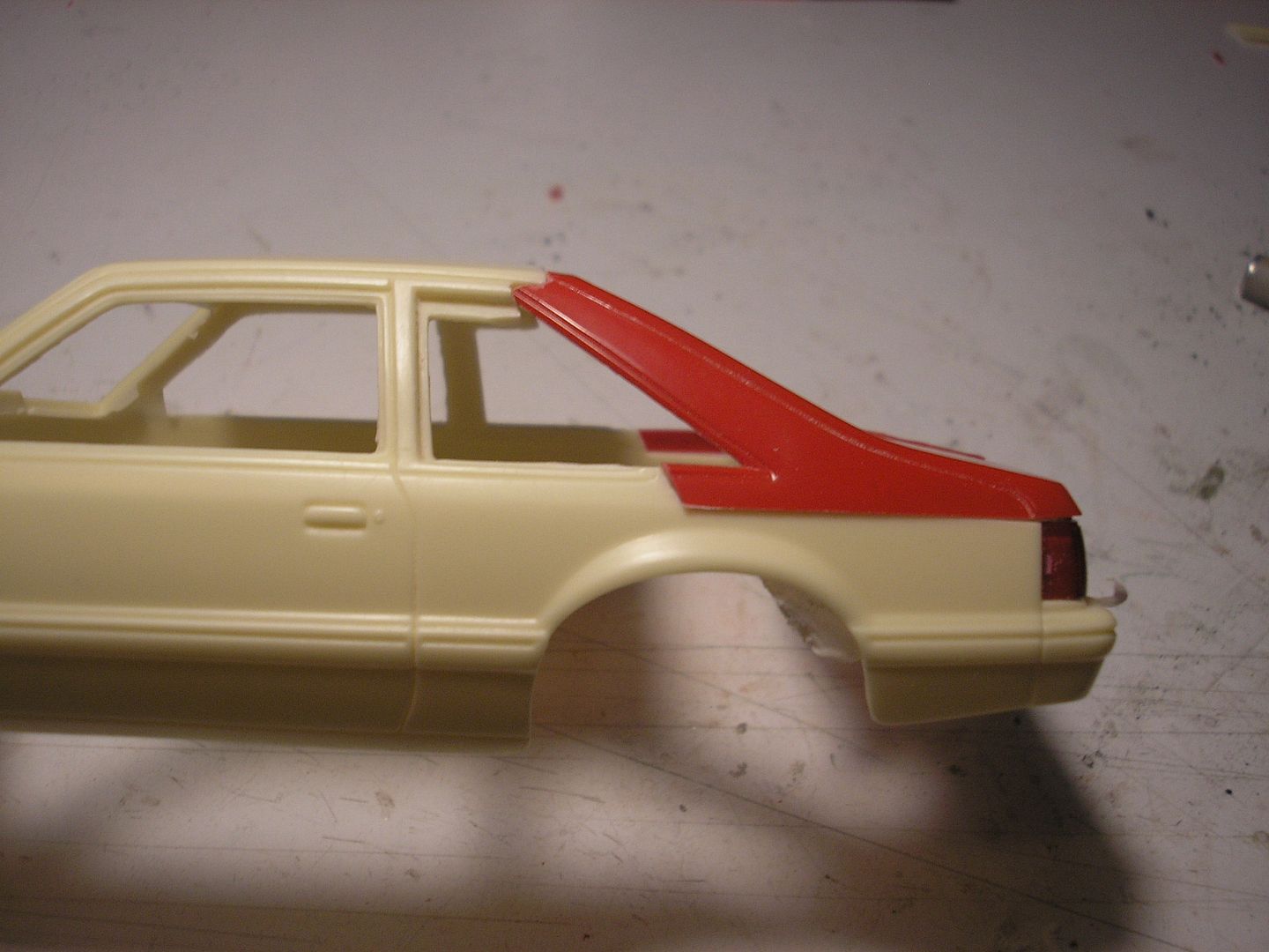

Maindrian Pace Posted January 13, 2015 Author Posted January 13, 2015 Starting to take shape. This will be the part II Fox offering from The Master Caster. When the body is done, I'll make a hatch area interior extension, a new LX wing, and a new vacuform glass buck. The wing will be a separate piece. -MJS

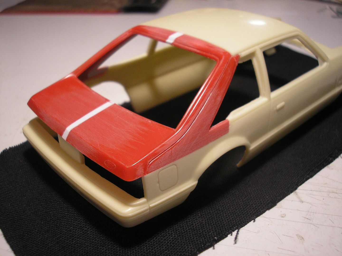

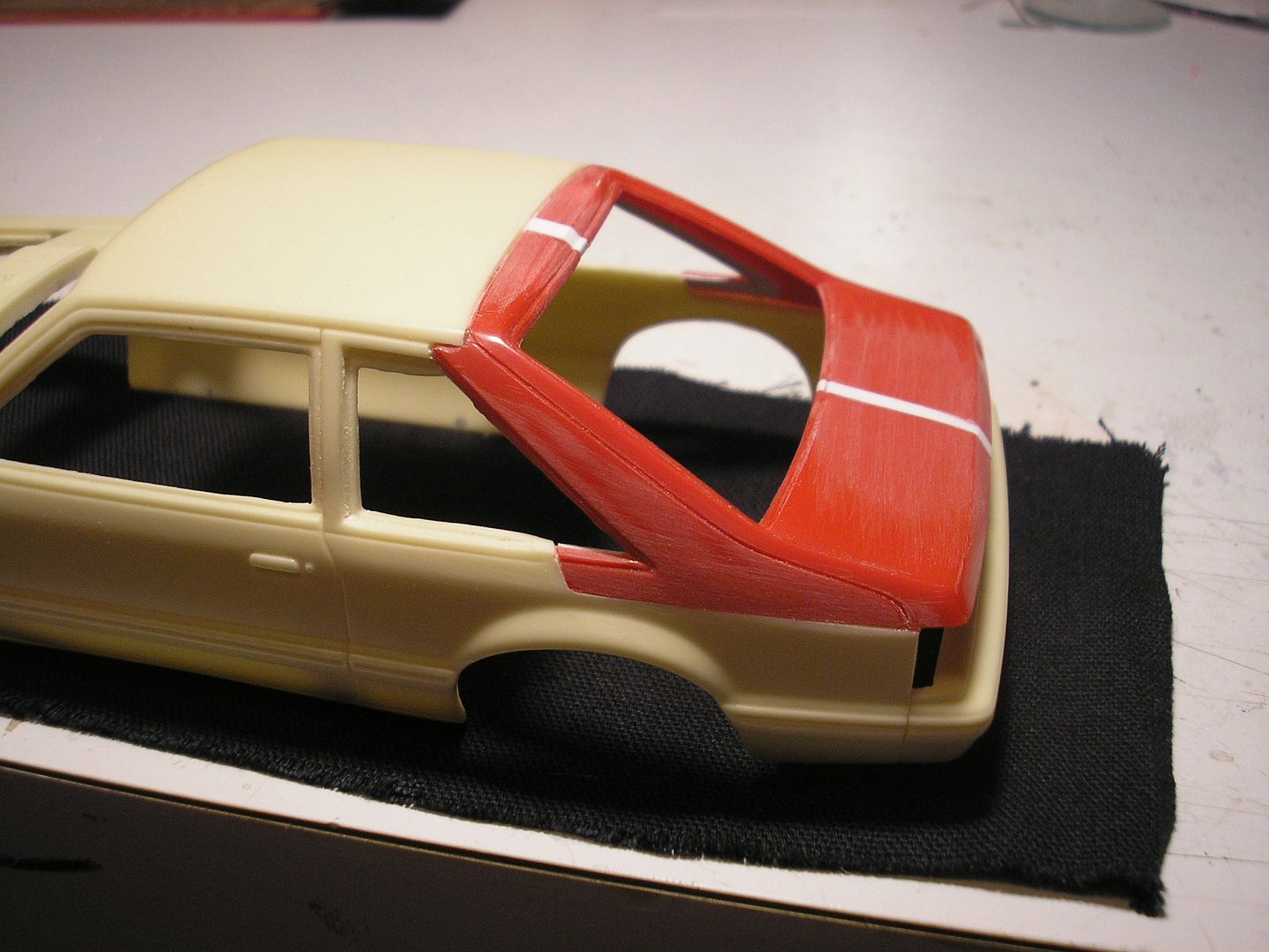

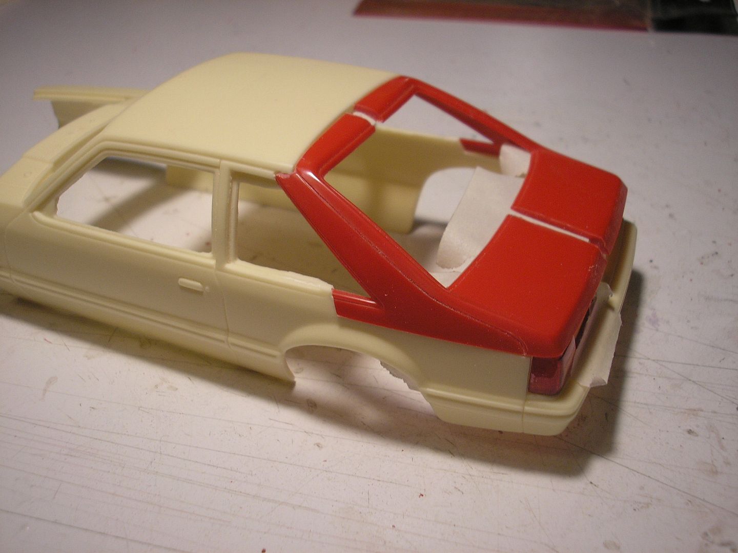

Maindrian Pace Posted January 16, 2015 Author Posted January 16, 2015 Thanks everyone for the vote of confidence. Looks like this body may be popular! Steaming right along, latest progress: Some interior bracing, garden variety aluminum flashing. A master needs to be stout for casting, because removing it from the inner mold twists it and un-reinforced joints give up. And I don't like doing things twice. Next: Lots of fussy boring stuff that doesn't make for the most interesting of pictures. -MJS
JTalmage Posted January 16, 2015 Posted January 16, 2015 Out of curiosity.... why use the amt hatch instead of the revell monogram 93 ccobra hatch? Scale?
Maindrian Pace Posted January 16, 2015 Author Posted January 16, 2015 Yes, mainly scale. Also, the Monogram body and hatch area has a few wonky proportions that would have had to be corrected, while the MPC/AMT part was pretty close as it was. -MJS
