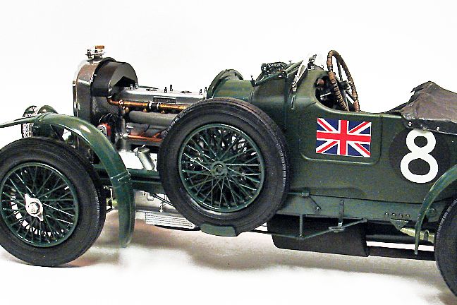

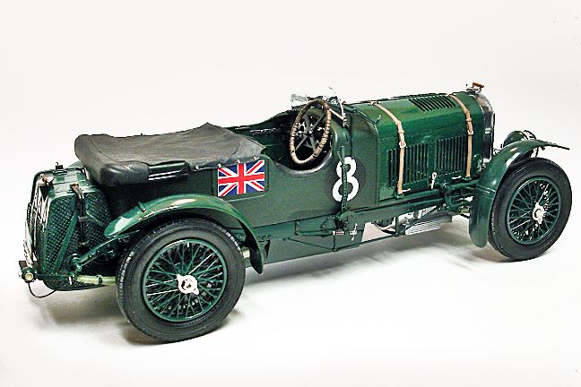

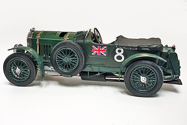

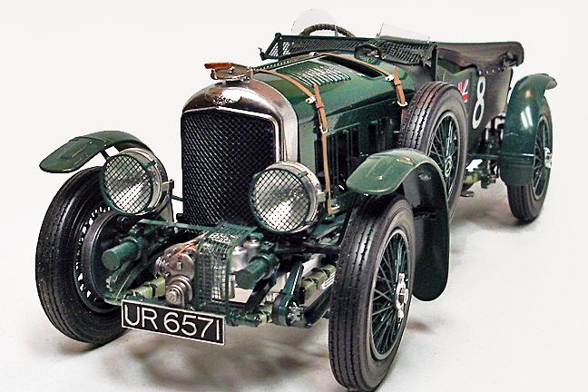

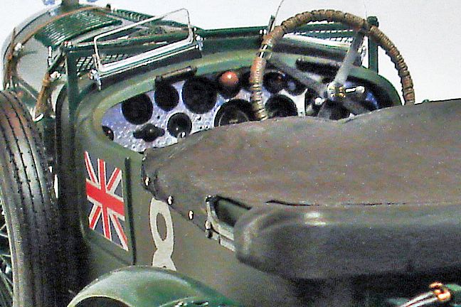

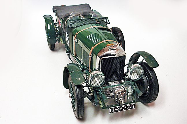

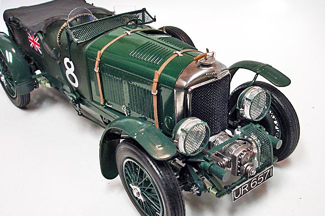

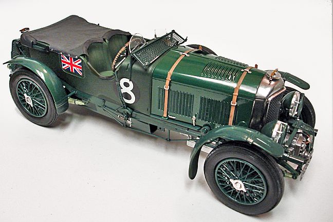

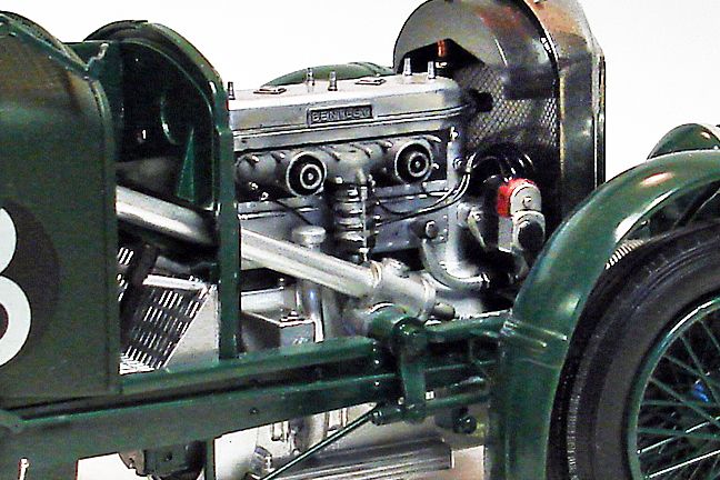

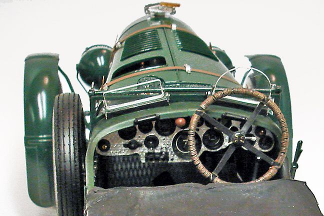

My version isn't quite up to the level that John's model is, but here it is anyway. Many changes made... all gas tank surface detail sanded off and new straps, mesh stone guards, and fuel lines/valves made from scratch, scratchbuilt stone guards over the headlights, and scratchbuilt stone guard on the cowl, real mesh added to grille, scratchbuilt map lights on dash, wrapped springs, scratchbuilt tonneau cover with snaps, radiator shell painted with Spaz Stix, seat cushions heated over a candle flame and pushed down to look "used," brake rods added, hood hold-down straps and hardware scratchbuilt, rear reflectors scratchbuilt, etc....
Let's just say I added a lot of stuff that wasn't in the box.
Nice work. How did you do the starps for the hood.
They are made of strips of thick paper, painted brown. The "buckles" are thin silver wire, the brackets on the hood are made of thin sheet aluminum (actually they were cut from a pie pan!)... the "bolts" holding them to the hood are pin heads, and the attachment brackets on the frame rails are scratchbuilt of styrene and wire.
Those brackets that the hood straps attach to were mounted to the frame rails on the real car, but to make removing the hood easier (and without having to actually undo the paper straps), I glued those brackets to the bottom of the hood instead of the frame rails. When the hood is in place it looks like the brackets are attached to the frame rails, but because they are actually attached to the hood, I can remove the hood and the straps all in one assembly without having to actually undo the straps.

Yeah, this is the one I had almost finished a long time ago, and then dropped onto a ceramic tile floor. The floor won. Lots of broken parts, lots of rebuilding. And then I put it aside because the chrome on the grille shell was messed up and I didn't want to go through the hassle of sending it out to be replated.
Then I got that can of Spaz Stix for my Mercedes wheels, and it worked so well that I pulled this out of mothballs and finally finished it,
