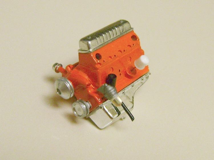

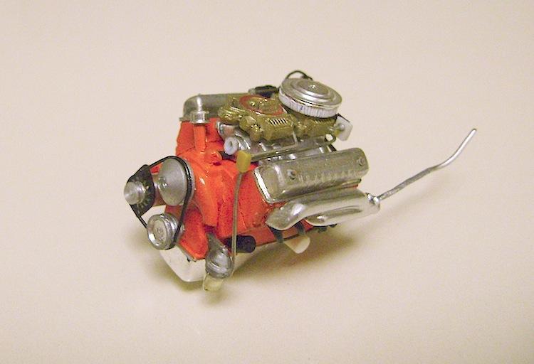

Russell C Posted April 21, 2015 Author Posted April 21, 2015 (edited) Block paint & test fitting. Color shows a bit too orange in this photo, it is Testors Bright Red, which is close enough for jazz in my book when it comes to the factory Ford color. For more visual interest, I drilled in freeze plugs and gouged out notches in the heads for where the head bolts are. I added a better looking mount for the oil filter and removed the excess plastic behind the water pump outlet tube. The fuel pump, crankcase vent canister, vent tube and oil filter are out on their wire pegs in a sort of 'exploded view' for this pic. The giant holes are for the AMT Crown Vic custom headers, and the two holes in the block in front of the oil filter (one is a mistake) are where the engine mount will go. The other holes are for the spark plugs. Edited March 8, 2016 by Russell C

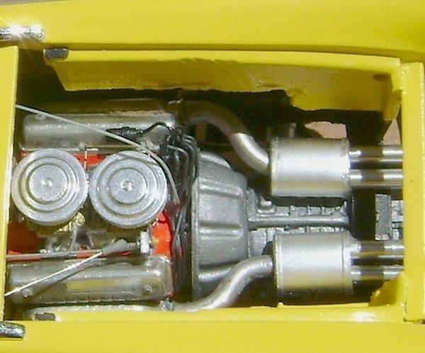

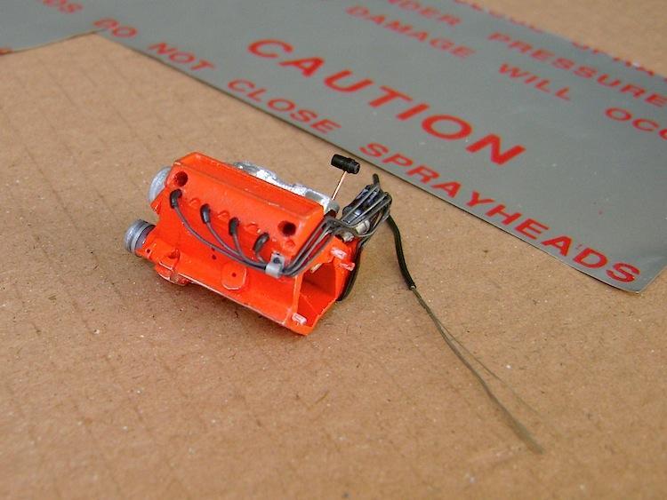

Russell C Posted April 23, 2015 Author Posted April 23, 2015 (edited) Plug wiring. I made that metal 'hoop' for the plug wires to go through out of some super thin soft aluminum sheet warning label material that I'd scrounged from when I used to work at a nameplate manufacturer. Basically, I cut a strip of it with a scissors, formed it into that shape, drilled a hole through the tab and the block, and attempted to secure it to the back corner of the block with a bit of black heat-stretched sprue - but that wasn't strong enough to hold it in place when I attempted to run a second full length formed wire through it, so I re-secured it with CA glue. The secondary lesson from that was my blackened soft steel wire was just a bit too springy to use full plug-to-distributor length. So, all the remaining wires after the first one go from the plug to that loops on each side, and the second half of the wires go from the distributor cap to the loops. Sure made life easier after figuring out that it wasn't necessary to have uncut wires. Hovering temporarily in space above the engine on a copper wire peg is the coil. The plug boots were made from insulation cut and stripped from the wire next to the engine. If I may be harsh on my own work, those boots look a bit too thick, but too late to fix that now. I'll have to clean up the worn off orange paint, a result of excess handling. I tried my best to hold the engine from only the bottom of the block and the top of the intake, but the lesson here is that I should have made some kind of temporary fixture to stuff into the back, so that I wouldn't have to touch any part of the block. Edited March 8, 2016 by Russell C

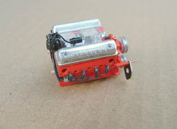

Russell C Posted April 24, 2015 Author Posted April 24, 2015 (edited) Coil. First, I'm glad I could find the center hole in the distributor cap in that spaghetti maze of plug wires, and second, I'm pleased that this was one more little part I didn't lose in the carpet. When first viewing this photo, I realized that I'd forgotten to make a boot for the back of the coil, so I solved that problem by half-slitting a very short length of the same insulation material that I'd used on the plugs, and slipped it over the end of the wire going into the coil. Valve covers now permanently installed. At the front, you see the beginnings of the T-bracket and front mounting plate for the alternator. There'll be no "floating alternator" controversy with this engine. Edited March 8, 2016 by Russell C

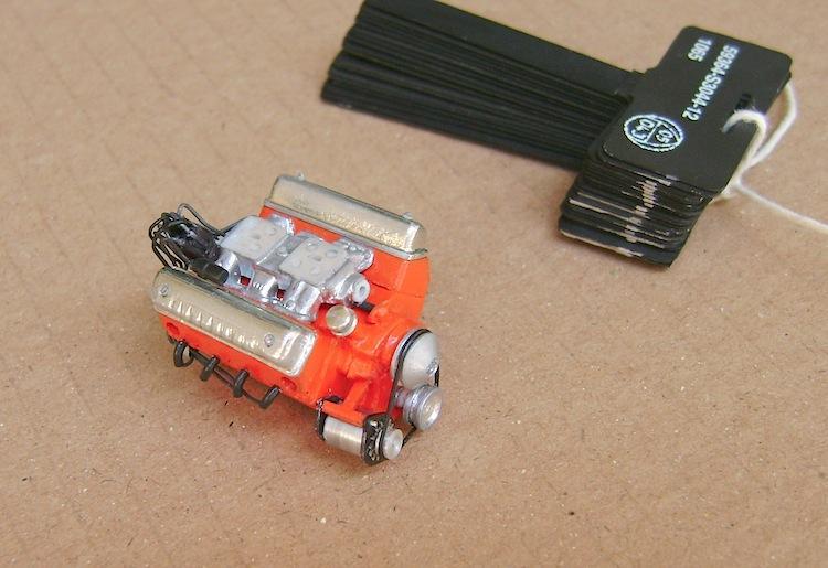

Russell C Posted April 24, 2015 Author Posted April 24, 2015 (edited) Thanks for the kind words, gents. Alternator. Generator [see posts 38 &39 below] The fan belt is heat-stretched black plastic sprue, bent to shape. I machined the alternator body and little pulley on my mini-lathe (blessed to receive that as a gift years back from my now-departed father, a pro machinist), since those were not something I could easily 'turn' on my motor tool. The fin wheel was a ratchet gear of a squashed wrist watch I found in a parking lot. The black brackets are the same dead soft black anodized aluminum as seen on the reject aerospace photo etched tags to the right, which were another item I snagged from the recycle bin at my former nameplate manufacturer job. That material cuts easily with a scissors, files like hard plastic, and is easily drilled through, all the while maintaining that nice even black surface. Touch up is as easy as hitting the silver-exposed surfaces with a black permanent marker. Edited March 8, 2016 by Russell C

MeatMan Posted April 26, 2015 Posted April 26, 2015 Great work Russell. I love the fuel pump! I'm not a rivet counter but what you called an "alternator" is actually a generator. Either way I like the work you did on it.
YBlock292 Posted April 27, 2015 Posted April 27, 2015 Russell, great work to show such a beautifully detailed Yblock in the 1:25 scale! Dennis is right with his remark on the generator. Last year the generator - a predecessor of the alternator - which refers to the technical standards of the 1950s, when Yblocks were developed - in my 62 Ford Galaxie, which features a 292 ci Yblock, needed a rebuild kit. Ludwig
Russell C Posted April 27, 2015 Author Posted April 27, 2015 Generator. I stand corrected, and a person learns something every day. I've been using both words interchangeably ever since I was a kid, never got around to learning the difference.
blunc Posted April 27, 2015 Posted April 27, 2015 (edited) from what I recall about generators/alternators... generators and alternators have similar requirements; they both require a voltage supplied to them before they will produce a charging voltage/current (unless they were built with permanent magnets...I've never seen one like that). they both require a circuit that limits max voltage, generators usually had an external regulator, most modern alternators have an internal solid-state regulator. the main reason an alternator is called that is because the raw output is alternating current (like house electric) and is rectified with diode packs to produce direct current. generators produce direct current without the need for rectifiers but are not as efficient as alternators. Edited April 27, 2015 by blunc

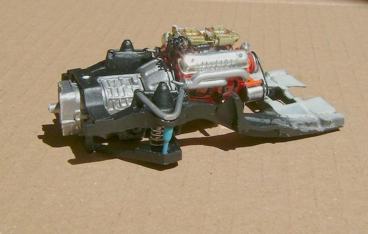

Russell C Posted April 27, 2015 Author Posted April 27, 2015 (edited) Transaxle/gearbox. Needed to permanently install the engine in order to work out the exhaust pipe/muffler setup on top of the transaxle area. Removed some of the bulky looking plastic of the AMT '56 Crown Vic suspension with better looking metal pieces. The transaxle/gearbox is a much reworked truck transmission, I think leftover from the MPC Super Semi Zinger kit. I'll have to detail in another thread how I used heat stretched sprue to create the reinforcement ridges on it. curiousmodeler sez:What?? Transaxle/gearbox?! I thought this engine was going in a Crown Victoria. It actually is, just not in the end you expect to see it in. Or I should say, it is in the proper end, kind of, but the end is not where it usually is. curiousmodeler sez:Lunatic. Hey. I resemble that remark. Edited March 8, 2016 by Russell C

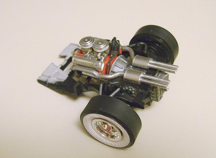

Russell C Posted April 28, 2015 Author Posted April 28, 2015 (edited) ... are ya gonna have the driver sitting out in front of the car...? Well... driver will be in front, no room for passengers, though ..... Exhaust. Had some aluminum (?) clad copper rod in the right diameter which was somewhat cooperative to bend. Oval shaped scrap plastic bits look like small mufflers to me, and I had just enough aluminum tube to use for the end lengths. This setup demands whitewall slicks, of course. Edited March 8, 2016 by Russell C
Russell C Posted April 29, 2015 Author Posted April 29, 2015 (edited) Engine/cradle install. Cramped quarters in there, somewhat dark and hard to see, thus the need for a WIP set of photos. This one shows the boot on the end of the coil which I'd forgotten to install when I took the photo for post #30, but now it reminds me I forgot to install the wire from the coil to the firewall location. I'll put it in right after I post this. Off to GSL with this thing early tomorrow morning, photos to follow of the completed model when I get back. Edited March 8, 2016 by Russell C
