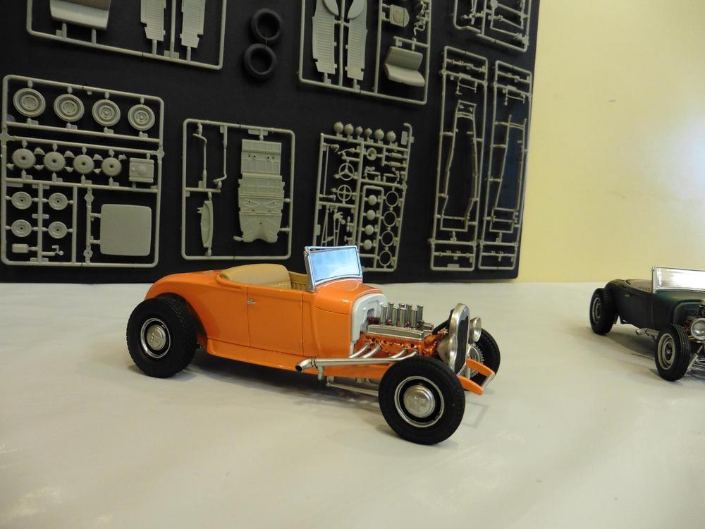

Add my thanks to Tim for the excellent review and photos.
There are some unique features engineered into this kit that I haven't seen before.  Revell added some material to the parts on the chrome trees so the sprue attaching points won't be visible when the model is built - It will take a bit of clever trimming, but there won't be any white spots showing or silver touch-ups required - way cool.  An example is the air cleaners which have the sprue attached on the bottom, not the edge
There are a lot of extra little disposable tabs molded on many of the parts with tiny details - overall, the detail is a lot finer and the tabs allow plastic to fill the molds so the detail is not lost.  Revell has engineered carburetors that look like a real carb and not just a plastic blob.  Revell has really upped the quality of the detail on this kit.  I didn't find any sink marks to fill.
Not an expert on injection molding but it looks like all of the ejection pins (or at least the ones I found) are on the sprue - not on the parts.
The parts trees are set up in logical groups - it looks like modular packaging which is looking forward to future kits - looks like more are on the way
Good fit on all of the parts that I've done test fits.
