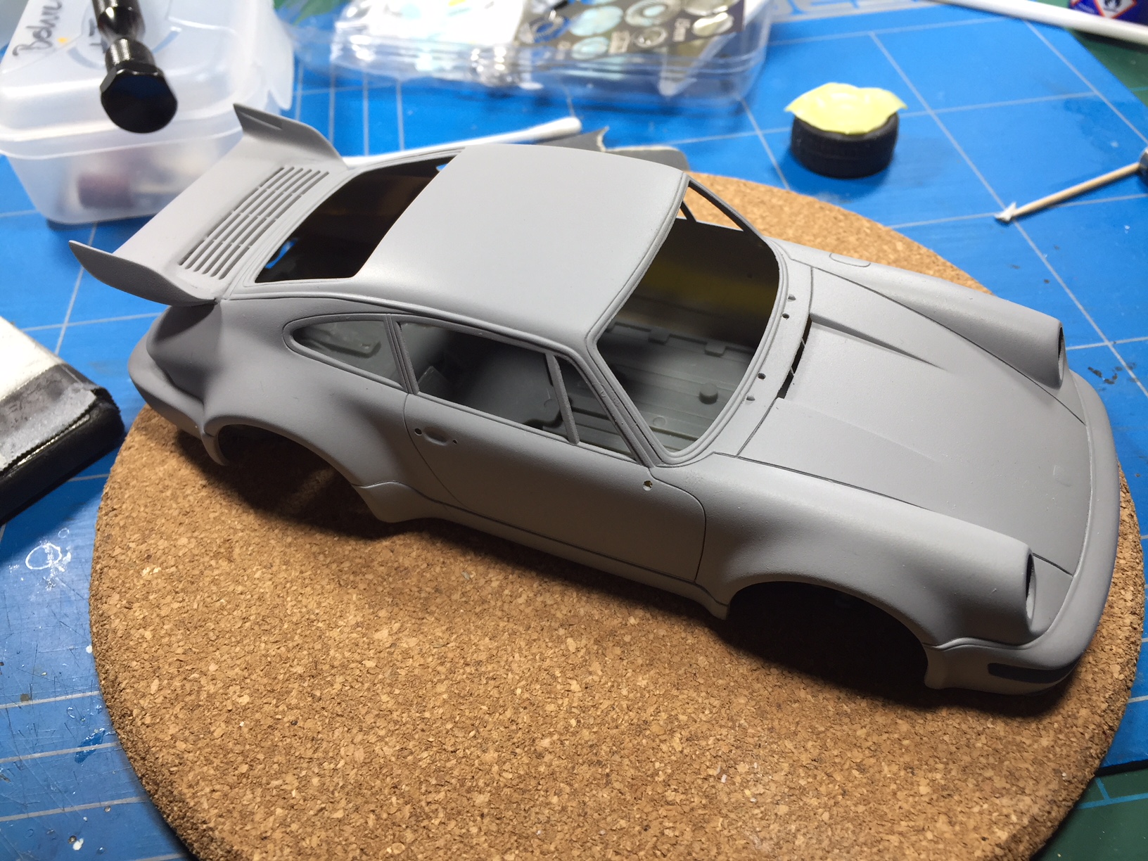

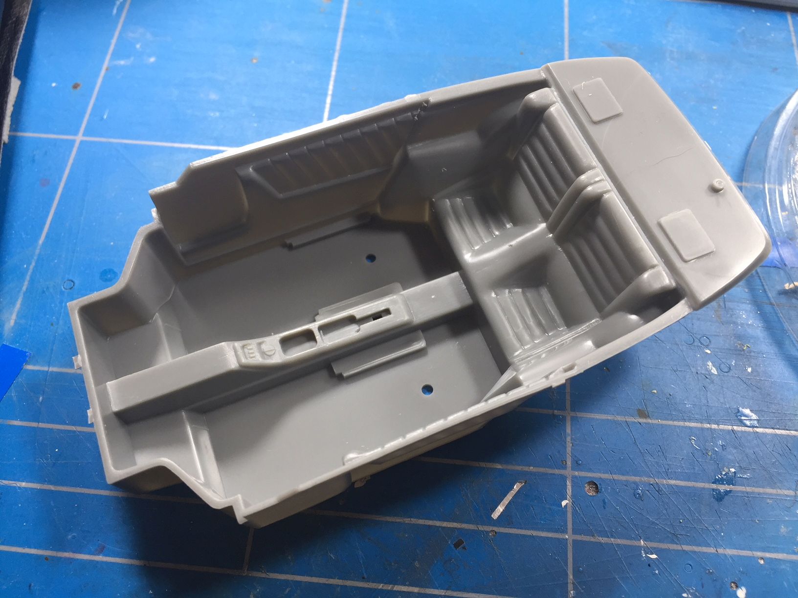

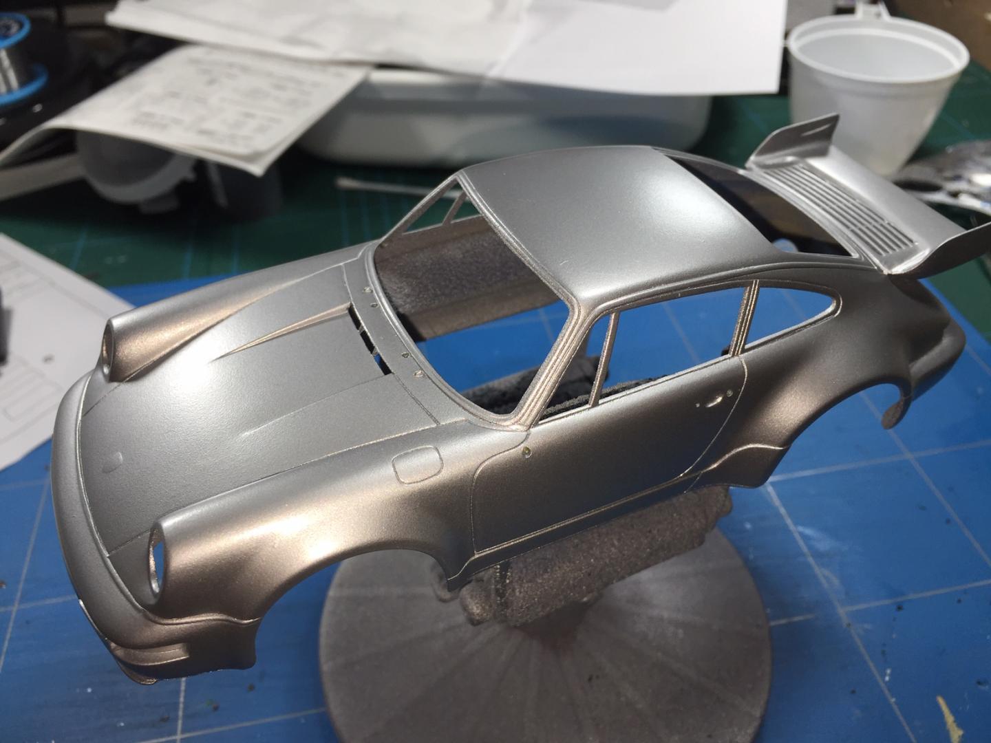

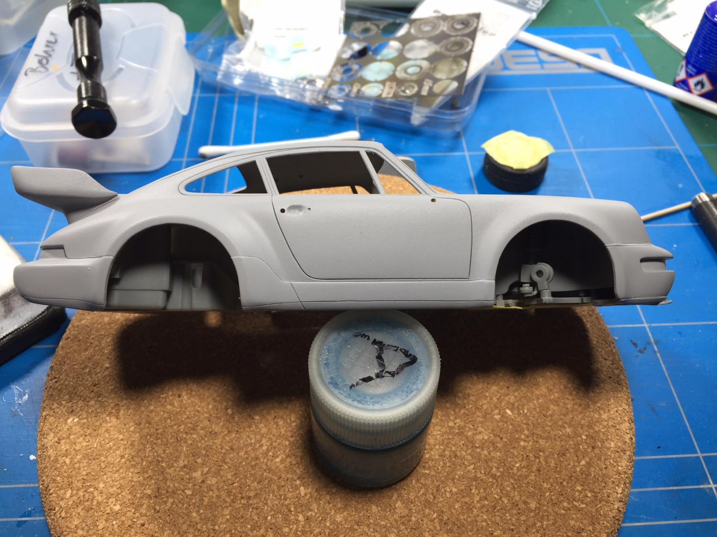

Tommy124 Posted October 8, 2018 Author Share Posted October 8, 2018 (edited) On 6.10.2018 at 9:17 PM, Draggon said: No, there's a sort of rubberized coating that is sprayed on rocker panels to prevent or limit stone chipping. I had it on my 5.0 Mustang. I guess I know what you mean. I don't think the Porsche has this, but regardless it won't have any effect on my build, as I will have the whole area painted in body color. Back to business... I took a shot at the body with good old grey Tamiya primer spray. Looks okay to me so far: Happy not to see any ghostlines from the sunroof that was filled and sanded earlier on. Let's hope it stays that way... Just like the rest of the kit, the interior is full of flaws. It's all just 911 Carrera/ turbo and as those cars are not lightweight, further modifications have to be made. This is what it looks like box-stock: On the ipad image you can see that there are not supposed to be any back seats. It's all basically stripped back there and covered with black carpet. I will cut, scrape and sand down the parts that formerly were the back seats, in order to have an even area that later will be covered using black flocking. Rear loudspeakers have to go too... The same goes for the door panels, they have that typical 911 leather look, whereas the RS has even, simple panels. So these pieces have to be cut out and will later be replaced by SB parts. As mentioned earlier on, I will use Scale Production race seats as a replacement for the kit's standard 911 seats. As the resin seats do not have the belt holes on their sides, these will have to be made using the hand drill. To be continued... Edited October 8, 2018 by Tommy124 Quote Link to comment Share on other sites More sharing options...

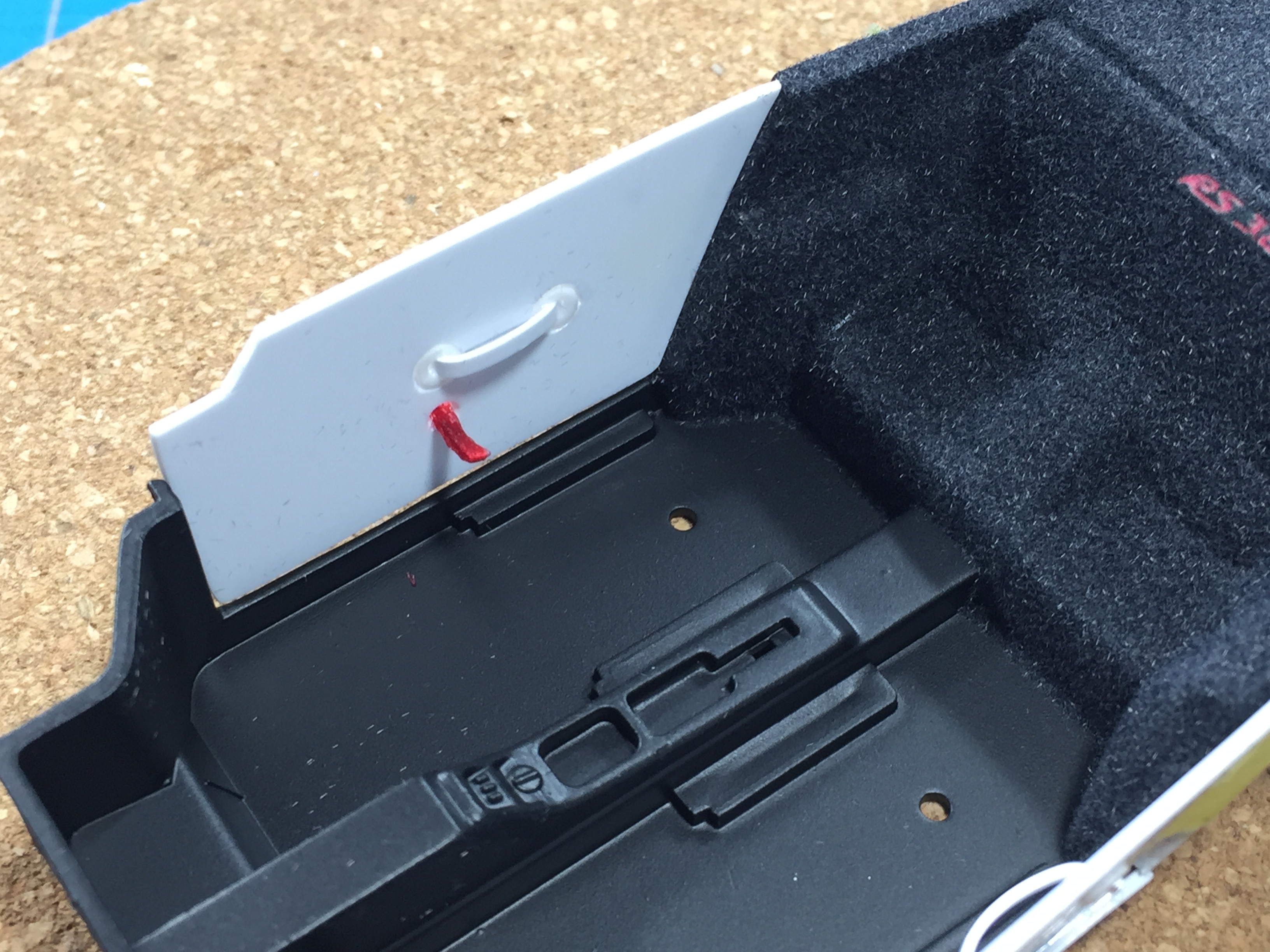

afx Posted October 8, 2018 Share Posted October 8, 2018 (edited) I was studying the interior in preparation for a race car conversion and was planning to remove the upper portion of the rear seats completely and replacing it with flat stock. Would do the same for the rear seat cushions. Interested in seeing how your method turns out. Body looks good. Edited October 8, 2018 by afx Quote Link to comment Share on other sites More sharing options...

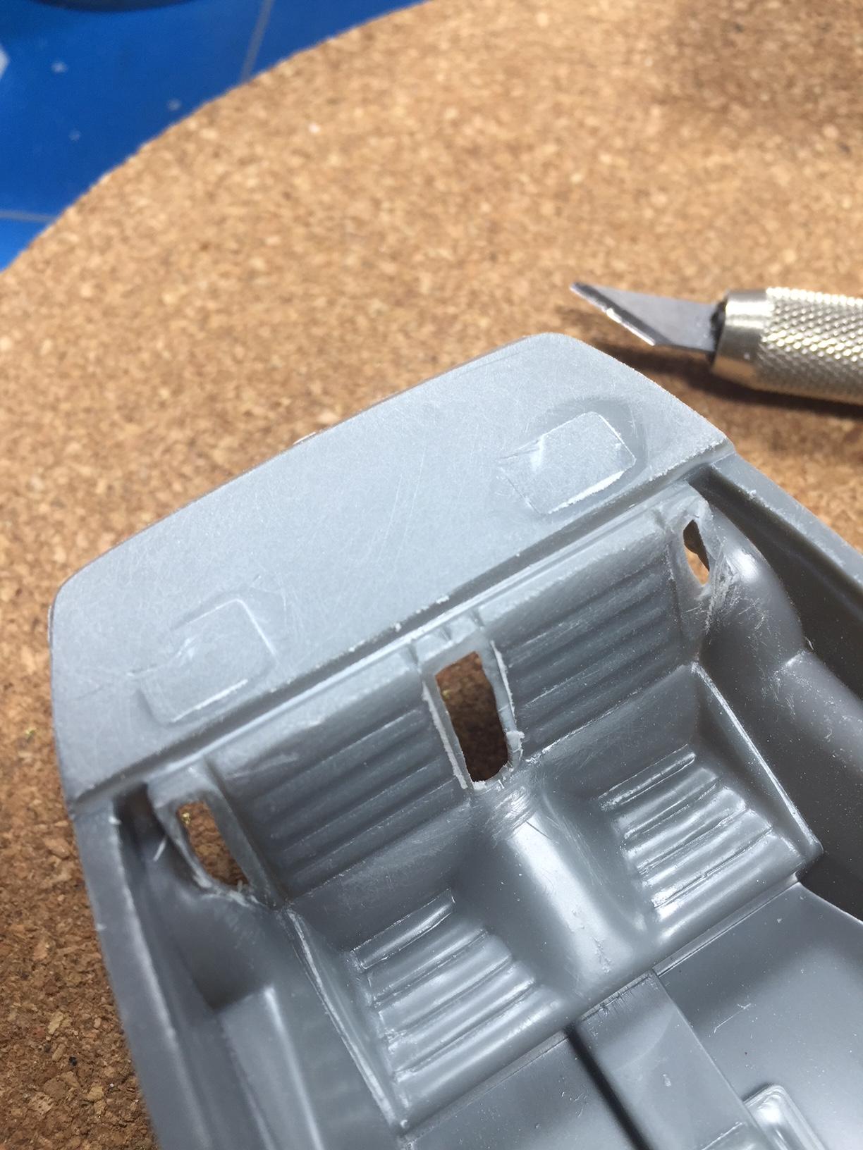

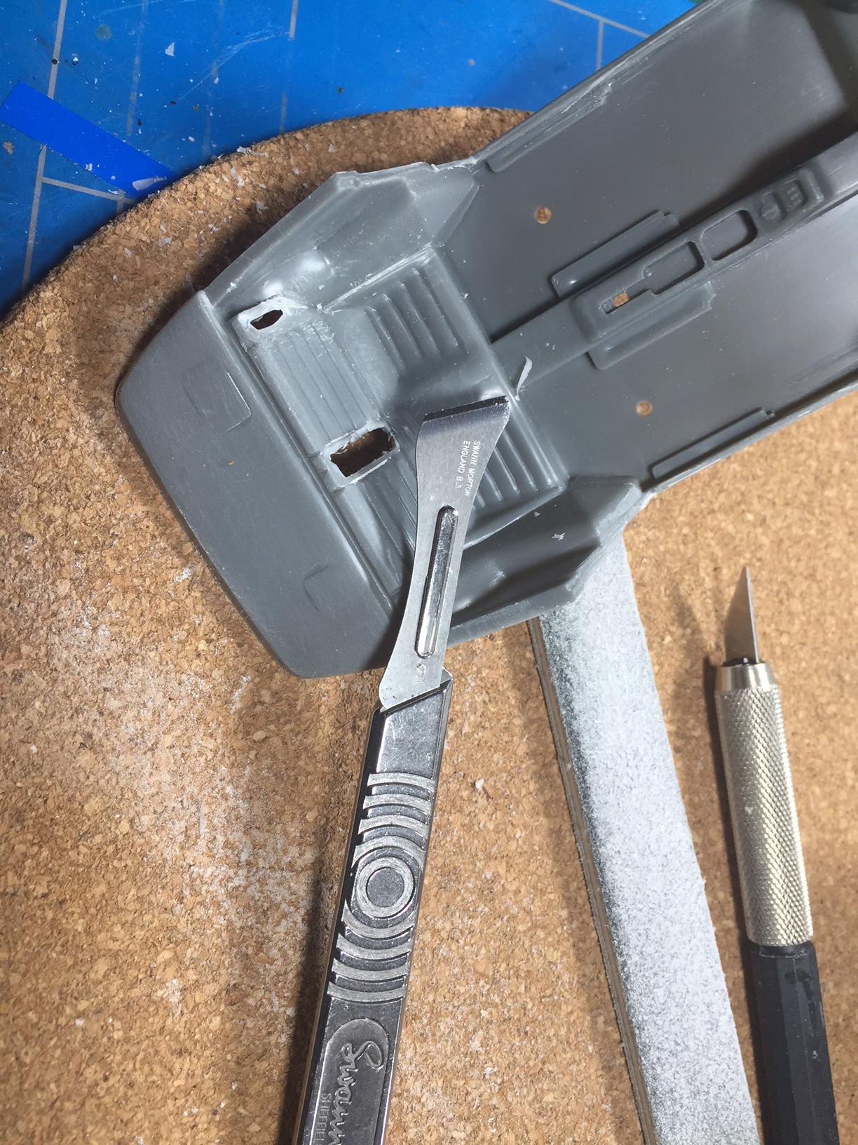

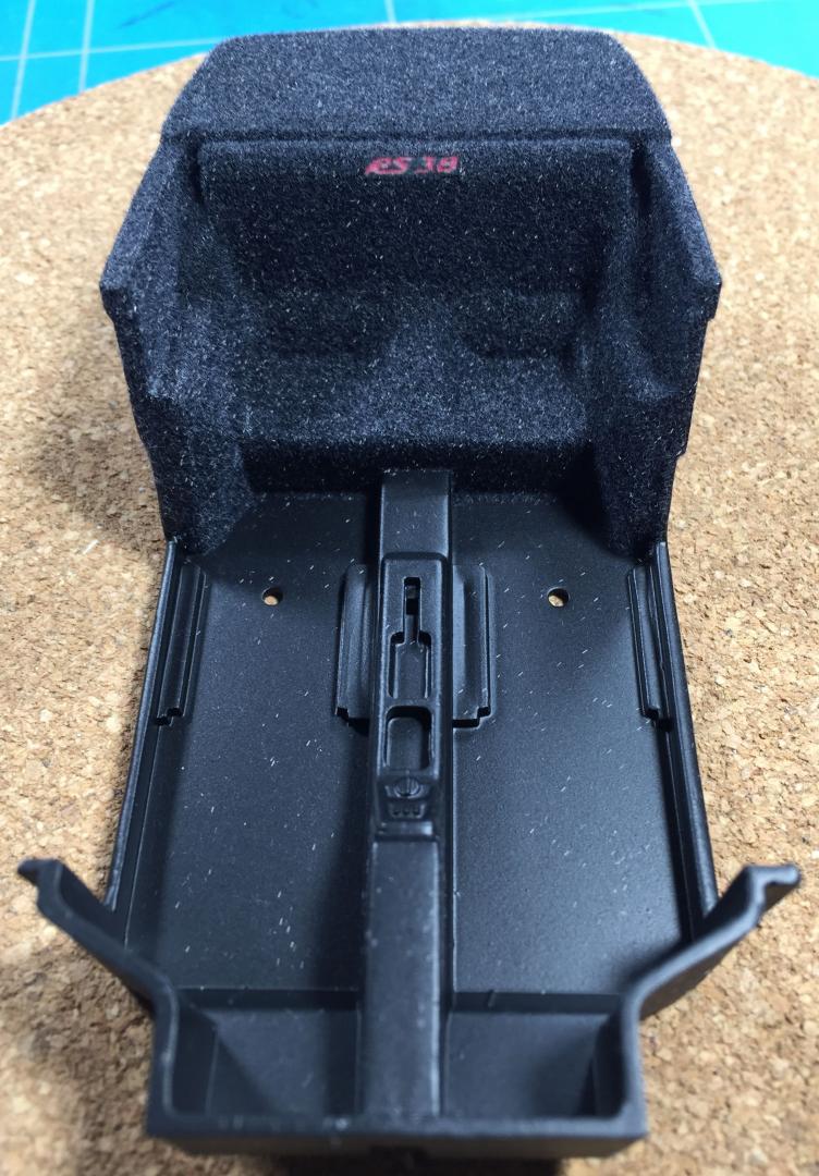

Tommy124 Posted October 8, 2018 Author Share Posted October 8, 2018 29 minutes ago, afx said: I was studying the interior in preparation for a race car conversion and was planning to remove the upper portion of the rear seats completely and replacing it with flat stock. Would do the same for the rear seat cushions. Interested in seeing how your method turns out. Body looks good. Thanks JC. In fact I was contemplating to do the same "cutting job" but decided to work my way around it. Note that the shape of the "seat pans" is still visible in the car, so to me it's mainly about removing the leather upholstery structure on the seats and backrest and cutting/ sanding down the higher parts of the backrest. I guess this will look alright once the black flocking has been done... Quote Link to comment Share on other sites More sharing options...
afx Posted October 8, 2018 Share Posted October 8, 2018 I think your method Thomas will work better for the street version as it does have some upholstery. I want to build a fully gutted competition interior. Quote Link to comment Share on other sites More sharing options...
Dann Tier Posted October 8, 2018 Share Posted October 8, 2018 Looking okay??….more like; BRILLIANT!!!! Quote Link to comment Share on other sites More sharing options...

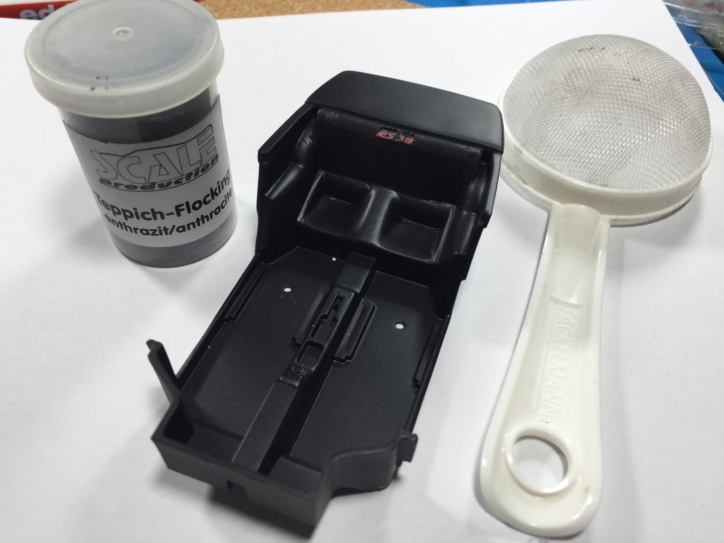

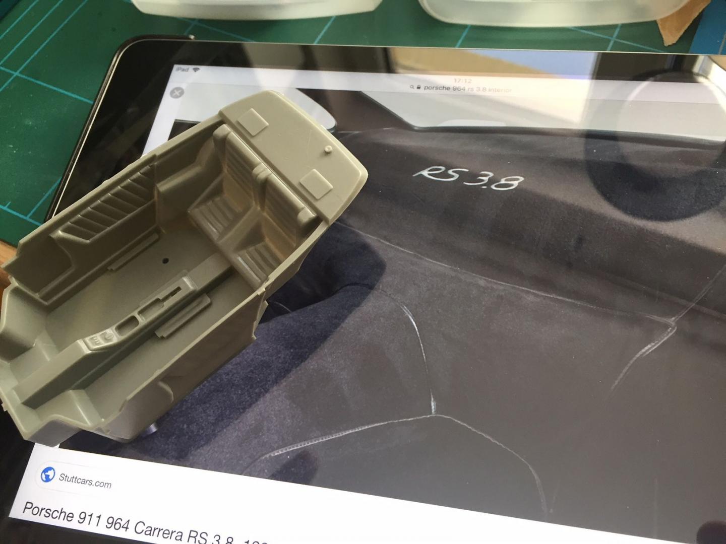

Tommy124 Posted October 9, 2018 Author Share Posted October 9, 2018 (edited) 18 hours ago, Dann Tier said: Looking okay??….more like; BRILLIANT!!!! Thanks a lot, Dann. I'm glad you like the progress... 18 hours ago, afx said: I think your method Thomas will work better for the street version as it does have some upholstery. I want to build a fully gutted competition interior. That makes sense, JC. A competition racer will be stripped of carpets etc. as far as possible. For "my" car, this is more like a more powerful, lightweight and widebody - but still roadgoing - version of the Carrera. So there may be some carpet. Speaking of which... This is more or less what I am trying to archieve: In order to replicate the "RS 3.8" lettering, I made a small paper printout from an image I found on the internet. I glued it into place prior to the flocking. I added the "lightweight" door handles made out of styrene to the SB door panels. There will be additional red "hand loops" on each side which I will make out of red seat belt textile. I tried it out on one panel already. Test fit: To be continued... Edited October 9, 2018 by Tommy124 Quote Link to comment Share on other sites More sharing options...
afx Posted October 9, 2018 Share Posted October 9, 2018 Interior looks great Thomas. Quote Link to comment Share on other sites More sharing options...
Italianhorses Posted October 9, 2018 Share Posted October 9, 2018 That a great flocking job. Quote Link to comment Share on other sites More sharing options...
Ich_Will Posted October 9, 2018 Share Posted October 9, 2018 Looks fantastic. I haven't built a 911 since I was a wee lad. This has reminded me how much I love them. Might have to look into something...at any rate, I'm following this. Quote Link to comment Share on other sites More sharing options...
Dann Tier Posted October 9, 2018 Share Posted October 9, 2018 DAS IST SEHR WUNDERBAR!!!!!!!! Quote Link to comment Share on other sites More sharing options...
Tommy124 Posted October 10, 2018 Author Share Posted October 10, 2018 (edited) 22 hours ago, afx said: Interior looks great Thomas. 18 hours ago, Italianhorses said: That a great flocking job. Thanks JC and Alex, there'll be more flocking for the floor mats. Moreover I am planning on making the seats and belts the same color scheme like on the iPad photo. I gather a bit of a "friendly grey" and red belts will lighten up the otherwise dark interior. And I will use Dann's way of making the buckles... 18 hours ago, Ich_Will said: Looks fantastic. I haven't built a 911 since I was a wee lad. This has reminded me how much I love them. Might have to look into something...at any rate, I'm following this. Thanks, William! It's a great compliment that my build might inspire you to go for a Porsche build yourself. Would like to see that! 12 hours ago, Dann Tier said: DAS IST SEHR WUNDERBAR!!!!!!!! Danke, Dann! As mentioned above, I will use your way of making the buckles. Hopefully they turn out to be half as good as yours... Edited October 10, 2018 by Tommy124 Quote Link to comment Share on other sites More sharing options...

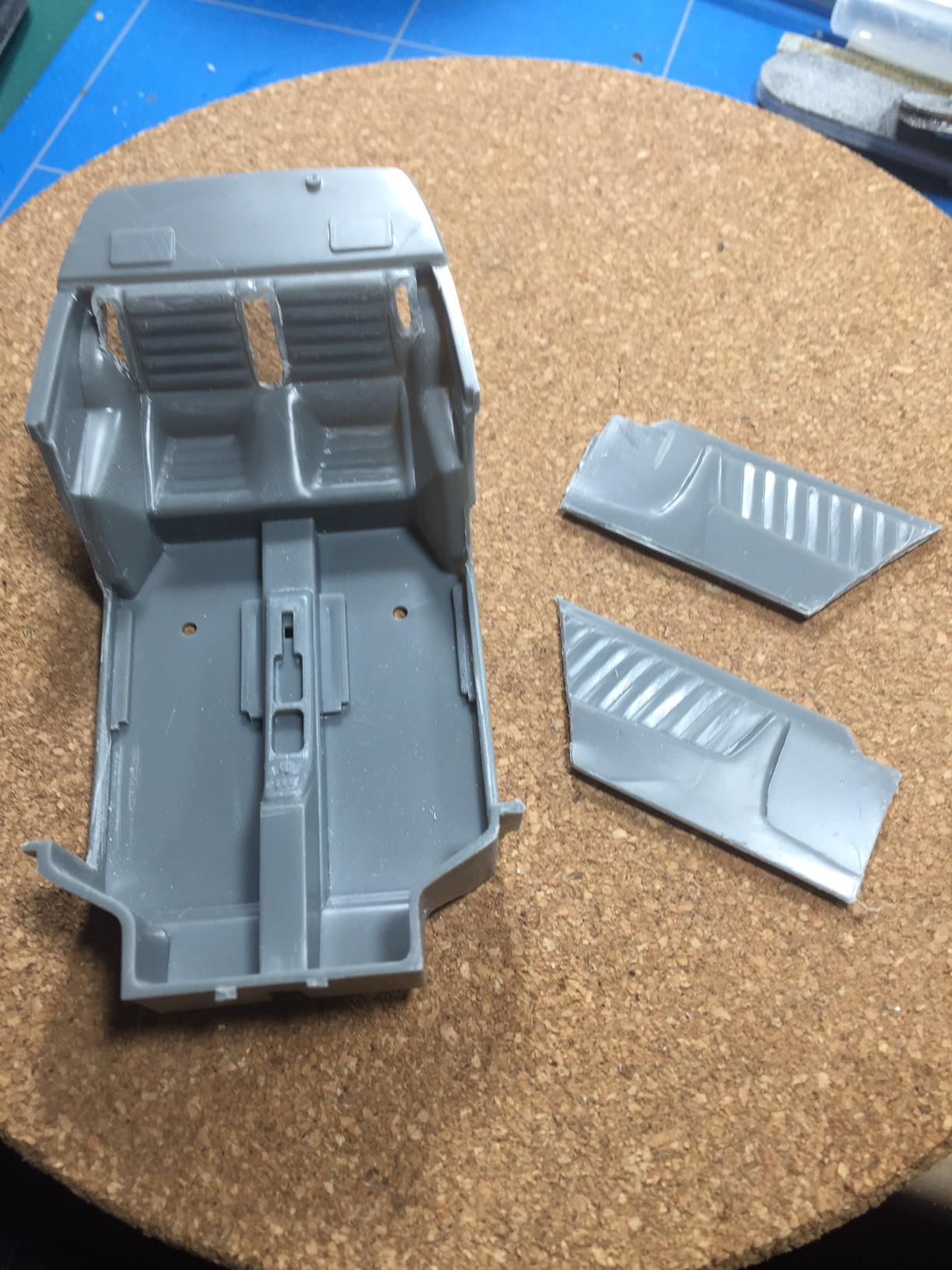

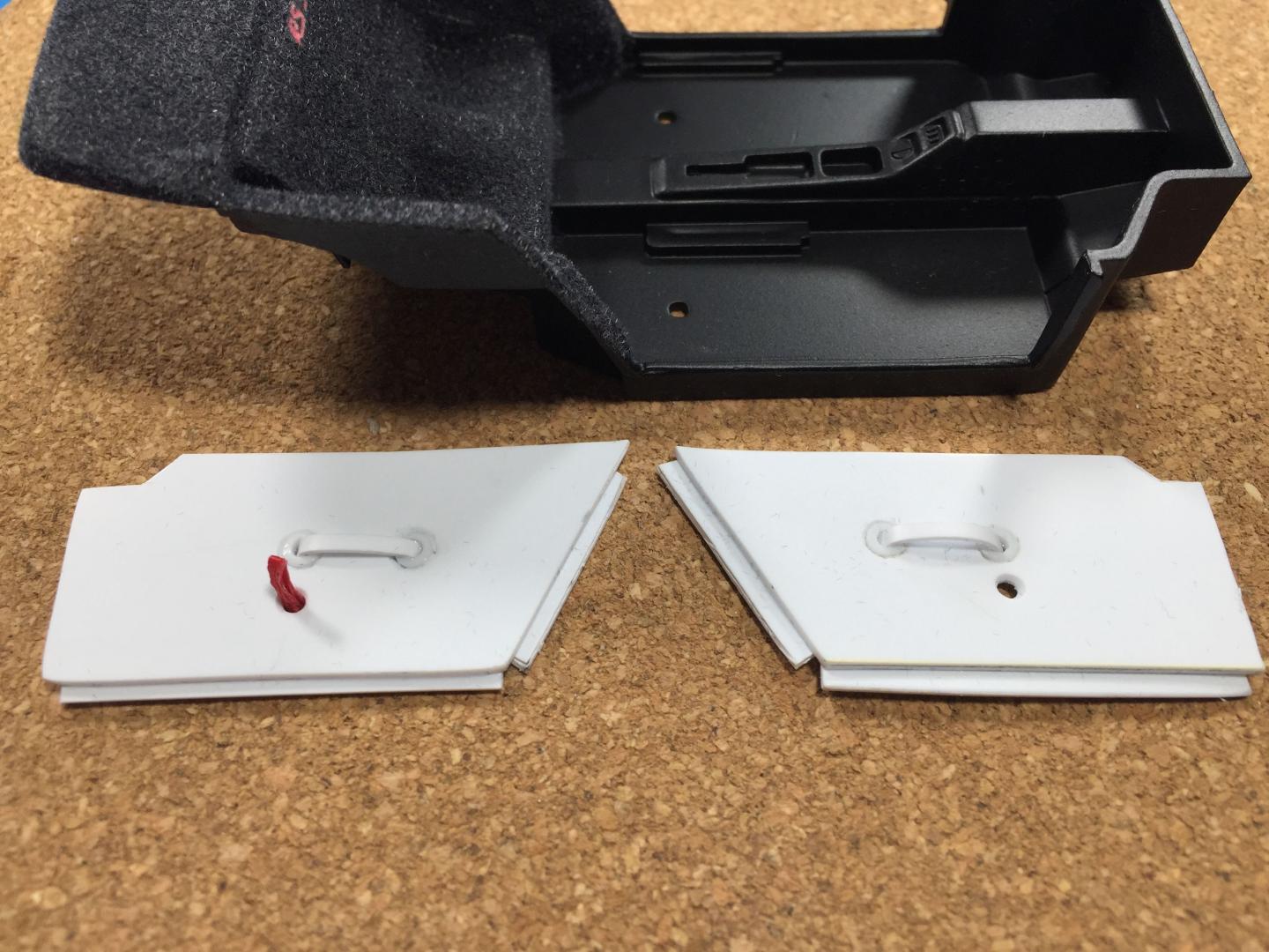

afx Posted October 21, 2018 Share Posted October 21, 2018 (edited) Thought I would share my results on rear seat removal for the racing interior Thomas, hope you don't mind. I removed the seat cushions and seat back and replaced it with flat stock Edited October 21, 2018 by afx Quote Link to comment Share on other sites More sharing options...
SSNJim Posted October 21, 2018 Share Posted October 21, 2018 Thanks for the rear seat pictures and ideas, guys! I just picked up a Tamiya 911GT3, and the instructions say to just place the supplied carpet over the seats to hide the seats. That doesn't seem right to me. I haven't made it to that point yet, but this will be a big help. Now to go get the tub out of the box, and the instructions.... Quote Link to comment Share on other sites More sharing options...

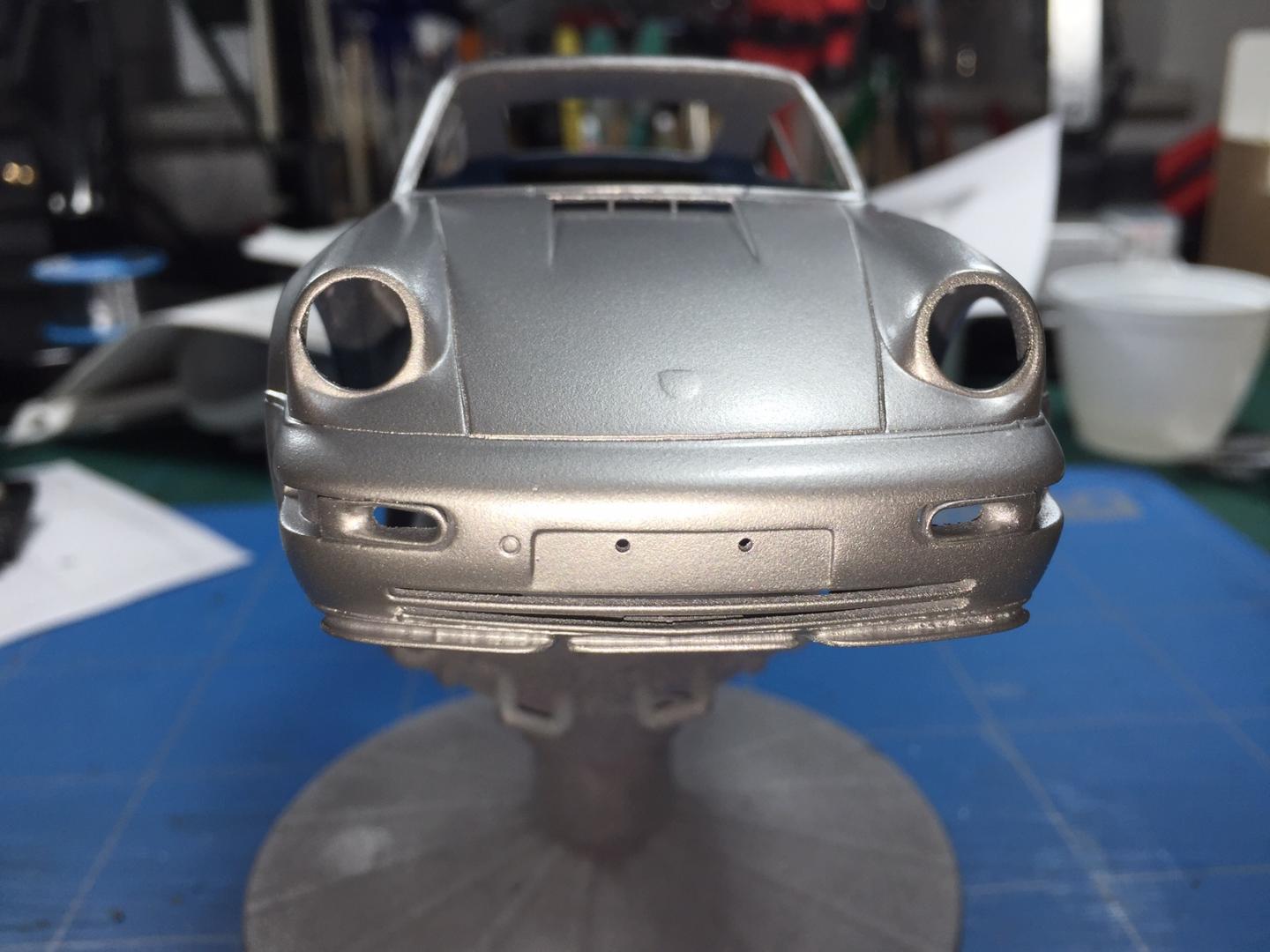

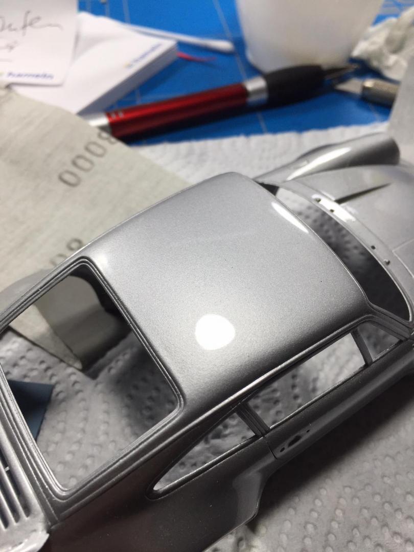

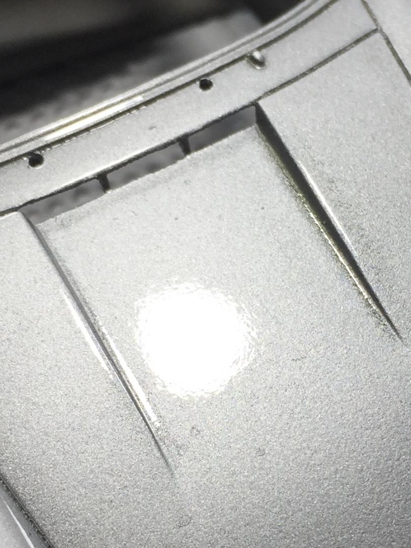

Tommy124 Posted October 22, 2018 Author Share Posted October 22, 2018 18 hours ago, afx said: Thought I would share my results on rear seat removal for the racing interior Thomas, hope you don't mind. I removed the seat cushions and seat back and replaced it with flat stock Looks great JC, good effort. Guess the same thing will happen to the door panels? As to my own progress, the work on fitting the aftermarket brakes and rims has become somewhat tiresome. As mentioned above, I will show the process in details once it's done but I assume I will take a break from this build for a while and do something "quicker" in the meantime. Thinking of making a restoration to an old, simple kit... Before that, however, I will post the images on the Porsche's body paint job. During all of my research on this car I saw lots of images of the car in silver and l liked it a lot. There was one favorite color I would have done rather than that and that would be amethyst metallic. However, as at this stage that color wasn't available to me, I went for silver. The color of choice is Tamiya TS 17. After that I gave it a shot with Spraila automotive 1k clear from the can. Orange peel, right? Right! There just HAS to be orange peel on my clear, otherwise something's wrong... But with a lot of elbow grease, and using Tamiya sanding sponge 3000 grit and Micro Mesh grit 3200 up to 12000 (all sanded wet), followed by polishing all 3 Tamiya compounds, the result was more to my liking: To be continued... Quote Link to comment Share on other sites More sharing options...
afx Posted October 22, 2018 Share Posted October 22, 2018 19 minutes ago, Tommy124 said: Looks great JC, good effort. Guess the same thing will happen to the door panels? Yes lots more work to make a racing interior but I'll start my own thread when the time comes. Paint looks good. Quote Link to comment Share on other sites More sharing options...
FabbricaP Posted October 22, 2018 Share Posted October 22, 2018 Body looks great JC. Always Love seeing that glass smooth finish after many hours of sanding n polishing Quote Link to comment Share on other sites More sharing options...
Italianhorses Posted October 22, 2018 Share Posted October 22, 2018 Silver, just like white, is a very hard color to paint. It shows everything. Not quite transparent clear (yellow), dust, too much grain, etc. It is very hard to get just right. Quote Link to comment Share on other sites More sharing options...
afx Posted October 22, 2018 Share Posted October 22, 2018 (edited) 13 hours ago, FabbricaP said: Body looks great JC. Always Love seeing that glass smooth finish after many hours of sanding n polishing This is Thomas' build Jason and his great paint. I just keep intruding on his build thread - my apologies Thomas. Edited October 23, 2018 by afx Quote Link to comment Share on other sites More sharing options...
