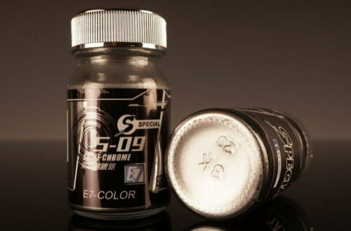

ChrisBcritter Posted July 30, 2019 Posted July 30, 2019 I see E7-Color has a paint called "Shine Chrome" - anyone tried that? Is that what the sealer was intended for? 1
Michael jones Posted July 31, 2019 Author Posted July 31, 2019 2 hours ago, ChrisBcritter said: I see E7-Color has a paint called "Shine Chrome" - anyone tried that? Is that what the sealer was intended for? Yep - see review here:
