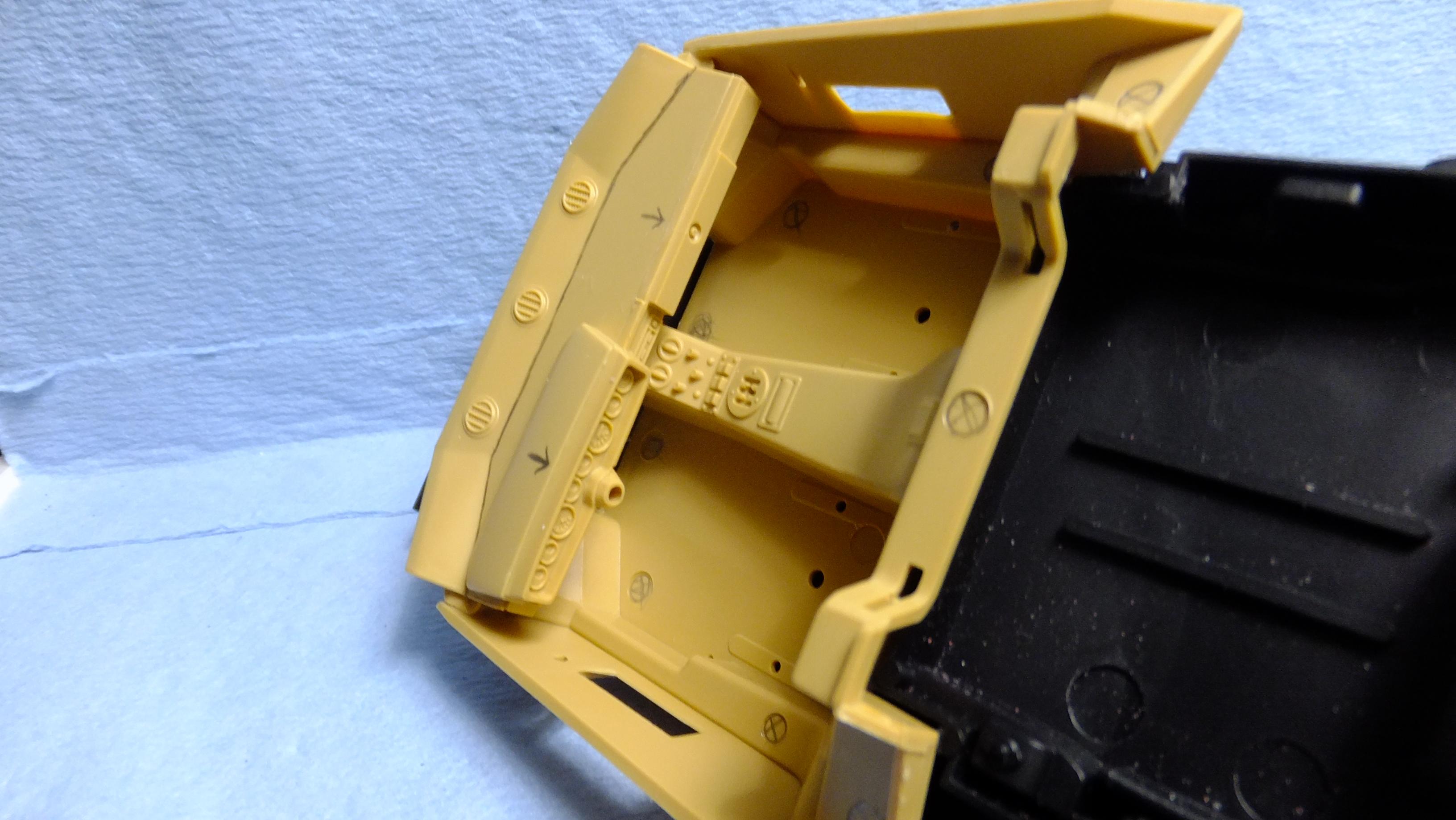

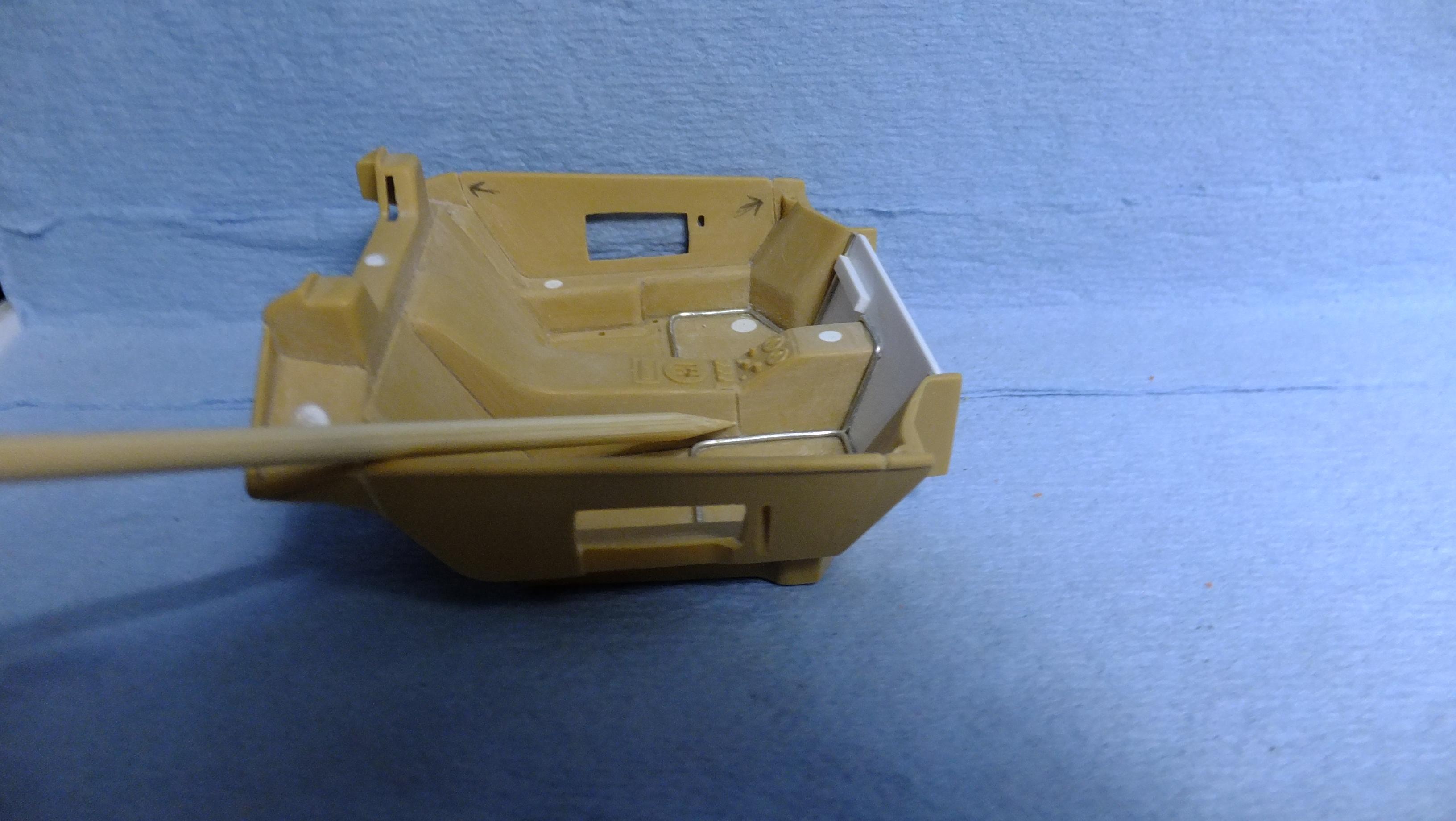

Dann Tier Posted December 18, 2019 Author Share Posted December 18, 2019 A bit of an update here...Time to start tweaking the interior. The arrows point to seams that need to be filled, and the circles with X's shows the MANY ejection pin marks that need filling. Another bit that most people miss, or dont really care about is the fact that the dash top has a seam that splits it length-wise(pencil line shows this). Quote Link to comment Share on other sites More sharing options...

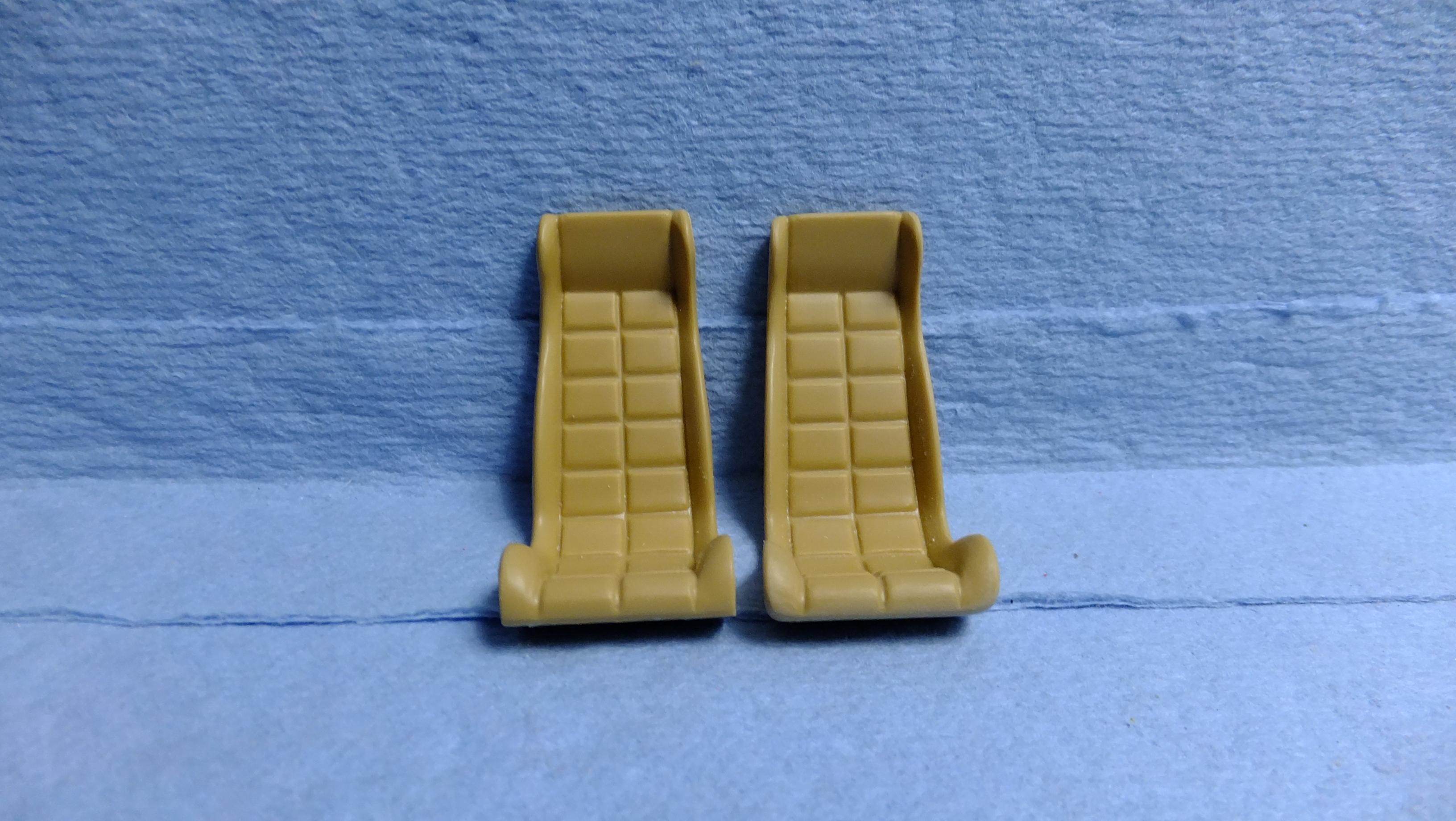

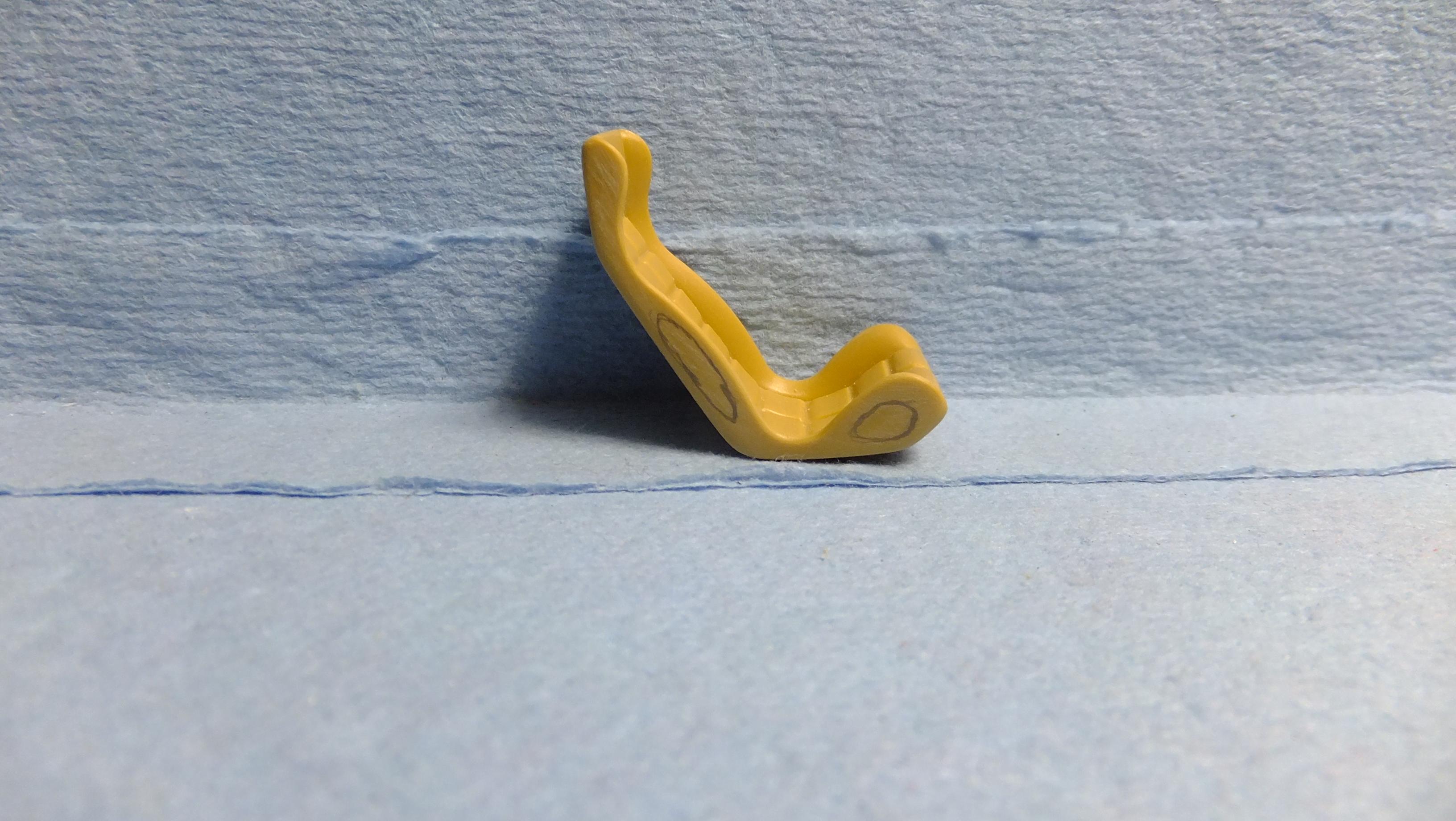

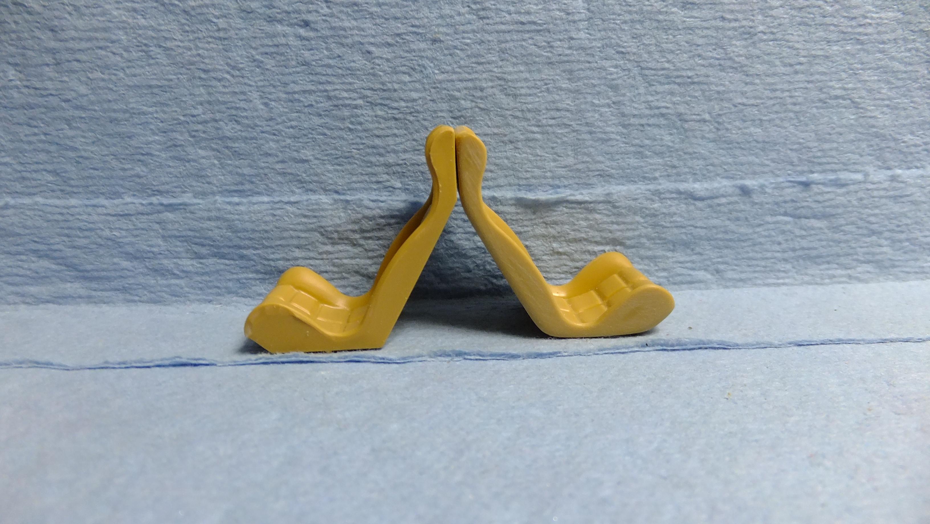

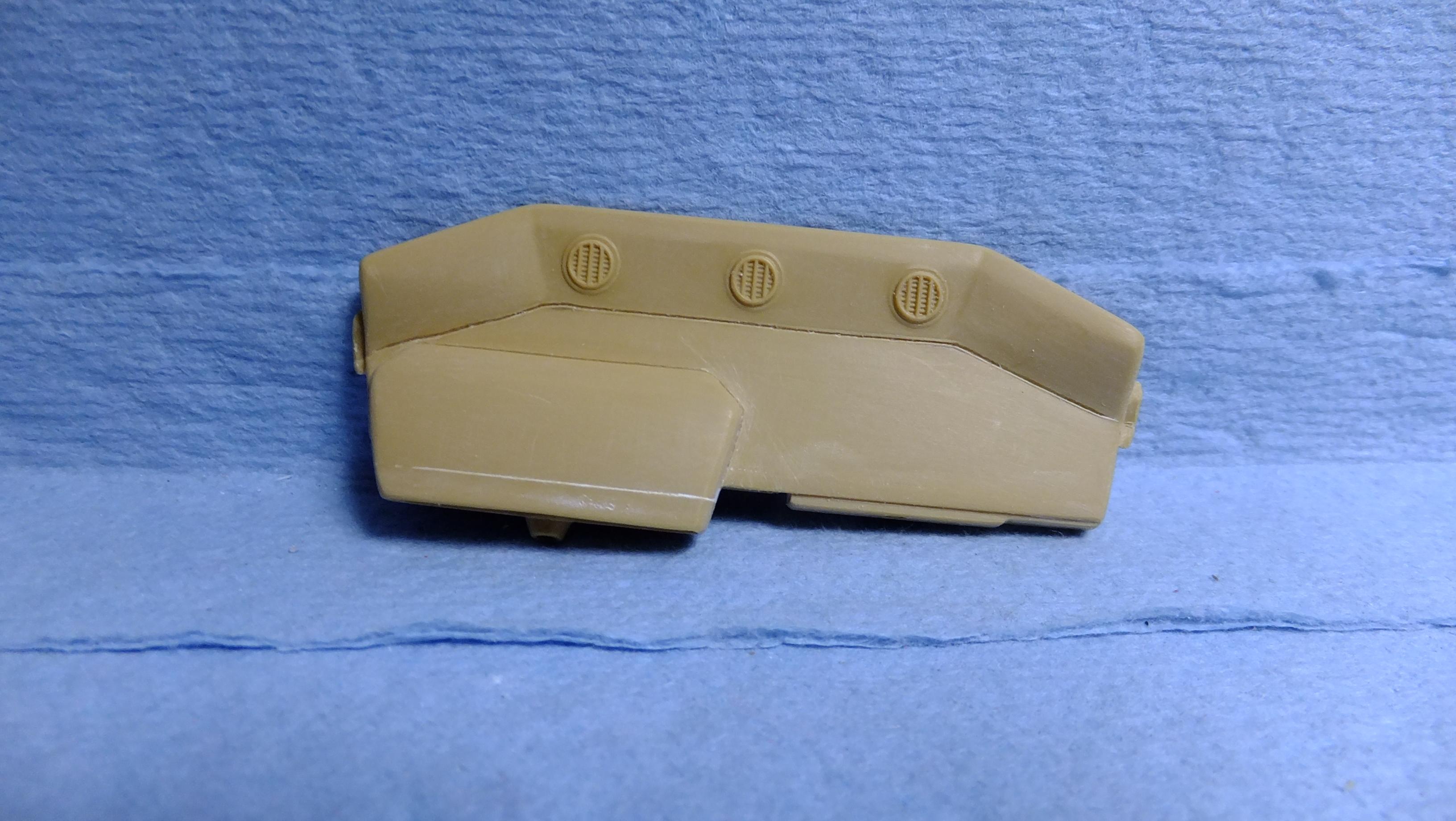

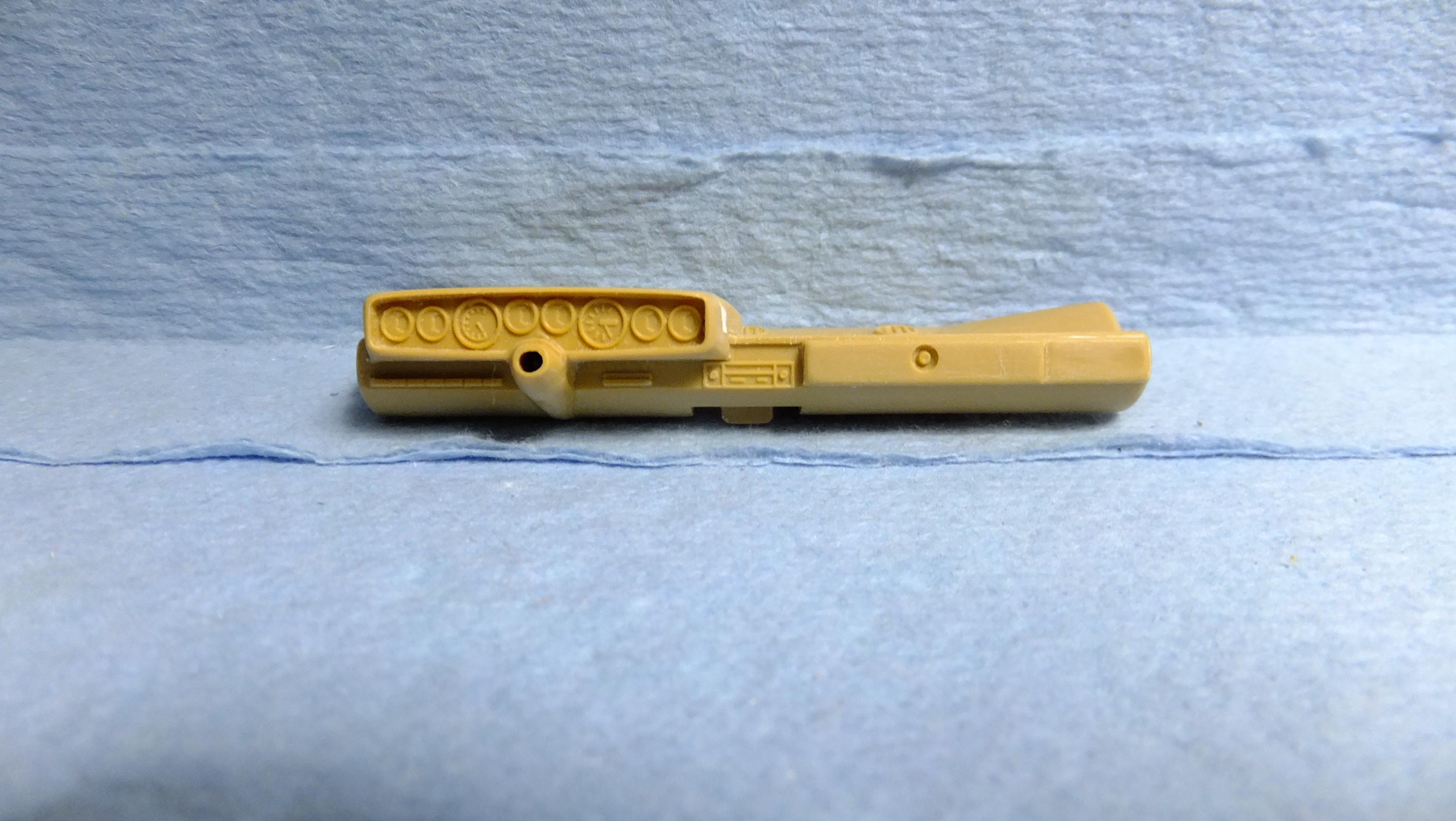

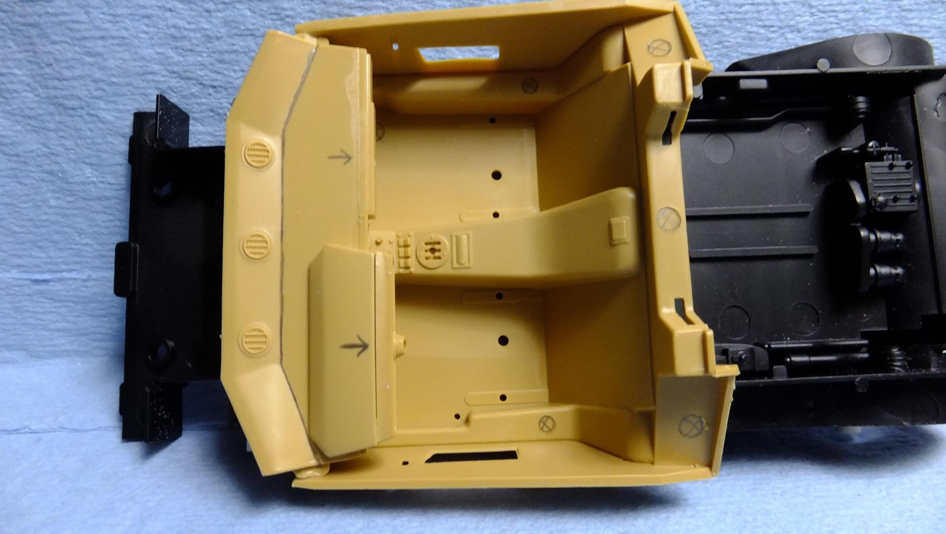

Dann Tier Posted December 28, 2019 Author Share Posted December 28, 2019 (edited) Got quite a bit done recently.....so close to this one being painted as well!! -Photo 1&2; Making more realistic looking seats...Standard kit parts on the left, and my rounded, more padded looking ones on the right. -Photo 3&4; Heres a little tip to add more realism without working at it; instead of getting rid of all the sink marks on seats, leave them if they arent too bad. Anybody whose really looked at seats, knows that the coverings OFTEN sink-in like this in the spots that i've circled here. -Photo 5-7; Time to make the dash more realistic...filling, rounding, and adding seams, really brings this dash to life. -Photo 8; After filling all the ejector pin marks, and properly rounding things, its now time to scribe-in stitching seams in the leather -pencil lines denote where... -Photo 9; Since there wasnt enough detail to show that a door was there, i made a door card stencil so that i could remedy that short coming. The X over the interior light means that i will make a better one, and put it in its proper location. Edited December 28, 2019 by Dann Tier Quote Link to comment Share on other sites More sharing options...

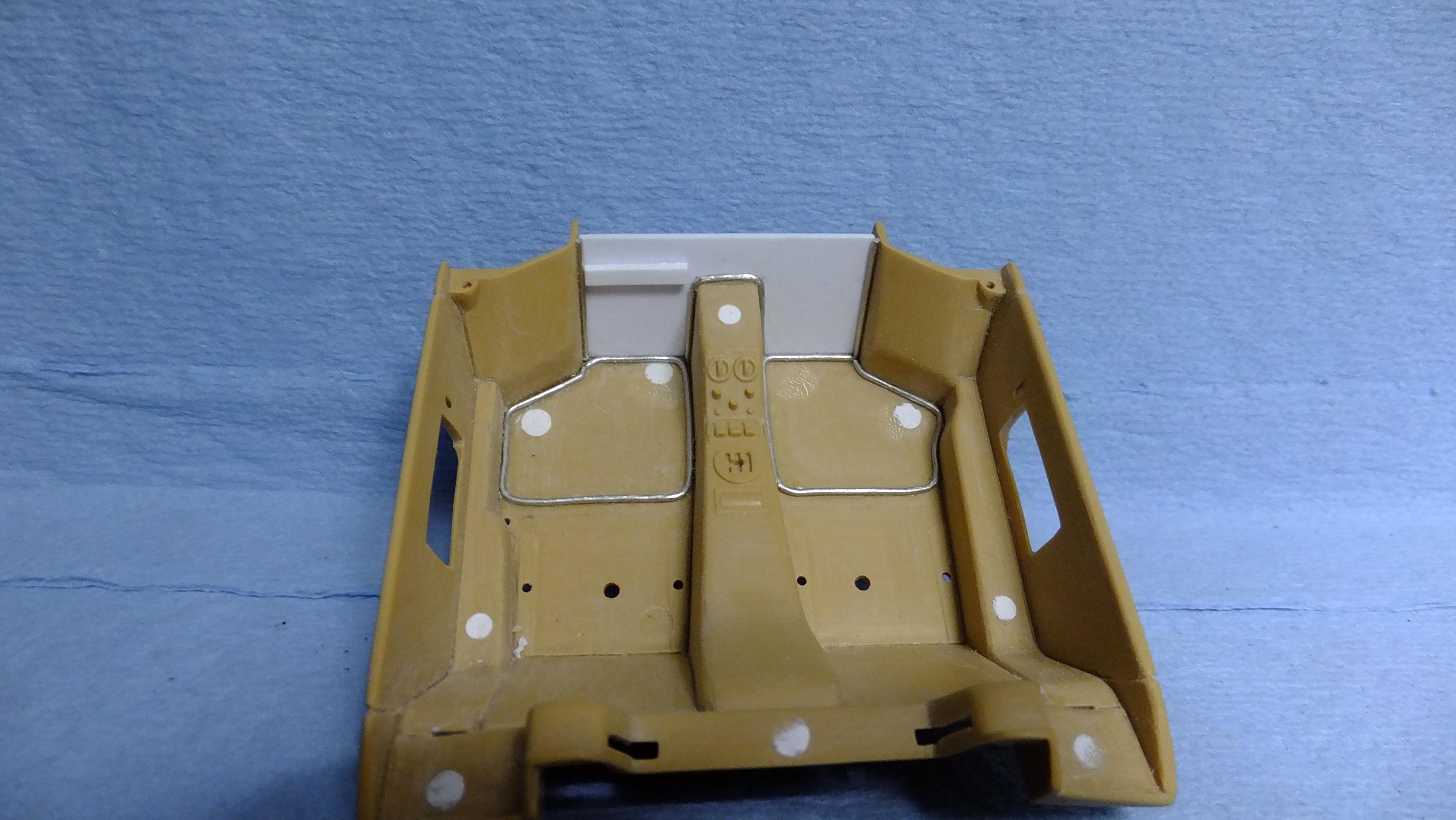

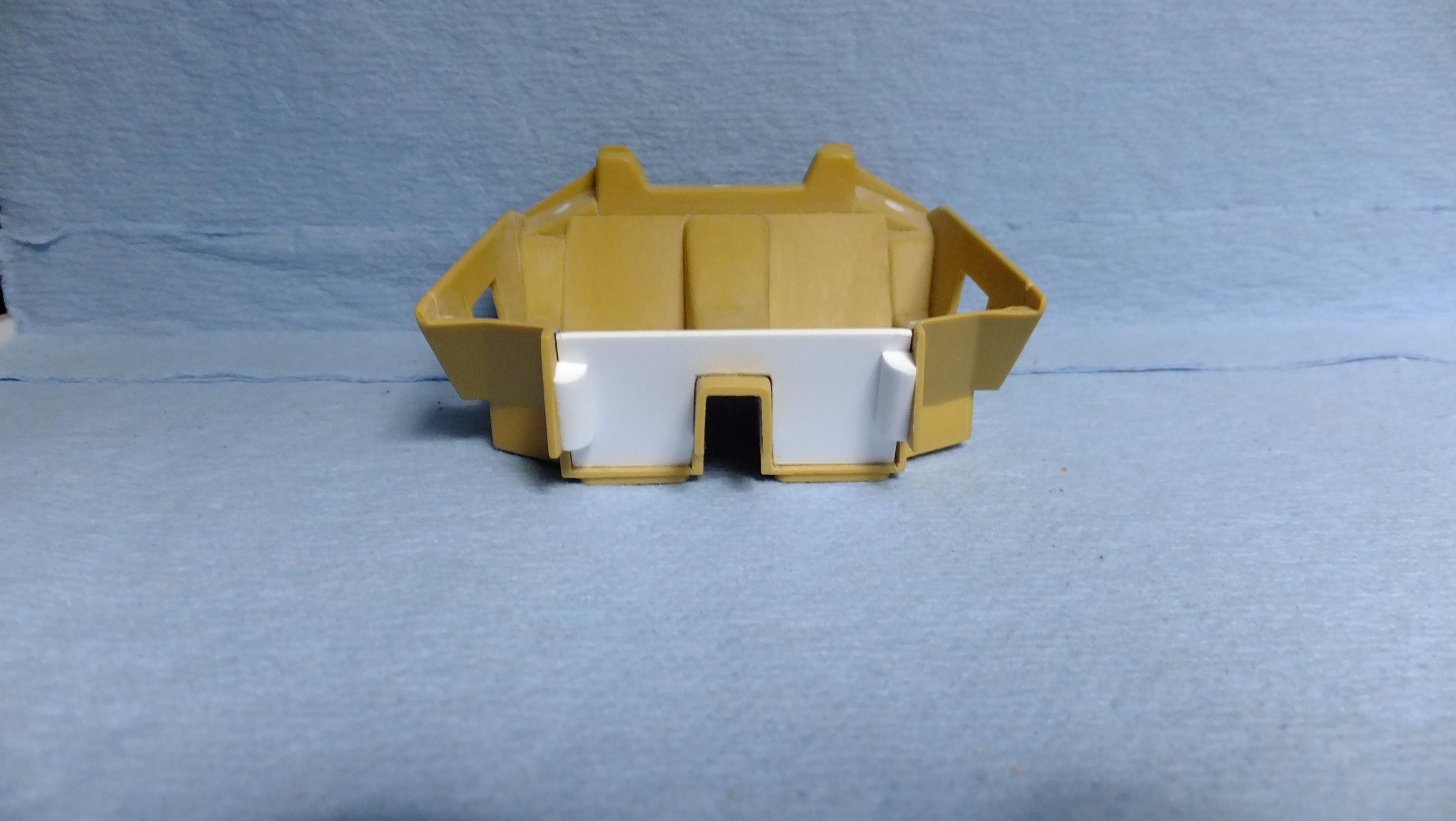

Dann Tier Posted February 29, 2020 Author Share Posted February 29, 2020 (edited) Heres a new update on this build....getting VERY close to painting a bunch of bits! -Photo 1; Here i made separate door cards. They will still get more detailing. I also needed to enlarge the door pockets in the tub so that they wouldnt be seen...later i will add the covers to them. -Photo 2; Cant have door cards without having the seams etched to show that the doors open. Yhe top edges of these doors will now become the window weather stripping, and be painted rubber. -Photo 3&4; Since the foot walls werent there, i had to make them. The styrene block you see, is a locator for the peddles which also werent part of the kit, but i found some in my parts bin. I have also made the carpet, and mat pipping, using solder. Its larger than scale, because once you flock around it, it visually shrinks to the right size. Remember not to make them perfectly straight...they arent on the real cars...this will add some crazy visual interest, and realism without trying too hard. -Photo 5; I cut the slots for the seat belts to retract into. -Photo 6; ...i also cut a slot for the hand brake. -Photo 7; The area i'm pointing at is the split between two padded sections, so i needed to scribe them. -Photo 8; At the last second, i noticed that i forgot to etch all the way round the glove box door. Without doing so, it would have blended into the dash after the painting process, and wouldnt have looked real...as if i could open. -Photo 9; Here i show how i cut a section out of a spare part, and attached it to the uneven side of the chassis(the white slash lines indicate the part i removed from the spare where the arrows point. To take this area a little bit further, i will be adding shocks which didnt come with this kit. Edited February 29, 2020 by Dann Tier Quote Link to comment Share on other sites More sharing options...

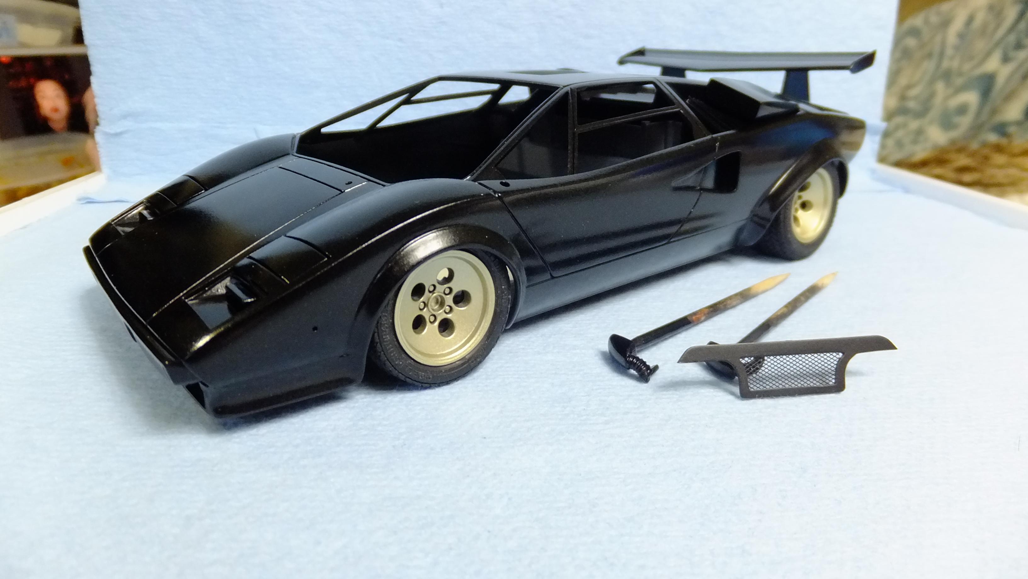

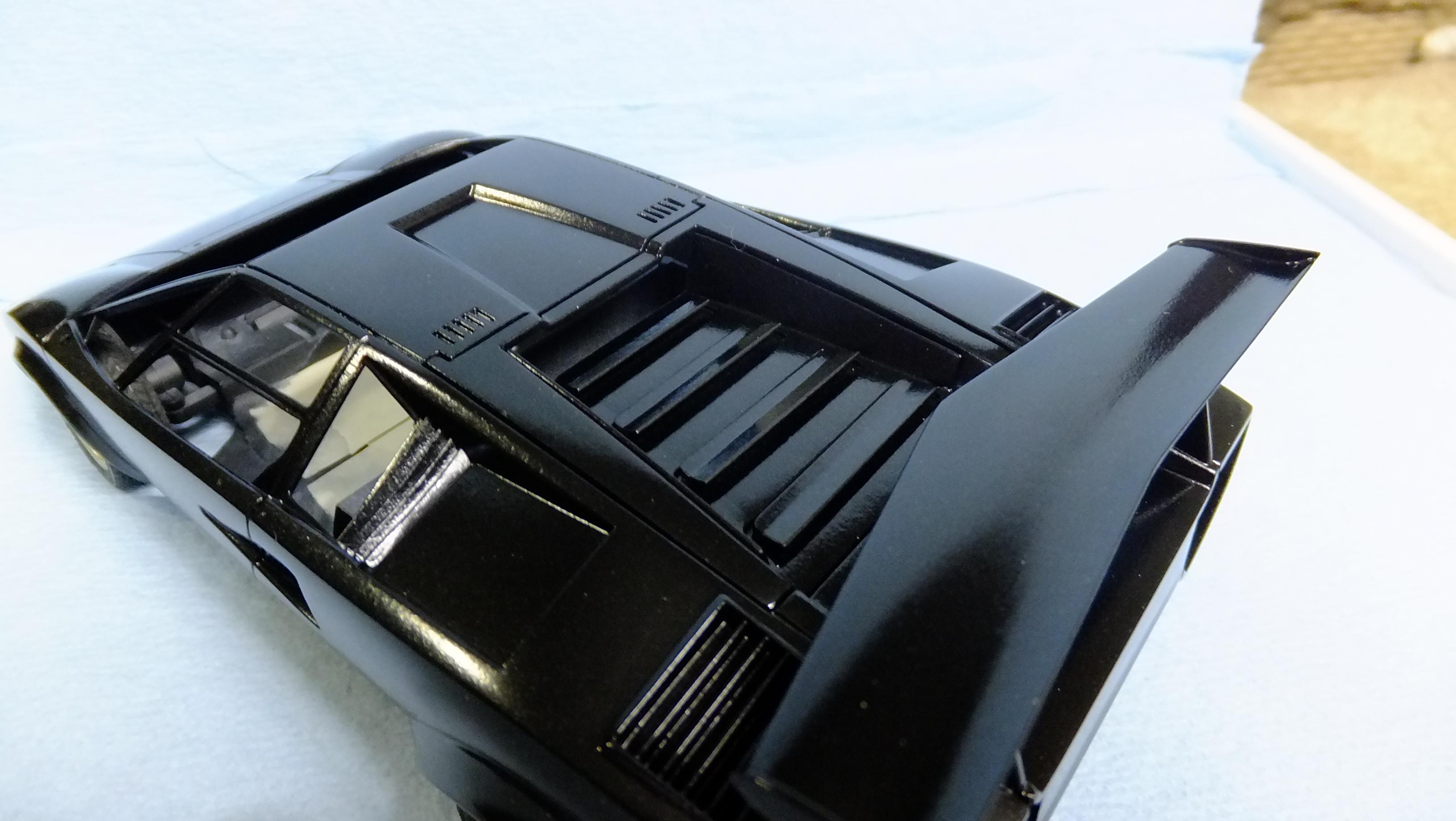

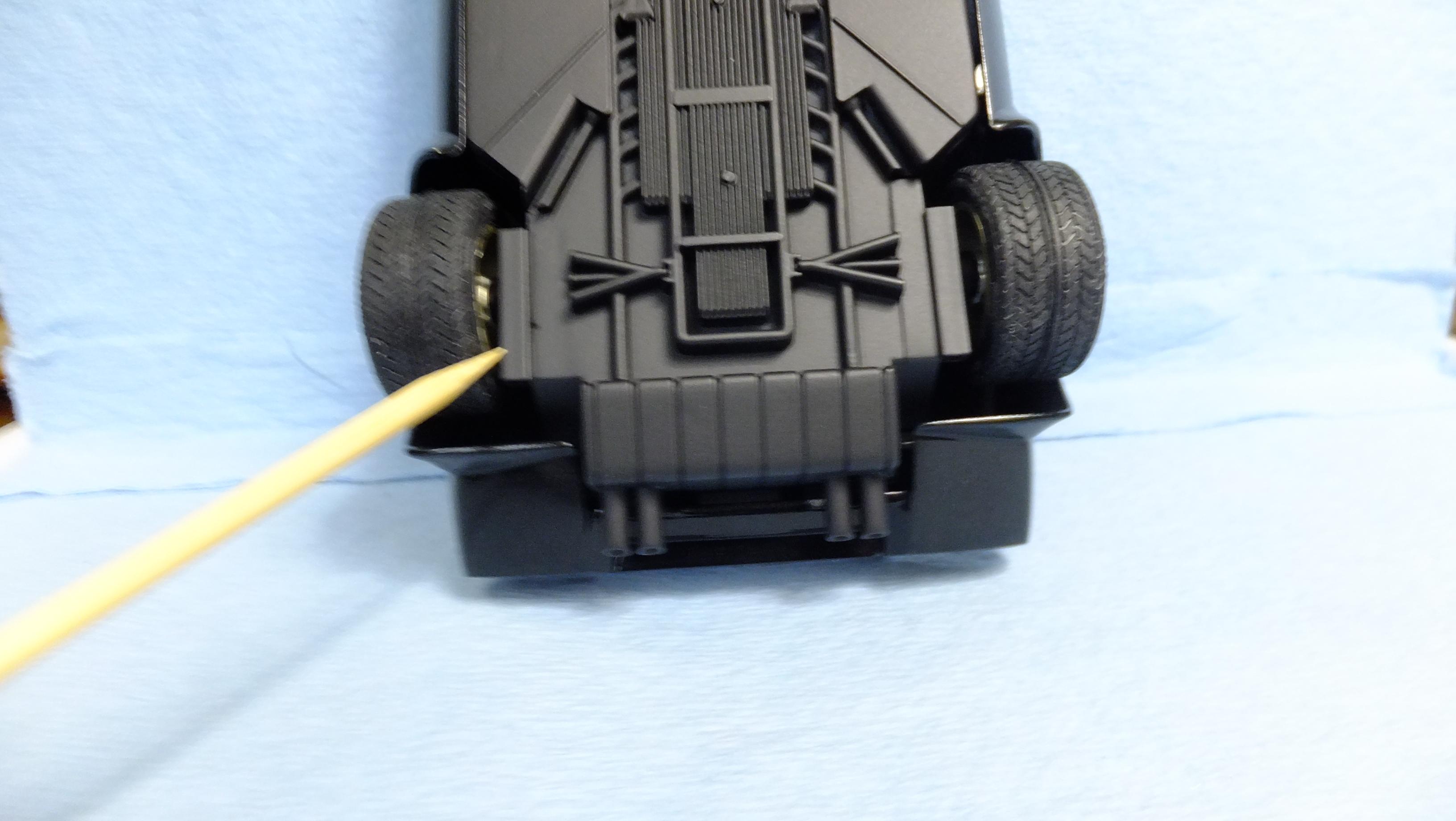

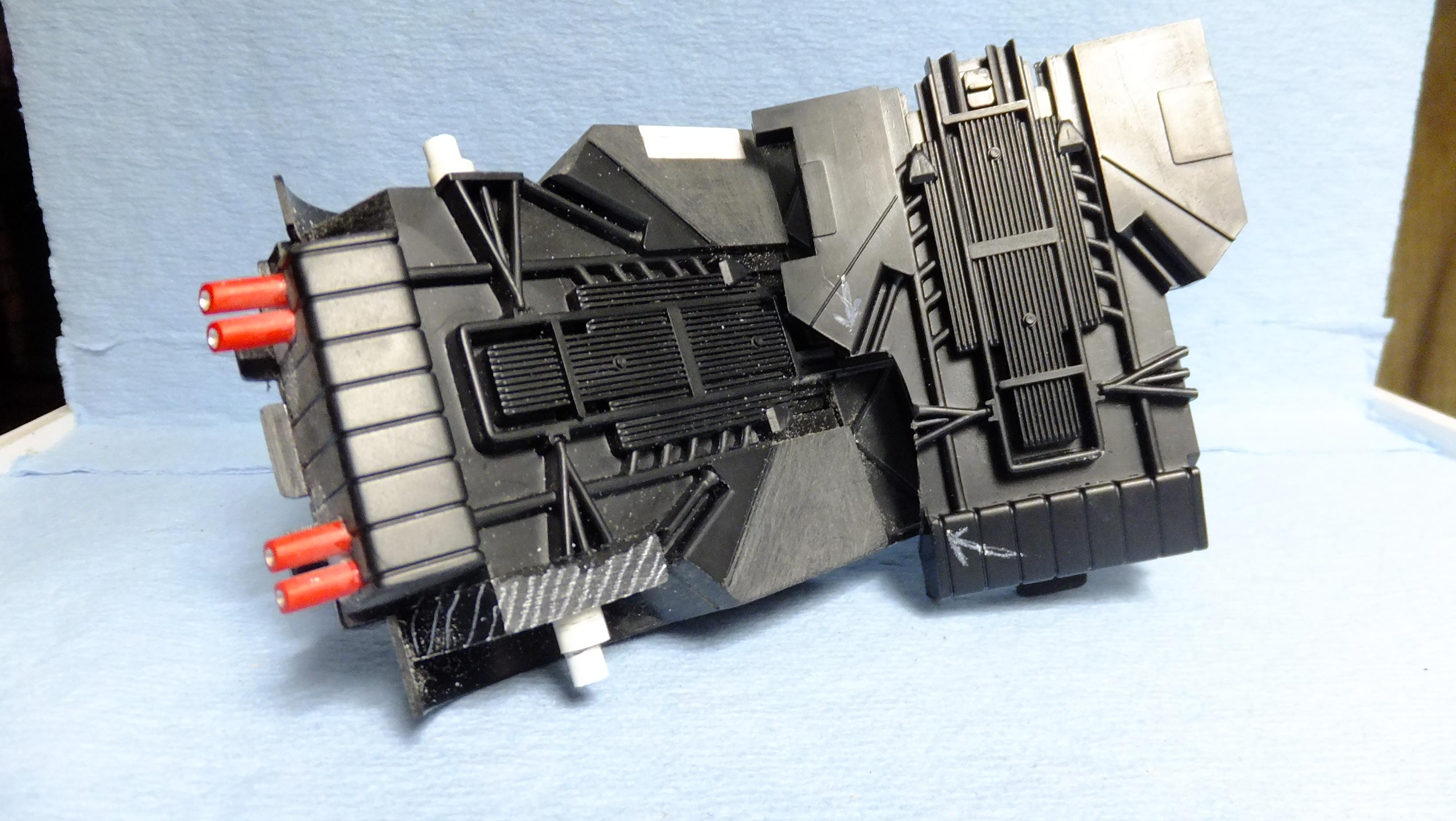

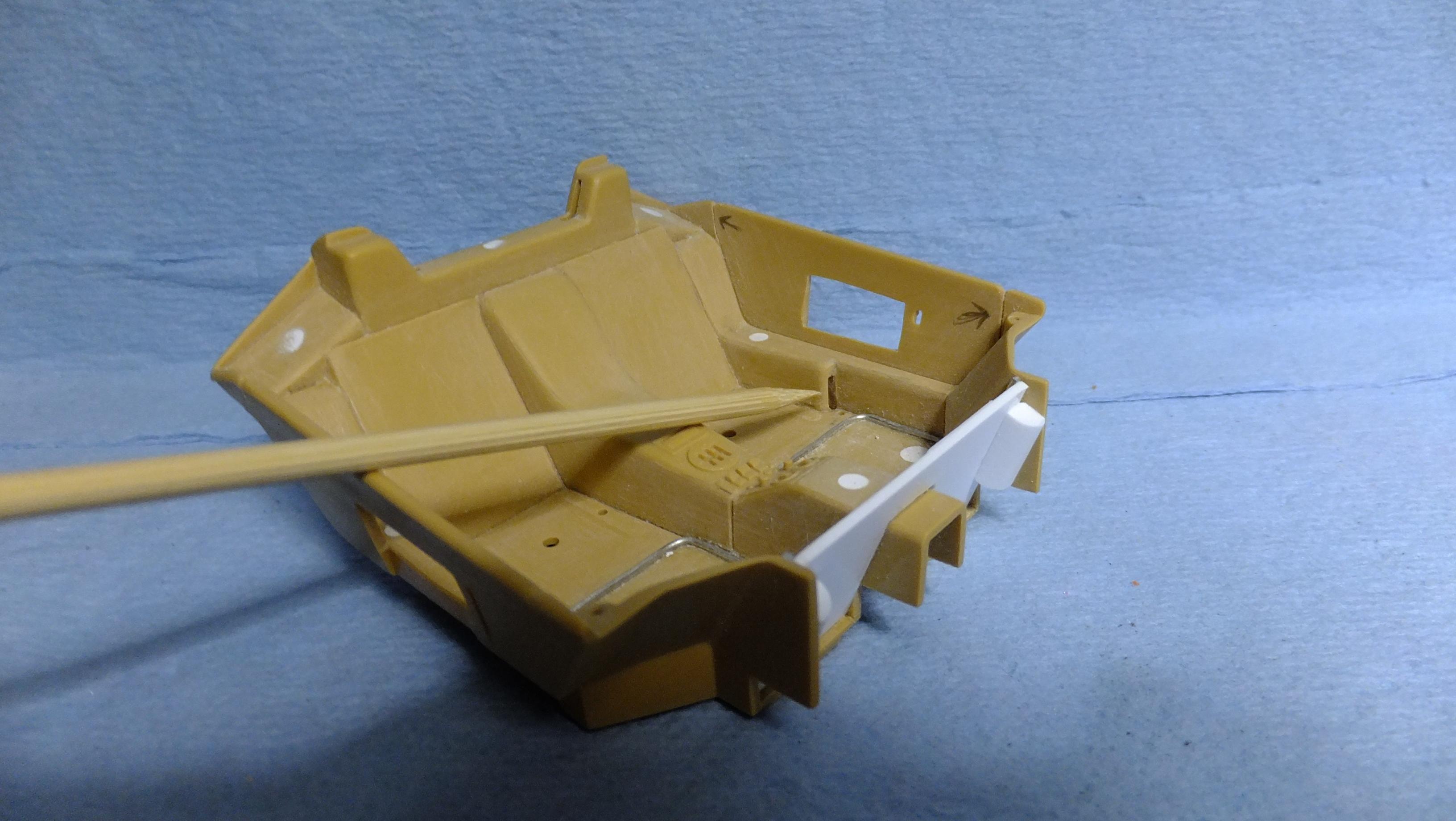

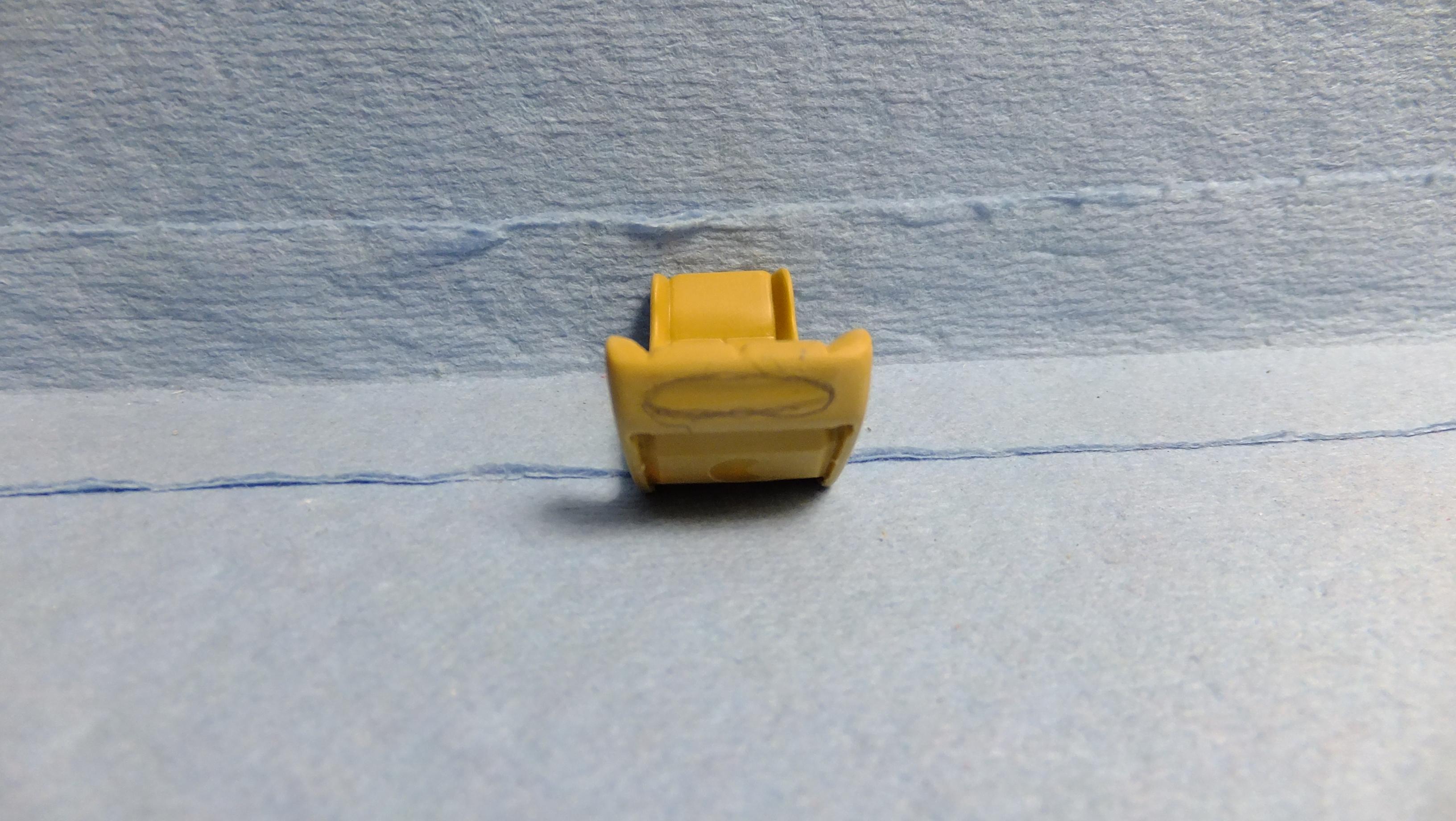

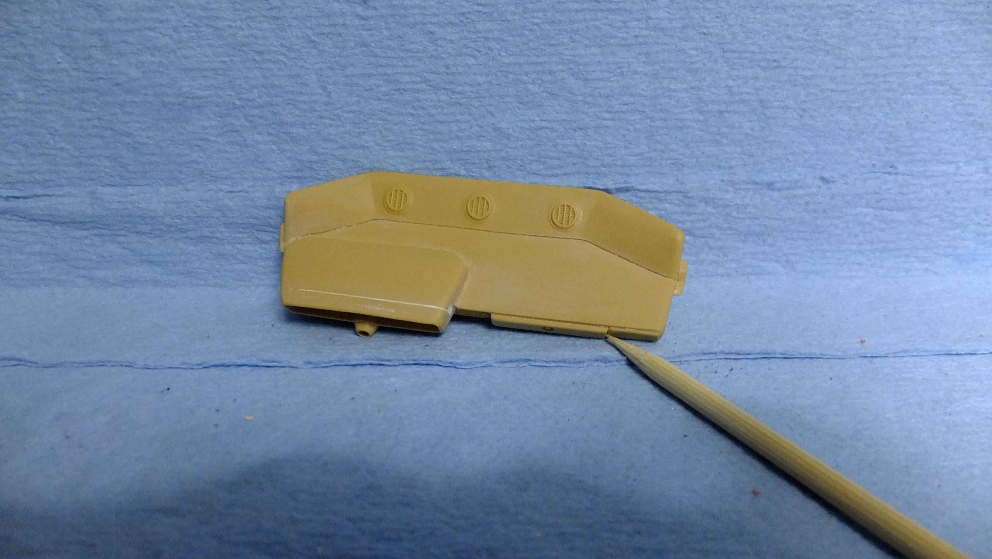

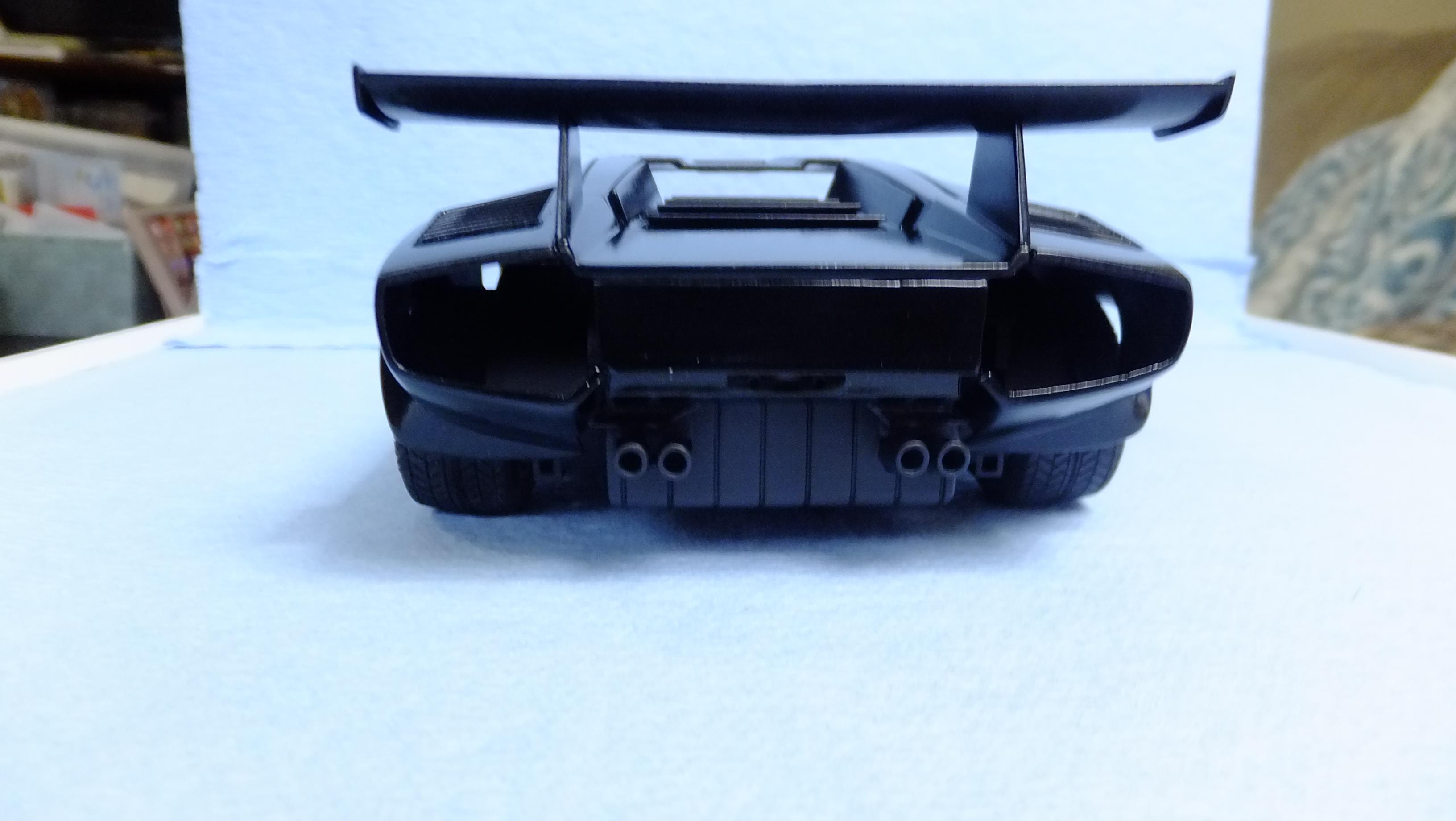

Dann Tier Posted April 14, 2020 Author Share Posted April 14, 2020 (edited) Hey, everyone!...heres a Countach update as well! -Photo 1; Body needs decals, and clear next..and i'm using Aoshima Countach mirrors, and had to SB a better -more realistic muffler heat shield -the molded in one was too short, and not see through. -Photo 2; I removed the molded in license plate frame, and will use Fujimi fog lights for better realism. -Photo 3; Looks waaay better with the lowered ride height, and wider tyres!...notice all the new vents i made for the hood. -photo 4; Better view of the 500s hood that i made. -Photo 5; I added these hollow square tubing to have a contact for the shocks. -Photo 6;All the interior bits ready for detailing, and assembly!...this will be the next build that gets finished. Edited April 14, 2020 by Dann Tier Quote Link to comment Share on other sites More sharing options...
