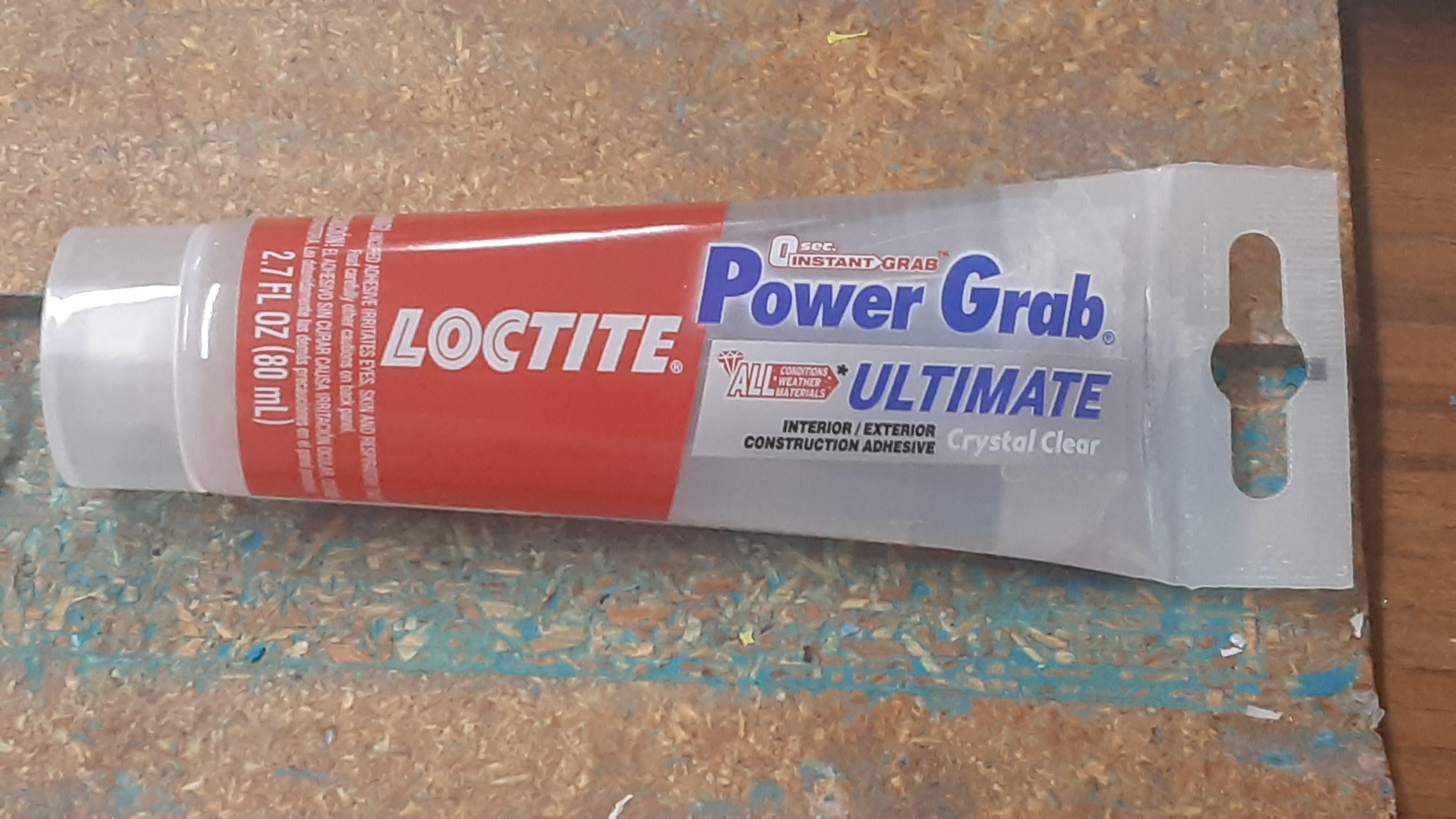

Greg Wann Posted March 28, 2022 Posted March 28, 2022 Why don't we put models together with something like this optically clear silicone? Only a tiny amount should do. It may or may not damage paint if you attempt to take something apart once cured. I bought this at Walmart for about 7 bucks. The wife and I drove to Indiana and spent nearly three months working on a couple of rentals. I bought a DAP brand clear that needed a gun. When I used it it was clear like glass. I said to myself, self! This would be great stuff for model building!!
Mark Posted March 28, 2022 Posted March 28, 2022 I have seen something like that used in certain places on large scale builds. Suspension parts on 1/8 scale cars, where a little "give" might be desirable when handling or moving the finished model.
peteski Posted March 29, 2022 Posted March 29, 2022 Off the top of my head, several reasons (at least for me). The biggest one is drying time. I'm a CA glue junkie (instant setting). Also, silicone is soft and rubbery. That flexibility of all the model's part joints is not something I want in my model. Another thing is that it is messy. Even in small amounts, it will likely ooze from the joint, requiring a cleanup. I don't want to double my build time doing glue cleanup. The next one is related: this stuff is too thick. Some parts need to be assemble in a way that parts touch each other. Also the bond between bare plastic and silicone is not very strong (especially if there is only very thin layer of silicone). When I build my models, they are not designed to be taken apart.

Bills72sj Posted March 29, 2022 Posted March 29, 2022 I think the biggest problem would be adhesion strength. Especially with parts that have very little surface area contact. Like engine fans and rear view mirrors.
NOBLNG Posted March 29, 2022 Posted March 29, 2022 (edited) Not to mention that it’s a good way to contaminate your paint jobs. Silicone and paint do NOT get along! Good luck repainting something thats been put together with silicone. I don’t want it anywhere near my workbench.? Edited March 29, 2022 by NOBLNG
Andrew McD Posted March 30, 2022 Posted March 30, 2022 I expect there would be adhesion problems with the paint. I don't think clear silicone takes paint very well.
Greg Wann Posted March 30, 2022 Author Posted March 30, 2022 Those are good points. I use clear silicone for doing my resin casting work. It can be dificult to remove. Thought it might work for model building.
Oldcarfan27 Posted March 30, 2022 Posted March 30, 2022 MIGHT be good to hold windows and headlights in place though.
