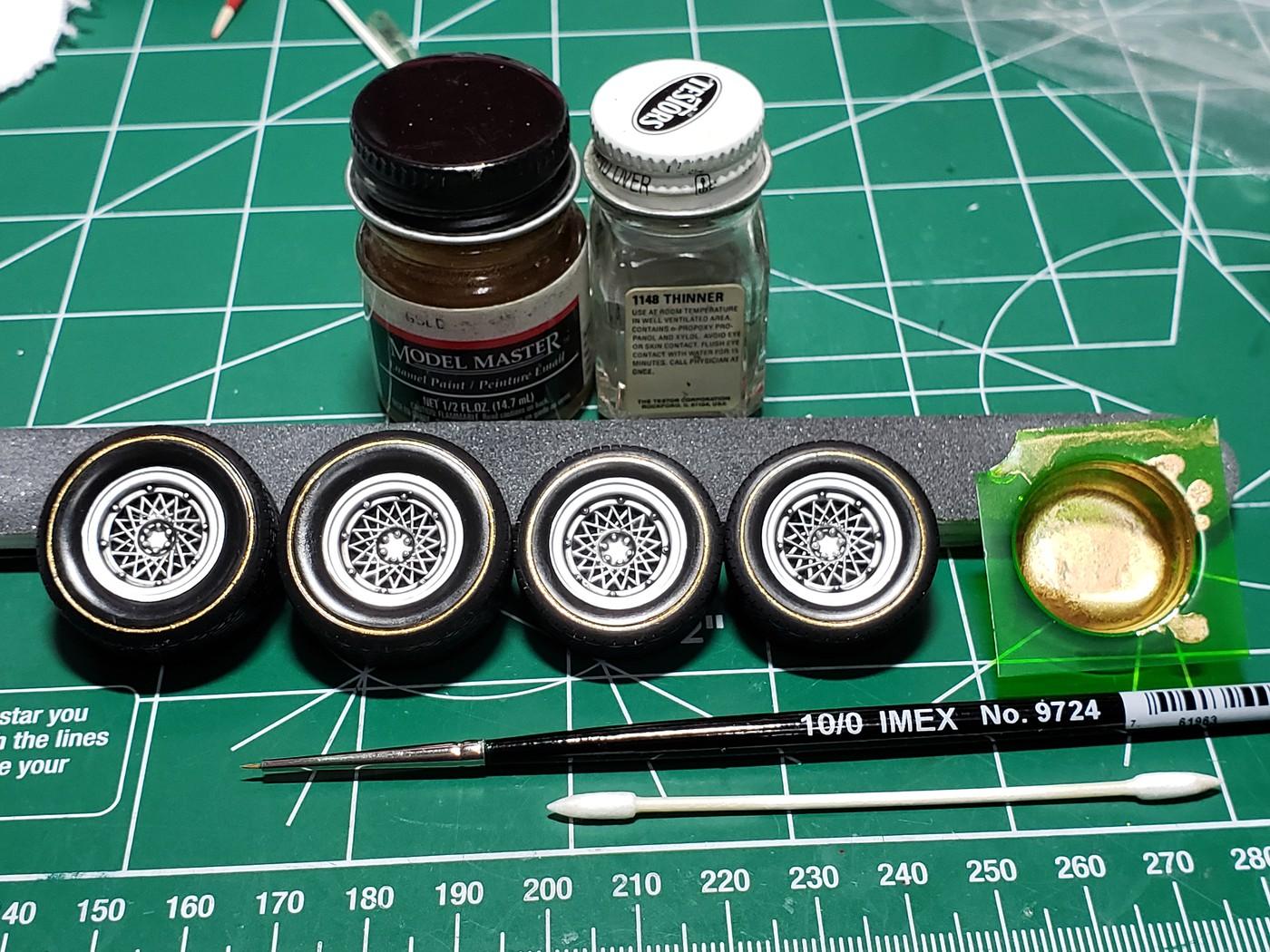

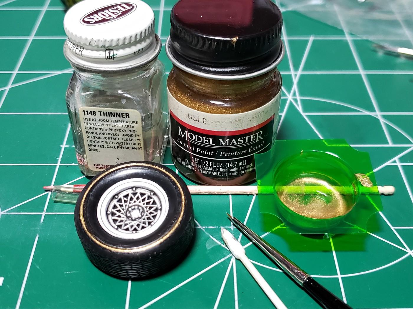

Nacho Z Posted August 31, 2022 Share Posted August 31, 2022 (edited) I hope this works, Mike. On my Chaparral build I tried the gold ring decals that came with the kit. Epic fail. The tires had a small groove in them. I thinned some gold paint and kinda loaded the paintbrush. I put the tip of the paintbrush in the groove and capillary action did the rest. Really, it was just like a panel liner. The few spots where I touched the brush to the tire were easily cleaned up once the paint in the groove dried. Edited August 31, 2022 by Nacho Z Removed duplicate photo Quote Link to comment Share on other sites More sharing options...

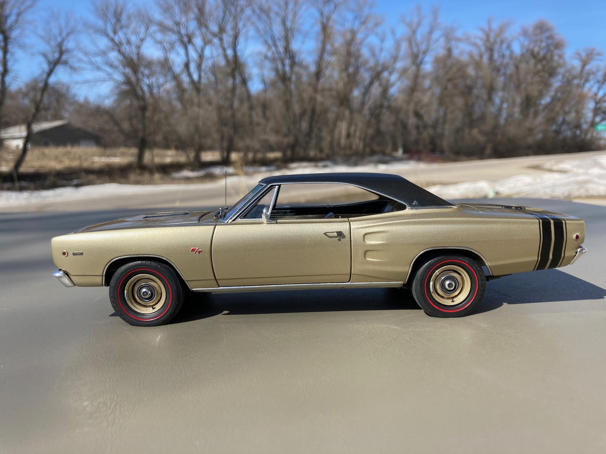

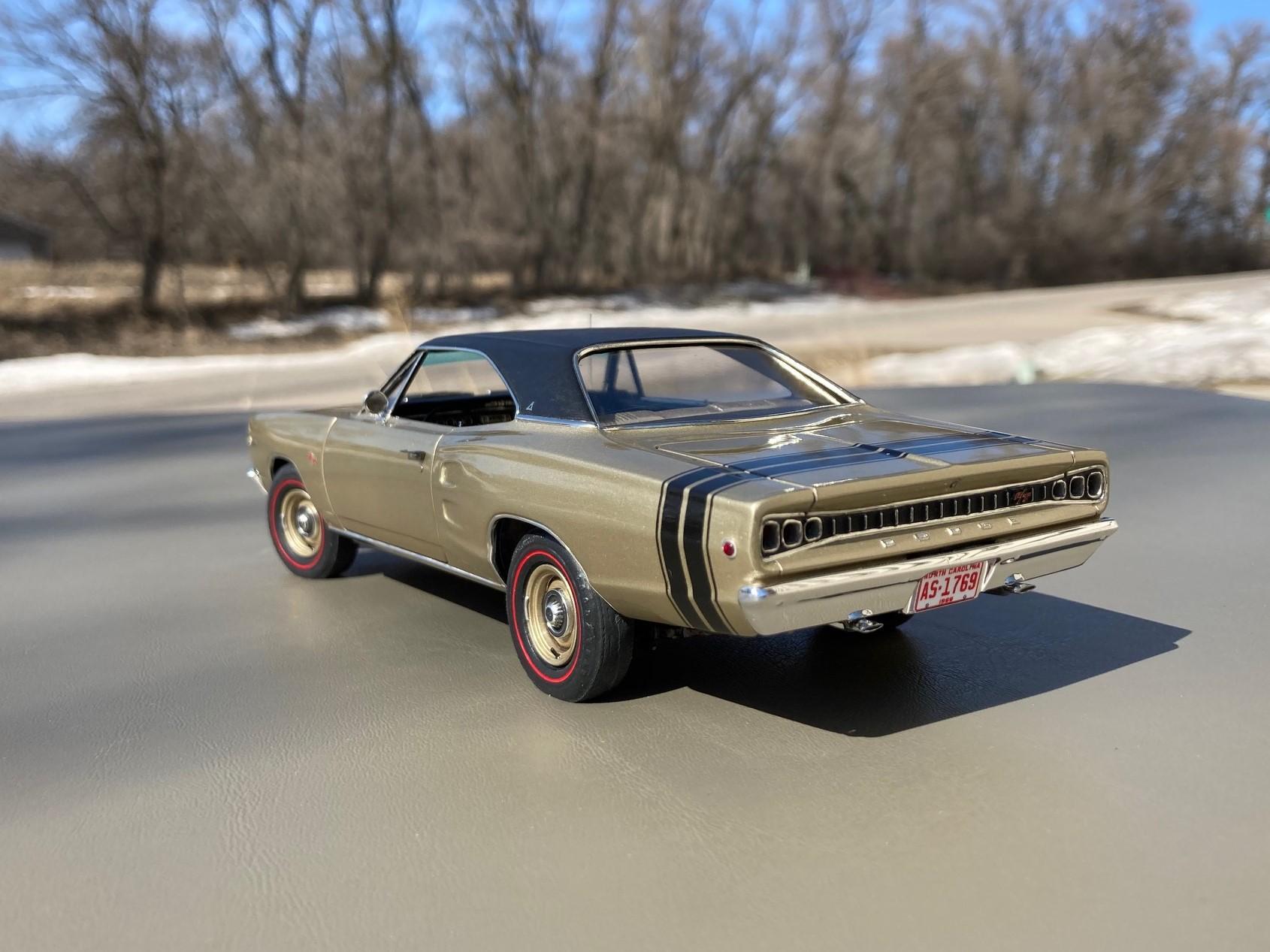

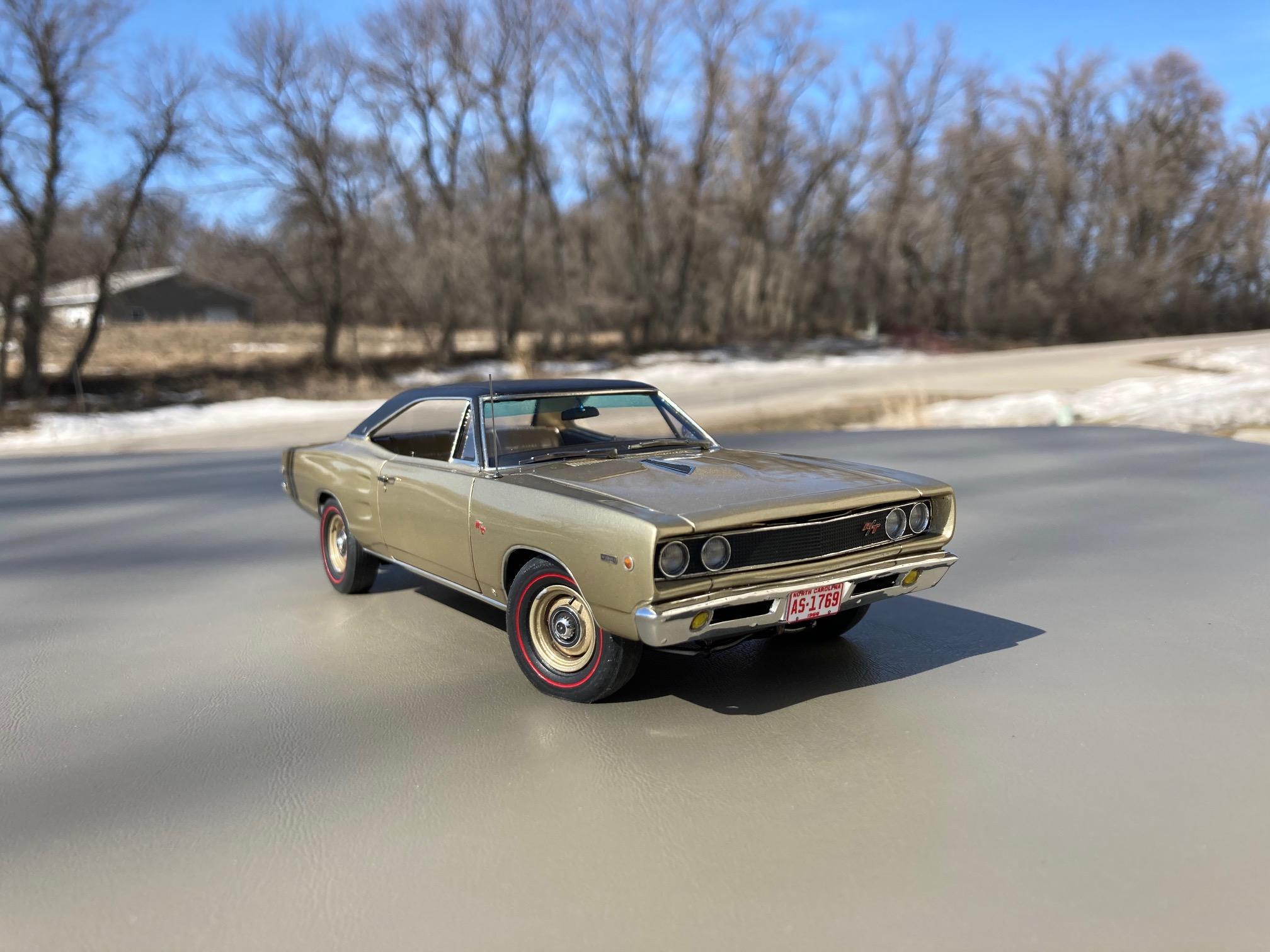

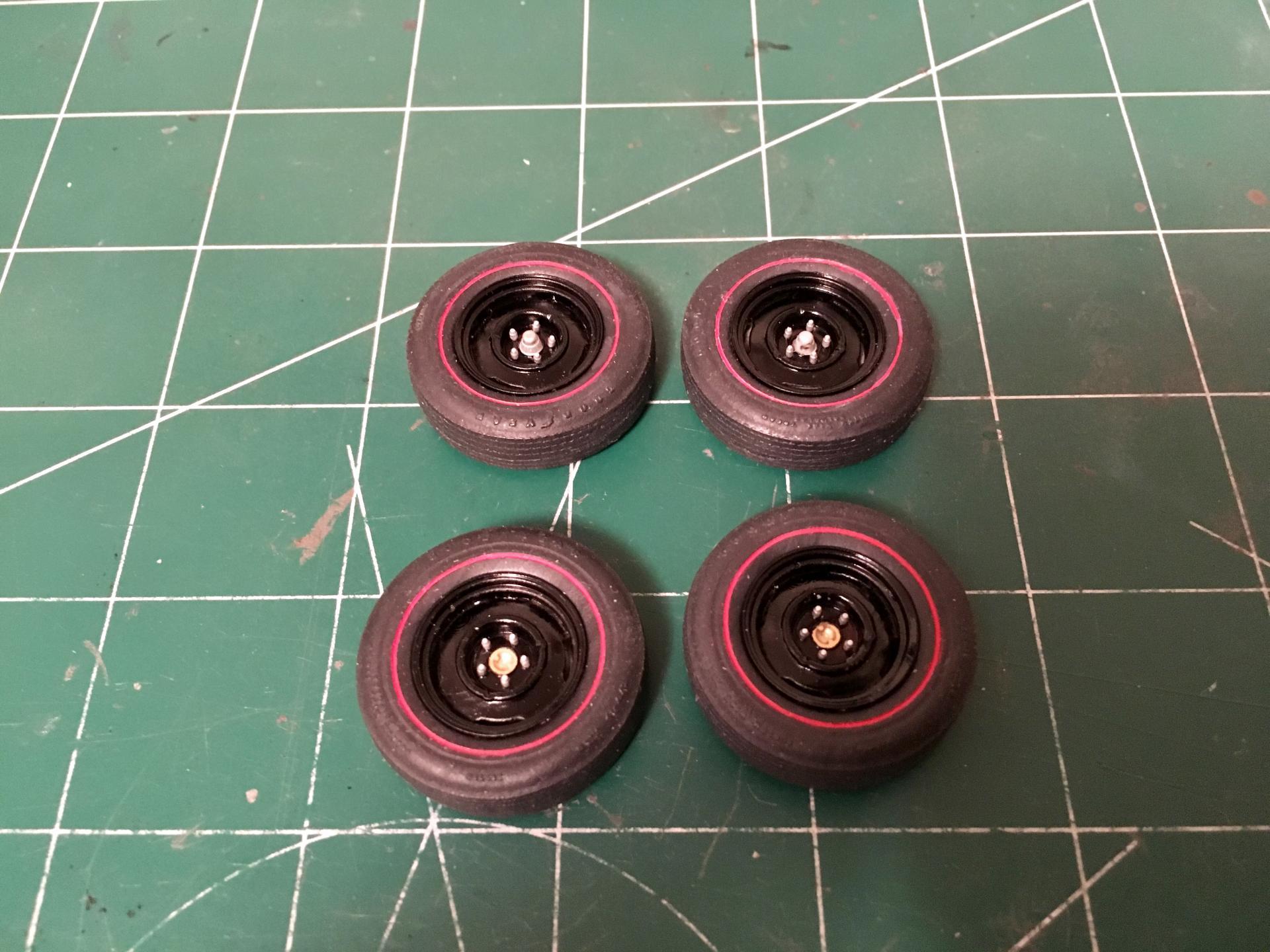

StevenGuthmiller Posted August 31, 2022 Share Posted August 31, 2022 You can just wipe off any excess outside of the groove with a little mineral spirits on a swab. It works very well. These are the Fireball red lines done exactly as Joseph describes using Mr. Hobby acrylics. Steve 1 Quote Link to comment Share on other sites More sharing options...

TransAmMike Posted August 31, 2022 Author Share Posted August 31, 2022 13 hours ago, Nacho Z said: I hope this works, Mike. On my Chaparral build I tried the gold ring decals that came with the kit. Epic fail. The tires had a small groove in them. I thinned some gold paint and kinda loaded the paintbrush. I put the tip of the paintbrush in the groove and capillary action did the rest. Really, it was just like a panel liner. The few spots where I touched the brush to the tire were easily cleaned up once the paint in the groove dried. Thanks John...Joseph says to use acrylic, looks like you used enamel. They did come out great! Quote Link to comment Share on other sites More sharing options...
TransAmMike Posted August 31, 2022 Author Share Posted August 31, 2022 51 minutes ago, StevenGuthmiller said: You can just wipe off any excess outside of the groove with a little mineral spirits on a swab. It works very well. These are the Fireball red lines done exactly as Joseph describes using Mr. Hobby acrylics. Steve Thanks Steven, they do look great. Quote Link to comment Share on other sites More sharing options...

StevenGuthmiller Posted August 31, 2022 Share Posted August 31, 2022 29 minutes ago, TransAmMike said: Thanks John...Joseph says to use acrylic, looks like you used enamel. They did come out great! Be careful using enamel. I can’t say what the results will be on these resin tires, but I have kit tires that I painted white walls on 20 years ago that still haven’t dried properly. Some kind of weird reaction between the enamel and the tire. Steve Quote Link to comment Share on other sites More sharing options...

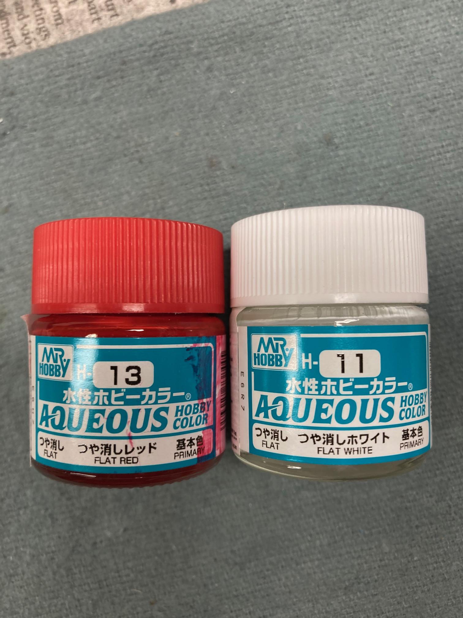

TransAmMike Posted September 1, 2022 Author Share Posted September 1, 2022 23 hours ago, StevenGuthmiller said: Be careful using enamel. I can’t say what the results will be on these resin tires, but I have kit tires that I painted white walls on 20 years ago that still haven’t dried properly. Some kind of weird reaction between the enamel and the tire. Steve As I have said, my first few attempts at get the paint into the grooves failed. Would you mind letting me know which of the Mr. Hobby paints you used? Thanks Steven Quote Link to comment Share on other sites More sharing options...
StevenGuthmiller Posted September 1, 2022 Share Posted September 1, 2022 38 minutes ago, TransAmMike said: As I have said, my first few attempts at get the paint into the grooves failed. Would you mind letting me know which of the Mr. Hobby paints you used? Thanks Steven These are the one's that I used, but I don't think the brand of paint should matter much, as long as it's a good acrylic paint. The technique is much more important than the brand of paint. I didn't thin it, I just used a small brush and flowed the paint into the groove as well as possible, let it dry for a short time, and then went around the edges of the groove lightly with a Tamiya swab dipped in mineral spirits. I put a coat of white on each tire, then went back and cleaned each one between each coat. I used 2 coats of white, followed by 2 coats of red. It worked very well for me. Steve Quote Link to comment Share on other sites More sharing options...
TransAmMike Posted September 1, 2022 Author Share Posted September 1, 2022 36 minutes ago, StevenGuthmiller said: These are the one's that I used, but I don't think the brand of paint should matter much, as long as it's a good acrylic paint. The technique is much more important than the brand of paint. I didn't thin it, I just used a small brush and flowed the paint into the groove as well as possible, let it dry for a short time, and then went around the edges of the groove lightly with a Tamiya swab dipped in mineral spirits. I put a coat of white on each tire, then went back and cleaned each one between each coat. I used 2 coats of white, followed by 2 coats of red. It worked very well for me. Thanks so much Steve. Huh, I very seldom use white paint so all I have on hand is the small enamel Testors bottle. I do have some of those swabs. As some have said they thin the paint. I'm gonna give it another try as a test with some very pale gray craft paint I have. Steve Quote Link to comment Share on other sites More sharing options...
