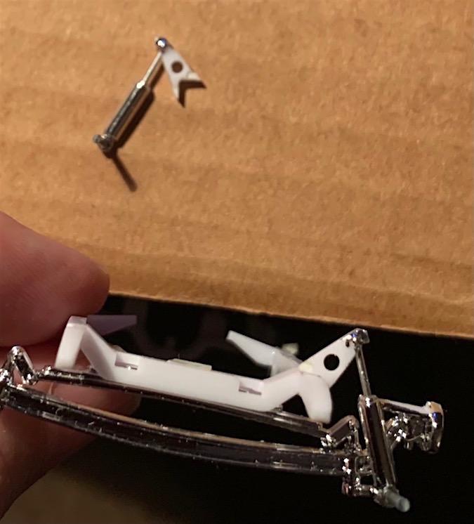

Russell C Posted January 4 Author Share Posted January 4 (edited) Seems this Revell kit's chrome trees weren't too happy leaving the factory, the rear radius rods were both snapped in two. My kit also had the thoroughly warped windshield frame and one incomplete wheel trim ring, but I'm using different wheels and only need the windshield frame uprights to go with the removable hardtop I plan. The rear radius can be fixed with some ancient brass tubing I have with wire inserts in the ends. Added a little beef to the axle mounting area since the arm ends looked a bit too thin, and cut a section of Plastruc tubing to match the widened arms, then sliced that in half with a razor blade, so that each half could be the "other side of the axle" bits for these arm ends. My next trick - inspired by "89AKurt's" fun with the rear shocks/springs - will be to separate them into upper/lower caps, to accept 2-piece shocks and real metal spring coils. Edited January 4 by Russell C grrr - typo 2 Quote Link to comment Share on other sites More sharing options...
