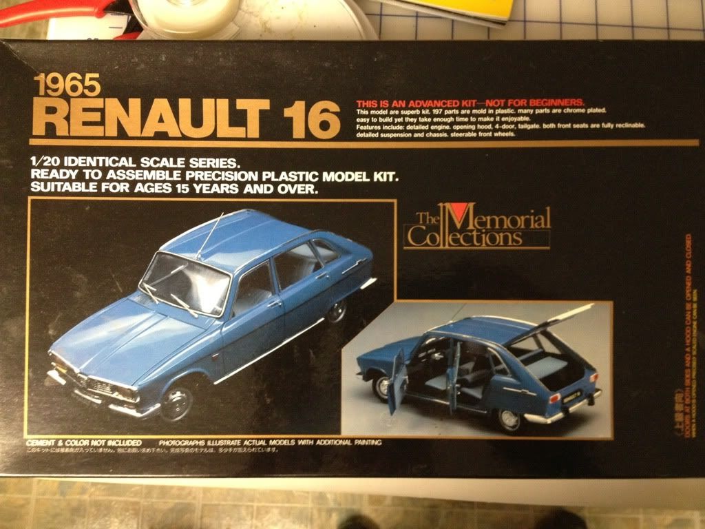

Why anyone would want to build a 4 door to begin with is beyond me
Because not every builder actually thinks Camaros and Mustangs are the only cars in existence.
Here is one of the few all-four-doors-opening models:
It takes quite a bit of work to do on a kit.
Edited by Erik Smith
