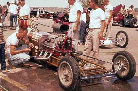

Here are some inspiration pics:
Cacklefest_E_Dragmaster.jpgMickey+Thompson%27s+Dragmaster+car+in+1961.+Photo+by+Pete+Garramone.jpgMICKEY+THOMPSON+DRAGMASTER+copy.jpgDRAGMASTER+2A+copy.jpg

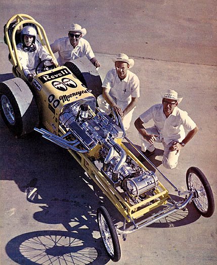

The Mooneyes dragster
