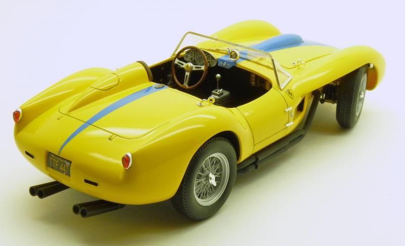

This is a build I just finished of the Hasegawa Ferrari 250 TR. Paint is Tamiya Chrome Yellow with the scallop in French Blue. This kit utilized the Studio 27 photoetched detail set, the Hasegawa aftermarket PE/ plastic wire wheels, MCG boltheads and Model Factory Hiro badges. Every good thing you've ever heard about this kit is absolutely true... it's a real joy to build and looks amazing when completed. If I had built this one box-stock it would still be a really nice model, but the additional details (especially those wheels- I have another set that will be going on my upcoming 250 California build) really make this one stand out.
The "story" behind this car is that it's a former racer that was imported to California and street-driven by its second owner, who had it repainted in the yellow/blue color scheme. I think the bright colors work on this body shape and the scallop really makes it feel period-correct. There actually were a few street-driven Testa Rossas... even one that had a Ford V8 swapped in when the V12 blew up!

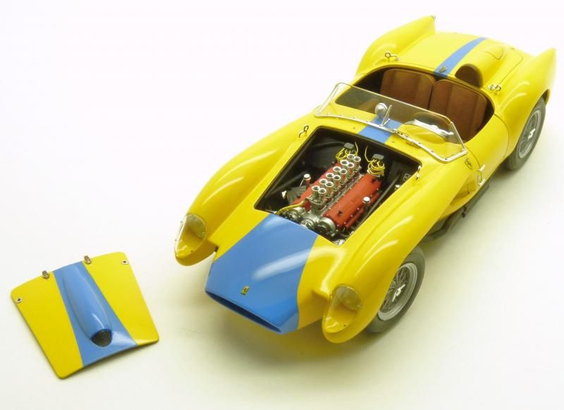

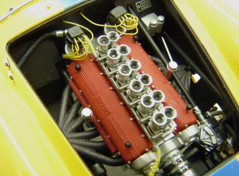

The engine bay was detailed out with crackle-finish paint on the valve covers and some wiring and plumbing. It doesn't take much to bring the engine bay to life.

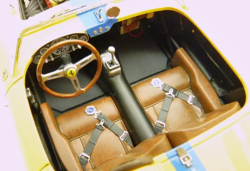

The interior received a fair amount of work... I found a decal for the battery and wired it, and used the fantastic instrument panel parts from the Studio 27 PE set as well. I hollowed out the spokes on the steering wheel and used fine wire for the turn signal stalk and gearshift. I used a technique adapted from a faux-finishing tutorial online to reproduce a natural leather interior. The headrest cushion was scratchbuilt from sheet styrene and fine detail wire. All panel lines were darkened with a mix of Tamiya yellow and smoke acrylics.

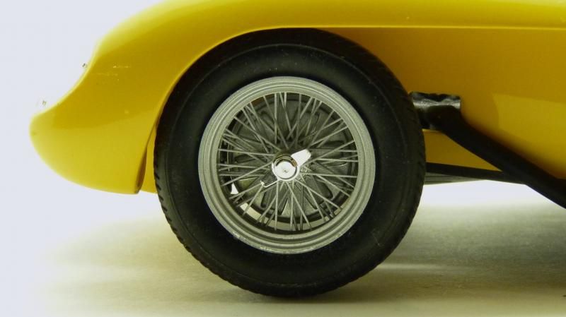

The star of the show here is undoubtedly the Hasegawa aftermarket wire wheels. Five layers of photoetch make up the spokes, with plastic parts for the inner and outer rim and the hubs. The result is stunning, and fits directly to the kit without modification.

Beautiful work. Could you give us a link for the tutorial on the leather? It looks very realistic.
Thanks, Tom!
I could give you a link, but it's pretty easy to just explain what I did...
1) apply your base color- should be a shade lighter/brighter than your desired final color.
2) if your base color is acrylic, clear coat with Testors Dullcote to protect it from the next step.
3) mix a "top color" two shades darker than your base color using acrylics. I used a custom mix of Testors acrylics. Mix this 50% with Micro Satin (Testors acrylic satin clear would work as well) and thin a little with water. This is what faux-finishers call a "glaze".
4) Using a large brush, apply your glaze over the base color in a heavy, wet coat. The glaze dries quickly, so don't do more than one part at a time.
5) While the glaze is wet, use a lint-free cloth or paper towel (I used blue shop towels) as a blotter to remove some of the glaze from the surface. Just dab it against the surface lightly... you want to leave some of the glaze on. This is what gives the part the leather texture.The glaze will also tend to remain in the recesses, adding further dimension to the part.
Let the part dry- you can finish with dullcote if you want, but using the Micro Satin gave me the perfect leather sheen.
The key to this technique is experimentation-once you've tried it a few times, you'll have no problems. The key is mainly to make sure your base coat is protected and you do NOT allow the glaze coat to dry before blotting.
Good luck!
