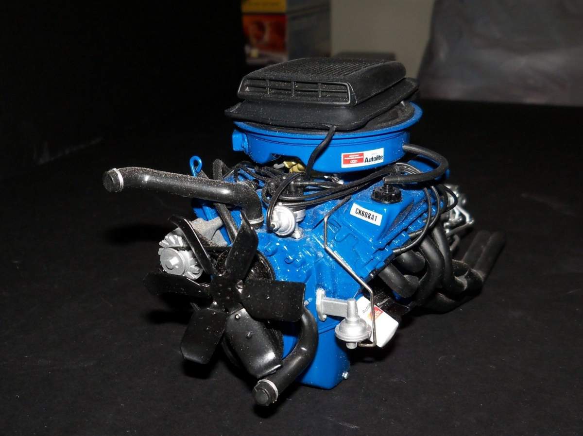

FordRodnKustom Posted January 17, 2015 Posted January 17, 2015 This kit has a nice one. It's not stock though.

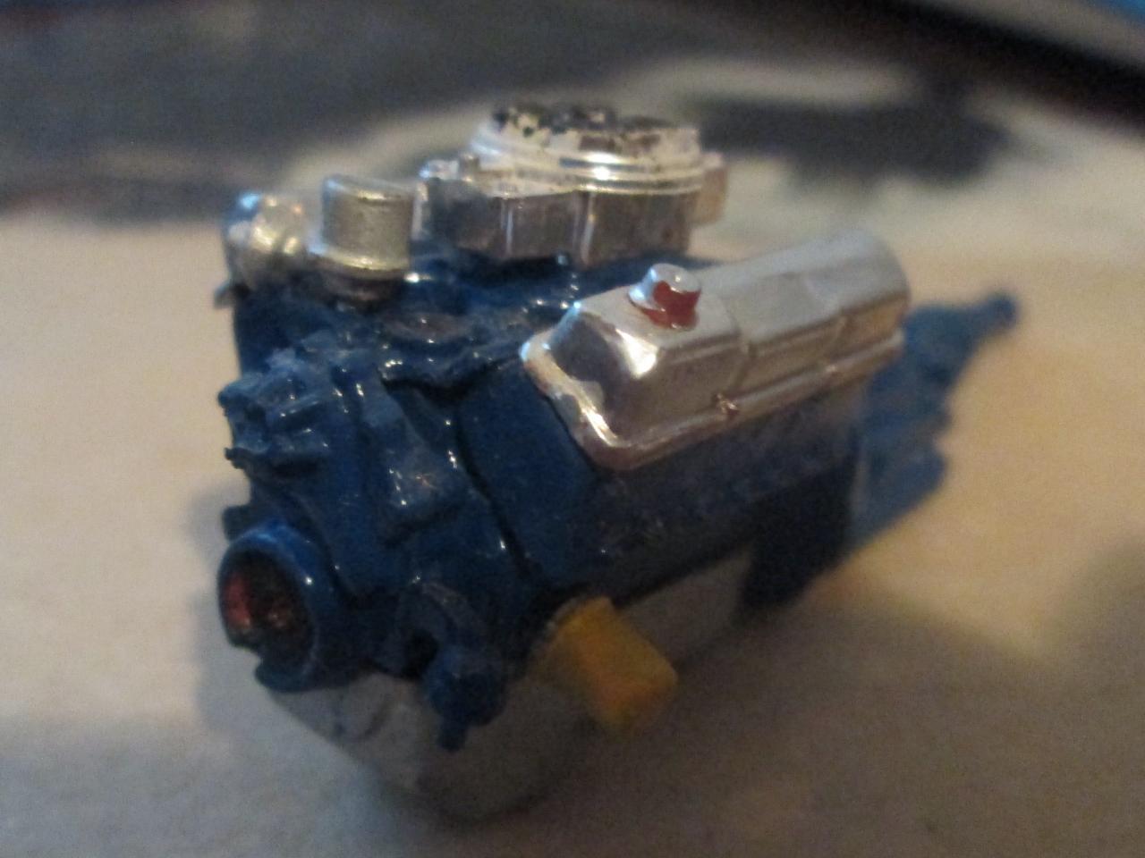

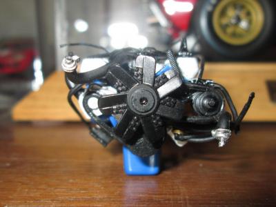

vamach1 Posted January 19, 2015 Posted January 19, 2015 Here's one good alternative and one that is a teaser. One is from a 80's Mustang Cafe racer gluebomb I bought but it sure looks like a 351C with a C6 tranny and oversized carb to me. The other picture is the engine from the Danbury mint Boss 351.
