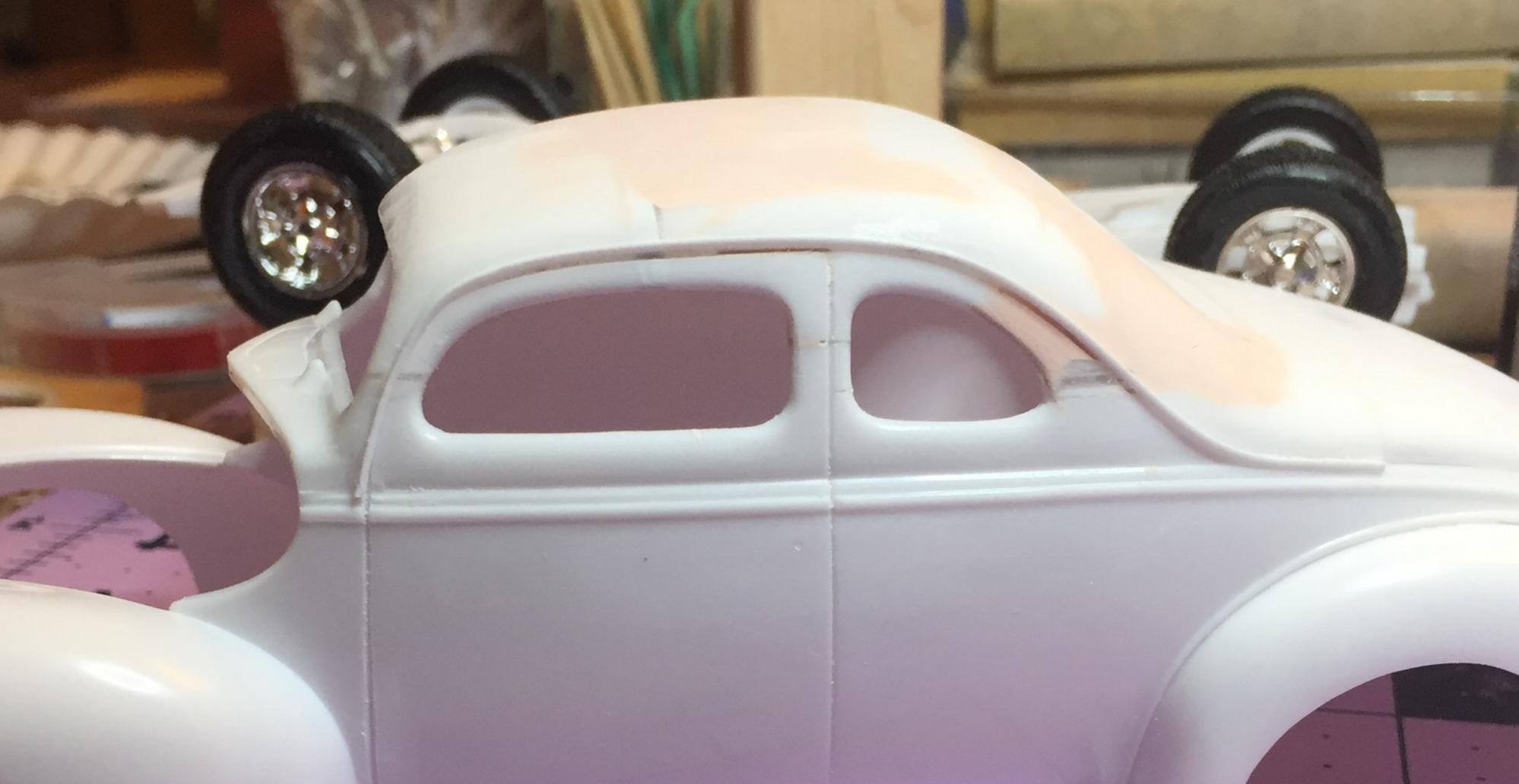

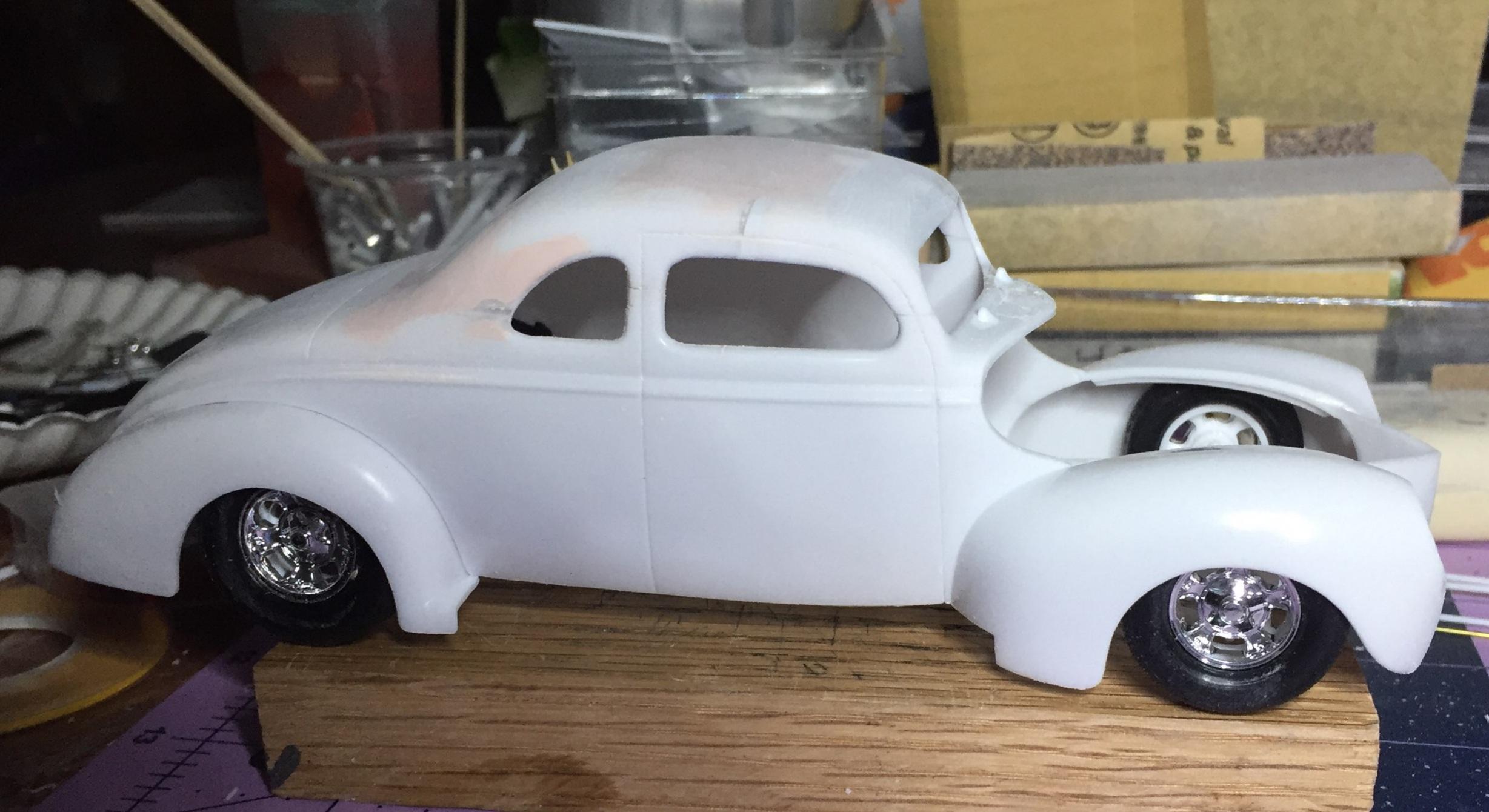

  14. Had to do it. Not just the handles, either. Side trim must have been an option because half the '62s don't have it. I think they look better without it. So much for one coat of primer ?. Got the engine almost finished but I'm gonna do a dip stick. Black-washed the wheels and grille. Removed the fender badging....OK, I didn't see any way those front badges could possibly be workable. So it's a restoration and I'm waiting for a set of N.O.S. scripts and badges. I can drill some holes....? I put the rear end together and found the mold of the springs was shifted enough to make clean-up impractical. A common situation. Lots of small parts need cleaning-up but the big stuff is fine. When I opened the bag that the parts came in I found the front suspension had suffered some sort of mishap in packaging. It was twisted severely. I attempted to straighten it out and I eventually got it installed after cutting the sway bar. That stuff happens and it was still usable so "no harm, no fowl."

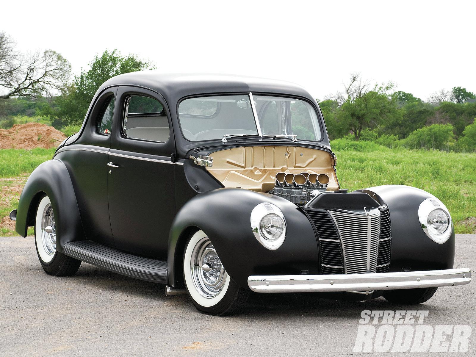

  20. Oooo.....red......I wish you had said that....um.....sooner. as far as flat black goes, I have used it on occasion where appropriate for a whole car. This '40 coupe is painted with satin black. I know, I'm splitting hairs but the effect is somewhat different. And the first coat was a bit O.P. so I wet sanded with 2000 and re-coated on a dry ( like under 50% RH) day. Ya gotta watch out for blushing with this paint because whatever you get, that's it. No polishing. There is a sheen that needs to be even in order to look good. I have used the same paint on another project and polished it down to look like old, neglected, original black paint on a Model A coupe.
