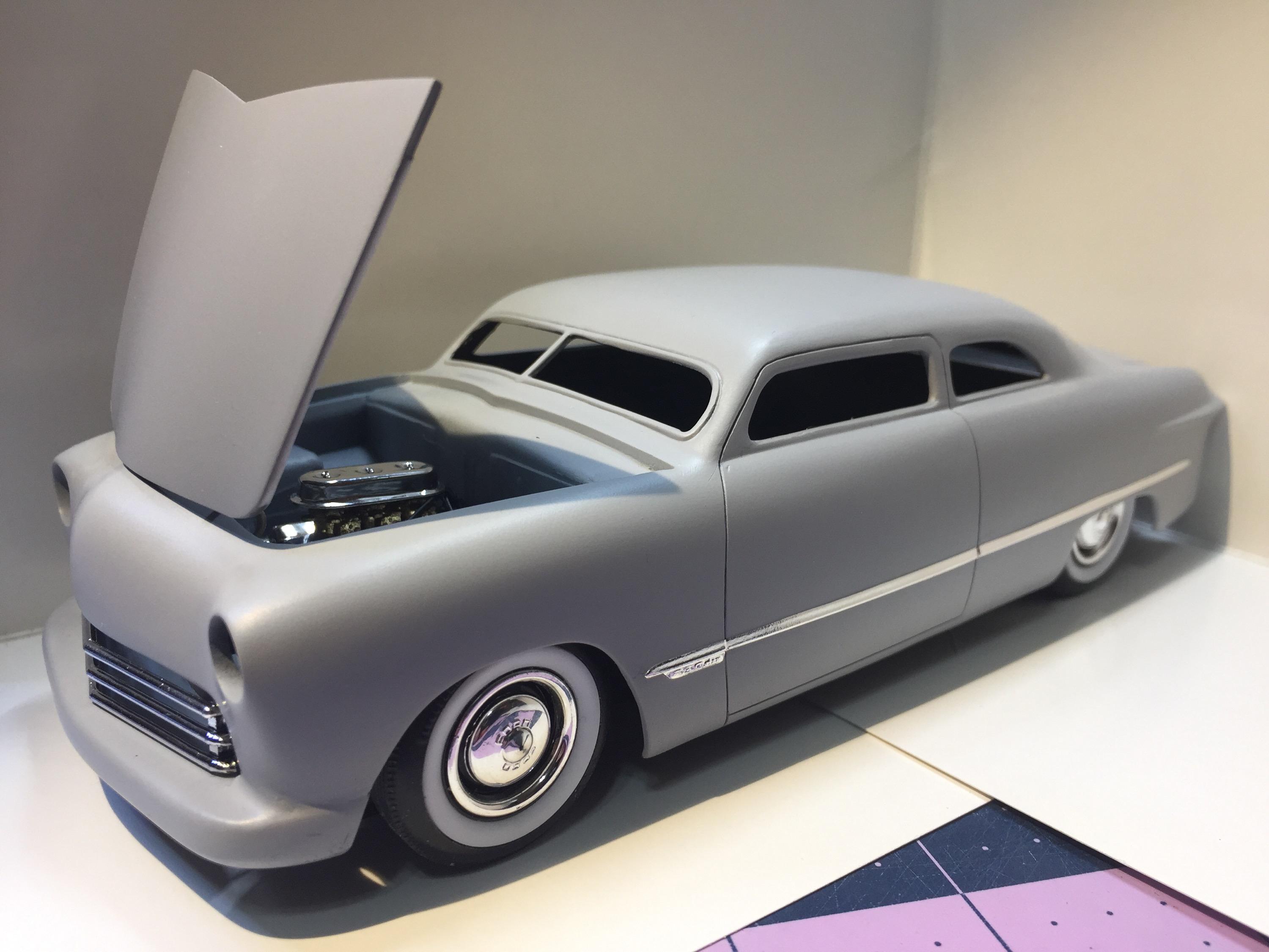

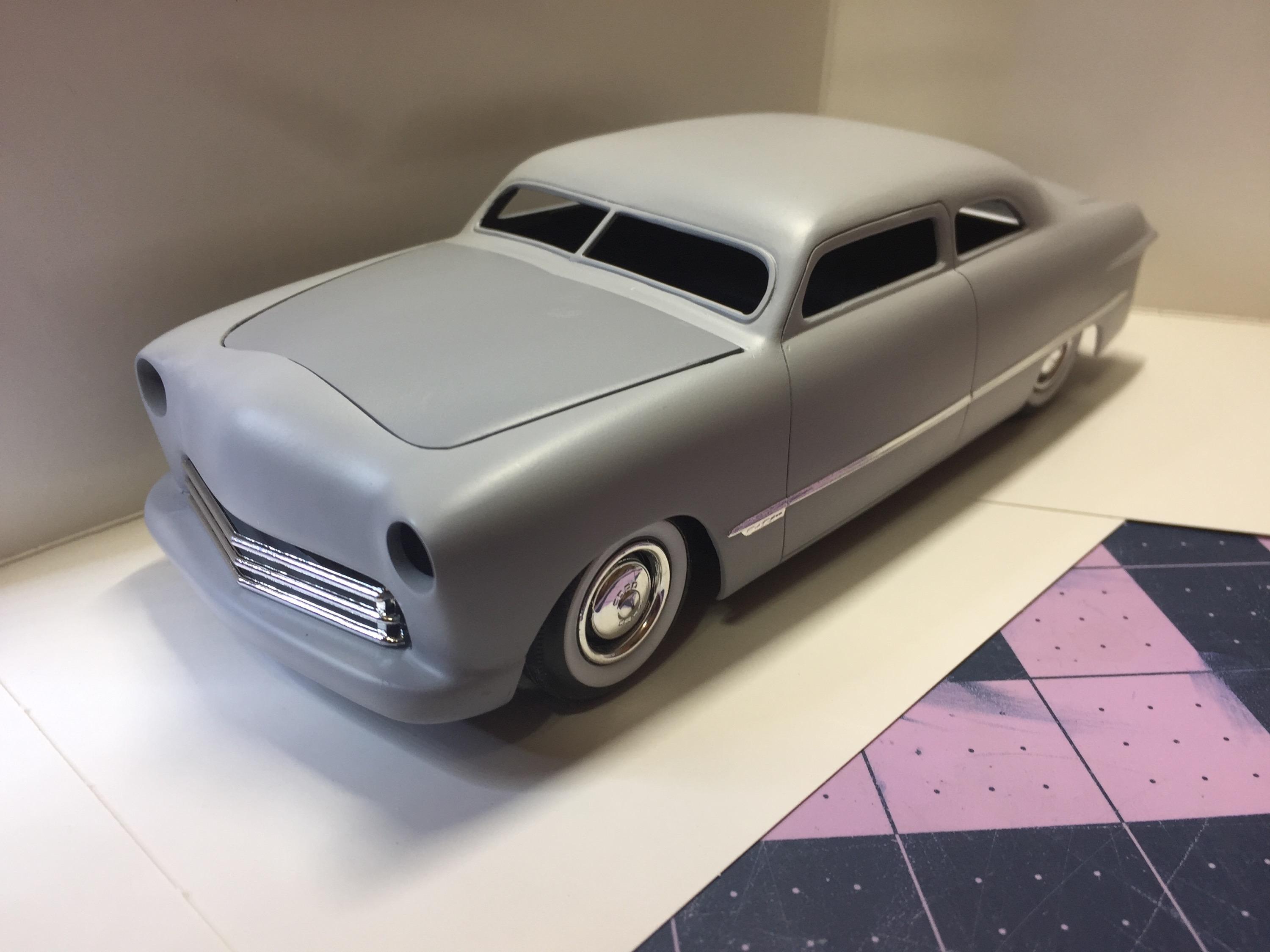

  6. Today I thought I would try my hand at carb linkage but it's not finished so....you'll have to wait on that. Anyway, I decided to go bumperless. I filled the bracket slots with styrene and shaped. I also figured I should install door solenoids. ๐Ÿ˜‰ And I trimmed the front wheels a bit more to get the tires a little more clearance. And then I couldn't resist another mock-up. Shown is the modified "big fat AMT axle" in place. You can see the added cross member necessary to mount the "custom" radiator in its new location. This swap necessitated quite a lot of mods to make it work... but it does work. I'm glad I didn't just box it all up. I'm having fun with it. ๐Ÿ™‚ This is as much clearance as I dare. If I cut the axle sockets any shorter, the wheels will fall off during subsequent mock-ups and we don't want that ๐Ÿคจ. The '39 Deluxe and '40 Standard Fords look much better, I'm my humble opinion, without a bumper in the front, especially with a nice nose dive. I drilled small holes to mark locations of tail lights and the gas cap. The door hinges are a hindrance to sanding and polishing and I am considering their removal. Some customizers convert to hidden hinges so I can point to that to justify my elimination of those awful things. WDYT?

  11. Be patient, Bil. You're still young. Maybe you could find some way to kill brain cells like I have. ๐Ÿคช In other news.... The modified floor My method of assuring a true-ish axle alignment. Then I remove the middle and apply reinforcing CA. Those ugly slots were filled with scrap styrene. The knee shock actuators were removed and tube shocks will be adapted These flatheads were glue-bomb acquisitions. Spent the better part of a day struggling with getting one acceptable. Still have a way to go on that. I think of these two as "the girls". Found 'em hiding in my "small chrome engine stuff cache" The new Offy heads, resin pre-drilled distributor, and custom aluminum radiator. The stock radiator is too wide to fit in a farther forward location. Here's the girls "in situ." The hood closes, I checked. ๐Ÿ˜Œ That's a custom cast aluminum high rise manifold from "Jimbo's Hot Rod Engineering Works". Whomever glued that generator in place used so much glue that it melted the bottom of it. Less is more, children. Today I should work on a hood hinge. Maybe. But those holes have got to be closed up. ๐Ÿ˜–

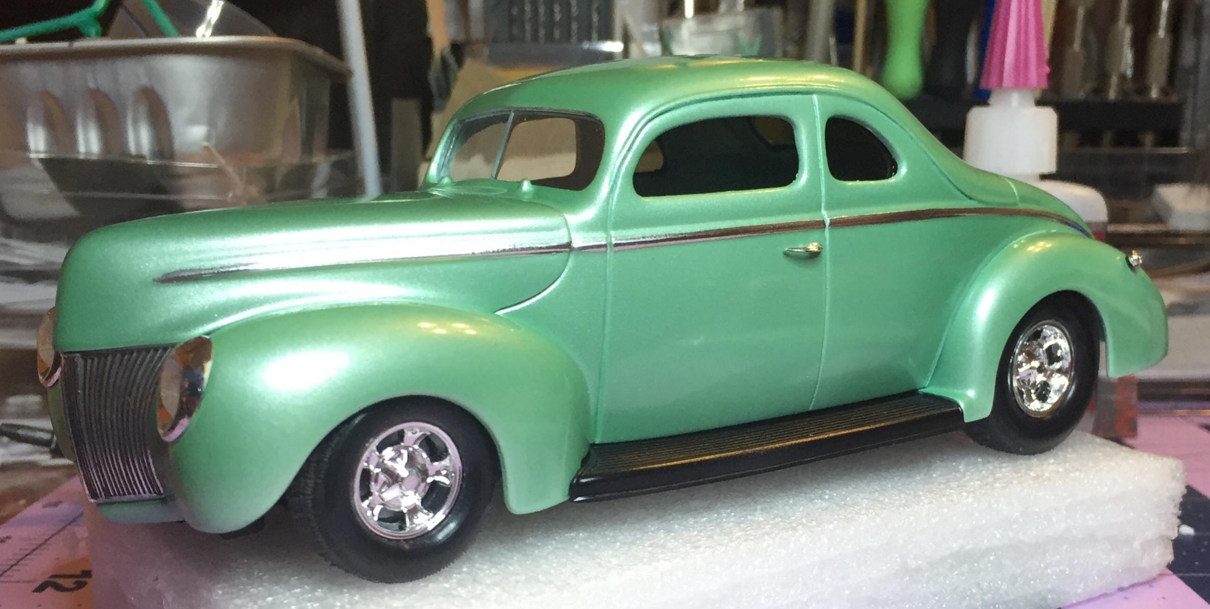

  16. The Revell has pins that fit in holes at the frame/floor interface. It's easy to not engage them upon final assembly. Is that what happened? The Revell boards have support bracket detail where the AMT boards do not. That bothers me. The current issue of the AMT coupe shows its age everywhere although the chrome trees are somewhat respectable. I got the one I'm using at Ollie's for 13 bucks - that's gotta tell you something. Cool greenish glass and nice decal sheet, though.....if you like Coca Cola. ๐Ÿ˜‰ My Revell coupe. A squirrel took the right side handle and has yet to return it. I should have shaved that ugly-a$$ trunk handle.

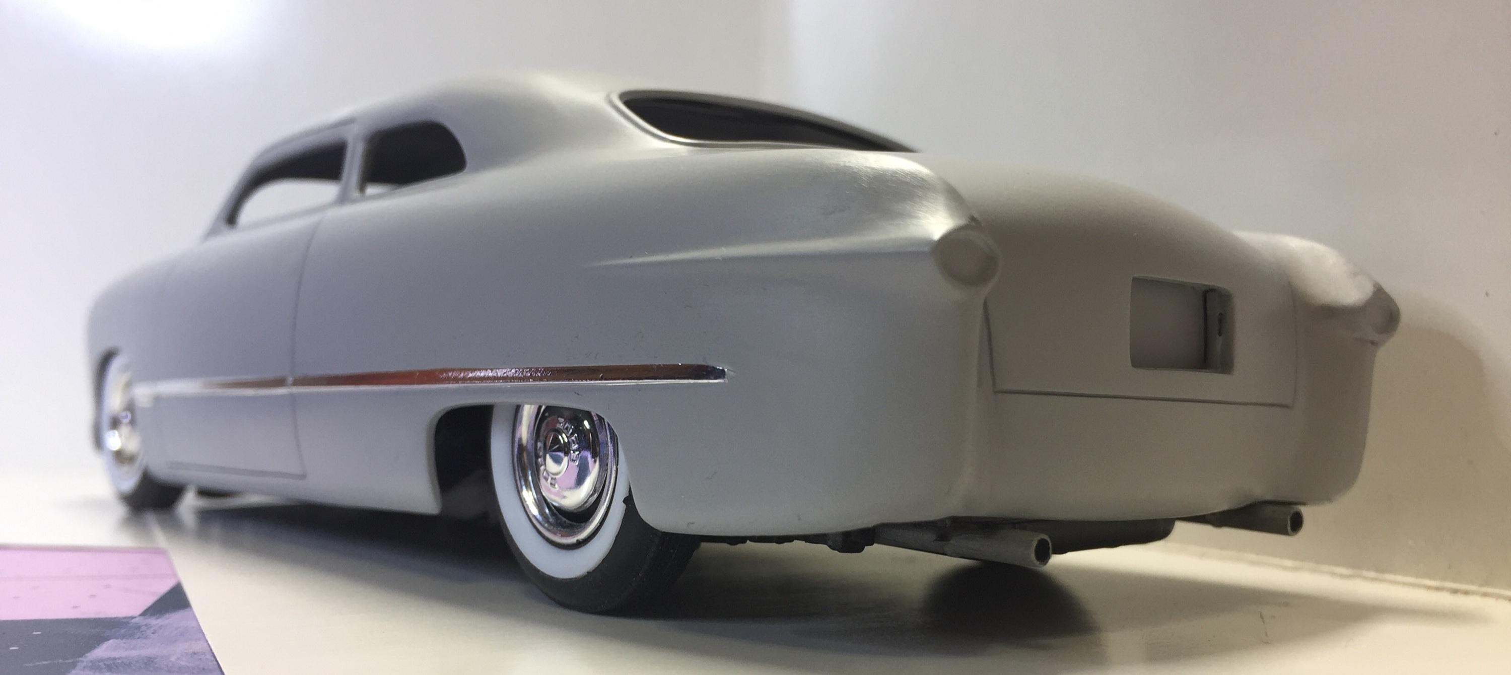

  19. I imagine you already know why I need this, right?

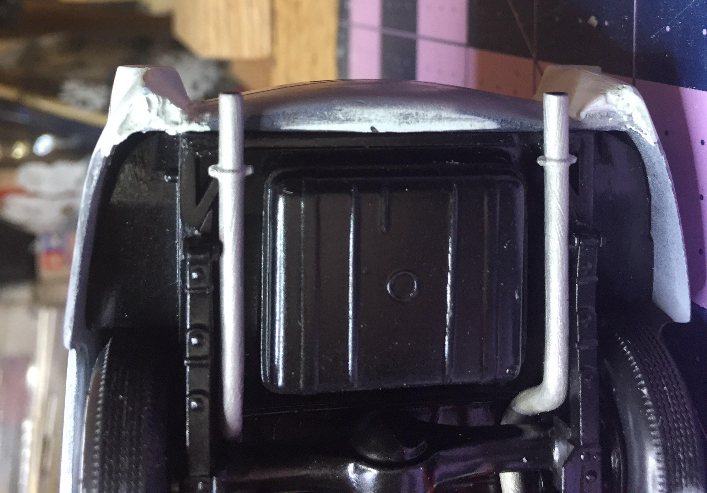

  22. Tonight's task was eliminating the molded-in exhaust on the AMT chassis and replacing the removed material with styrene sheet. Below is two hours with P E saws, Tamiya scribing tool, and a 1/2" chisel blade. After making the front cross member permanent, I drilled small holes to establish the layout of the cuts which was done from the top side of the chassis starting with scribing. I finished the cuts with a P E saw and finally the knives and files to clean up the cuts. The tail pipe was removed with a 1/2" chisel blade. There was a notch in the right rail that had to be filled and also at the intersection of the rear cross member, a small piece of Evergreen was blended into the frame where the tailpipe was removed. The space I created between the frame rails was filled with .030 sheet and secured with CA. The beading in the floor pan is extremely small and the entire floor will need new beads. That's it for now, thanks for your interest. ๐Ÿ˜ด Incidently, I checked the instruction sheet to learn what the notch on the right rail was for and there was no trace of it. I did notice, though, a detail showing how to install the exhaust system- the separate exhaust system. Huh? ๐Ÿ˜ฒ
