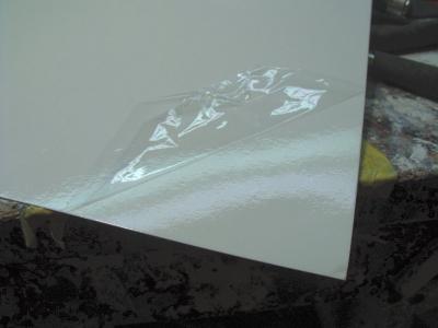

Papilio decal paper question on setting solution
935k3 replied to Foxer's topic in Model Building Questions and Answers
Below is a picture of the film peeled back. The decal does not need this on the white or clear paper. If you leave it there it will not conform as well. It definitely is not needed and there is risk that it may peel after it is on the model for awhile. -
I discovered by accident that Papillio decal paper actually has a clear protectiver layer that needs peeled off before painting or printing. It is a thin layer of plastic. Also to get decals to conform try a hot damp cloth pressed over the decal. It will conform instantly without wrinkles. Use a hot damp Q-Tip for small areas. -
