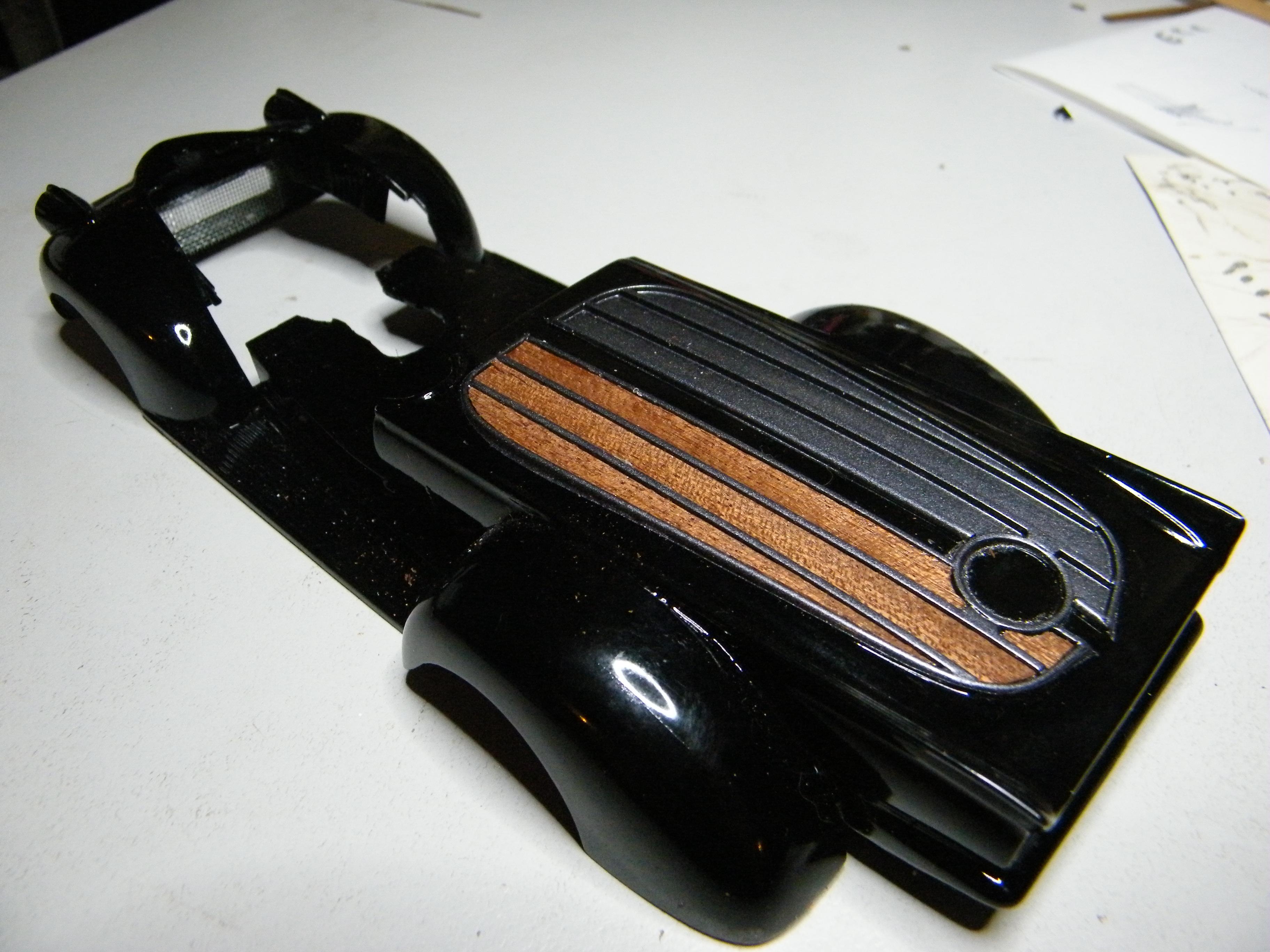

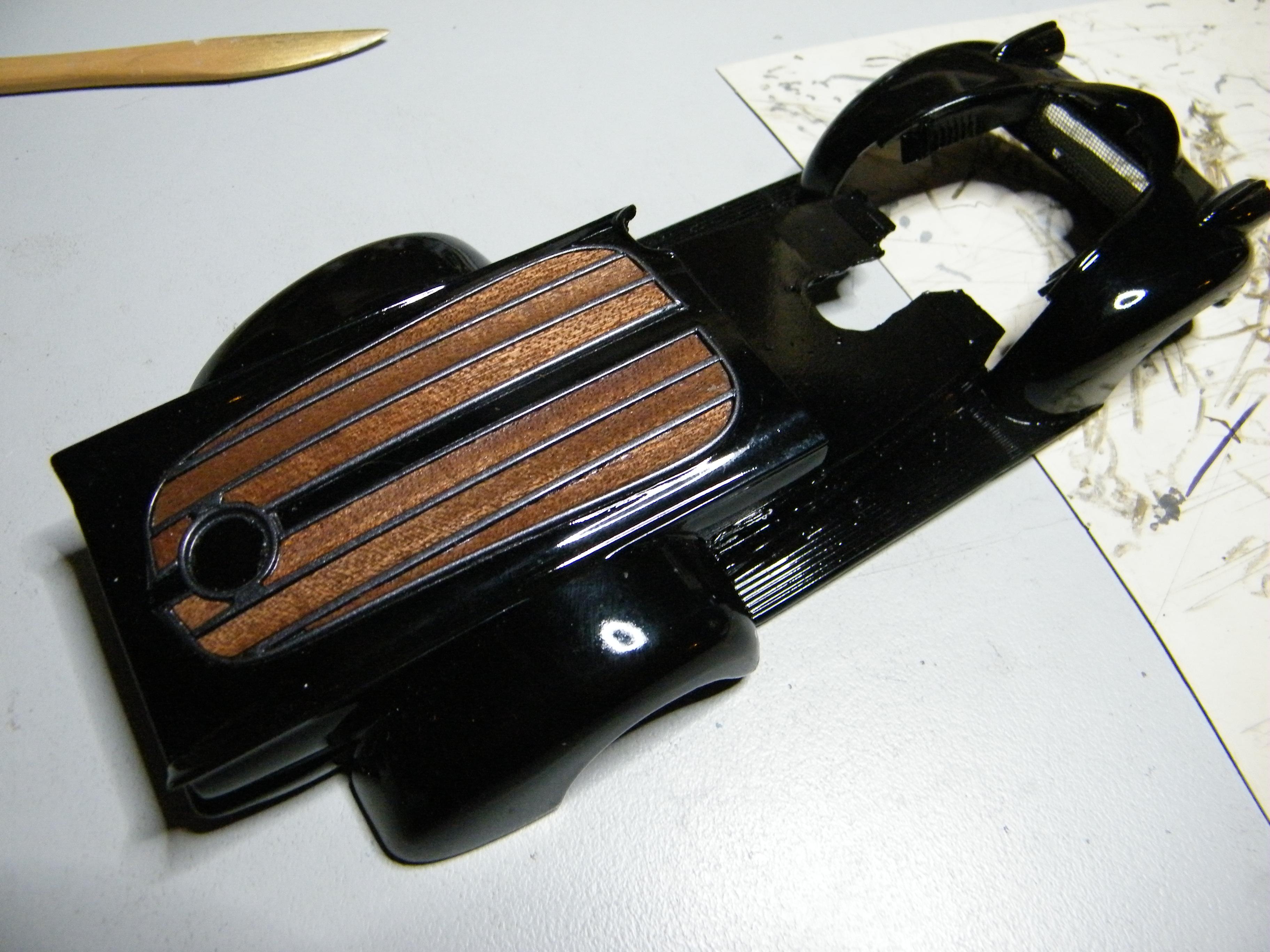

Thanks for the 'cohesive' comment. Something I try for with every custom and rod. Not sure about the Morris Minor comparison though.... Once I committed to black it meant a lot more sanding, filling and getting frustrated seeing new flaws every time I laid down what I hoped was a final coat. Anyhow it's close enough now. Hard to photograph though. Timberwork next! Brian -

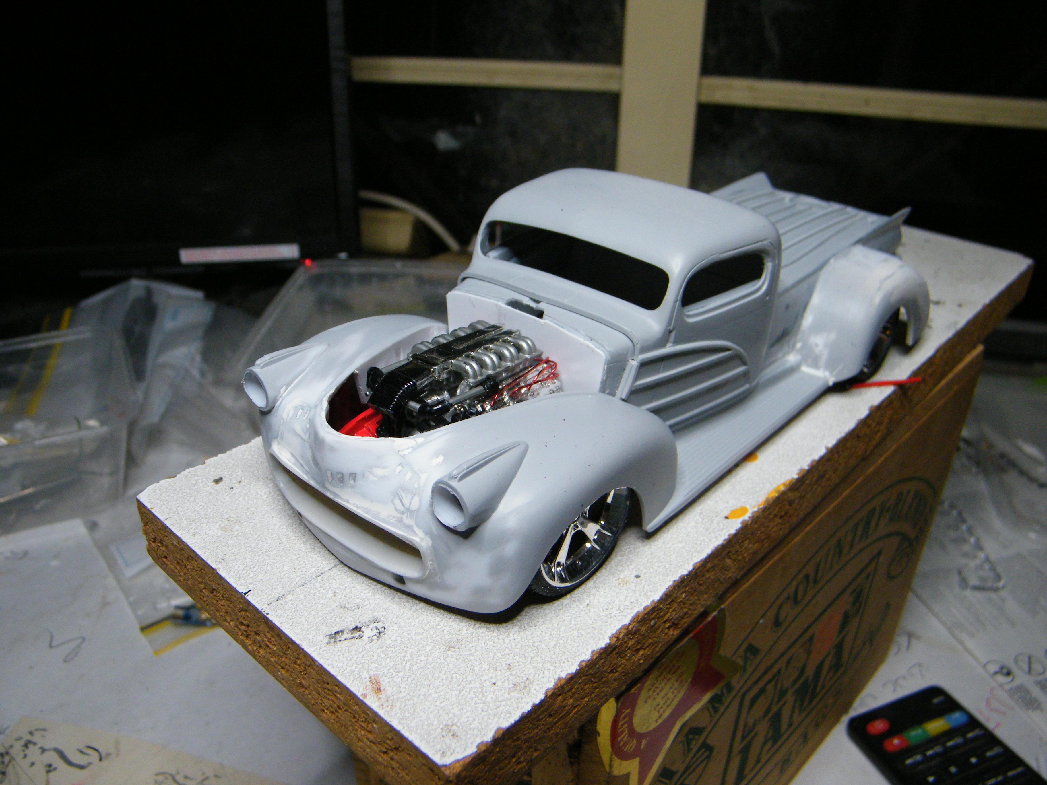

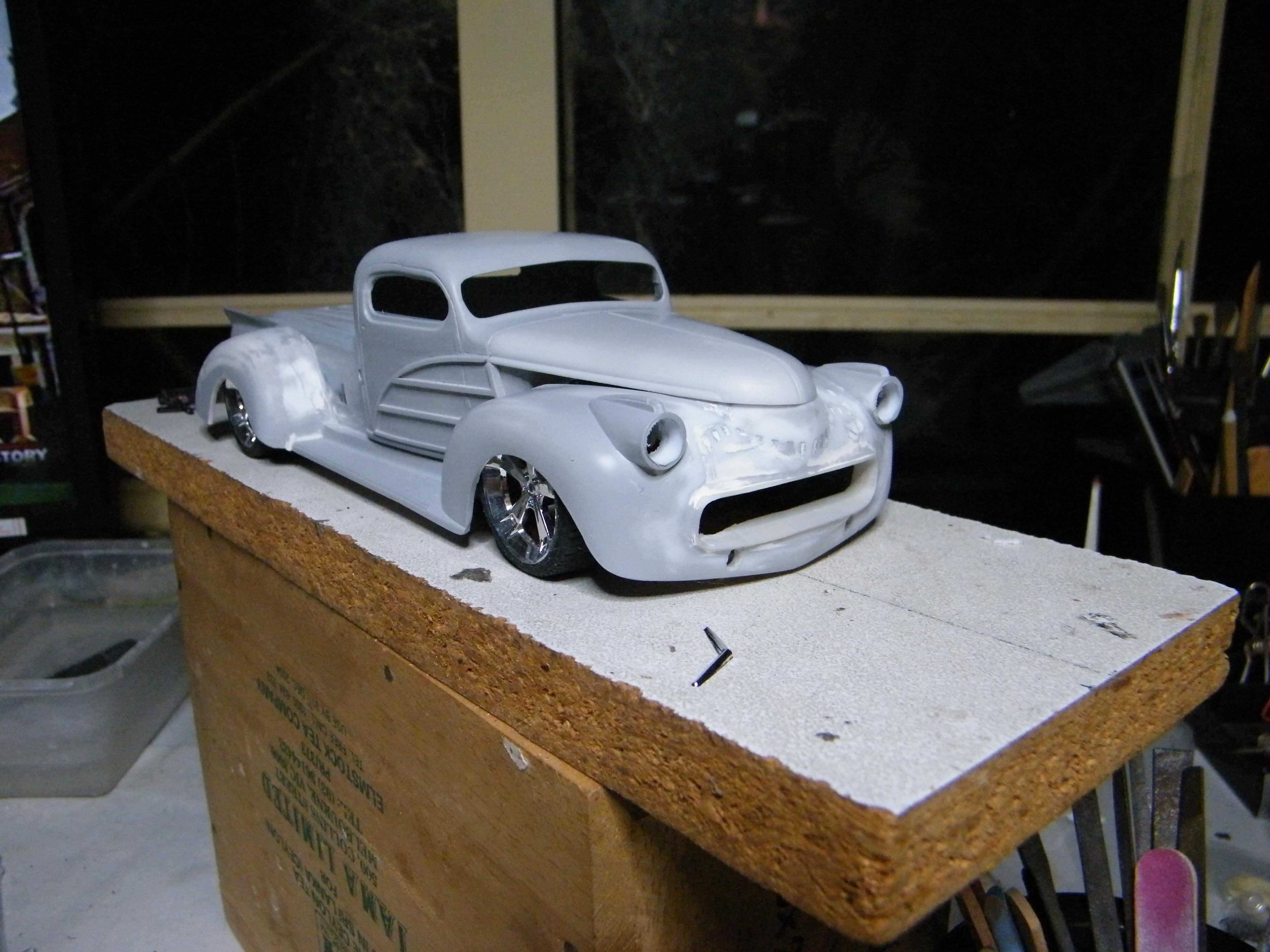

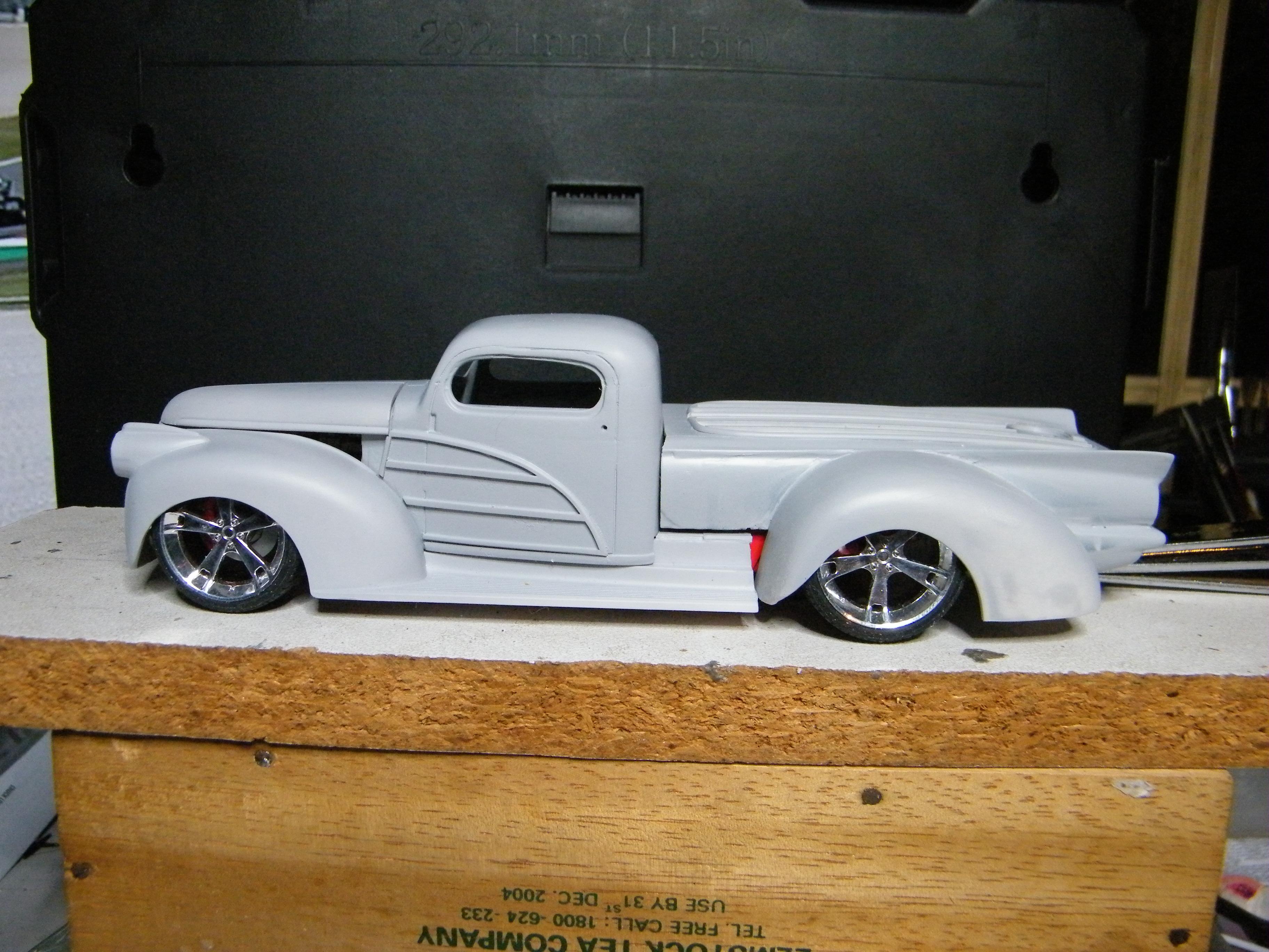

Thanks for the comments gentlemen Front end is pretty well done now. Just some cleanup work to be done. Was going to keep the Chev 6 but after cutting out so much body height it wouldn't fit under the bonnet so back to a Corvette unit. Moving to paint soon I hope. Brian -

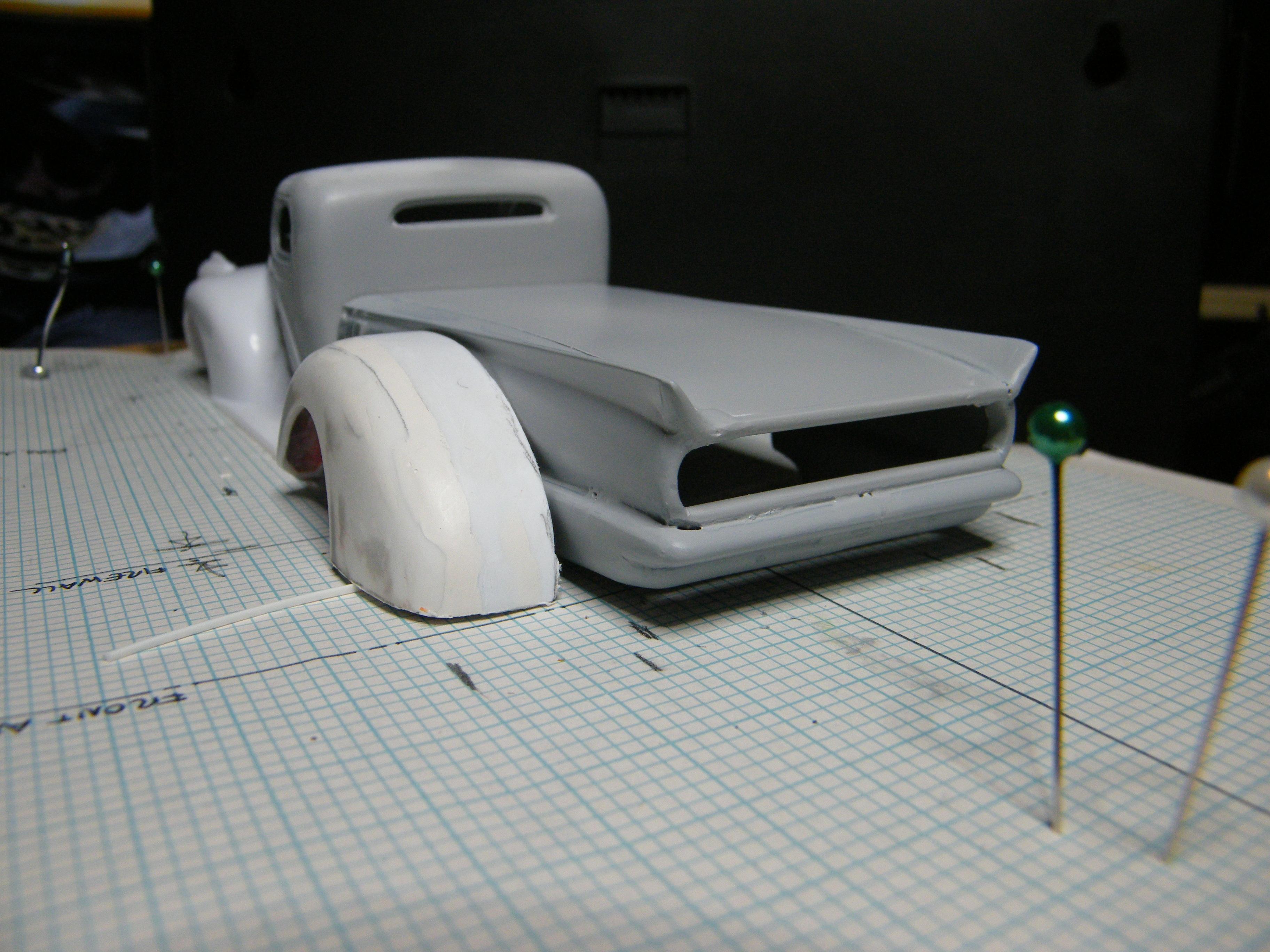

Heaps of cutting, filling and sanding. Bodywork is largely finished just working on the new nose and a general clean up. I'm thinking I'll glue the hood to the nose to get the right profile then cut it off again. We'll see. Brian -

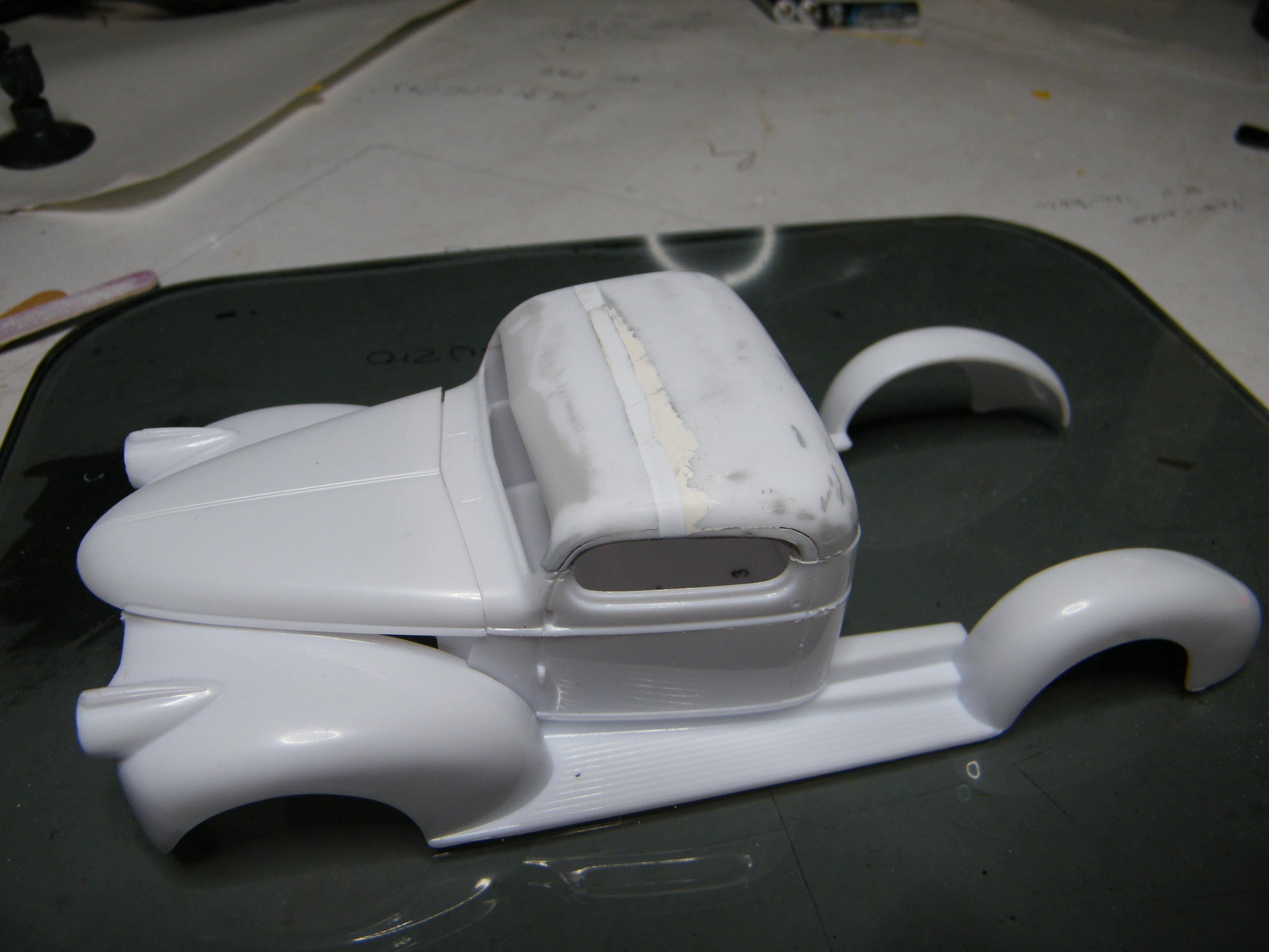

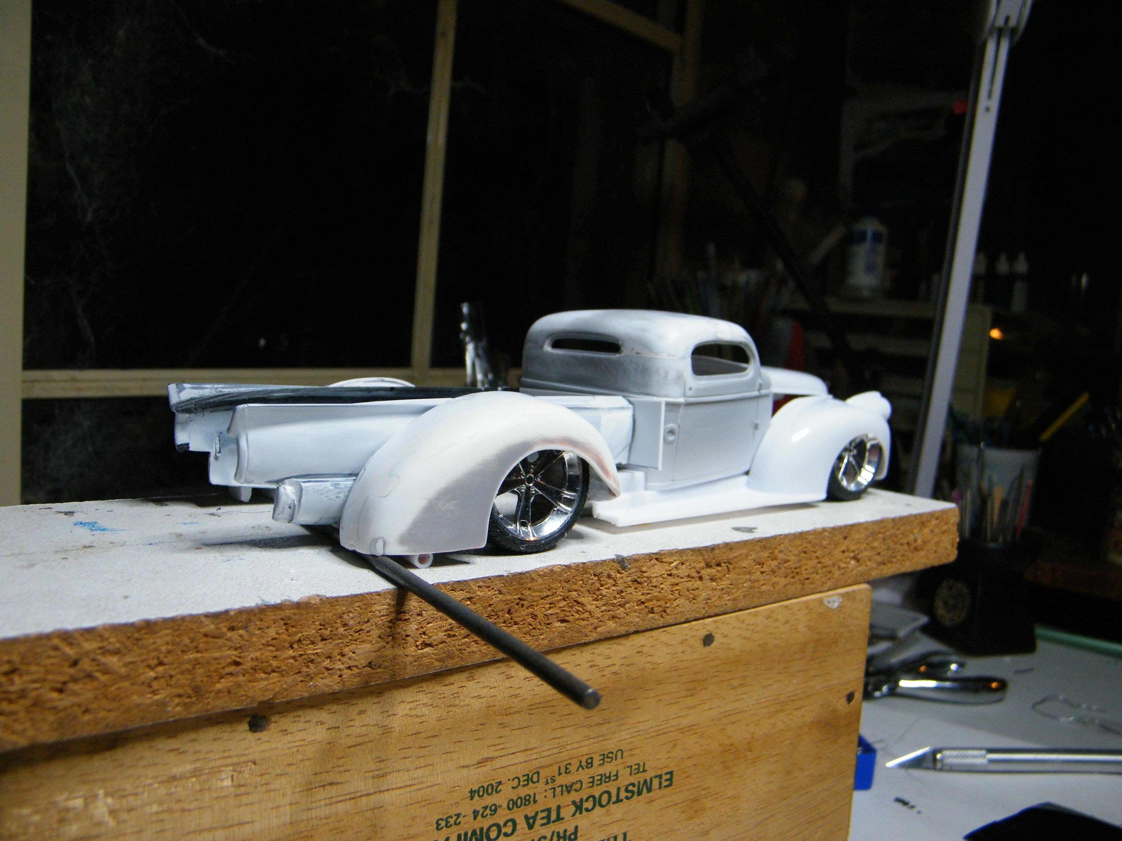

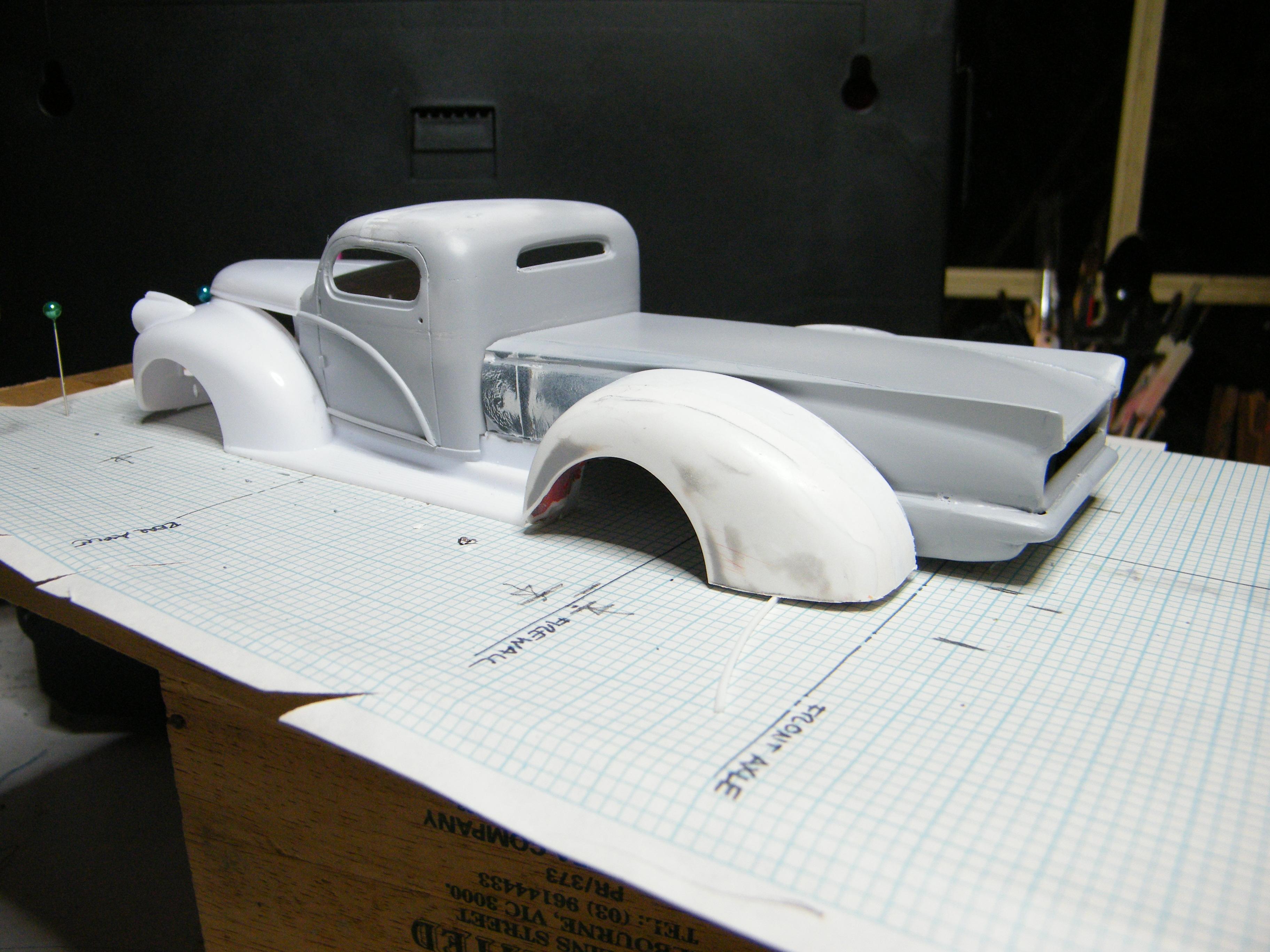

The cab, bed and some other bits were a gift from a fellow club member. Originally intended as a tow vehicle it sort of descended into a full on custom (again...). The Chev rear fenders didn't seem big enough so I modified a pair of '40 ford rears and widened them at the same time. Was going to use the stock bed but so does everyone else. The T'Bird rear quarter panels worked very well, even the fins continued the theme of the bent sides of the original bed. I cut 4mm from under the belt line of the cab and tops of the front fenders and another 4mm out of the cab which meant the roof needed lengthening. Took a long time to get right!. At this time the deck and door panels will be timber so it's sort of a woody... sort of. Think I'll keep he straight six with some mods. There is a lot of body work to go yet!! Brian

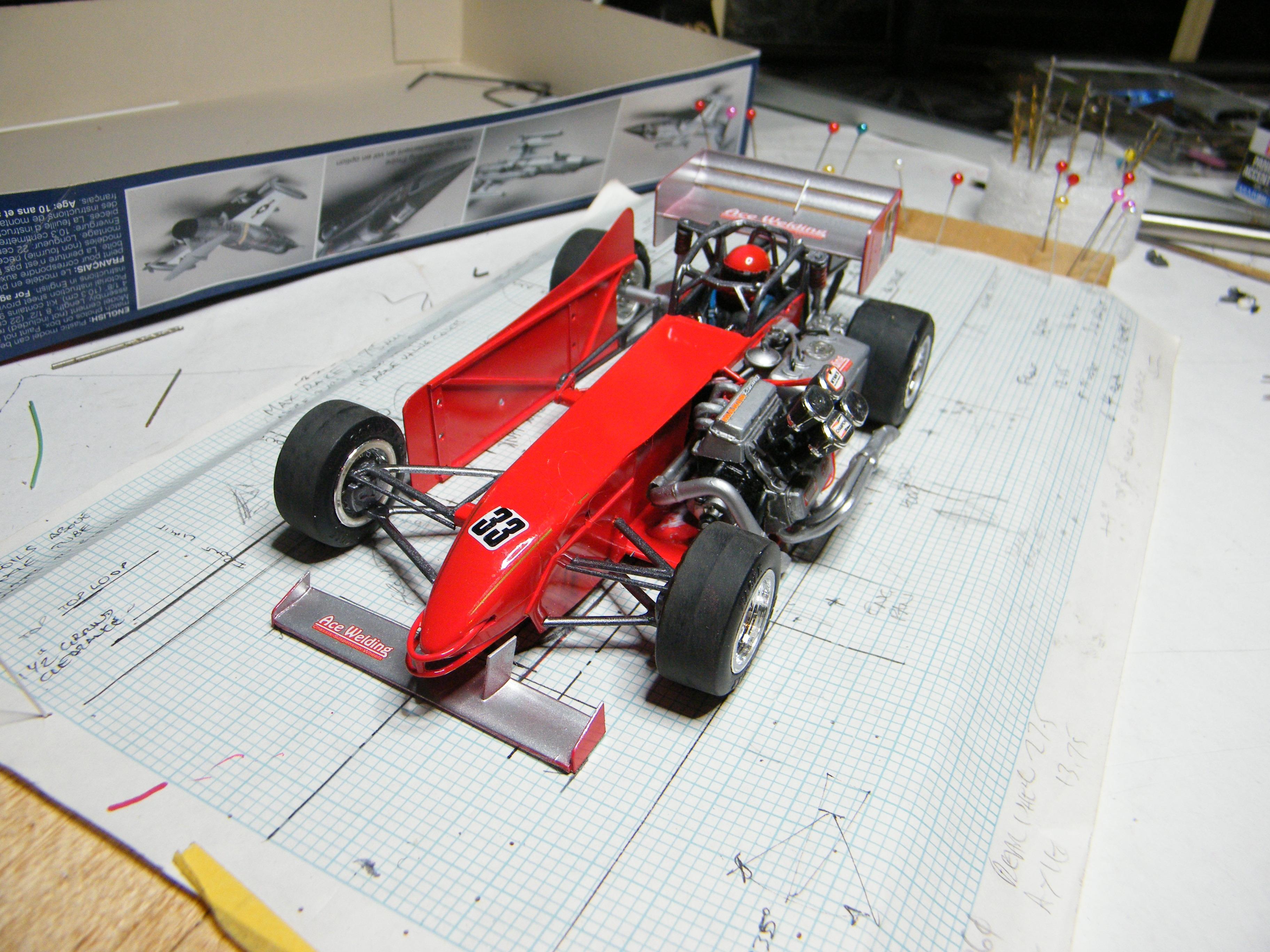

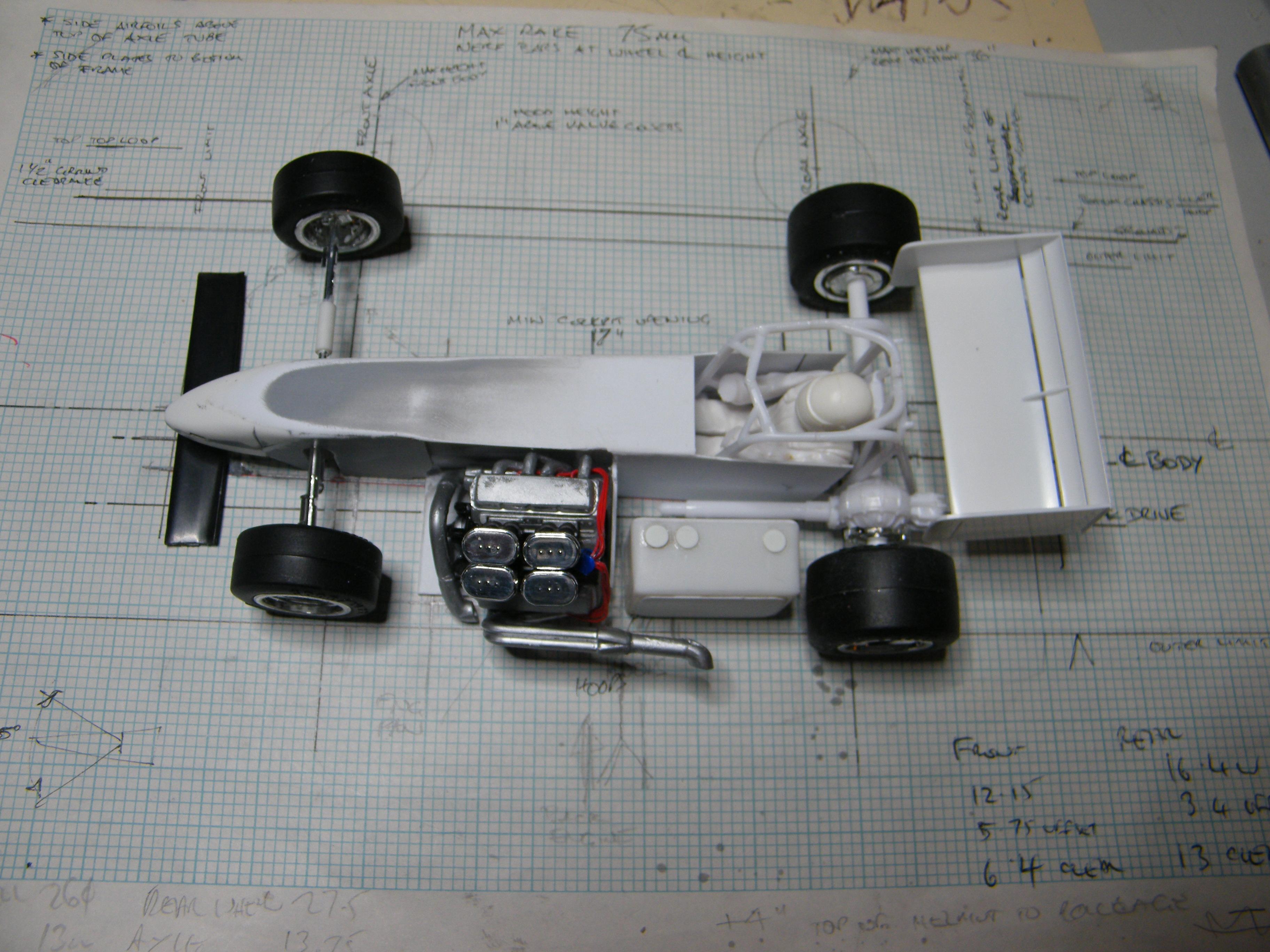

Thanks for the kind words gentlemen. Car is now finished and in the Under Glass section. Looking at it the only thing I would change would be to go back to the beam axle originally intended but I couldn't work out how to do the links so they would be strong enough. Otherwise pretty happy with it. There seems to be a lot of options for the suspension on these things. I often use the graph paper base for scratch builds and framed models like hot rods. It keeps everything straight (sort of!) and I can make notes so I don't forget any ideas I have when I'm not actually working on it. Brian
Finished! Found these on the web. Awesome cars. The sort of cars I like where some very smart people are building very fast cars within some smart rules without multimillions of backing. Mostly scratch built with bits from my junk box. Looks good on the shelf. It's not copied from a specific car nor is it particularly accurate but a lot of fun. Brian

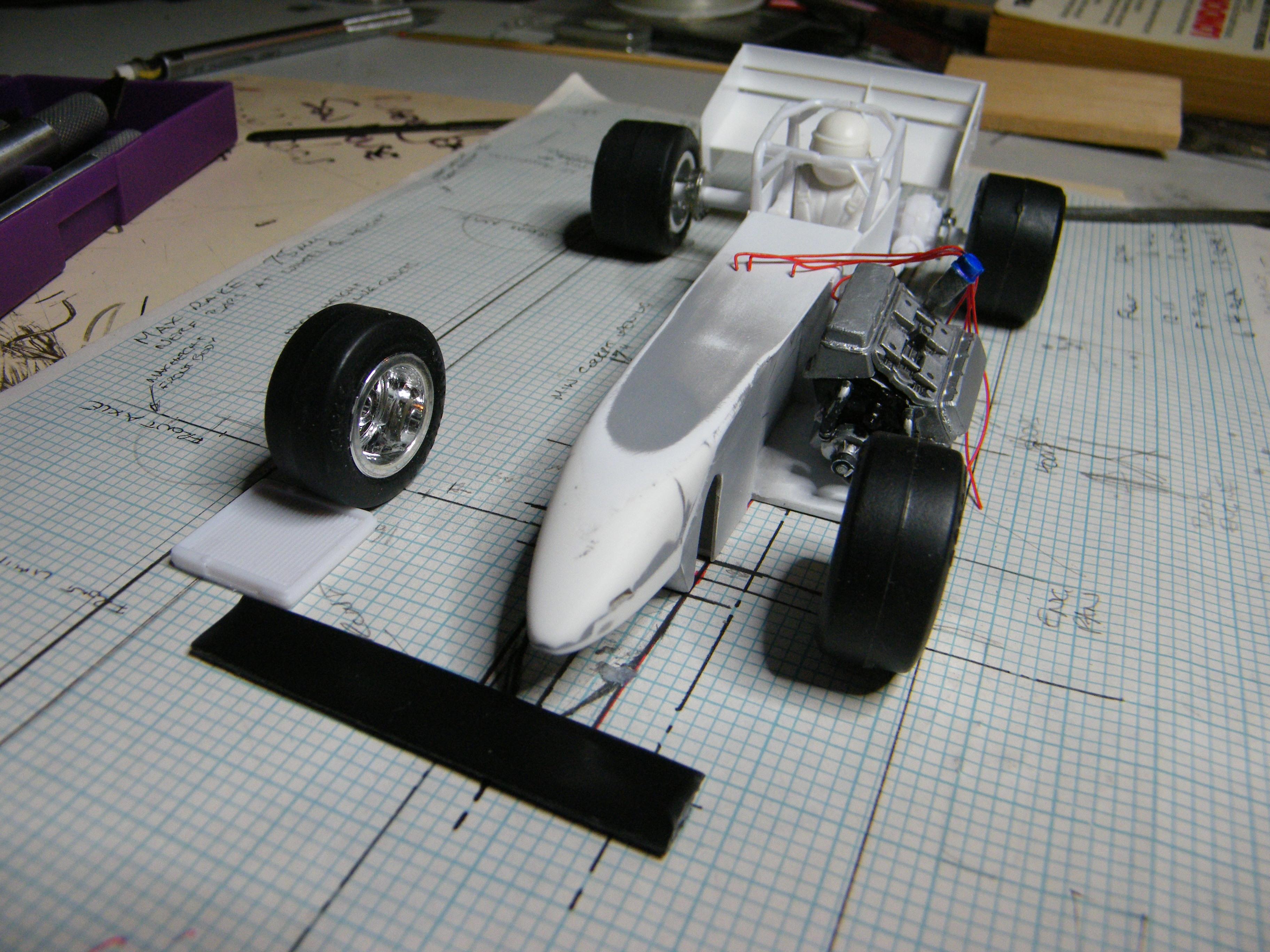

90% there! Suspension is almost finished and mounting the side panel is next then a lot of little detail cleanup. Brian

Thanks for the comments. The wheels and part of the nose were from an old indy car kit. Rear wing is a 1/20 open wheeler, I have forgotten which one sorry. Part of the cage and carby's are sprint car items. I'm building it in two halves, the forward body shell, engine and front suspension and the back half hanging of the frame work. It was the only way I figure how to paint it andget the diver in! That rear end still needs a lot of cleaning up to look right and the wing won't sit straight. I'm working on it..... Brian

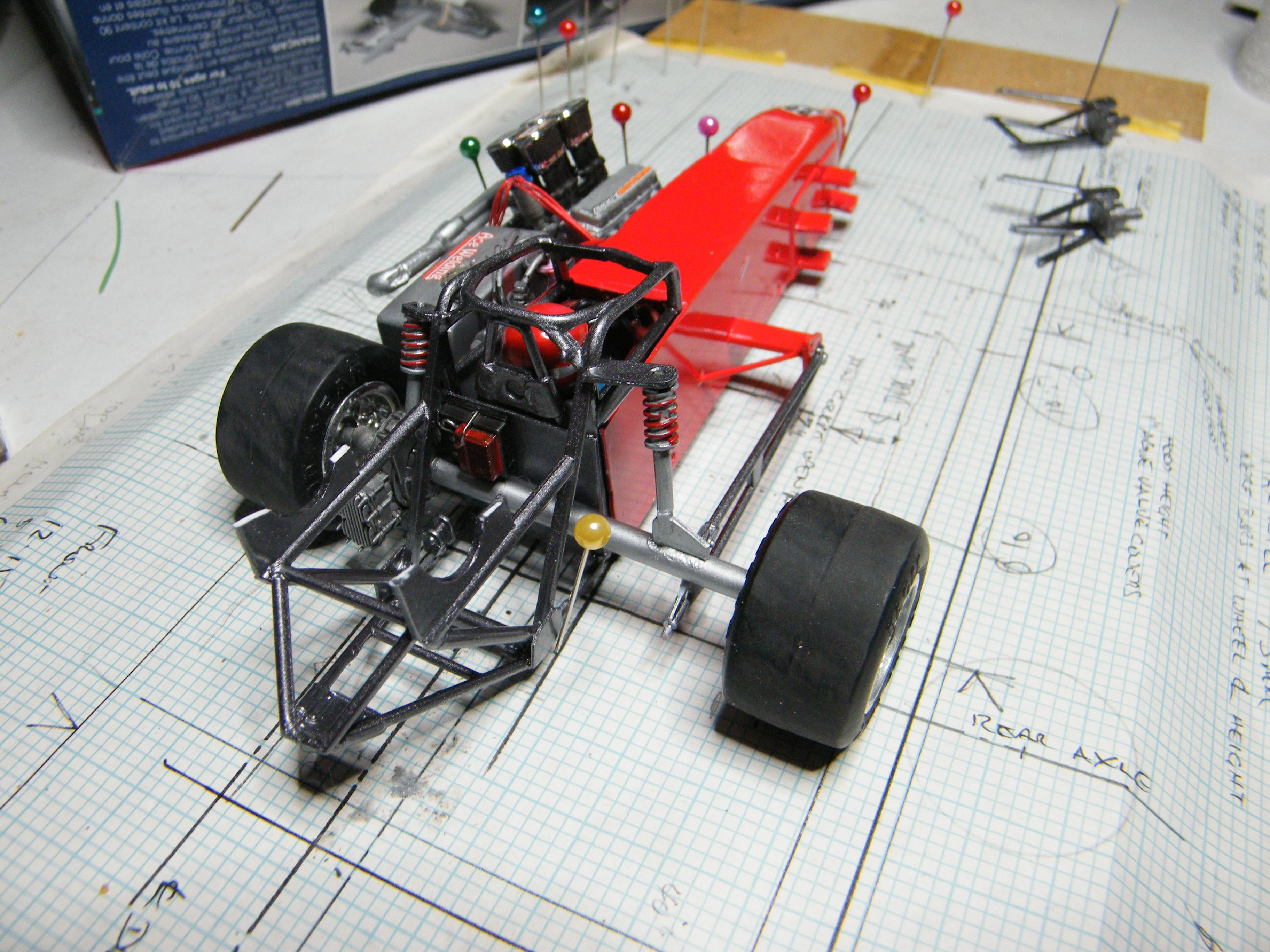

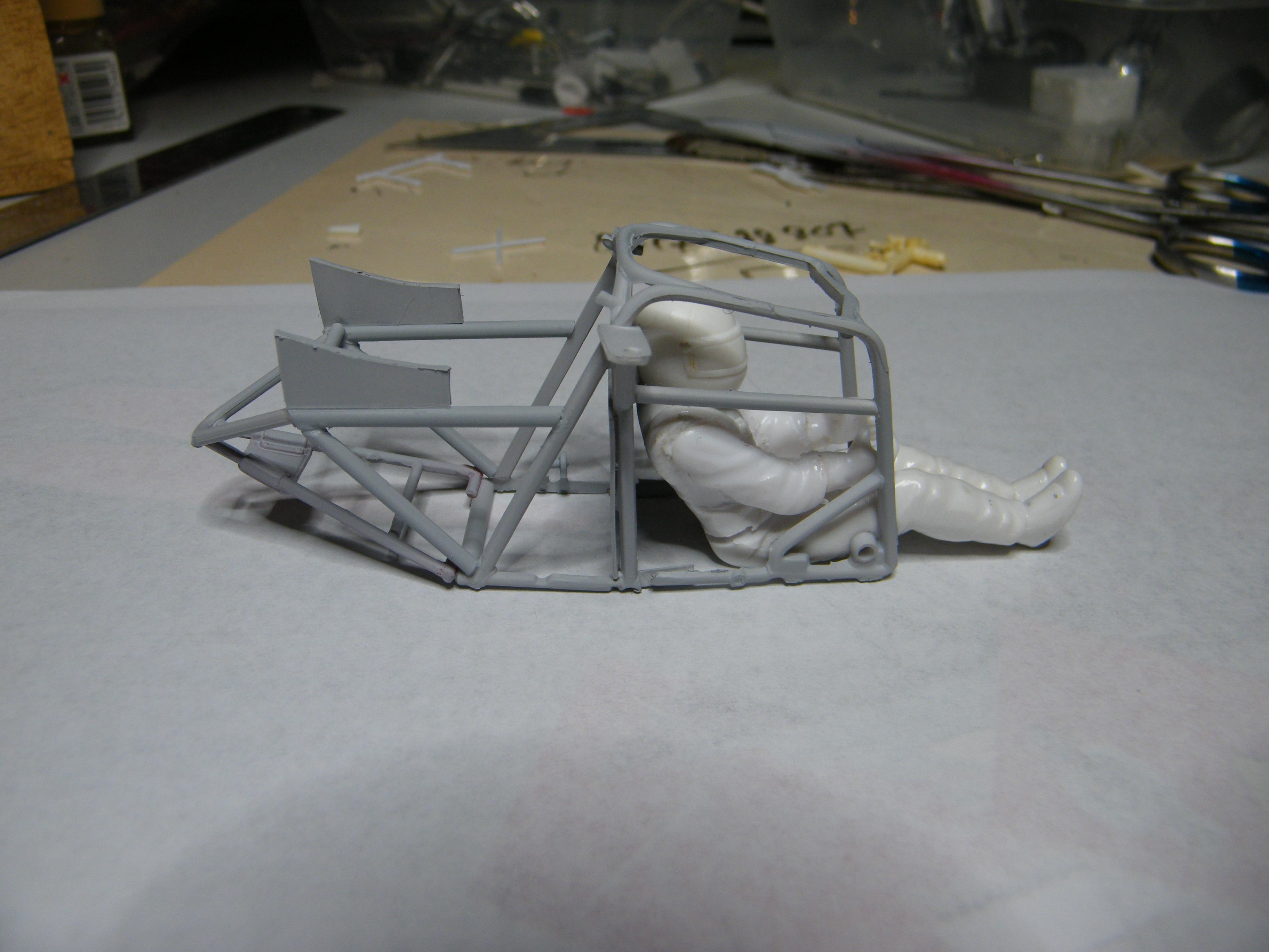

Came across these on the web and they fascinated me so I had to have a go at building one. I'm not modelling a particular car or am I trying for super accurate detail, I just want to have something representative of the type. Pretty well all scratch build so far. I have the front and rear suspensions sorted now and just trying to work out the side panel and nerf bars. Great thing to model and something unique for the cabinet. Happy to hear from anyone who has seen these things run. They must sound awesome. Brian

Oh man… Stance and wheels! That last shot is awesome. Bruce, this rocks mate. I'm reaching for my box of fender flairs right now. Brian
