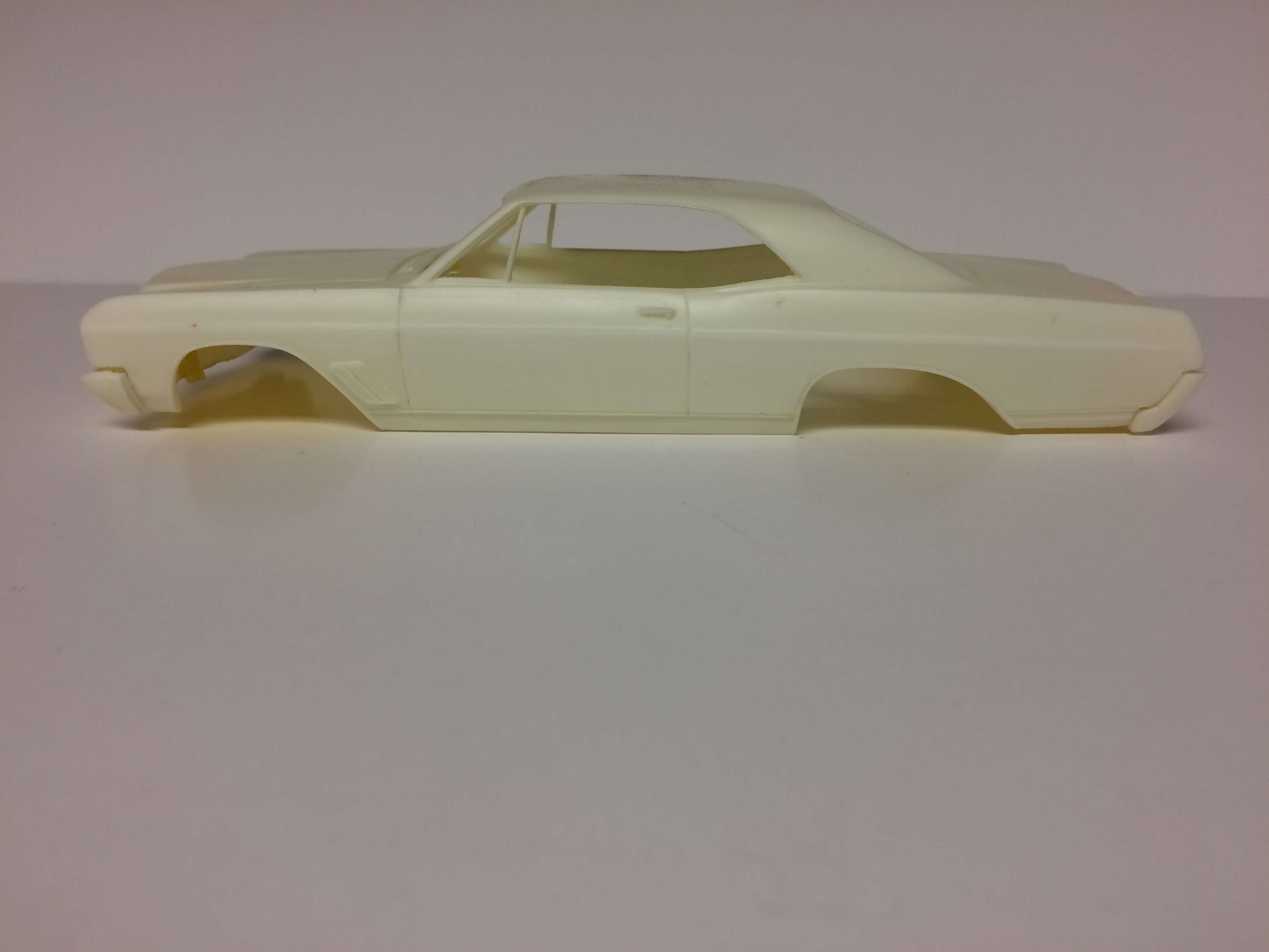

  10. Got this thing de trimmed. Opened the rear wells a bit and flared them out slightly. Also pulled the bottom rear of the rockers out in frt of the rear tires.

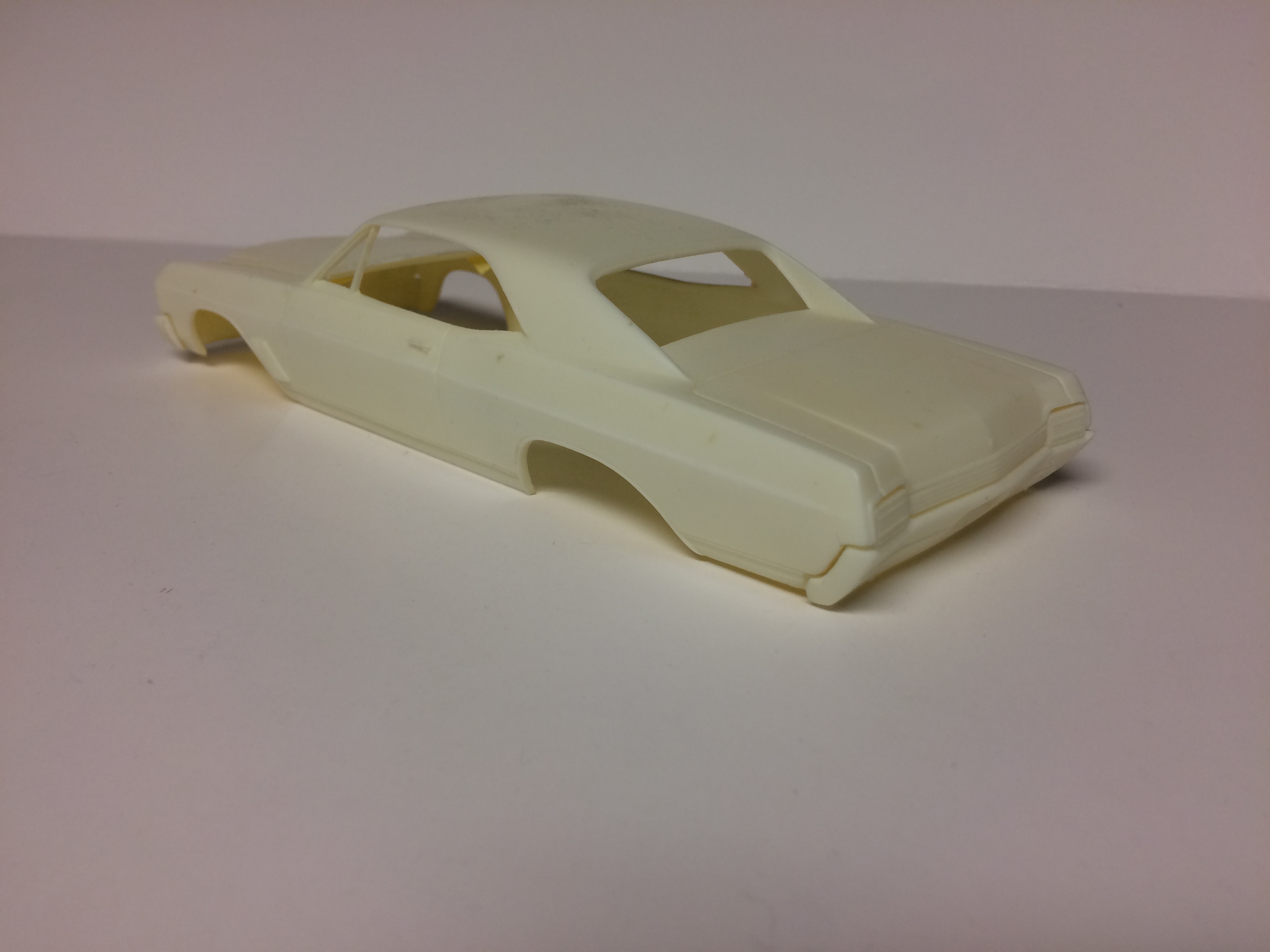

  18. Drilled the spring pockets through the frame and floor. This will lower the rear even without cutting springs. Added these spacers. They have a smaller I’d than the holes I drilled so they limit the springs from falling through. They also look like spring pockets for screwjacks.

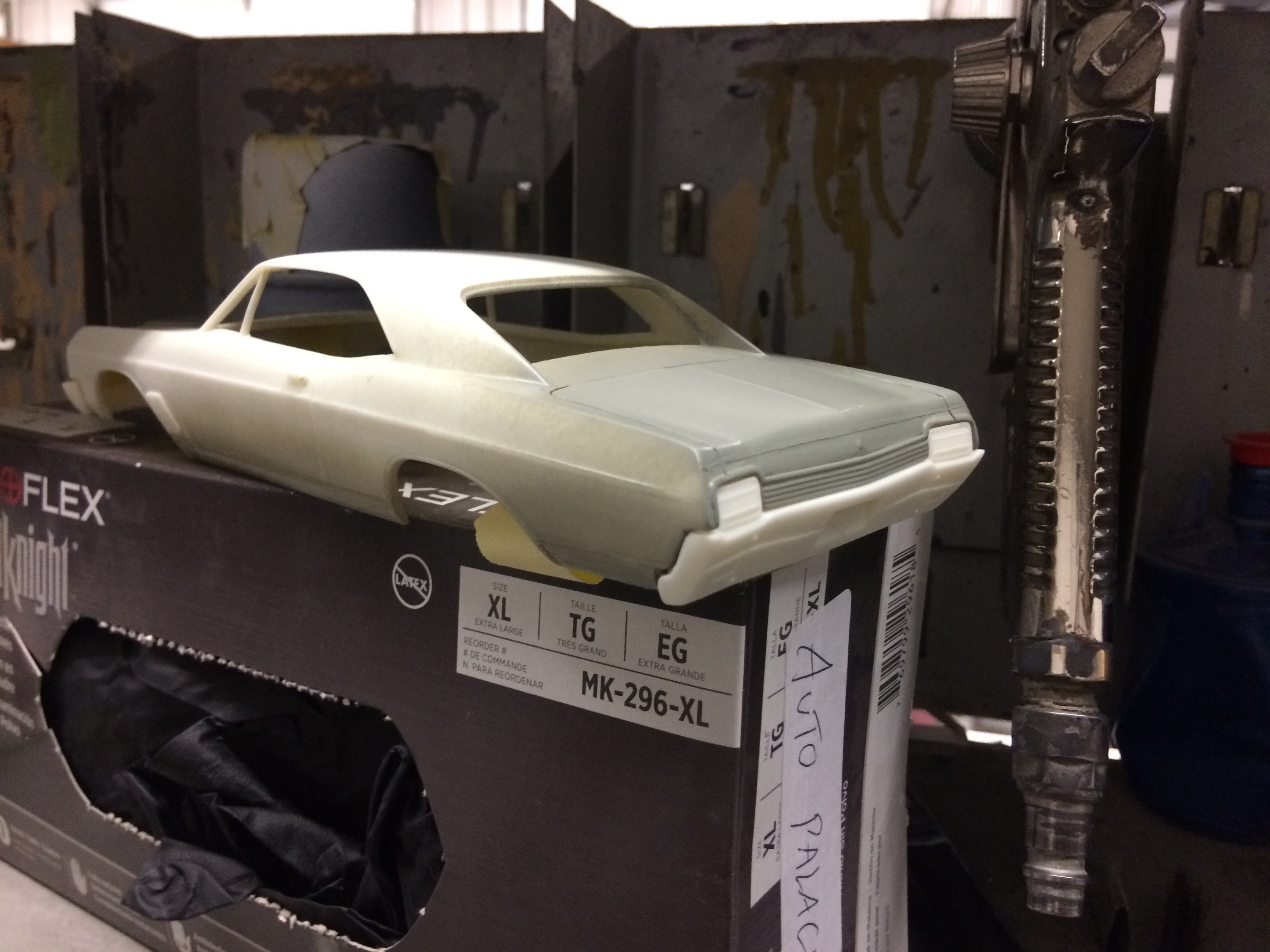

  19. Progress pictures. Had to shorten the frame and floor at the rear. Narrow the frame rails by the tires. Hog out the wheelhouses too. Added a 9”Ford rear. Made a frt and rear firewalll. The 442 firewall was too tall and had too much stuff molded in.

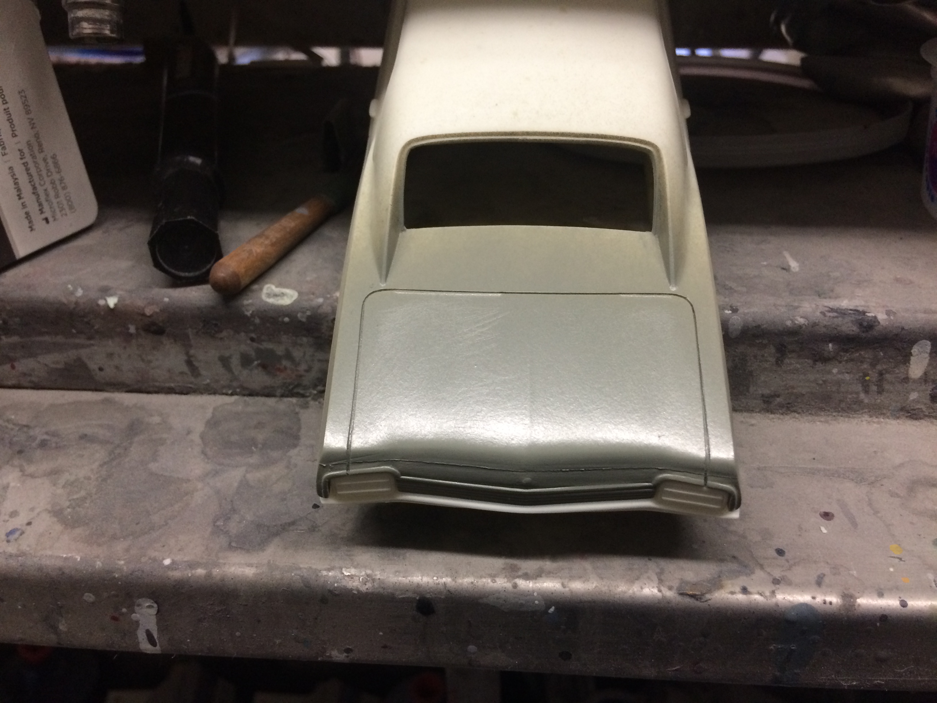

  20. Reshaped the rear end some today. The two body lines on the top of the trunk lid don’t belong. And it needs one on the back of trunk.
  21. First off many many thanks to JustJake for the body!! I will be doing some corrections along with some mods to this body. It will hopefully go on an AMT 66 442 chassis. A 69 Riv gave up its engine for this build.
