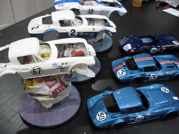

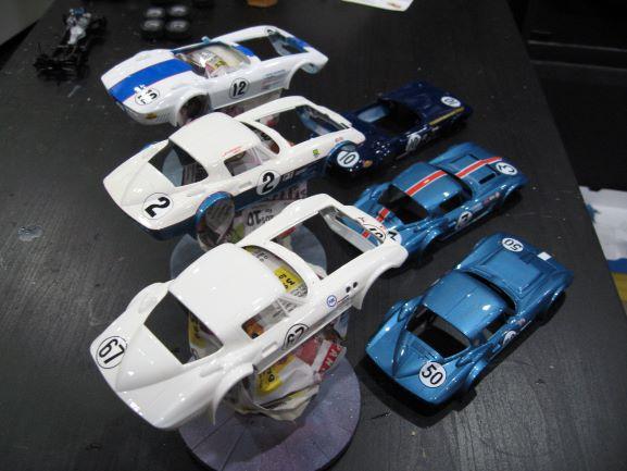

1965 Sebring #2 Grand Sport Corvette
65slotcar replied to 65slotcar's topic in Other Racing: Road Racing, Salt Flat Racers
thanks guys there is still about 10 more versions i have not done, but may do a couple more down the road. -

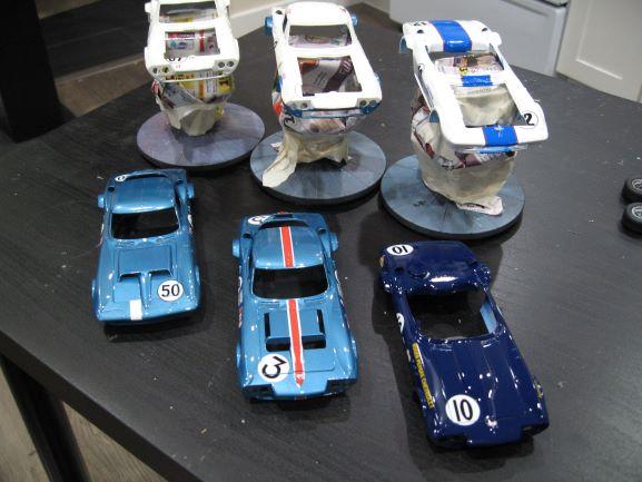

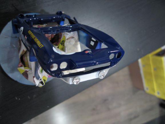

Penske Sunoco Grand Sport Corvette
thanks , Corvette is HRM transkit to make a full kit . Shelby hauler is a modified AMT Ford c-600 full kit with engine and a scratch built flat bed. i don't remember if i started a topic on it. thanks , i'm not sure if it's Penske blue but looks close to me. i used Zeropaints Lola t70 Royal blue part# ZP-1054 (over light grey primer) -

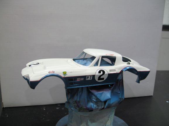

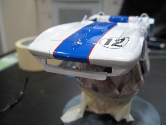

grand sport corvette roadster
thanks guys and great pictures Rex. it's great to see these cars un-restored -
thanks guys. Phil , i hear you on the required discipline, like most if not all model builders it's not easy to finish a project when you have many other un-built model kits you would like to start or finish. i started this flat bed Shelby hauler about a year ago and will try to finish after all the Corvettes are done. -

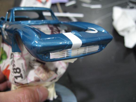

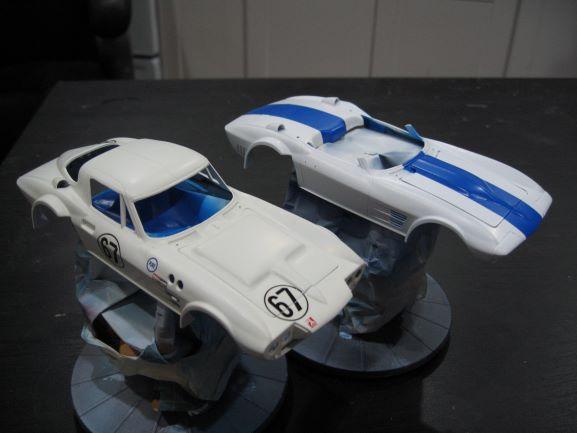

thanks guys blue for stripes was airbrushed using Zero Paints Ford and Chevy engine blue part # ZP-1395. you will enjoy this one, the kit comes with parts to build restored Penske Sunoco version also. a headrest behind the driver. also not sure if this Penske car is a replica. -

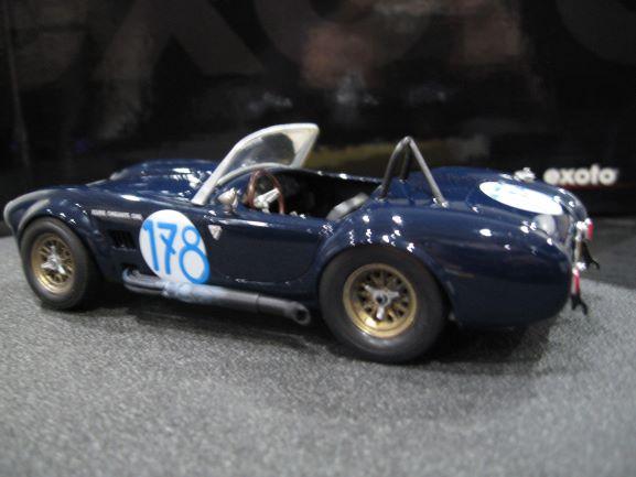

cobra csx 3013
thanks Mike and great pictures Charles. I have never seen the #45 car. interesting windsheild and front shovel . i have decals to do the 73 car but not 236 and 45. -
thanks guys for all the positive feedback. Yes Harold's HRM transkit. i have a few HRM kits but this is the first to be finished. this kit is very accurate with correct 427 , different dash, correct torque thrust wheels and many other great parts. -
cobra csx 3013
thanks for the correction, world registry of Cobras & GT40's doesn't have that info. just that it raced by Jo Schlesser under Ecurie Filipinetti banner and does not mention any other drivers.
