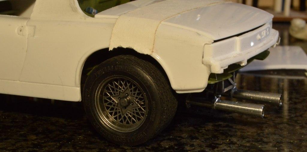

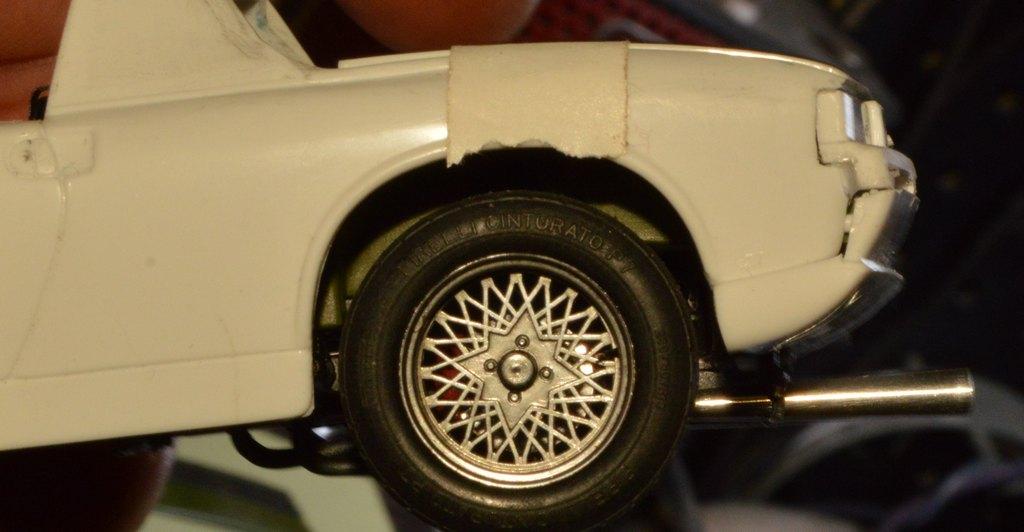

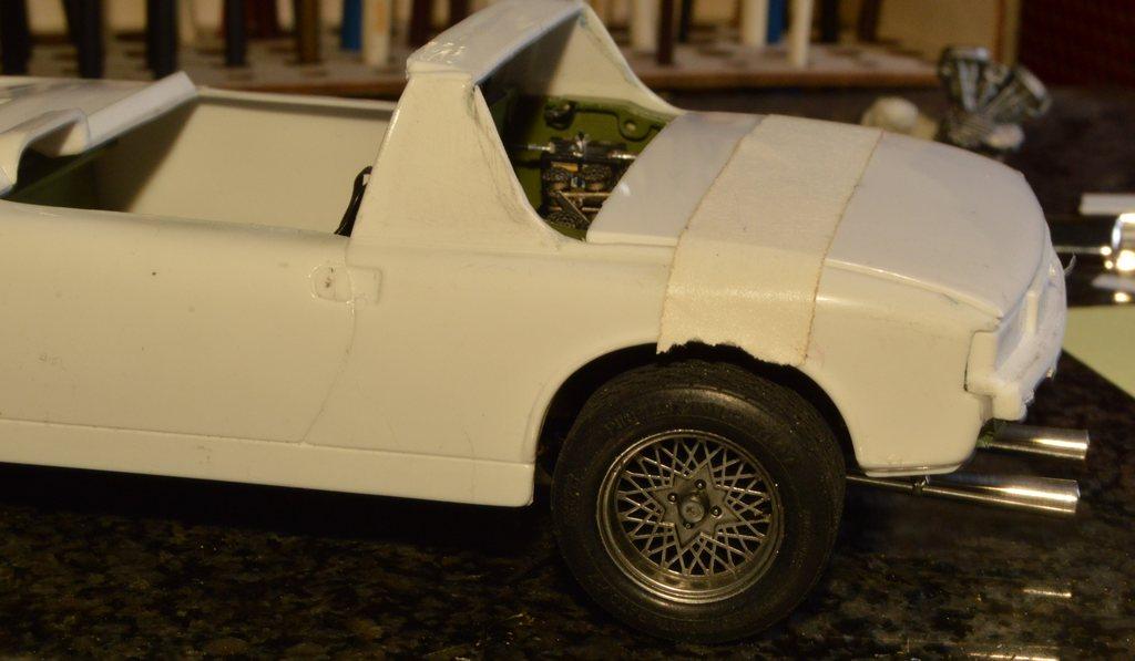

Thank you, Dennis! While I am still working on the inner door panels, I wanted to look ahead to the body. Earlier in the thread, I mentioned that I had cut the rear "cap" into two sections. I had to shim under the taillights, to raise the upper section, and just generally make the fit in that area better. I tacky-glued the upper section in/on, to provide a look at how the lower area would now fit. That fit is much better! Especially where it meets the bottom of the QP. It will fit a bit tighter, in the bumper area, but, the bumper covers that gap, anyway. I've sanded off a bunch of the raised strip above the rear bumper. I plan to replace it with something thinner. I saw a photo of one using the treatment I am hoping to achieve. I'll need to thin the trunk lid, at least along the sides. With these modifications, I will be able to permanently mount the nose, and the upper tail area to the body, prior to paint. That will leave only the bumpers, and the lower section of the tail, which is a separate piece on the real car, to attach. I'm planning to add a racing type external fuel filler to the front hood. As always, questions, comments and critiques are welcomed. Thanks for looking!

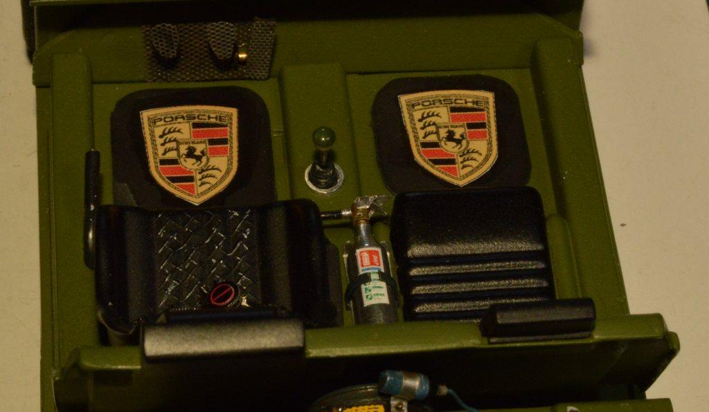

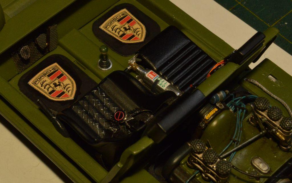

Thank you, my friend! 2022 was when I initially started playing with the sail panels. I had zero plans of building it, I just wanted to see if I could make those look better. Turns out, I could! They still need a bit of refinement, but they're already better than what Revell did. Anyway, once the computer thing happened, and Steve said it was his favorite car, it ended up on the bench. I'm a tad envious of all my friends who are currently building drag projects! The 914 definitely isn't my favorite Porsche, by a long shot, but, it's been interesting to learn a little something about them. And, scratchbuilt parts are still fun to work on, no matter the subject! I have already told him that I want to compete with it, once or twice, first! I am quite happy with the work I've done, so far! I'm currently working on the inner door panels. I whacked the armrests off, and made aluminum panels. All the doors will get will be window cranks, door handles and a pull strap, to close the door. I should have some updated photos, in the next day, or so. Thank you, again for your kind words, Francis. They always mean a lot, to me.

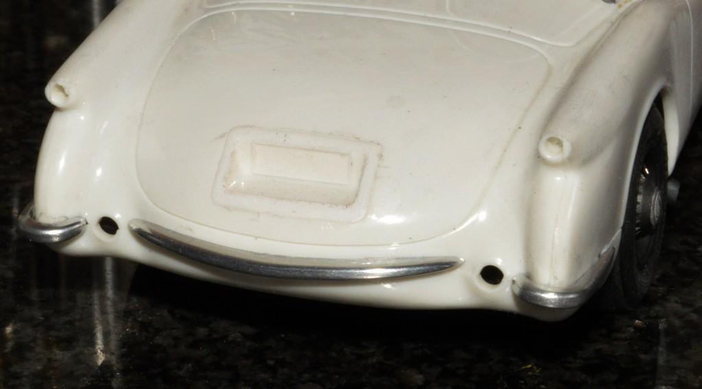

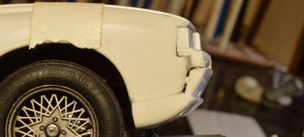

Thanks, Mike. I appreciate that! Somehow, I'd ground off the point above the taillight, on the left side of the car. I've avoided using sprue goo for filling, because I don't trust it not to shrink, over large areas. However, I decided it would be the perfect medium to repair the damaged point with, as it would more readily become a part of the body than attaching a piece would. I made a fairly heavy batch, and applied it to the damaged area with a toothpick. I let it set for a couple of hours, then dabbed on another bit. It worked like a charm! The high viscosity allowed me to pull the toothpick away and form the point. A bit of light sanding later, and here we are. Thanks for looking!
