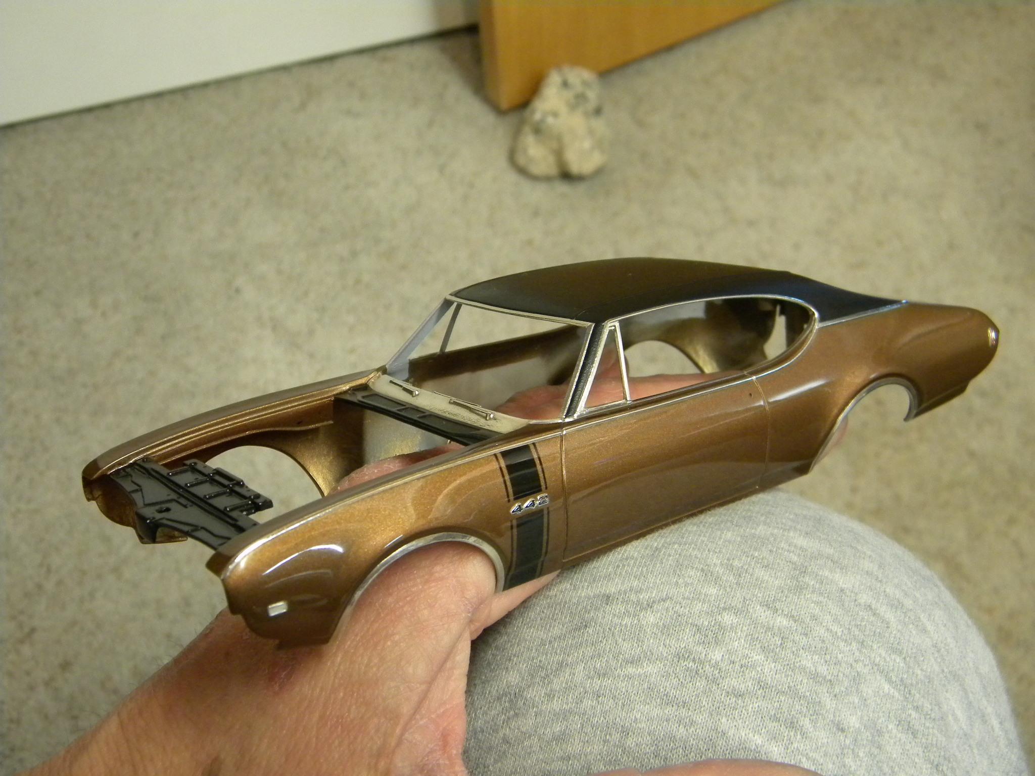

Yes sir. Here's the break down on this particular build. 1 coat of Testors lacquer primer 4 coats of Duplicolor "primer sealer" 1 coat of Duplicolor "Desert Sand Mica" 3 coats of Scale Finishes "Cinnamon Bronze" 5 coats of Duplicolor "Protective Clear Coat Finish" Steve -

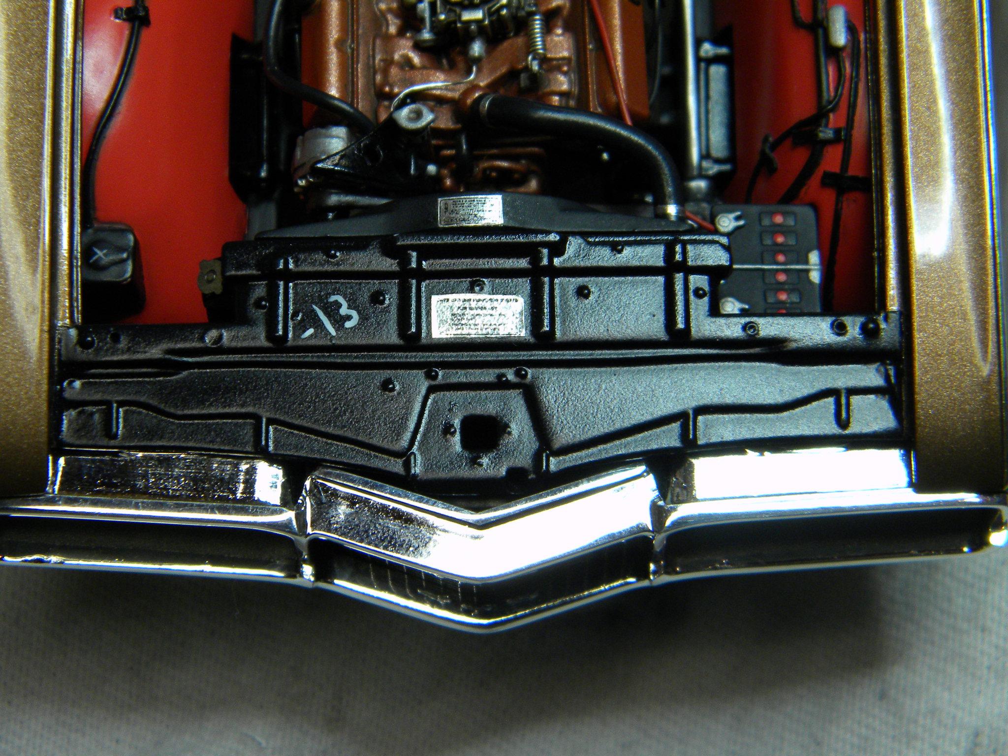

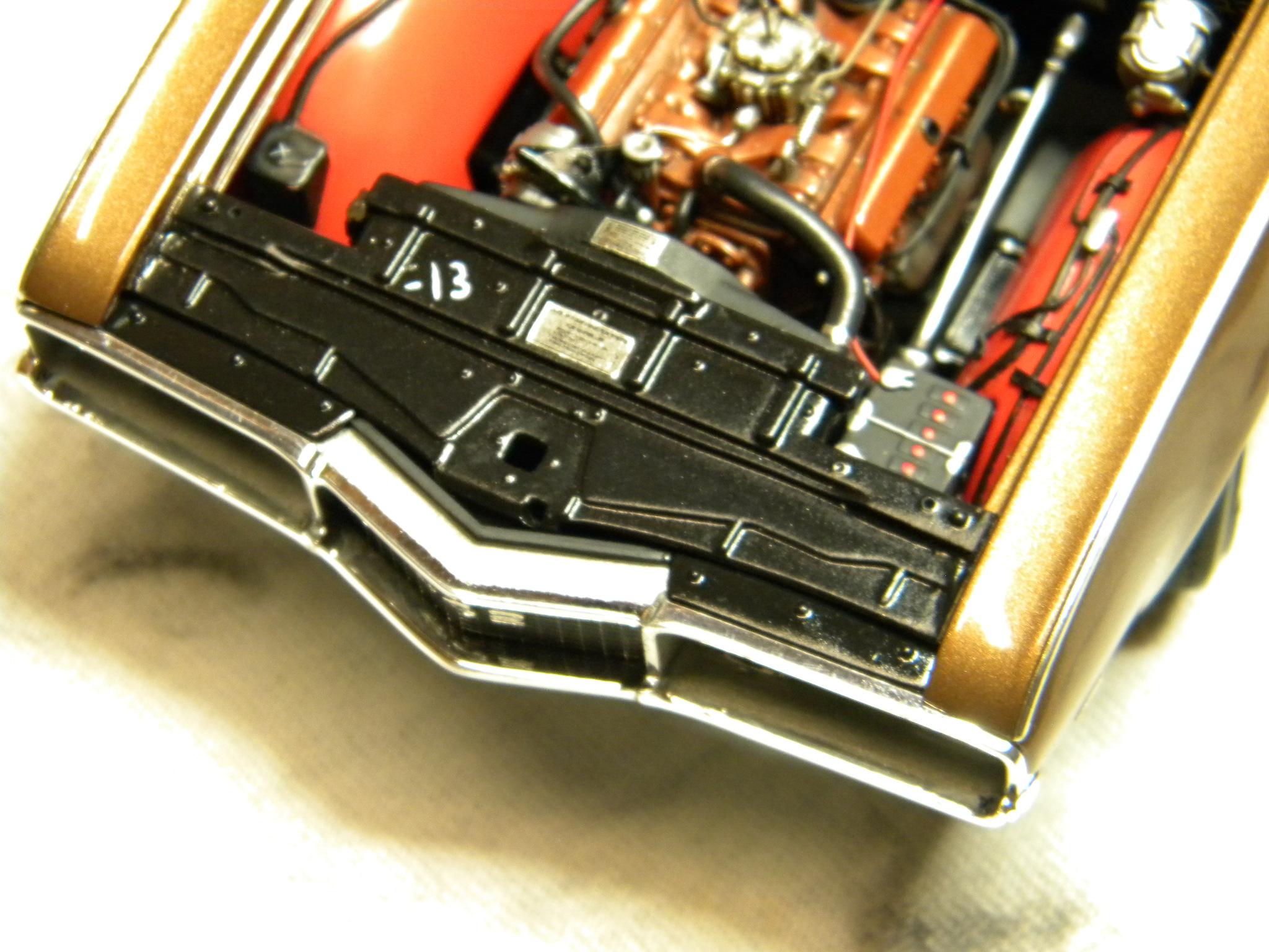

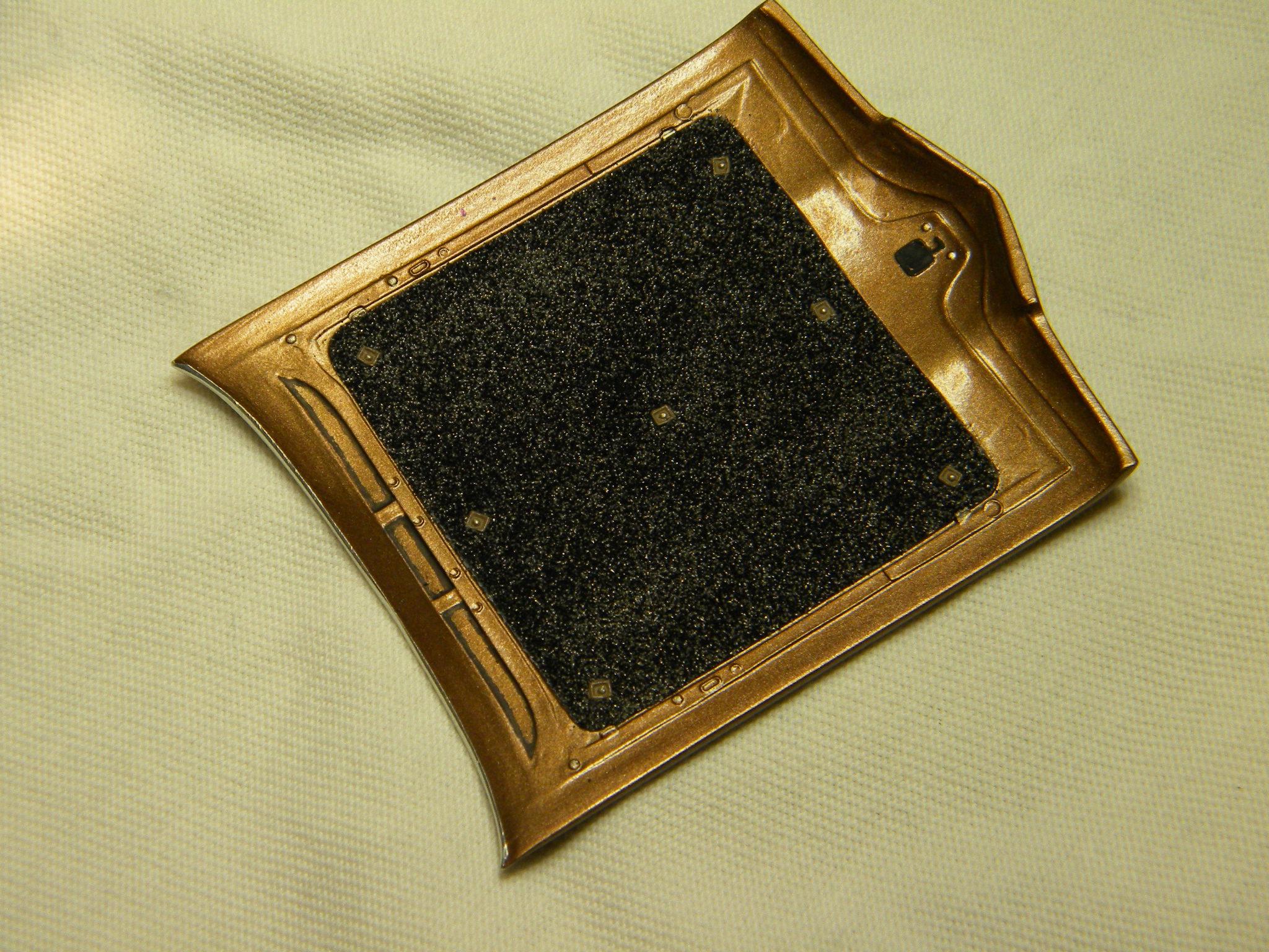

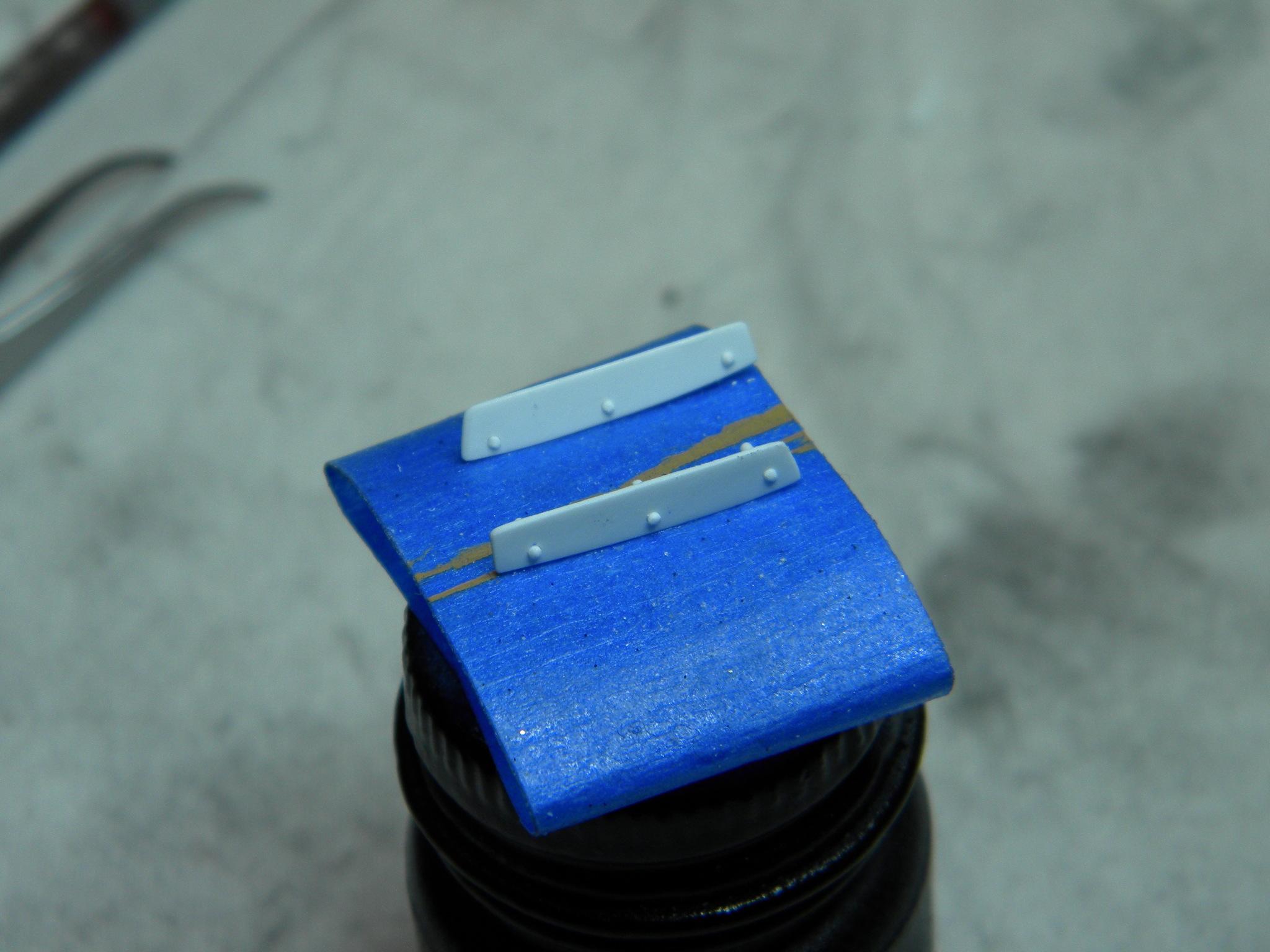

Thanks so much John and Steve!! There was one more item that I felt needed addressing before I finished the final assembly phase of this project. The front bumper/grille of the '68 and '69 Olds 442s differ slightly, and as a number of the parts for this build came from the MPC '69 kit, the area between the back of the grille and the front of the radiator brace panel leave a portion of that area appearing unfinished. I decided that a pair of scratch made panels too fill that area would make it look better. I also finished the detailing on the underside of the hood. Next will be a quick polish, and then the finishing touches can be added to complete the model. Steve

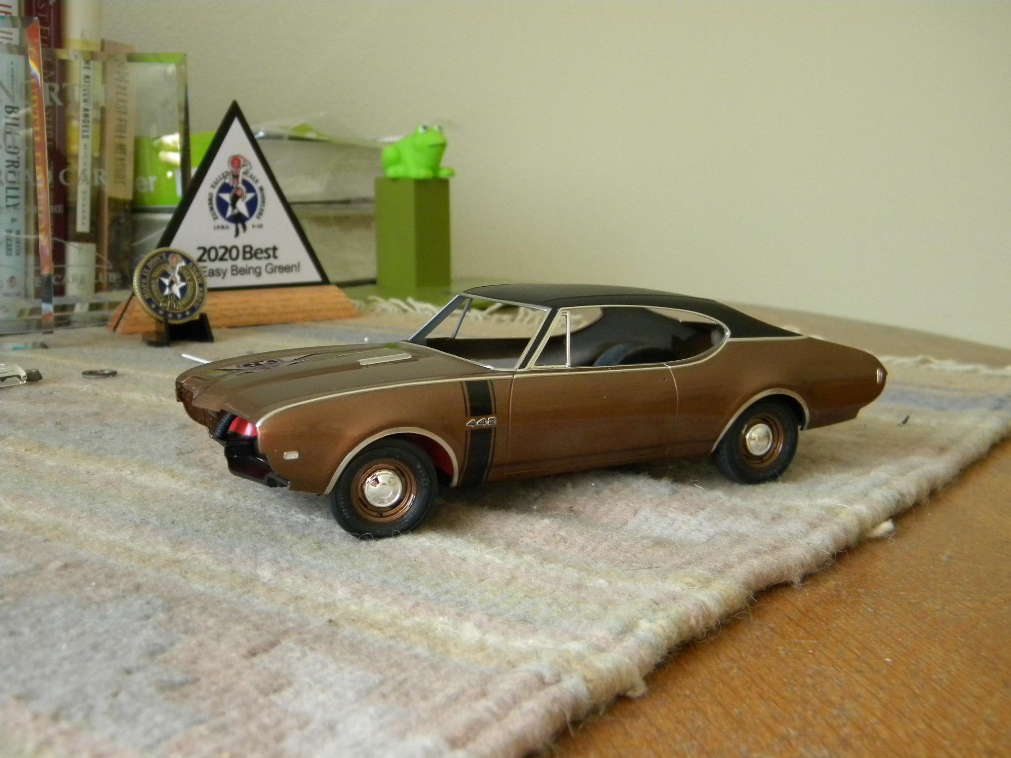

My grail kits kind of evolve as time goes on, but one that I never thought that I would likely ever find, is the one about to emerge from my bench very soon. The Johan 1968 Oldsmobile 442. This is a kit that I almost never see anywhere, and never really thought that I would be able to find, or afford, in restorable condition, but thanks to a trade with fellow forum member, Claes Ericsson, I now have one that will grace my finished build collection very soon! Steve
