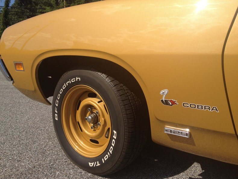

Painting side panel badges
StevenGuthmiller replied to foxbat426's topic in Model Building Questions and Answers
You can do it either way. I have done it both ways. Just wanted to give you an option to make cleaning the scripts much easier. By the way, the '62 Ford & the '61 Buick that I have posted in this thread were both shot with rattle cans. This technique can be used exactly the same way no matter how the pant is applied. Steve -
If I could make a suggestion Snake, I would save the foil until right before the last coat or two of color. The less paint that you have to remove from the foil, the easier it will be. Not only that, but if you foil before primer, there is the possibility that you can get a thin line of primer "peeking" out around the script after paint removal. I've had that happen which prompted me to start doing it this way. I always lay down my primer & initial color coats, followed by foil & then one or two more light coats of color. Then clean your scripts off before spraying your clear coats. Easy as can be. Steve -
Exactly! I neglected to mention that. Thank you for bringing that up Tom. I've seen too many attempts at this technique where the modeler did exactly as you mentioned and threw down a big rectangle of foil expecting the paint to cover the edges. It does not. Steve -
You can hone this technique to do some pretty remarkable things. One of my most successful attempts was on this extremely faint '61 Buick trunk badge. Steve -
