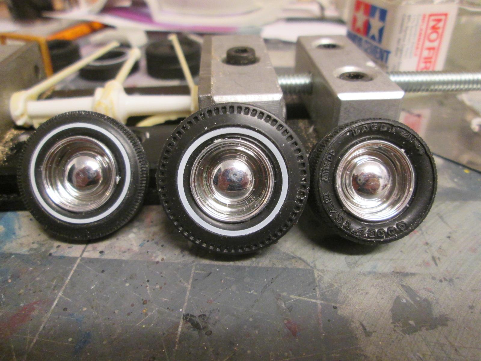

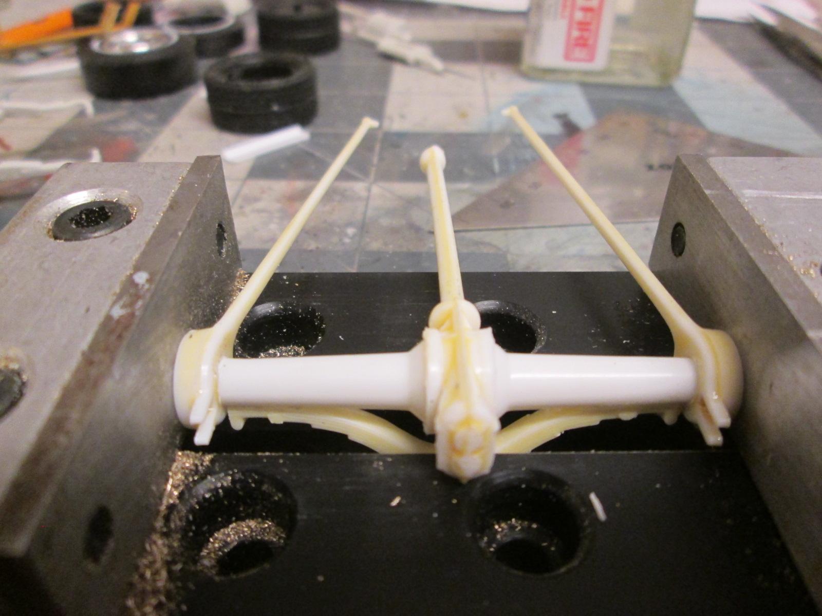

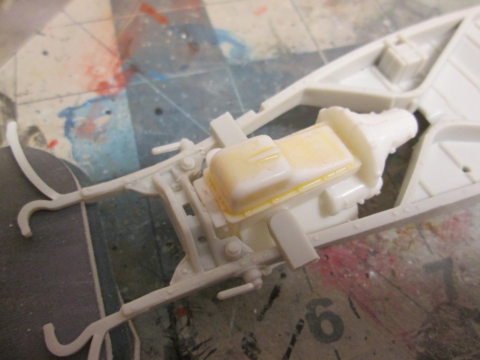

Spent quite a bit of time fiddling with the rear spring mount moving it up and down to get the ride height where I like it.Assembled the Tall T rod axle. Looks like a Halibrand to me. The '34 Ford kit comes with some nice Merc wheels and some low profile radials. The Tall T's rod option has slicks and regular bias tires with a thin white stripe. I think my mind is made. -

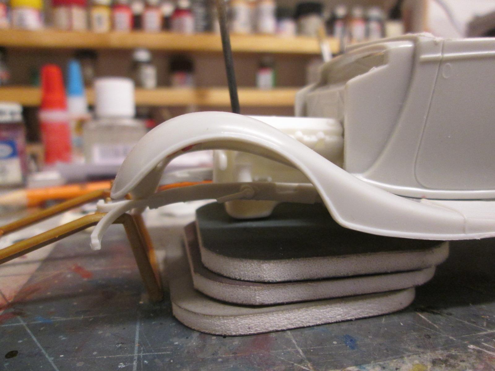

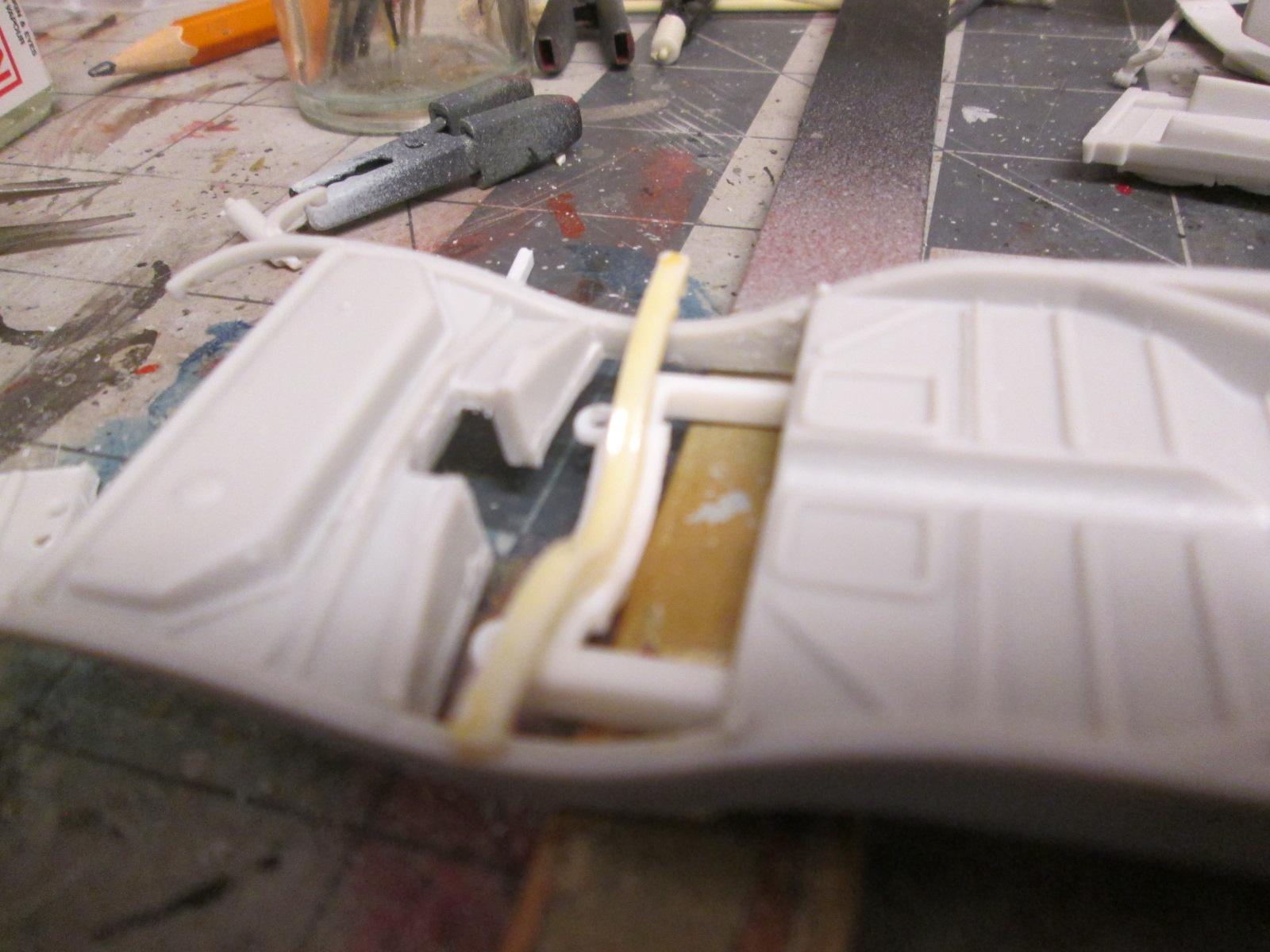

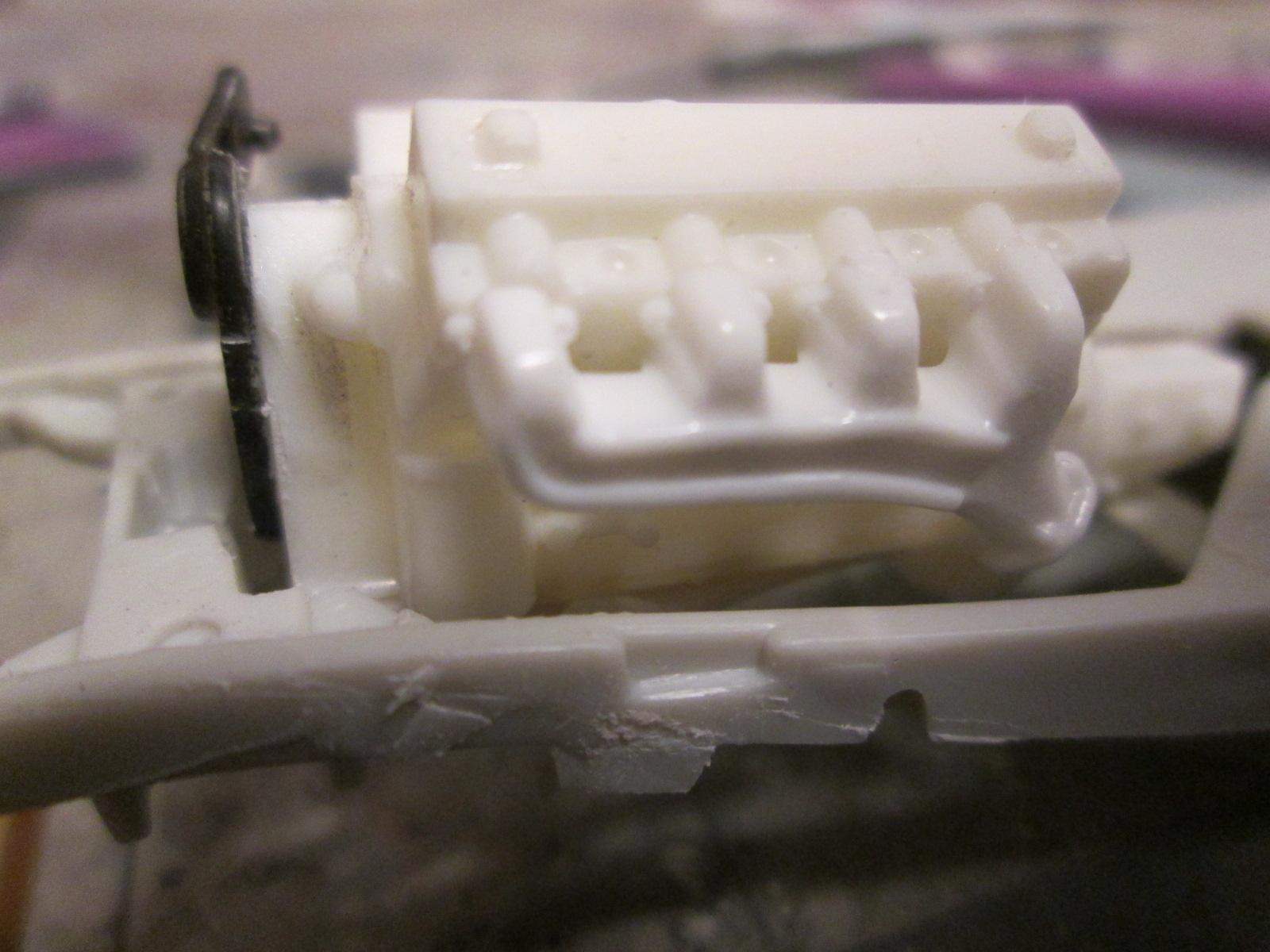

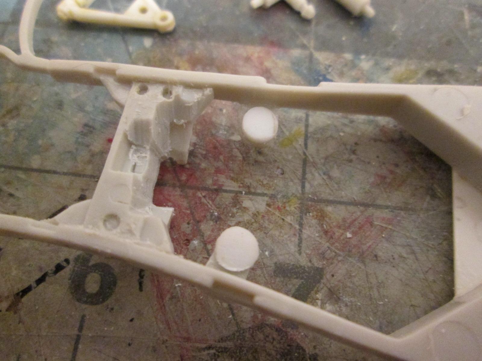

Following Ted's suggestion I recessed the firewall a bit further and added two "rubber" donuts to lift the engine a bit. It won't be as much of a sump dragger. Removed the trunk floor and notched the front flange of the rear crossmember to accept the Tall T's spring cradle and transverse spring. -

To lift it, I'd have to recess the firewall further. It is feasible. -

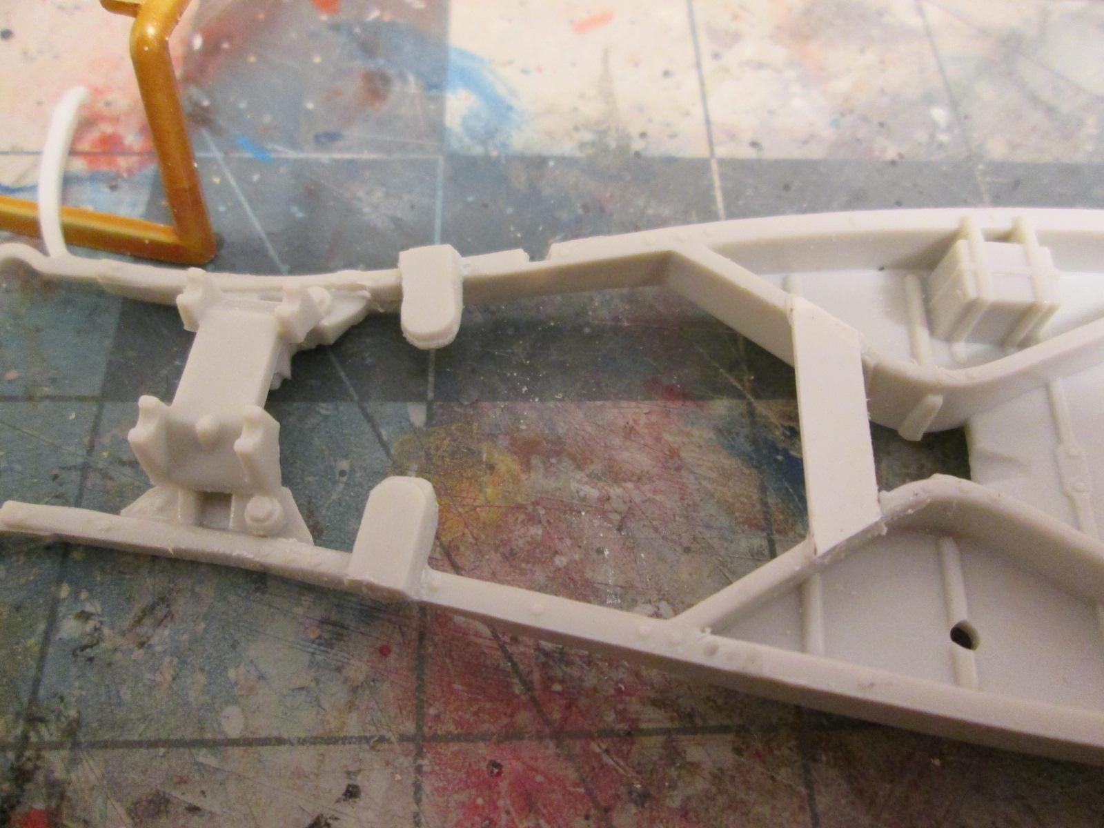

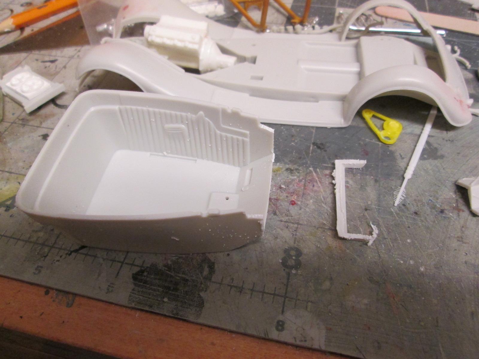

Practised two professions today, engineer and surgeon. Spent some time making sure the 430 fits in the space made for a flathead v8.. Cut off the crossmember with the idea of moving it forward and ended up putting it back on after realizing it locates the front suspension. installed some tabs to support the engine. Ended up recessing the firewall instead. Since there is no room foe a belt driven fan installed some electric fans from the parts box. Then tied several bely an pulley configurations for the alternator. Most of them didn't clear the suspension. Found a two belt setup which does. Stole some manifolds from one of my unbuilt engines that will do the trick. they are from the 80 Bronco. -

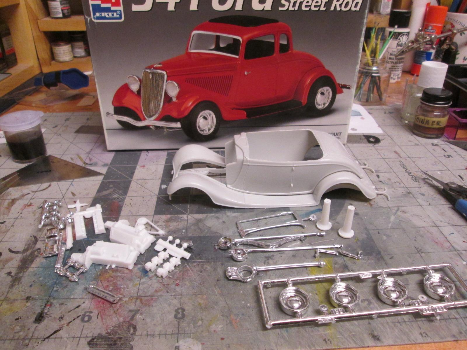

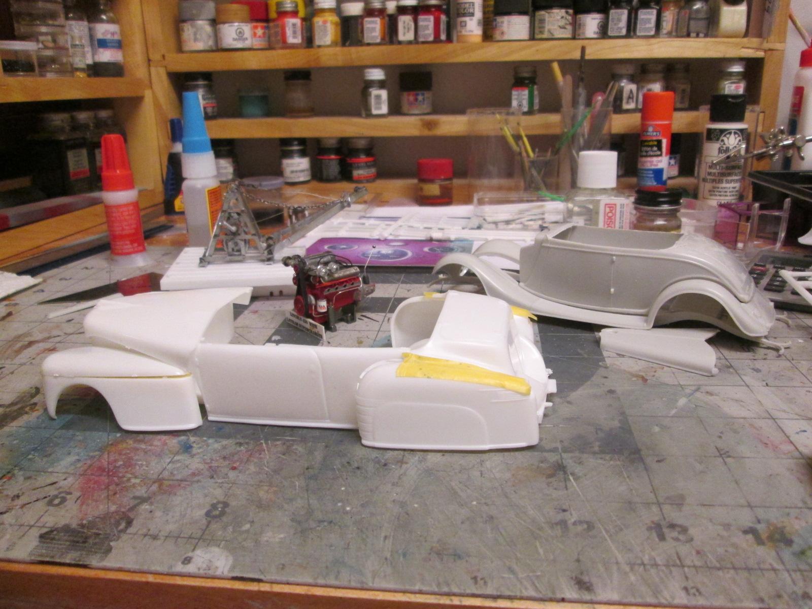

The other day I floated some ideas around which included either the '34 Ford with a Lincoln 430 or a '48 with the same engine. Well, it will be as follows: A topless '34 Ford coupe (top is on my '34 Chevy) The rear suspension from the Tall T hot rod option (the 34's rear end is under the tow truck I just finished) The 430 with 6 strombergs, also from the Tall T hot rod option The windshield from a Packard phaeton (I think) Whatever else is required along the way.

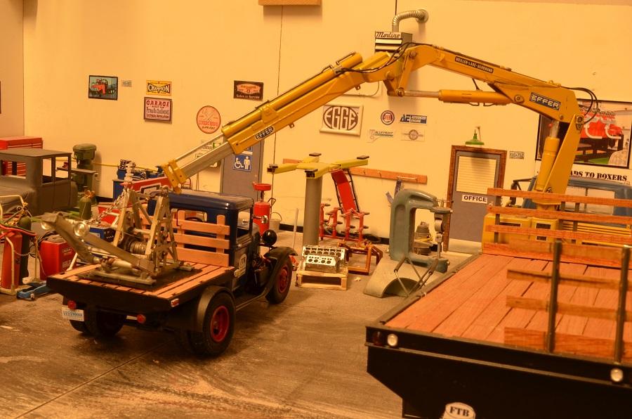

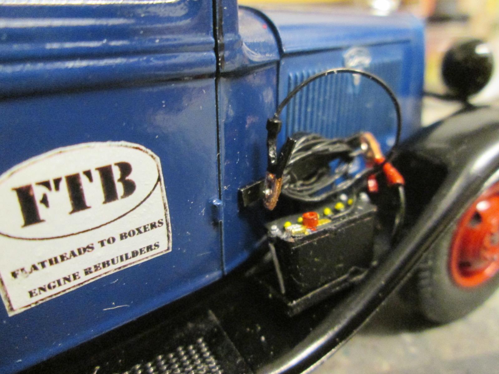

Added corporate mud flaps and parked it with the rest of the FTB fleet. -
