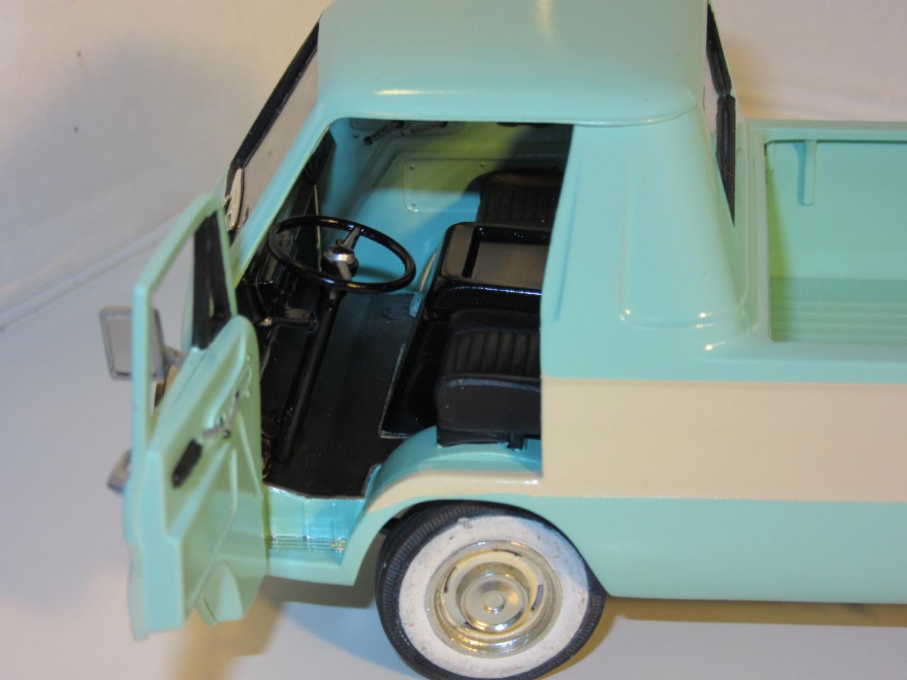

Thank you for all the kind words and encouragement. My ship was supposed to sail a couple days ago but due to some generator problems we are stuck pier-side for a bit longer so I am going to wrap this one up for now and call it done. In trying to go from out of the box normal builds to something approaching some of the works of art I see on this forum I have been setting goals for myself on each build and my goal here was to improve my body and paint work, scratch build small details, and get some practice with BMF. I think it's time to move up to an airbrush, rattle cans are just too unpredictable and the available color choices are too limiting. I need to get a good magnifier, my eye's aren't 17 anymore. I like this kit and plan on picking up a couple more including the resin van body, and a slant six. My plan for the van is to build a machine shop delivery van and open at least the back doors to show an engine and other parts in the back. The issues I had with this kit were miner and easily corrected including the lack of a brake and clutch pedal, no gas filler cap, and the windshield center post being too thick. Tom Geiger got it right by replacing it with styrene, I think a small half round piece would do the trick but the windshield is made for a thick post. The only correct way would be to make a new windshield. Again, thank you for looking.
Last night I got the body primed again, you can't see how bad the orange peel really was from the picture but the first coat went on nice and smooth, after about twenty minutes on a cool day the second coat just wouldn't flow right. The color is going on okay this time for now. I added a little bit of weathering to the engine and chassis, and since the kit didn't come with a brake or clutch pedal a made some and added them along with a normal gas pedal. Tom, thank you, I did forget about the gas filler and that meant also making a cover for the fill hose that would be on the inside of the bed. I couldn't find a reference picture online so I assume it would look something like this. Also pictured is the retainer bracket for the spare tire.

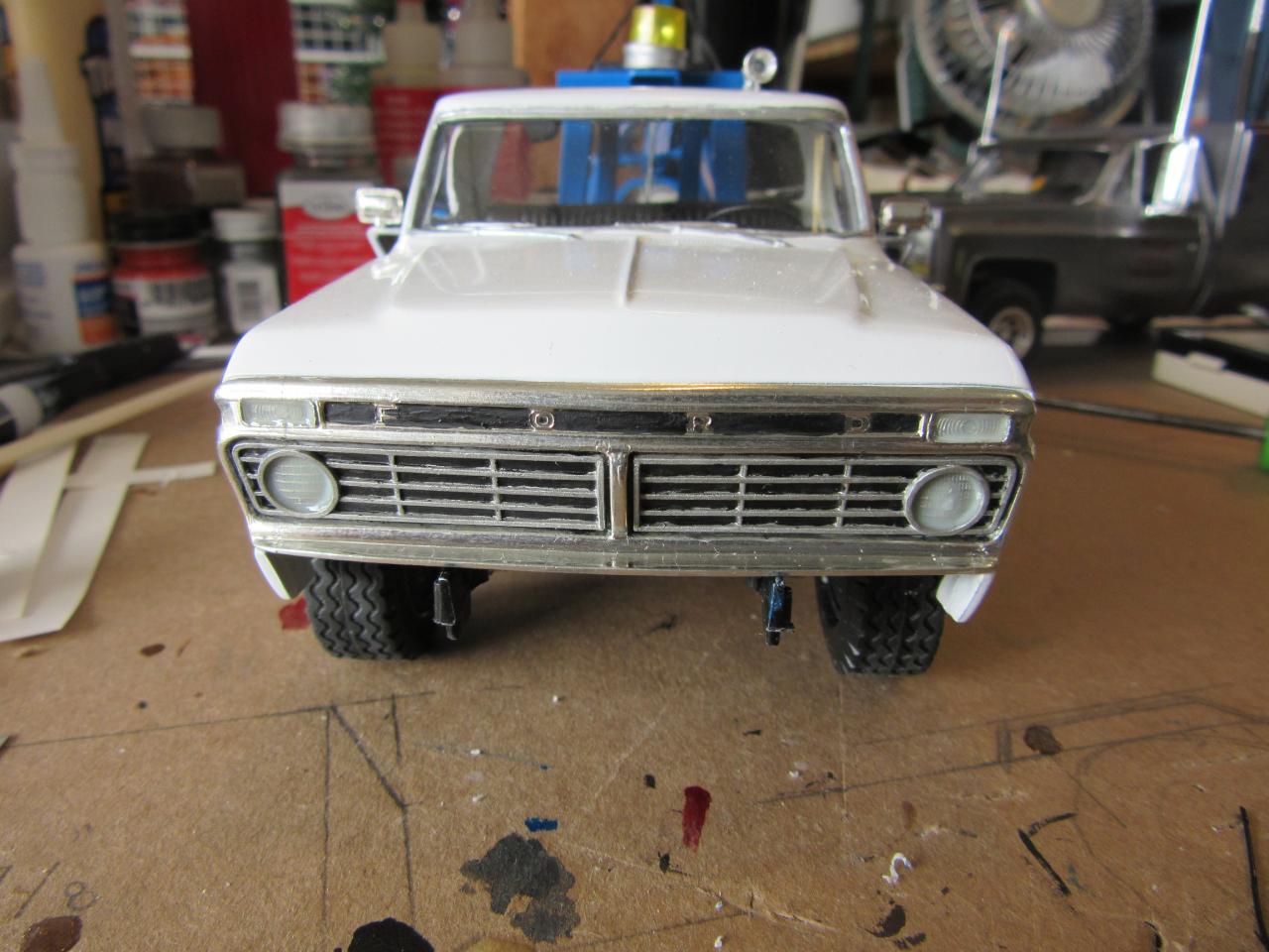

The grill came from Kris at Morgan Automotive Detail. I cant figure out how to post the link to his site but the address is www.madmodeling .com. Kris is a member of this site and provides great products and excellent service. -

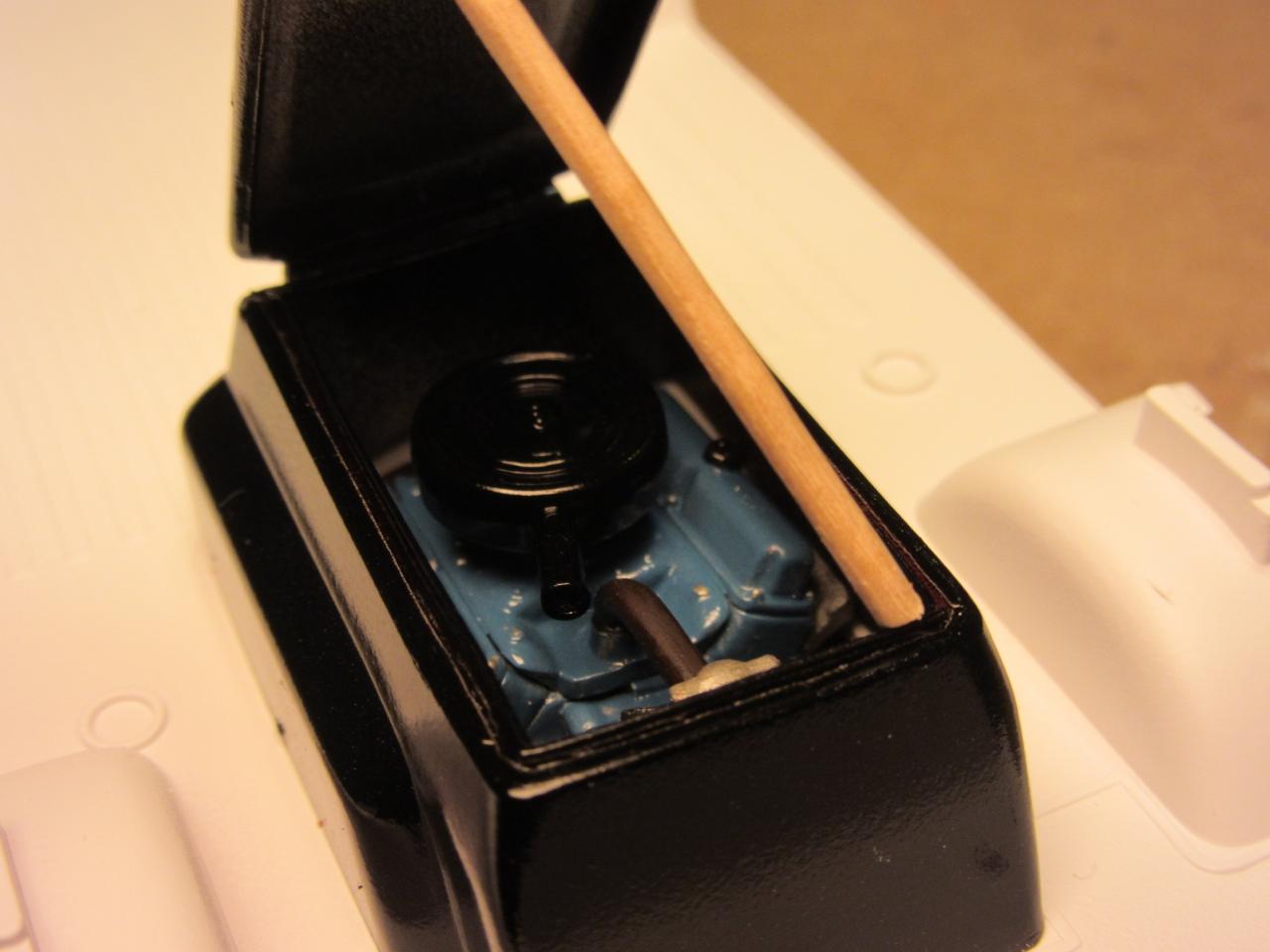

So yesterday I got the doghouse insulated. I'm not sure how they came stock but I had a 63 ford van years ago that was insulated like this so I assume they would be similar. I remember the Ford was loud so I couldn't imagine how loud it would be without insulation in there. I used some material that came wrapped around a bike stand we recently bought for the sides and foil from a yogurt lid for the top. I also wet sanded the body and got it ready for paint. This morning I sprayed it, I don't have an airbrush yet and I usually use Tamiya spray paints but I found the colors I wanted in Model Master. I don't really like the Model Master spray paints, they seem to flash off too fast and then take forever to dry without really flowing out like I like want. But that's okay, I have plenty of 1200 grit paper and some water so whenever it dries I will wet sand it and spray the second color.

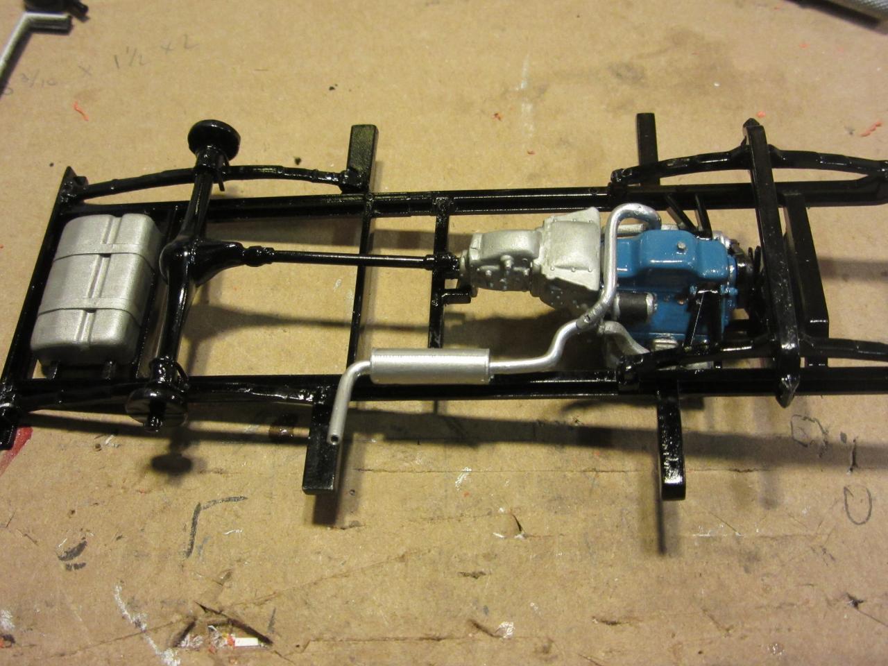

Thank you to those that have followed along so far. Yesterday I scribed the panel line at the rear of the bed side and adjusted the doors. The right door was a mess but with some encouragement from some heat I got it pretty close and got the rest of the body cleaned up and ready for primer including narrowing the center windshield post. Chassis is done and engine installed. I was going to use a pre-wired distributor but even with opening the doghouse it's not visible enough to warrant the time and expense. The next one of these I think is going to get a slant six so more of the engine should be visible. Not pictured yet is the spare tire bracket and I painted white walls. Also, I lowered it by what would amount to about 1 1/2 to 2 inches.

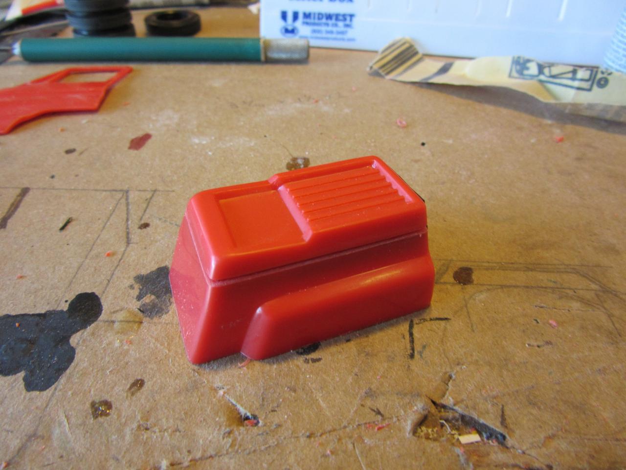

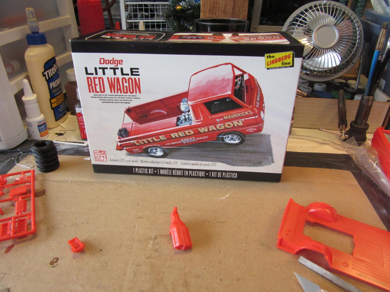

I was wanting to do a quick build so I started this Dodge A100. I want to do the van version but I don't have time to get the body in and I also wanted a truck anyways. I am doing this stock with the 273. I was thinking about finishing it in grey primer but I haven't settled yet. I opened the doghouse and hinged it. Since the back is not visible, rather than build a hinge I used a small piece of rubber and shaved the top rear so it would clear the back of the cab.

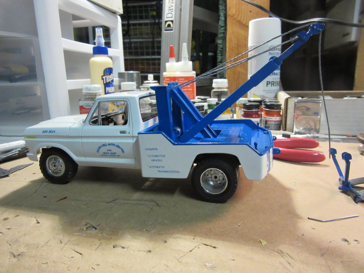

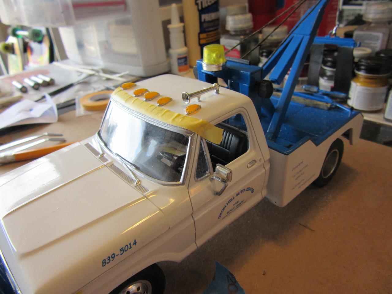

The clearance lights and rear marker lights came in. I don't like the marker lights, they seem way to big and I have found better, PE parts online. The clearance lights are ok, I would have liked to have found the type with the chrome frame that goes around the top but I will live with this. I added insulation under the hood and a HOLMES plate below the winch cable. In the future I will start making my own hood hinges so the hood will actually go up properly. I am also going to invest in an airbrush later this summer. I wonder if I try this Future that I keep seeing y'all talk about will it help blend the edges of the decals better or should I make new ones and try trimming them closer? -

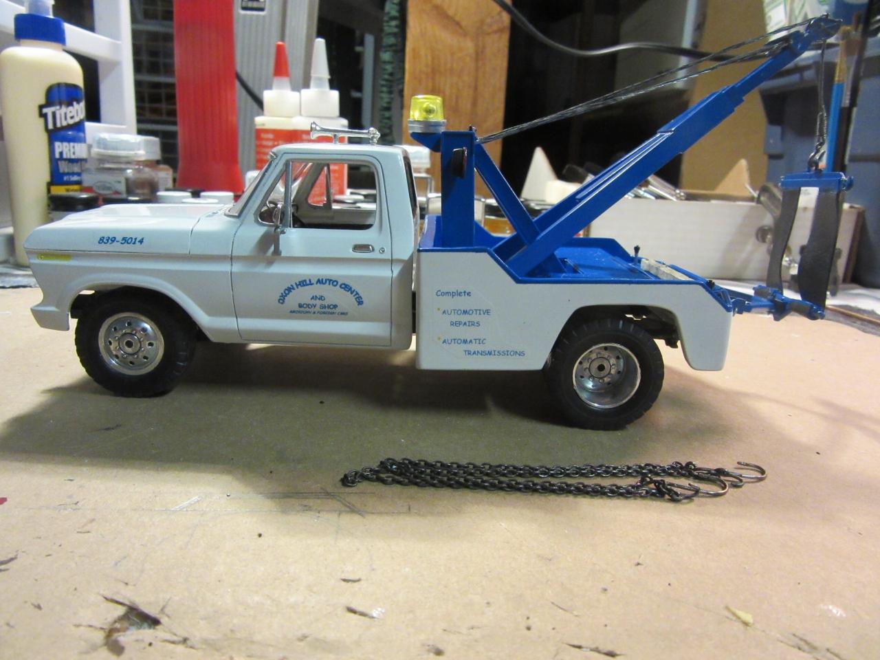

Slusher, its close, I've got clearance lights and rear marker lights coming, and tomorrow I'm going to make the HOLMES plate that goes below the cable on the crossbar. I would like to find the correct wheels but so far I haven't seen any of the 4 hole ford 8 lug wheels. My Dads shop specialized in VW's so it only seemed fitting to try it out on one. The 4x4 is just about the most important accessory for any sling truck, it keeps the hard parts off the shiny stuff. The chain is from the LHS, the hooks are fishhooks bent and filed. The brake lights are scratch built but the three running lights I trimmed out of the 77 GMC wrecker kit. The mirror's and horn were my first attempt with BMF, I wish I had tried that stuff years ago. I guess I didn't mention, I filed down all the trim and raised the top of the windshield to get it even with the door glass. I also didn't realize I missed detailing the inner door panels until I had the cab and bed attached and I really don't want to fight that again right now. The fire wall detail on this kit is pretty mediocre. No master cylinder or even a hint of a heater core. My son is working on a Revell "70 Torino which by the way is an impressive kit for the price, it even has a PE grill, so I am thinking about trying one of these resin casting kits from Hobby Lobby and copy the master cylinder from that. The battery cable is a paper clip, I flattened out the ends a bit to simulate the terminals. I think next time I will just put a bit of 2 part epoxy on the end and shape, file and scribe the terminals. The fuel line is also a paper clip but I can see now in the pictures it's a little bit too big. -

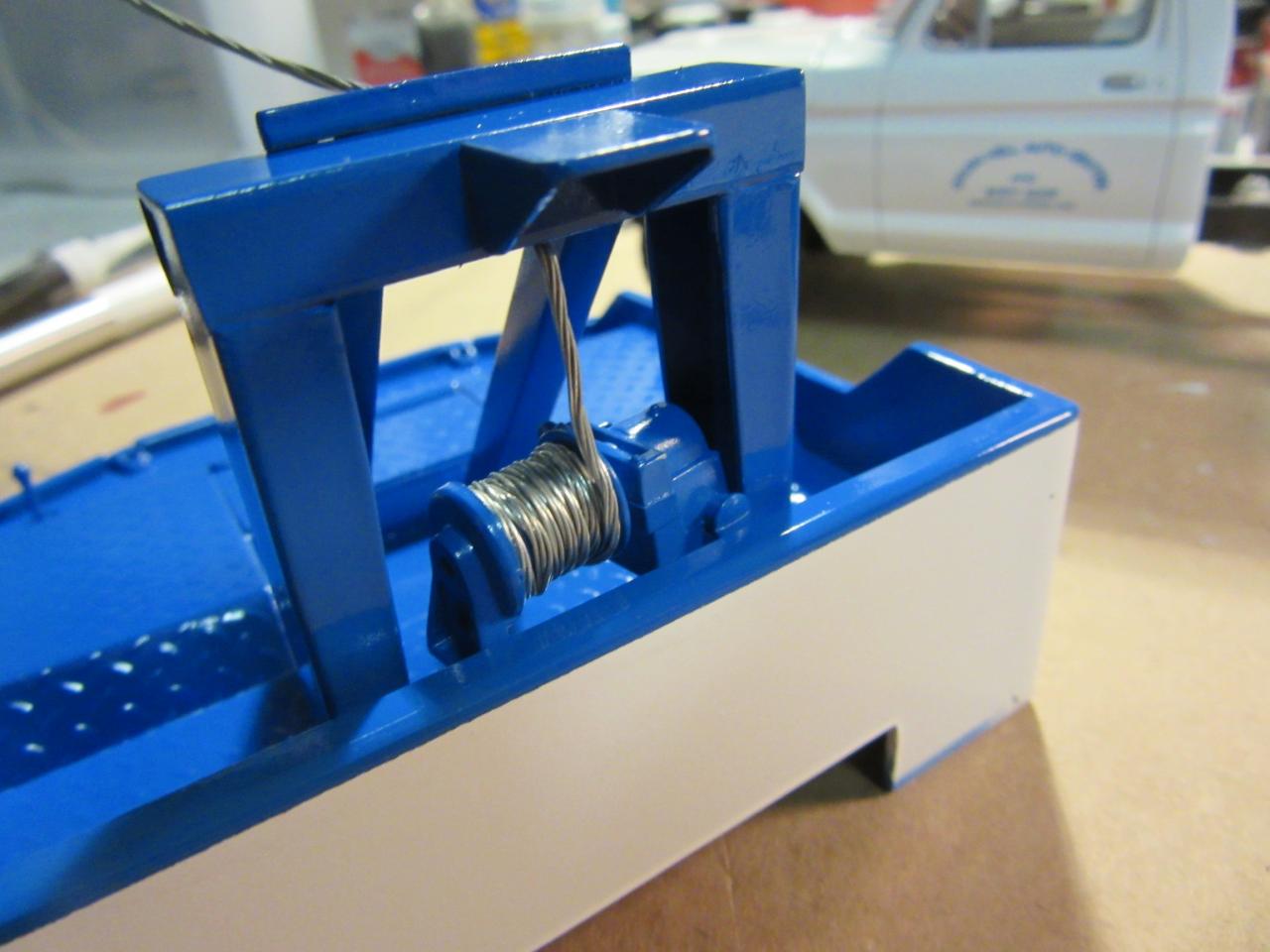

The sling from the GMC wrecker kit was ok but I wanted articulate it and one of my kids just needed a new bicycle inner tube so I tried gluing a piece of rubber to a scrap piece of sprue and it worked great. So now the sling articulates and has rubber straps. The bed is pinned and would extend in and out except I didn't plan for that from the beginning so the cable doesn't flex so well. My next one I think I'm going to put a small hand winch up top in the frame and maybe use braided fishing line for wire rope. -

Scratch built PTO driven off the transfer case that came with the kit. I tried to put a little surface rust on the muffler, this was before I really got to looking around on this site and found all the great tutorials on weathering and rust. At this point in the build I was planning on just using the 78 grill but then I saw Kris from M.A.D. mention he had just done the correct grill so I sent him an e-mail and he blew me away with the service he provided. I can't say enough about how happy I am with the grills and distributors he sent. The cable is picture hanging wire, the parking brake cable is one strand from the picture hanging wire. This was my first attempt at decals and I think I sprayed the clear on a little to thick. I also should have trimmed them closer.
